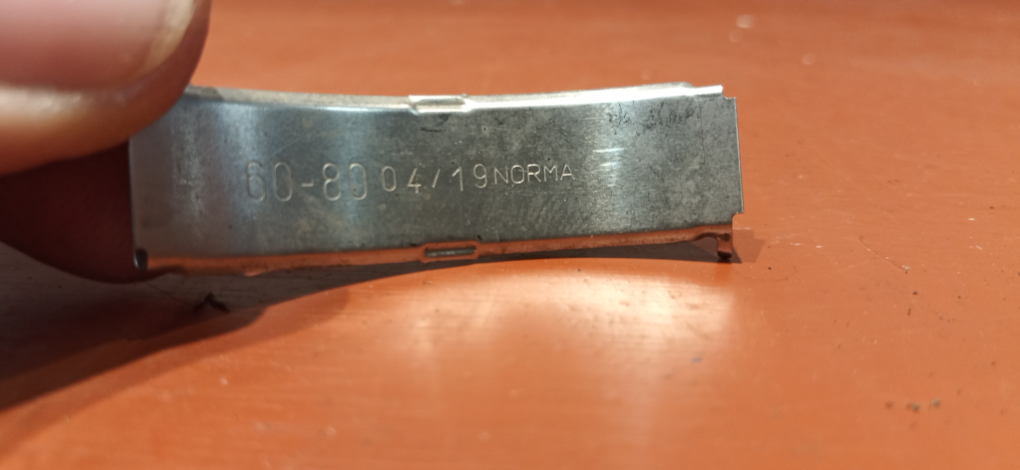

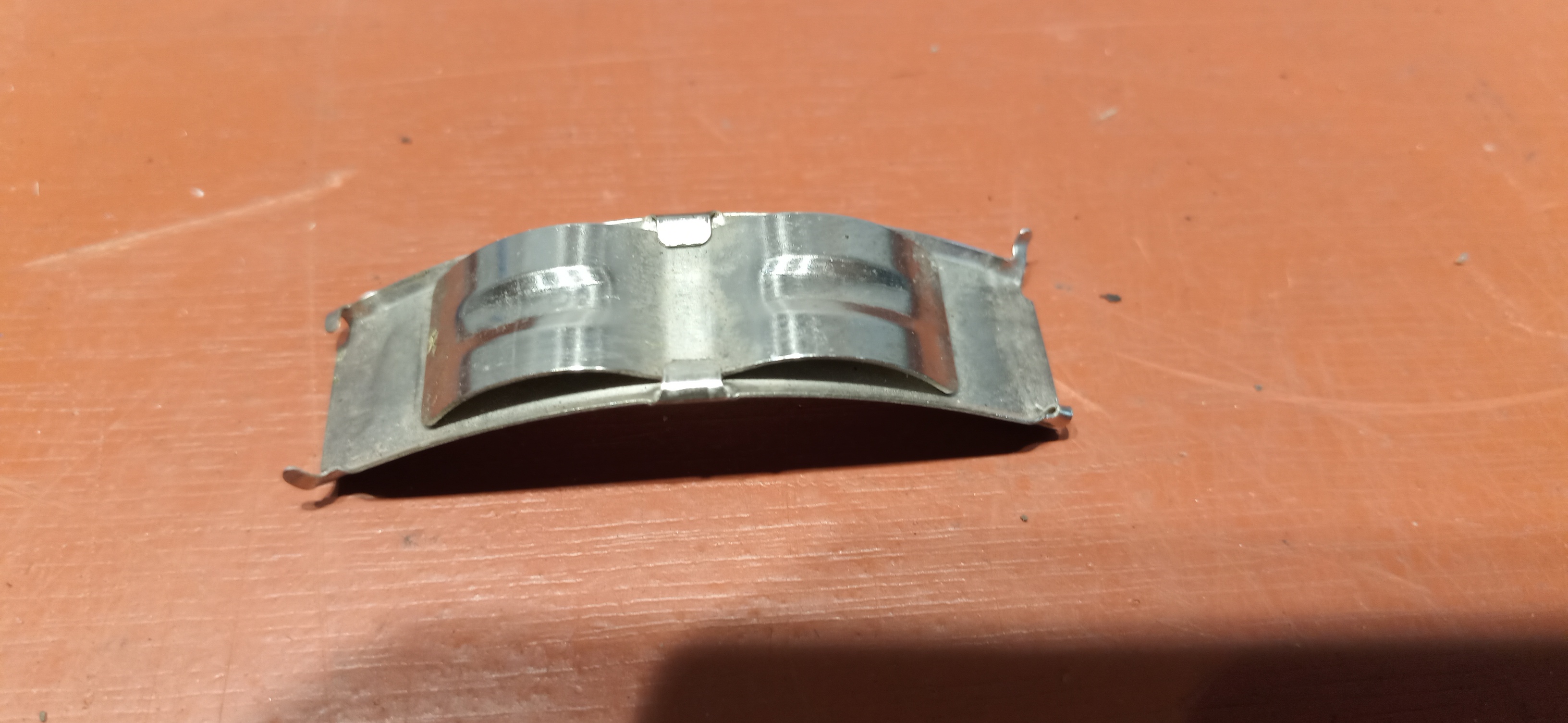

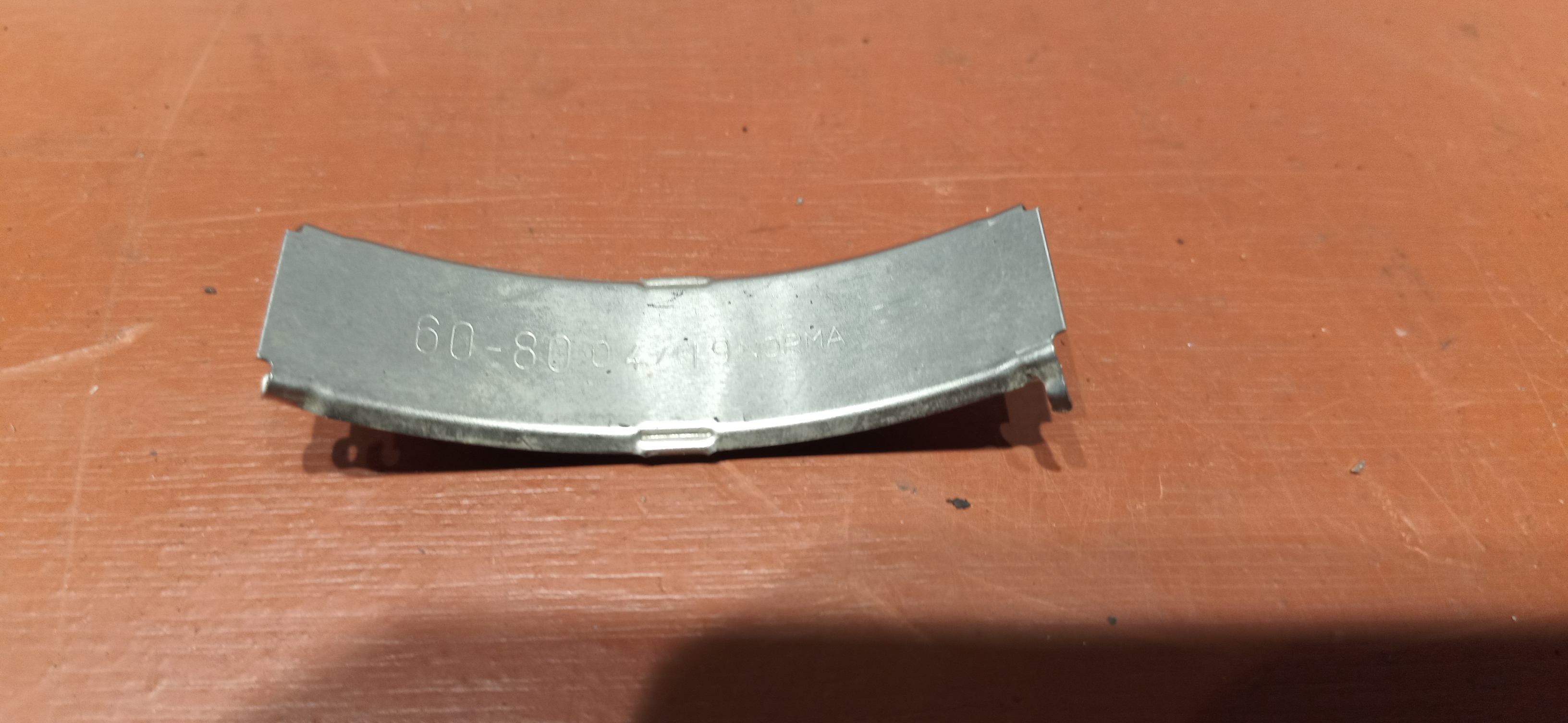

Identify the component
Wots dis fing?
I found it under my car this morning, but not sure it's off the car because it's absolutely pristine.

Brake pad retaining clip?

Or part of a watch bracelet

I think it's a piece of trim off a jubilee clamp.
Like inside this one...

Might be stainless, have you tried a magnet on it?

Re: Identify the component
I'm now wondering where it might have come from.
As said, it's absolutely pristine, which makes me think it's NOT come from something under the bonnet.
If it's a tension spring from a jubilee clip, that would indicate that (if it came from the car), there's now a loose bit of pipe somewhere....
