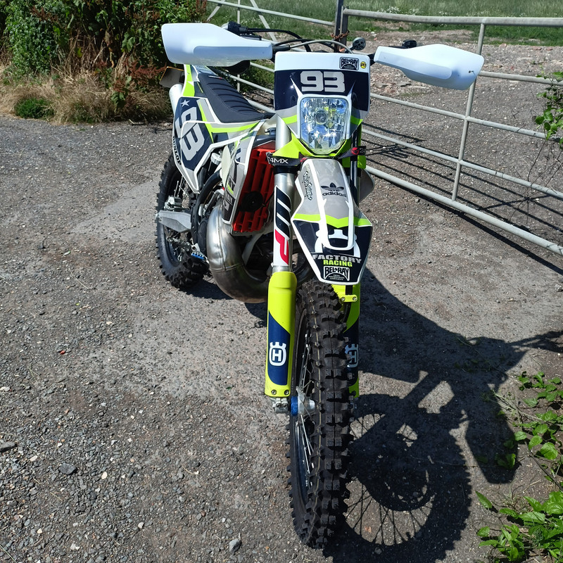

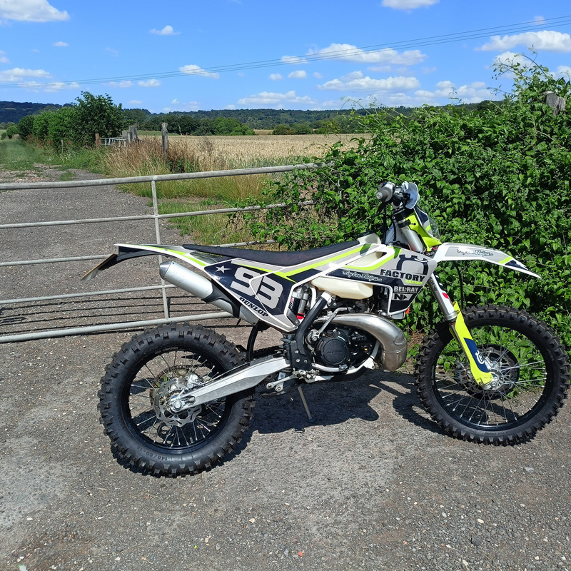

Well, it’s actually white, ( apart from the KTM rad guards) as it’s a Husqvarna, but as we all know it is really just a KTM in a different frock :D
This one is a 2019 TE300i, a one owner bike with 83 hrs and 1,300 miles on it.

The one I bought is a one-owner bike, and I bought it directly from the owner, so known history and all the books, receipts etc.

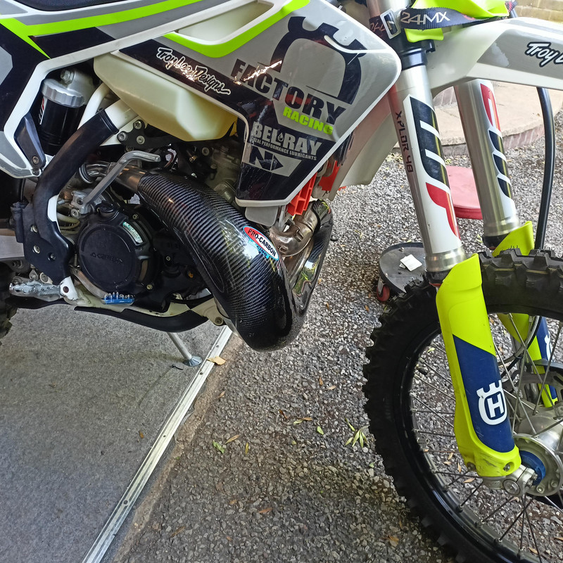

It has been used as intended so is by no means immaculate, but it has been loved and had some useful additions ( that I would have bought if it dodn’t have them ) such as engine case/exhaust port, wheel bearing and suspension linkage protections, along with one that I wouldn’t in the (Marquez?) sticker kit, but that’s easily changed if I choose to.
It also had a carbon fibre exhaust protector, which had a fair bit of damage from an off and looked scabby, but the good news was it had definitely done its job as underneath it, the damage to the pipe was minimal, so I ordered another one up, and it arrived last Friday, the day before my scheduled first proper outing on it, so that has now been fitted.
It’s also been tested too as of the week-end and has survived unscathed as it was clay I went down on, but the pipe is so sticky-outy and vulnerable on these it’s bound to get damaged over time.

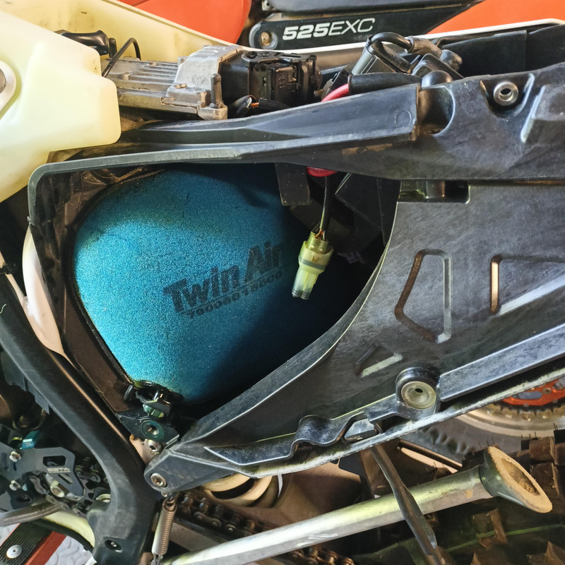

The bike had been just sitting unused in the previous owner’s garage unused for the last year and a bit, so although it was due its first MOT last year, it hadn’t happened so I had to get that sorted, with of course a good check-over from me first, and the purchase and fitting of a legal size rear plate for the MOT.

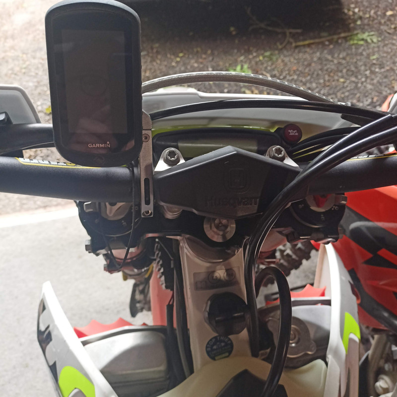

I also wired in a little 12v to USB power supply for my Garmin , took a feed from the lighting circuit so I don’t have to worry about flattening the battery.

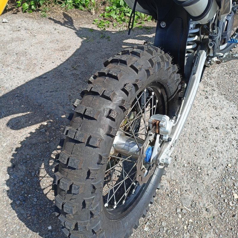

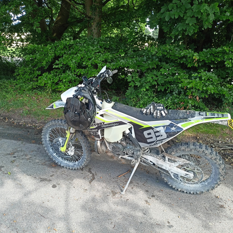

Anyway, got it home, fitted the new exhaust guard, filled it up with fuel, checked tyre pressures and in the van it went.

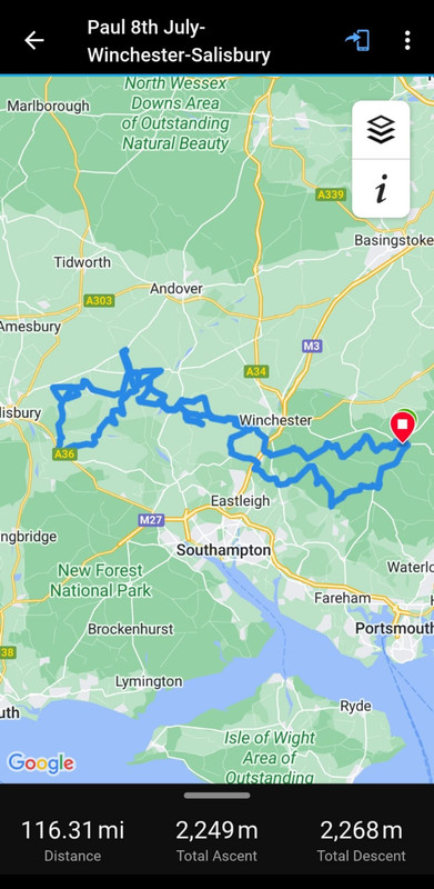

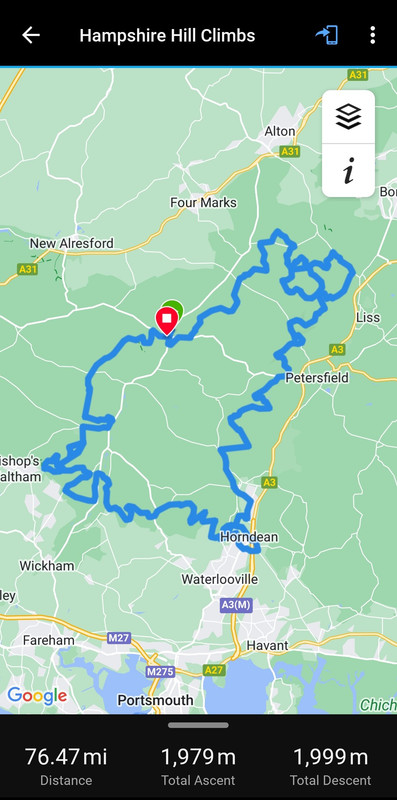

And this was Saturday’s planned ride route
Some great (and very slippy) lanes, but a fair bit of tarmac in between on this route, which on reflection made it an excellent test for the new bike.
And I have to say, it was brilliant- my meh-ness of the previous day disappeared pretty much on hitting the first lane, I can see why the serious enduro boys (and Yorick :wave: ) like this motor, pulls from absolutely nowhere and really flies.
Overall there is probably only 6kg or so weight difference between it and my trusty old orange girl ( 106 v 112kg) but as anyone who rides off-road knows, weight (or lack of it is key), and the 300 feels just that little bit more nimble- perfect novice bike IMO in that respect.
But the biggest revelation to me is how civilised they've managed to make a 2-stroke- it’s even Euro4 FFS!
Gone are the days of fannying about with over-rich chokes from cold, oily drippy tailpipes and having to “clear its throat or worrying about it oiling up after tootling at low revs for extended periods, and almost 4-stroke-like in that respect, it just goes.
And the fuelling at constant throttle on the road- although it sounds like it’s 4-stroking sometimes, you can cruise along at whatever throttle opening you choose- no surging or having to pick one speed only or speed up and slow down all the time like you might have to on pretty much any other (non FI) 2-stroke, it is just so civilised.
It was an absolutely cracking day, the only slight negative in its performance was the suspension, which I’m sorting this week.

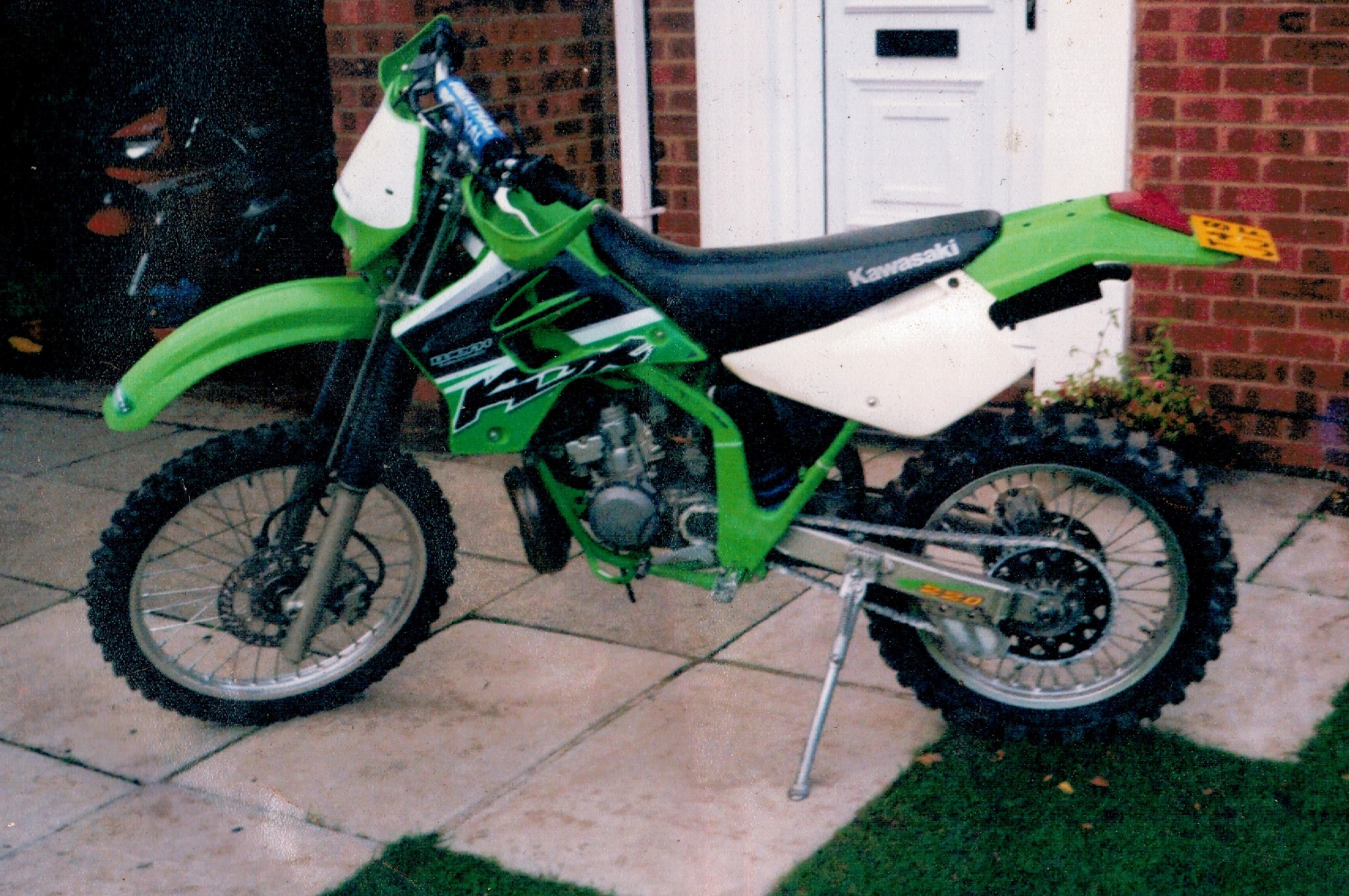

I dunno, I tried a KDX220 in about 2004 and I thought it was superb compared with the last two stroke enduro bike I'd ridden, a 1986 KTM 250 (in 1989), the KTM was so old school it didn't have a power valve, it was a proper old snarly beast of a thing, the KDX was lovely and smooth with power everywhere, 20 years of development can only have made a better engine.

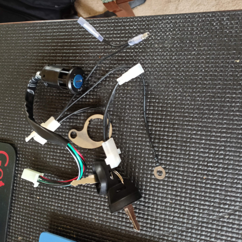

4. Install an ignition switch

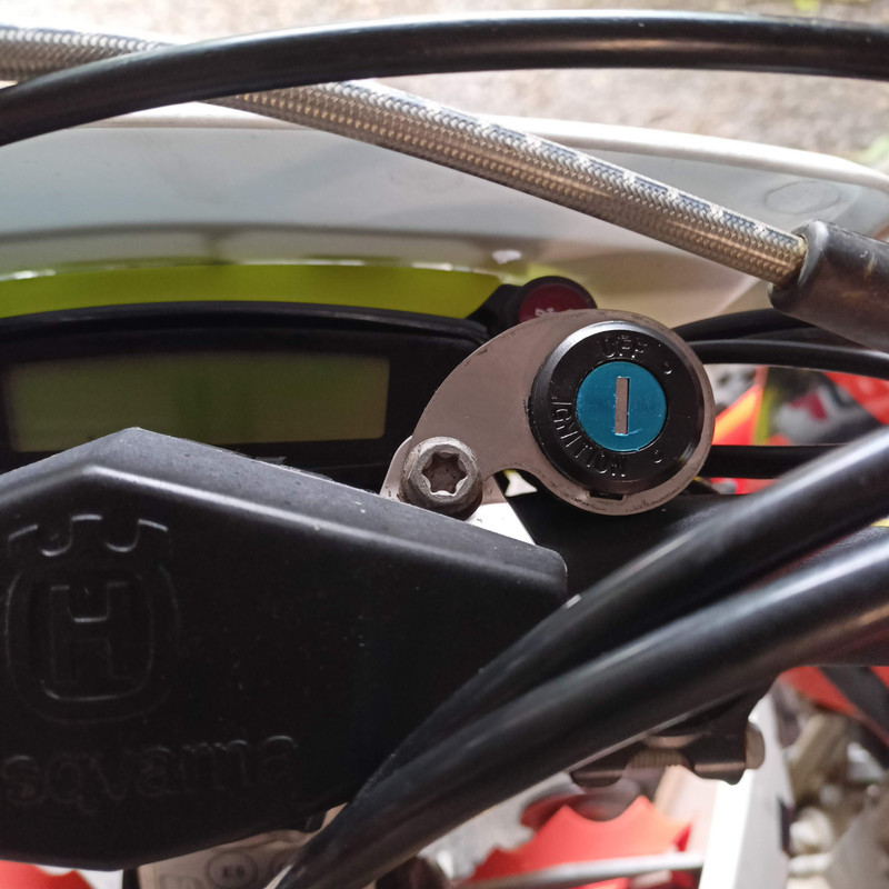

So I started with the easiest first, and it really was easy- I bought this KTM/Husky specific kit for under £30, and it took under 5 minutes to fit, very much worth paying those few extra £ to save having to mess about finding connectors and making my own little loom up IMO - job jobbed.
As previously mentioned, it’s not going to stop anyone who really wants it stealing it, but will prevent somebody just being able to walk up to it and ride straight off, as of course, you can on any of them as standard

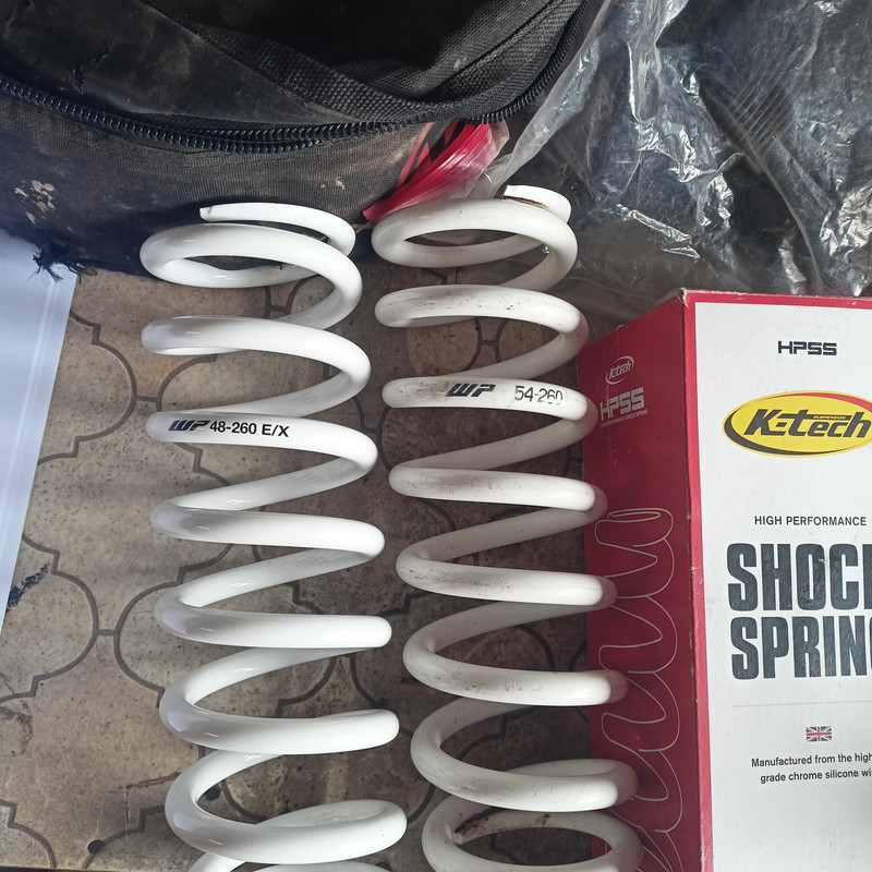

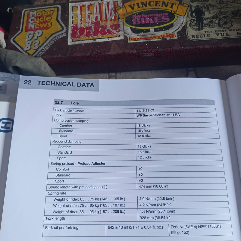

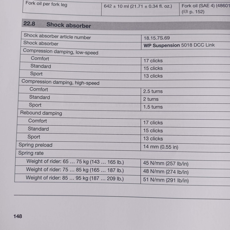

Next I turned my attention to sorting the suspension out- this is the relevant page from the manual for the rear shock
I fall within the 75-85kg category, I have choices of a 48 N/mm or 54 rear spring in stock to replace the 63 that is currently fitted, which as you can probably guess is waaaay to hard for me, so the 48 is going on

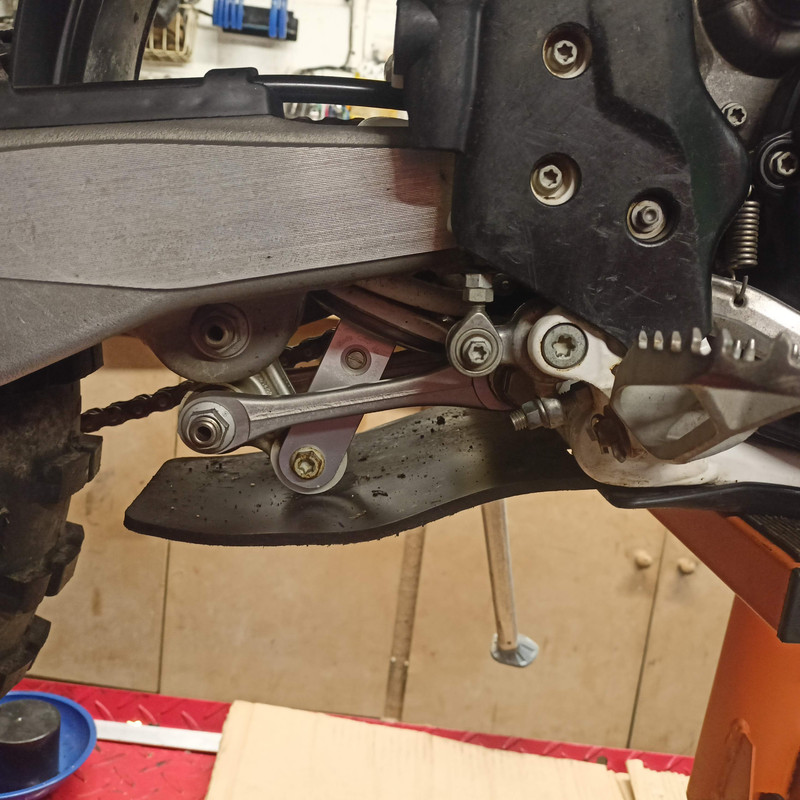

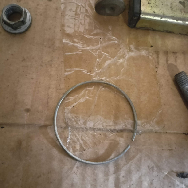

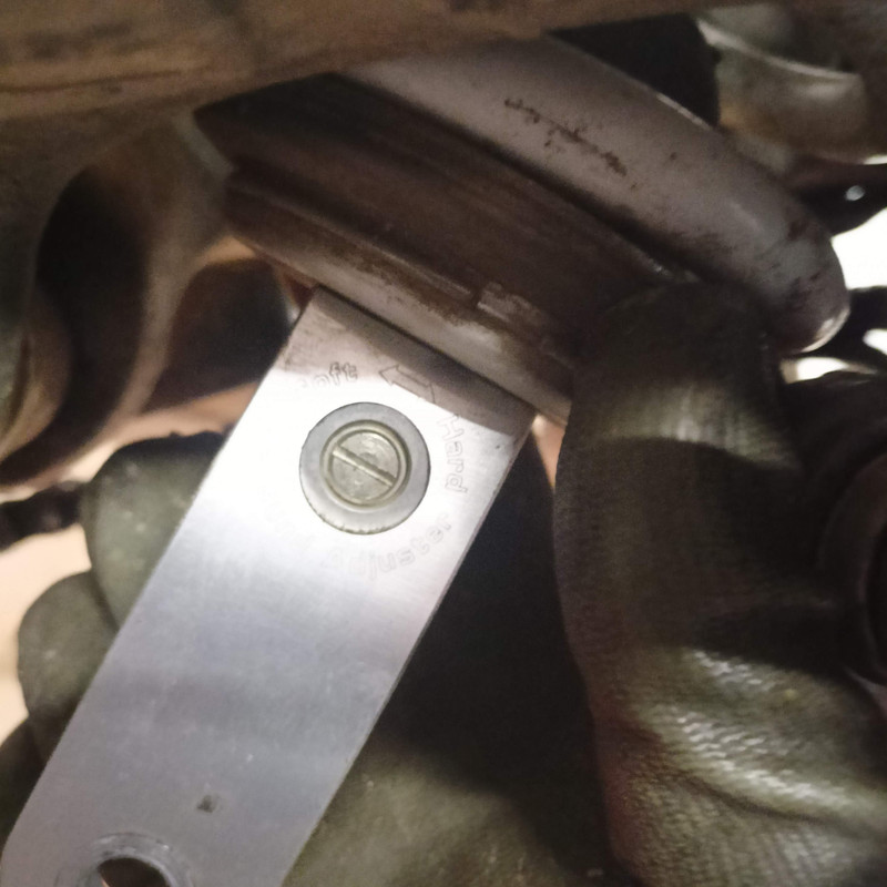

And once again, the job really couldn’t be a lot easier with the WP shock- it is simply a matter of removing the bottom shock bolt and one from the linkage ( I’ve got a linkage protector on mine so that meant two extra 6mm bolts to take that off first )
Once you’ve wound the preload off, it allows you to lift the spring up to expose the little wire clip that secures the bottom collar, ping that off with your finger and the spring simply drops out – no need to remove the shock and no spring compressor required :thumbup:
This weedy little bit of wire is all that holds the spring in place, cool eh!
And in the words of Mr. Haynes, re-assembly really is just doing the opposite of what you’ve just done, or something like that, and then winding the collar back down to set the preload.
I haven’t measured the sag yet as I didn't have an available helper today, so for the moment I’ve just set it to book recommendations of a spring length of 246mm, and the standard compression and rebound settings, which feels good to me just sitting on it and bouncing up and down and is a decent starting point.

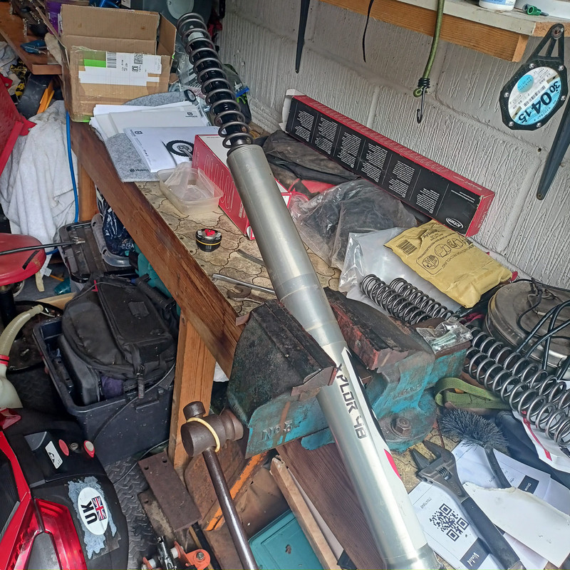

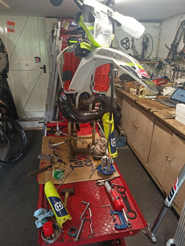

Now for the front:
The standard front springs that I have are 4.2N/mm, so that’s what went in to replace the 5.2s that it was on currently.
As with the rear, it really couldn’t be a lot simpler- the front wheel and forks were out in 5 mins, then it was just a matter of unscrewing the top cap on each leg, removing it from the damper rod, sliding the old spring off and new one on. The oil in there looked immaculate, and I didn’t lose any, so I’ve left it as is

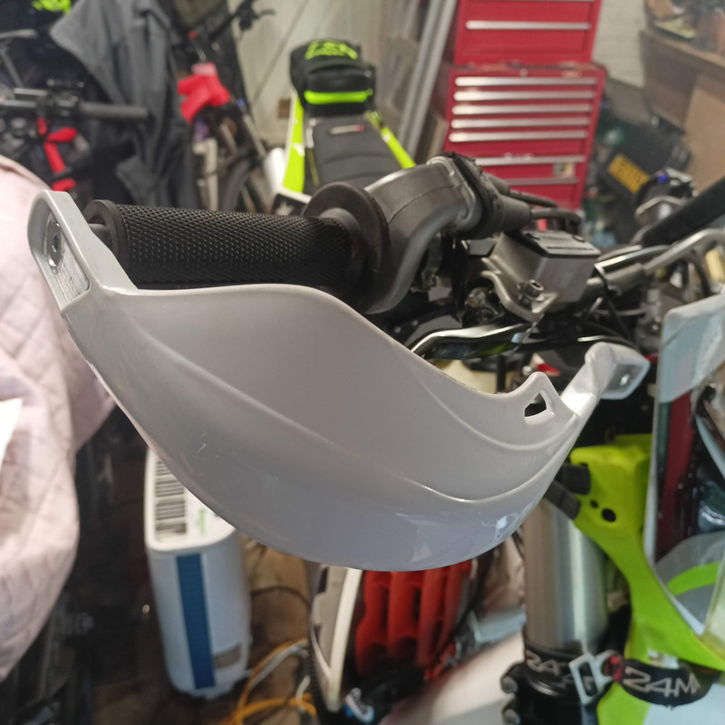

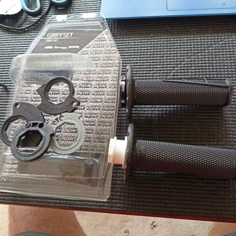

And to finish the whole job off, it got a pair of brand new KTM/Husky grips- only £23 which I reckon is a bargain considering they come with the inner sleeves/throttle tube and a choice of cams.
I also fitted a new pair of levers to replace the shortened original ones that were on there, and a set of wrap-around handguards- not genuine KTM/Husky ones, which I would have preferred, but they seem well made and solid, time will tell I guess

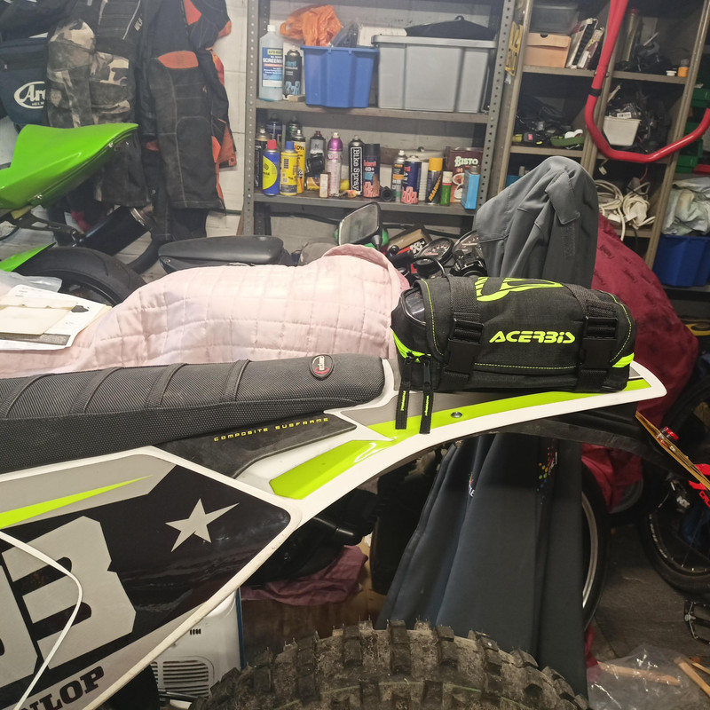

And to finish the job off, I’ve also treated it to a nice new (colour matched) toolbag- screwed rather than bungee-d to the rear guard so it should say on there this time!

Another little update- got out on the 300 again this week-end , the first ride since re-springing, and the other little updates above.
The route we took was this one
It incorporated a fair few quite technical climbs ( including Butser Hill, and the one that @crust broke his femur on last year :( ), lots of rock and clay which after the amount of rain we’ve had over the last couple of days made it slippity with an absolutely massive capital S! :shock:
TBH I think the 300 is probably a bit harder work on this type of going than the trusty old 525 is- although the motor pulls from pretty much nothing, throttle response is quite instant and abrupt even in map2 ( that's the supposedly softer map, albeit fecked if I can tell any real difference between the two) which when it is this slippery and lumpy means it is mega easy for your rear wheel to end up pointing 90 degrees or more different to the way you’re trying to travel...
The old 525, although undoubtedly pokier (by my arse dyno it is anyway) is easier to hold on small throttle openings IMO, just seems not quite so keen to run away, and I think it's also a (little) bit easier to find grip on when you really need it.
And of course it has engine braking in spades, which really does help on some of the really steep descents - the 300, well it's a smoker innit... :)
Anyway, it was another cracking day, we didn’t get rained on, I sweated at least 10 gallons, and although there were a few offs and one ankle that’s blown up like a balloon today, it wasn’t mine, me and the Husky stayed the right way up the whole time, although I will admit that there were quite a few times when I thought I was off, my massive bike control skilz ( and possibly a little bit of luck ;) ) saved me every time
And although the forks were a massive improvement, and I think are just about spot on, the rear is too soft , it bottomed out a few times on the faster bits- going by the sag, I think there’s a good chance that it’s more than adding some pre-load to the current set-up will sort, so I’m going to slip the 54N/mm spring in over the next few days and see how I go with that.
Oh, and just for my own interest, and that of any nerdy types here, I’ve been measuring MPG and oil consumption- over the ~250 miles I’ve done on it so far it’s averaged 52mpg and used a total of just under 150ml of 2-stroke oil , which equates to roughly 1500 miles per litre by my calcs - quite astonishing IMO considering the use it gets , and roughly 10mpg better than the old 525 :geek:
I’m next out the day after tomorrow with some local boys on some new (to me) lanes in Bucks and Herts, and I've decided that I’ll use the trusty old orange bike for that ride- will make an interesting (almost back to back) comparison, now I've done a few miles on the 300 and got to know it....

Not a huge amount to report but I guess that this thread is overdue an update- I had another full day and 90-odd miles on the lanes on the Husky this weekend, and had a blast.
I’d previously gone back to the standard rear spring, but even whacking pretty much full preload on it, it was still on the soft side of OK so I did end up going up to the 54N/mm spring, and am pleased with how it is for me now;- it just glides over the really rough stuff with no bottoming out and still plenty of scope for pre-load change if I needed it ( which I don’t).
It was quite an eventful day one way and the other- perfect weather for it, but we’d had a fair bit of rain down south last week so some pretty tricky going on some of the climbs and descents, but all afdds to the fun IMO
What wasn’t so good is two of the boys had punctures, about 20-30 miles apart, but we had plenty of spare tubes and all the tools we needed ( including a portable bike lift- all you need is a tree :D ) so all was good.
As for the Husky, it was spot on- the lack of engine braking compared to pretty much any four-banger makes it a bit trickier on the slippy really steep downhill stuff, but , well old news eh and you just adapt.
What was interesting for me was two of my riding mates' opinions, as we did swapsies so two of them have a stint - both experienced off-roaders and KTM / Yam riders, but neither having any off-road 2-stroke experience.
Although they both obviously enjoyed it, and commented how light it seemed and how “floaty” and good it was over the really rough stuff, they both also thought that it was harder work and needed more gearchanges than their own bikes and were also not unhappy to hand it back, with the opinion that it’s fun but both preferred the 4-stroke 350 KTM as an all-day bike.
The gear-changing comment surprised me, as I don’t think it’s in the slightest bit peaky as smokers go, but the ratios are so close together, and I guess it depends on what you’re comparing it to.
Anyway, I’m loving it.
I’ve got it just about how I want it for me now, apart from the gearing – it could do with new chain and sprockets in the not too distant so I might bring that forward a bit and go down a couple on the rear and up one on the front too, but that will be it, apart from tyres etc when it needs them.
I suspect it will get less use than the 525 will over the coming months as the orange bike is definitely easier to ride when it’s really deep and slippy ( and I also have heated grips on it 8-) ), but it’s great to have the choice
