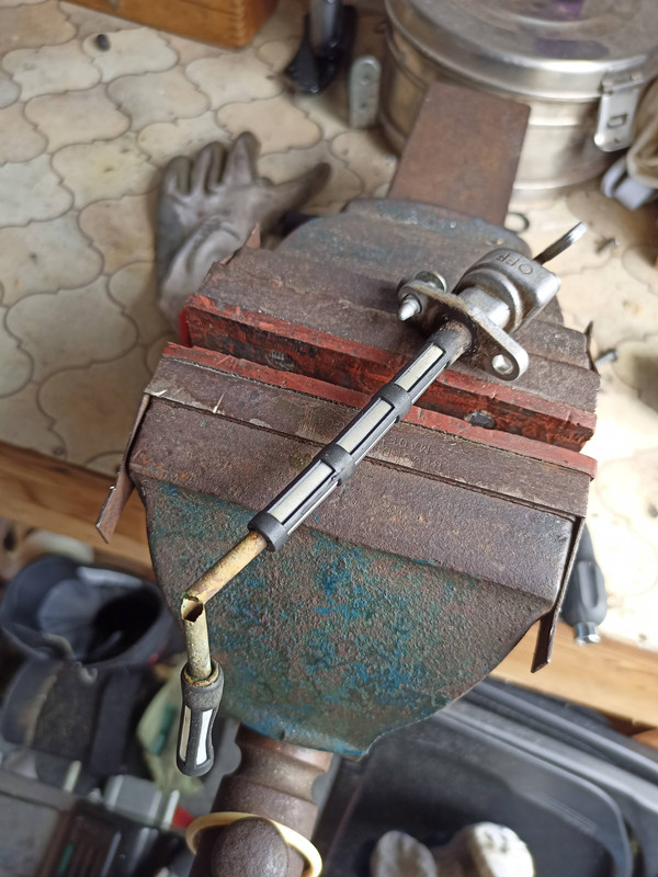

So first up the fuel tank/tap problem- I slipped that tank off and the tap out and it was immediately obvious-
The copper tube has absoloutely rotted away, I guess that’s at least in part due to ethanol based fueI- it did get very corroded a few years back when it was standing for a year, I managed to bring it back back it's obviously taken it's toll.
I gave it a blow through to clear the debris and for the moment have just crimped the end of the tube over and put it back. It means I’ll have to use reserve position all the time, but I will look to get a new tap at some point so that I have main and reserve, but it’ll do for the moment.

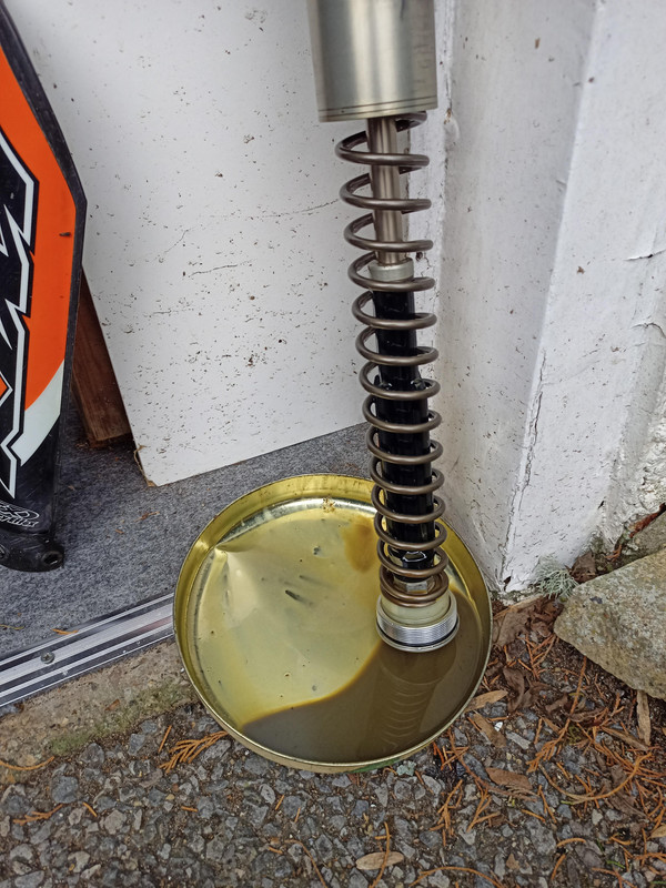

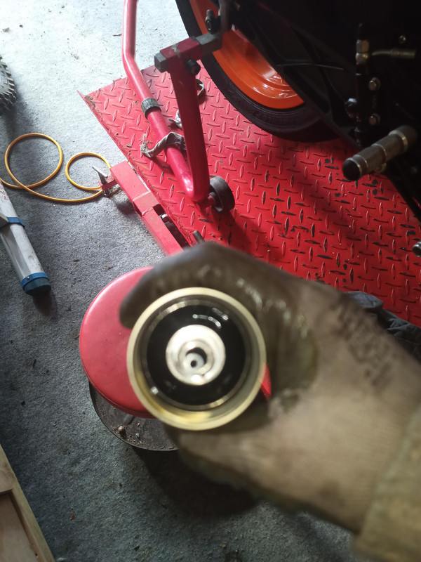

Next up is the fork seals.
This is where off-roaders like this are great, as there is no unnecesary tat on there and it’s literally a 5 minute job to drop the forks out and get them on the bench ( not forgetting to crack the top caps first while they are still in the yokes of course).
The WP USDs come apart easily, with no special tools needed which is a nice change from those horrible old 1970s/80s RWU forks with the annoying methods of securing the damper rod to the lower leg- no broom handles needed or other such such hassles here, it’s literally top cap off, remove the spring and associated gubbins, remove the circlip above the seal, and the lower leg can effectively be used a slide-hammer to knock the old seal out.

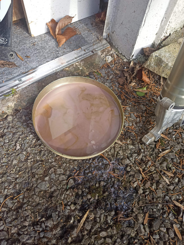

I started with the leg that had the popped seal first and as you can see from the above pic the colour , and quantity of ol in the legs was very different, not particauly surprising I guess as one was leaking heavily, and obviously pulling crap in too
This side was quite a nice colour considering how many years its been in there :)
Once its disassembled and cleaned, in the words of Mr Haynes, “reassembly is a reversal of removal", except you really do need a seal driver of the right size (48mm in this instance) to do it properly - mines the two-part black thing in the below pic, someone knocked it up on a 3D printer for me, although I will admit in the past I have used the old seal as a seal driver and cut it off with a Dremel afterwards.

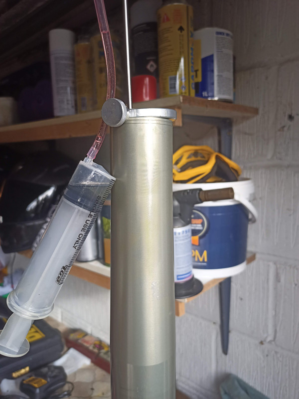

Once the seal is in and the damper rod reassembled, it’s then time to add the new fork oil- the KTM rivet counters will tell you that you need Motrex 4w , I didn’t have that but did have Motul 5w on the shelf so that’s what has gone in.
Rather than adding a specific quantity, the supposed correct way is to set the level , ensuring of course that you’ve fully bled it by working the damper rod up and down until there is no more gugling or air bubbles- in a clean installation, I can’t really see why adding a specific quantity as per the olden days is technically inferior, but mI have a fork oil height tool , so I did it the recommended way with that and set it the fork oil height to 120mm from the top, which equates to somewhere between 400 & 500 ml per leg in these forks.
When that’s done, then it’s simply a matter of putting the spring back in , ensuring of course that you don’t forget the thrust washers, and then screwing the top cap back onto the damper rod, before nipping the cap back down onto the fork leg and then you’re done.
That was as far as I got yesterday before other things intervened, but both legs are back together and ready to go back in, it’s peeing down outside this morning so plan for today after my cornflakes is to sort the speedo ( and maybe even get that tail-tidy on the 890 too.... :think: )- More to follow

Always feels like a worthwhile use of your time when the oil comes out looking like that, every time I’ve done my lads crf forks it’s come out looking like new and feels like a wasted exercise!

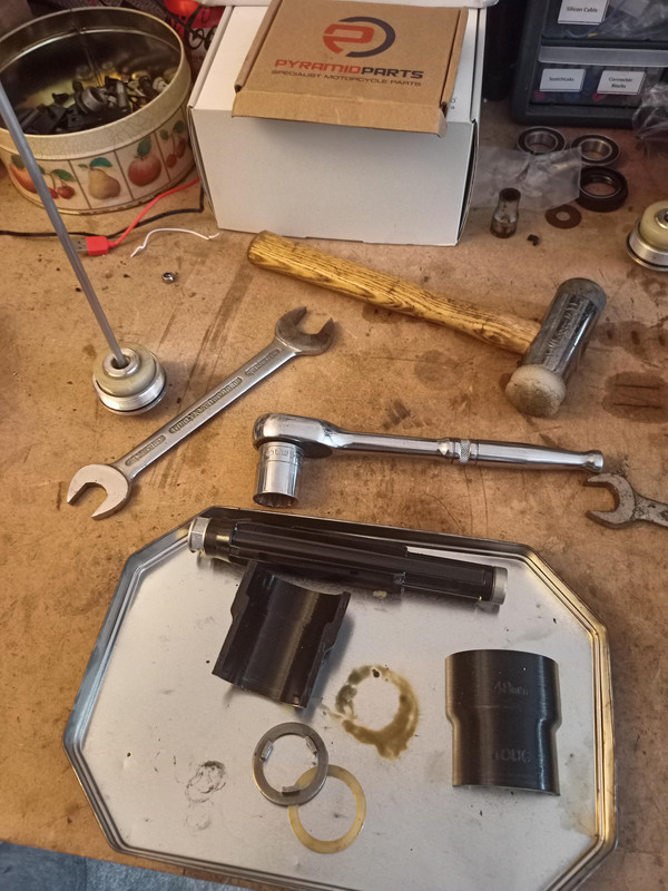

So out the forks came again- was nothing obvious on either of the seals to my old man's eyes, but they weren’t sealing so they were replaced with Showe 3L ones- not had them before but they have 3 sealing lips are supposedly low stiction and guaranteed not to leak- we shall see
Anyway, they all went in nicely with some Rock Oil 7.5w, and while I was at it I replaced the air bleed screws in the fork caps with some of these beauties :D

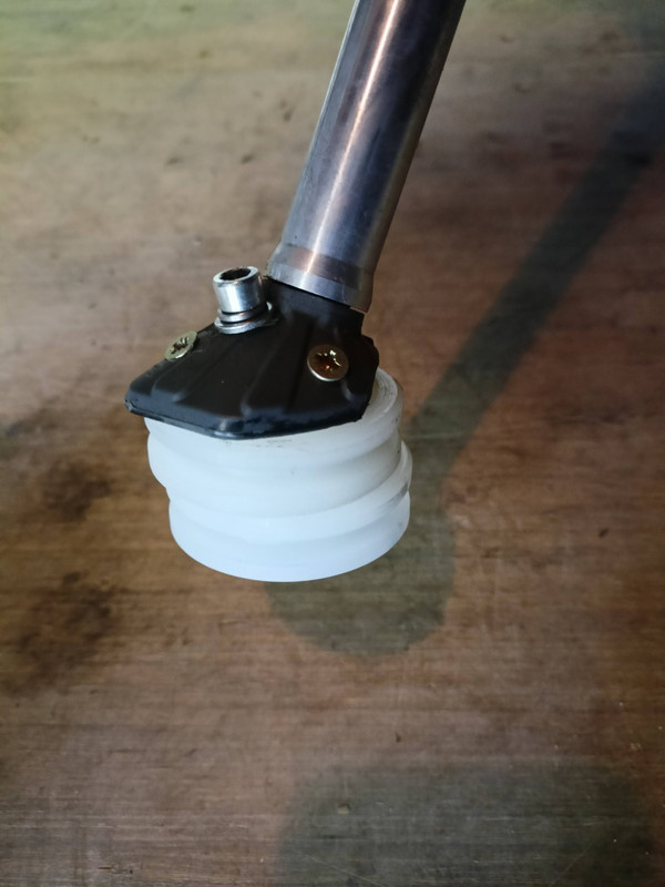

Another thing that broke last time out was my wooden prop stand extension- not too surprising really, as it was only softwood- what I really need to do is turn up a nice piece of nylon bar to the exact dimensions I need, but I didn’t have any, and did have a couple of nylon pulley wheels so I’ve made do

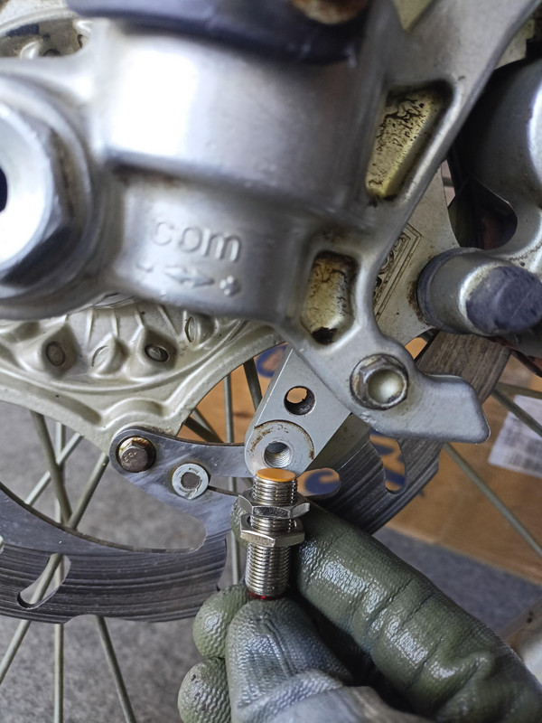

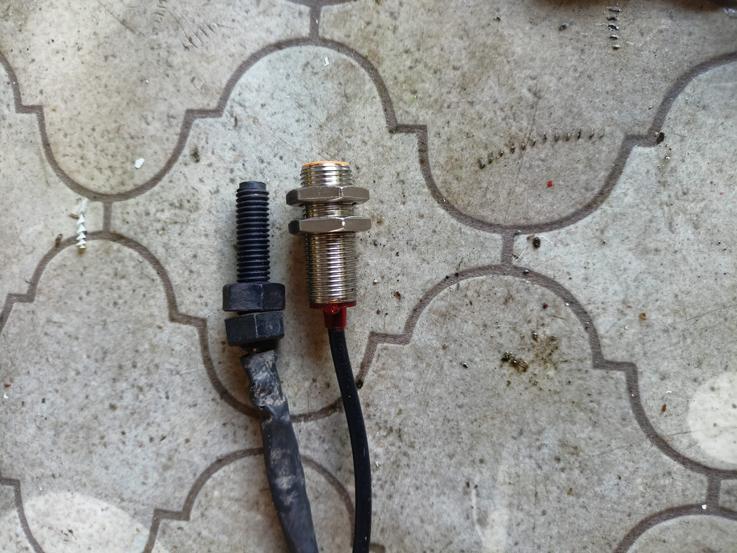

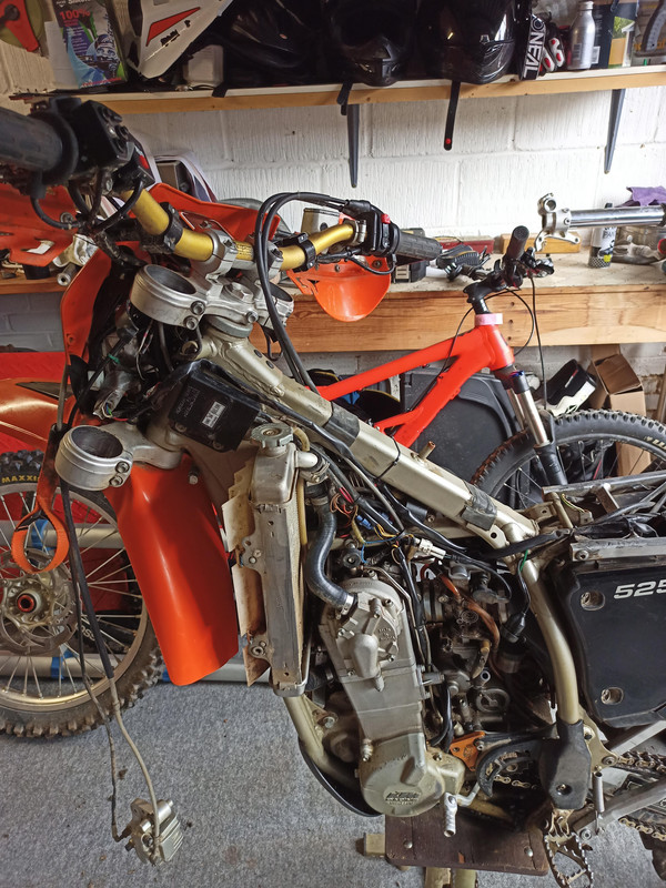

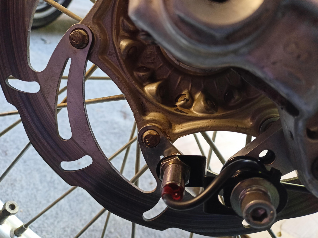

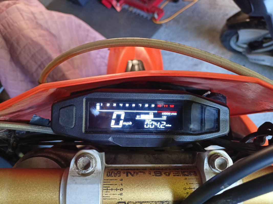

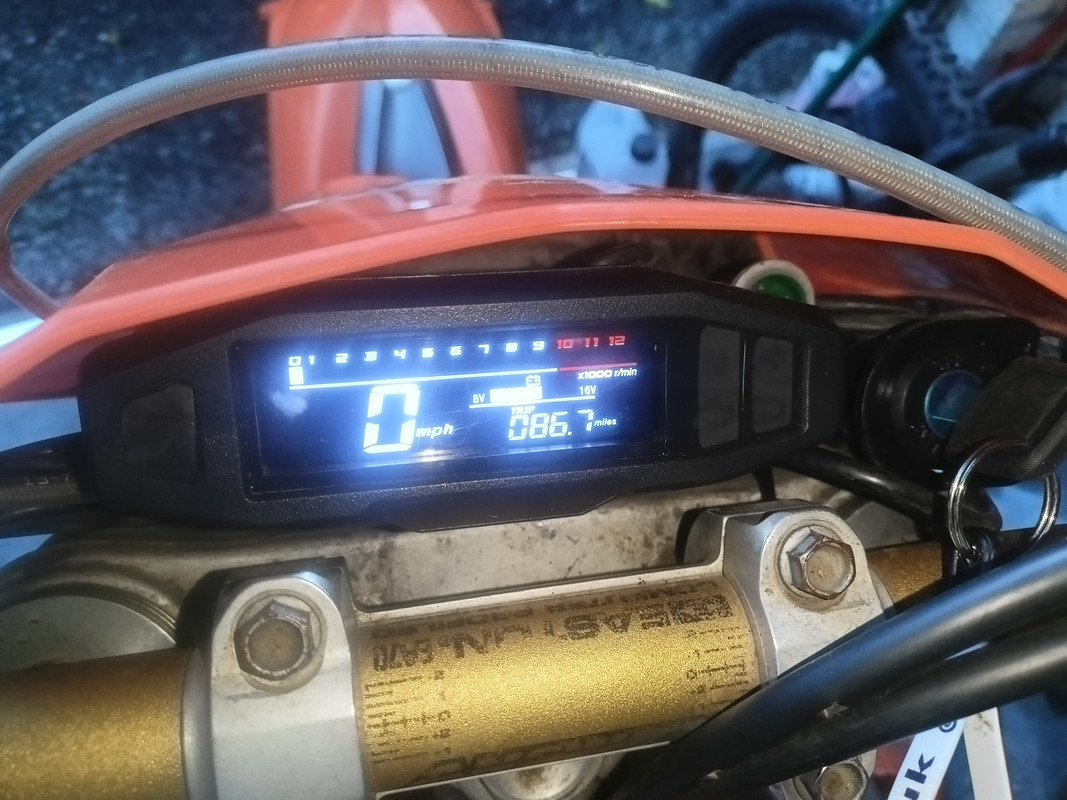

And while the forks were out, I finally turned my attention to the now completely dead speedo/ display.

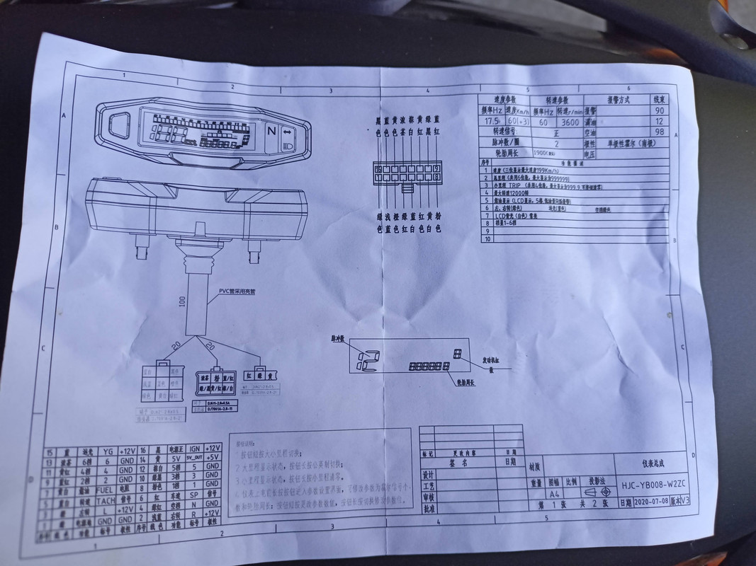

The speedo function has been fecked for a good few years now, meaning it’s been showing 4661 miles for as long as I can remember, so I thought I’d see if I could get the no-name £15 Chinese one that I’ve had in a cupboard for years working.
It took a bit of trial and error wiring it up, as this is the wiring diagram that came with it,
And the sensor is a lot bigger (M12 – the standard KTM one id M8)
And mounts in this hole
It’s a quite unusual M12 in that it’s a very fine 1.0 pitch- I have 1.5 and 1.25 taps , but not that fine in M12 so for the moment it’s installed in a slightly Heath Robinson manner using an old paddock stand bobbin and some bent tin – I’ll get a tap over the next few weeks so that I can mount it directly in the caliper bracket like standard, and neaten things up a bit, but this is how it looks currently
but I am pleased to report after a brief test ride today, that after all these years, we now have a working speedo, hurrah! 8-)
It fits nicely in the space, looks more at home than the original IMO- no rev-counter, fecked if I know how that’s meant to work ( I tried connecting the RPM ( I think) wire to the LT side of the coil, and wrapping it around the HT lead too when that didn’t work so feck knows, but it’s not really of any significance on this bike, and no clock, but the speedo works

On top of that minor annoyance, , since I replaced the original speedo/hour meter, I have also missed knowing the time of day without rolling my sleeve up, as the new speedo doesn't have a clock, so today I finally got off my arse and set about sorting both these aspects.
What I meant above by the new speedo making things a bit fiddly comes down to how it’s powered- it’s a basic and cheap (£15 delivered including the wheel speed sensor IIRC) generic Chinese unit, with just a single 12v power connection, which is fine for most bikes, but of course, my era EXC doesn’t have any form of ignition switch.

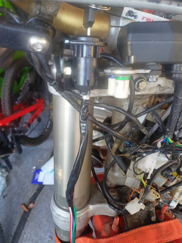

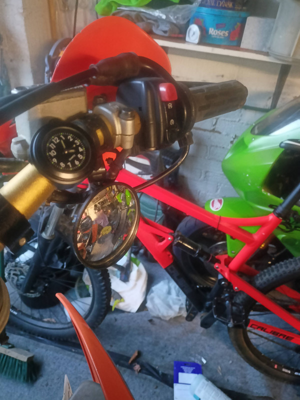

On my specific bike I have always had what I call my anti-theft device, which is just a tiny little 2-pole rocker switch hidden away in a place under the tank that when switched, cuts power to all the lights, horn etc, and also earths the ignition;- the trouble with the new speedo is that it doesn’t have an auto-timeout on the display like the original KTM one does, so I have to remember to flick the switch when stopping for any length of time so to not flatten the battery, and that is difficult and a little bit of a faff with gloved hands as the switch is so tiny.
So I decided to install a key-operated ignition switch in an accessible place, and here seemed to be the most suitable.
It’s just a £6.50 generic Chinese one off eBay, so it’s definitely not increasing the security to any significant degree, but that wasn’t the aim. I’ve wired it in series with my secret little switch, so I still have that as my effective immobilizer that could stop a rode-away even if someone screwdrivered the lock.
I adapted an old fairing bracket I had laying about to provide a suitable mount for the new switch, to mount and position it alongside the new speedo by bolting my new bracket into KTM bracket that would normally mount the indicators- I ditched them off mine back in 2006.
I ran and terminated all the wiring under the tank, and I have to say, am quite pleased with the result- it’s tucked away, and almost looks factory fit I reckon :thumbup:
So once that was sorted, I turned my attention to the lack of a clock, solved with the addition of a £5.99 bicycle handlebar clock from Amazon and 10 sec with an Allen key- sorted!

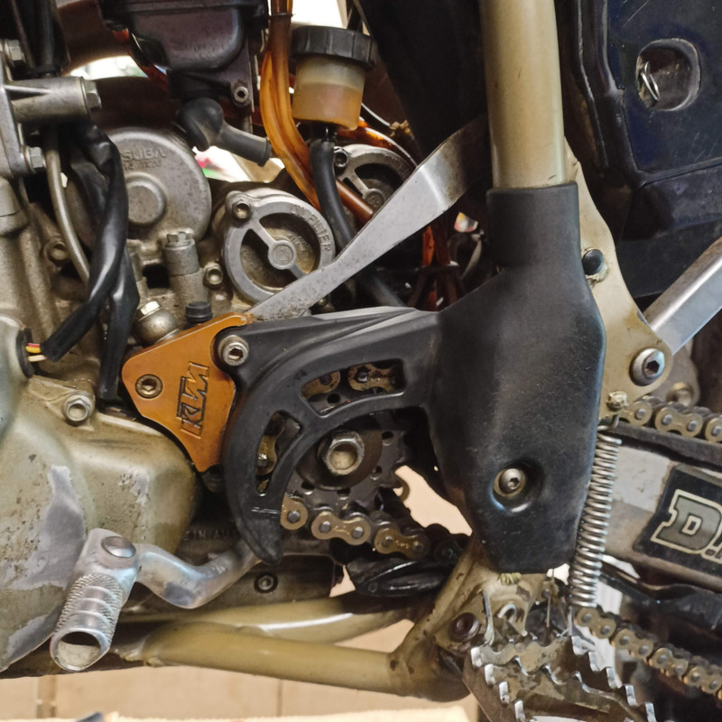

Interesting on the sensor side of things. Looks like an IFM one (orange cap). That's the kind of stuff we manufacture and I try to sell. What size is the target? I'd have thought it was specced as an M8 for the target size. Generally speaking your on/off point is related to target size and the physical coil inside the sensor.

Sorry Col @tricol , only just seen this- RE the sensor, if by the target you mean what size is the magnet that is attached to the disc, then it's only approx 5mm dia, way smaller than the surface area of the sensor itself- you can see the magnet earlier in this thread in a pic above where I'm holding the sensor.
And this is the (highest quality I'm sure :D ) exact item in question

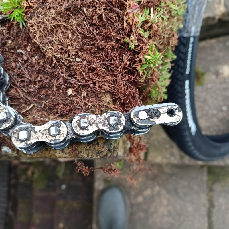

Why I say it was strange and fortunate, was that is was ~70 miles into the ride, right at the end and happened on the final ride back to the van at the end of the day, bimbling along the (tarmac) road at 50ish under next to no load when we were less than 1/2 mile from where we left the vans.
It was the split link that failed, but not, as you would think, by the retainer becoming detached, but the backplate of the link actually snapping :?
It had been a faster than usual day for us with a good few really gnarly rocky climbs, so I was just a bit surprised that it failed where it did.
Anyway, fortunately, it didn't lock the wheel, do any damage, or cause us any hassle as I just about coasted to the van, and the chain isn't that old so after a nice new £4 DID link, she's good to go again 8-)

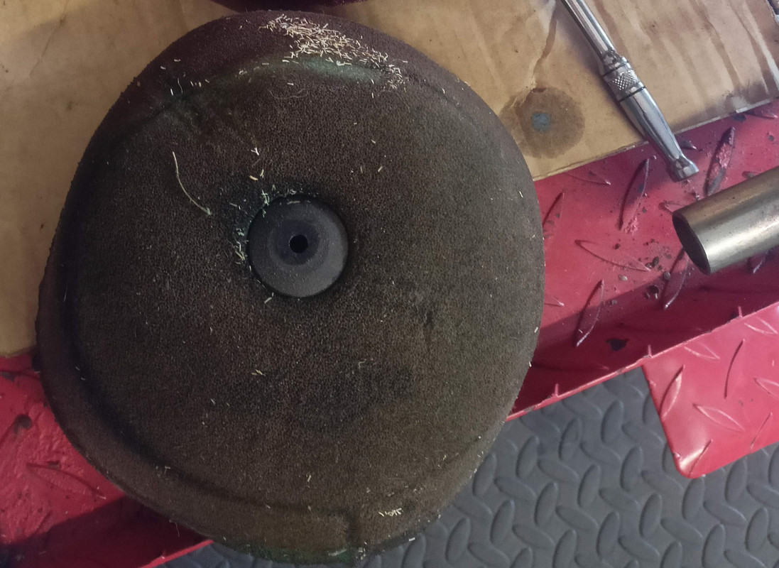

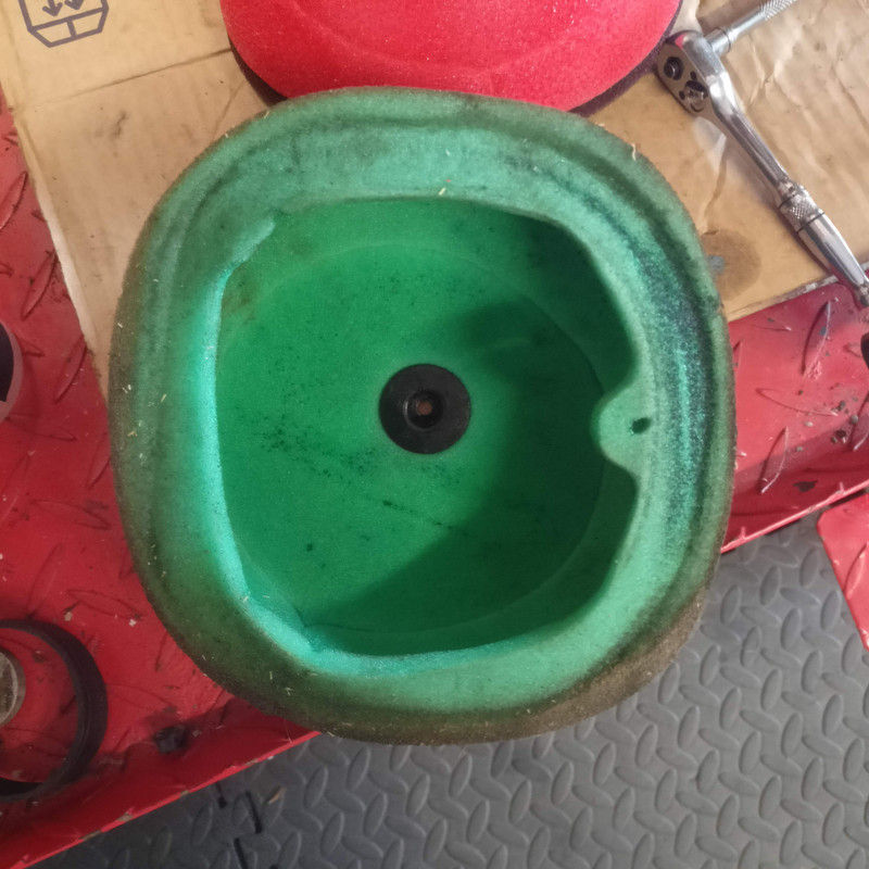

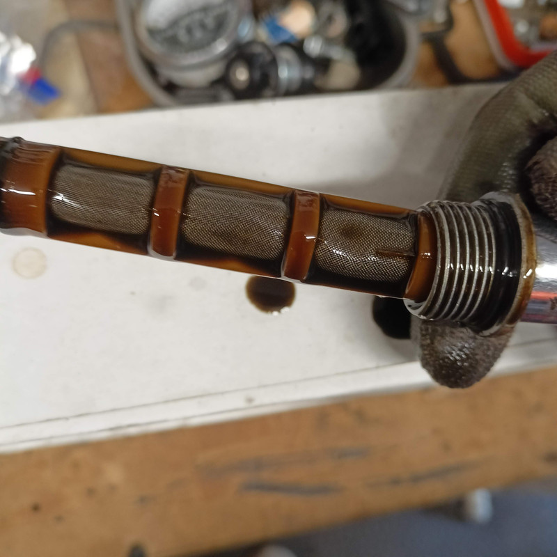

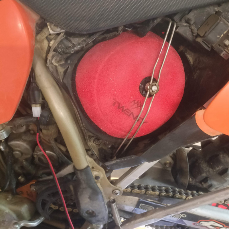

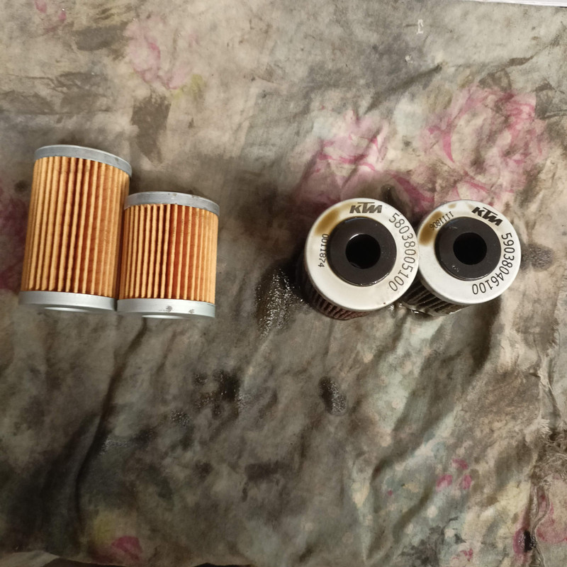

It’s been a while since I’ve posted anything in this thread, since I got the TE300 a few weeks back the trusty old orange bike has been unused, but I’m out agin in a couple of days time, and although the old girl is clean and had a chain and sprockets a month or two back, I haven’t changed the oil or filters in over a year so it’s due.
Unlike all the current KTM/Husky 4-stroke singles, the old RFS motors have two paper element oil-filters in addition to the sump oil screen- they still only hold 1.25 l of oil, but maybe that’s at least part of the reason that they are so reliable.
Anyway, it’s all dead easy to get to, I just whip off the (KTM original 20 year old and made to last) sump bash plate before I do it so it doesn’t get full of oil.
Am pleased to report that despite the oil looking dirty, there wasn’t a hint of any metallic stuff in there, not that there ever has been, but I always check as the way the gearbox gets treated , it wouldn’t surprise me if there was….
I also popped the side panel off to clean and re-oil the air-filter, but it was in such an embarrassingly shitty state I decided to treat it to a new and freshly oiled one-
Old :o
(what is good to see though is how nice and clean the inside of the old one was- it’s been doing it’s job eh :-) )
And the nice freshly oiled new one installed :thumbup:

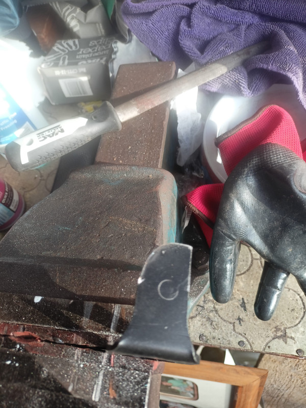

The side plates snapped completely through a ( non-joining) link, meaning it wasn’t fixable with the tools we carry, but luckily we weren’t too far from someone’s mate’s mate, and he and his angle-grinder were at home, so one of the boys raced over there with the broken chain and 30 or so minutes later he was back and we were re-fitting the chain with a new split link, and on our way again :thumbup:

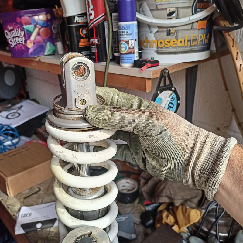

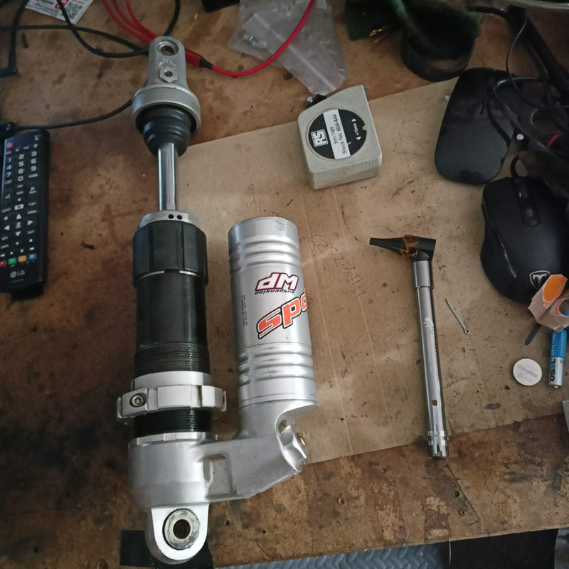

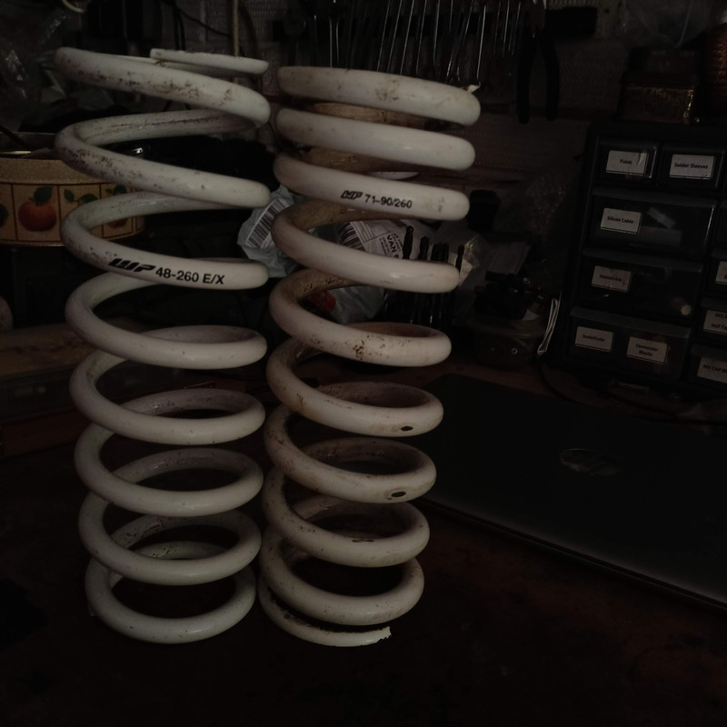

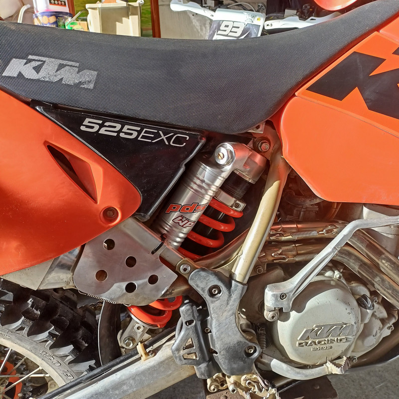

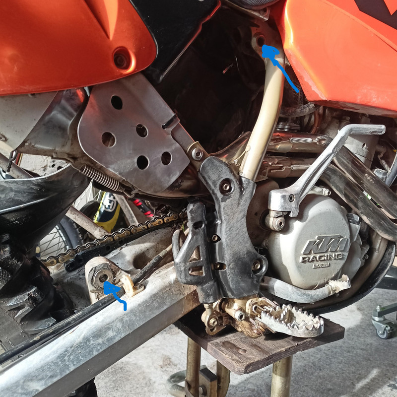

It wasn’t all roses though- having taken the TE300 on the last few rides (with its now nicely set up for me suspension ) and really got used to it, jumping back on the 525 was an interesting contrast.

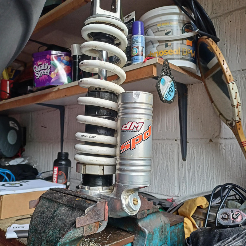

The rear shock is the original and has never been serviced, or even removed in the bike’s 20-year life, so it’s still wearing the standard OE spring, and although I’ve felt it was fine for all these years, if perhaps a bit on the soft side, it hasn't bothered me enough to change it.

If anything, the rear shock is even easier to remove than on the Husky- you just remove the bolt at each end of the shock and it slides out between the rear wheel and swingarm- you don’t have to remove anything else- a total of two bolts to remove and it’s out- cool eh!
And once it’s on the bench, removing the spring really couldn’t be easier- same as with the Husky ( surprise surprise eh as they’re both WP shocks...) you just wind back the preload allowing the spring to drop a few mm from the top collar, drop the collar exposing the little wire clip and pull it off ( oo-err missus ) with your fingers
And after a squirt or two of GT85 the shock is ready to package up and send off for servicing.
I have to say, the thrifty side of me was sort of thinking why bother, as it isn’t leaking, still feels very well damped and all the adjusters work well, but the other side of it is that the oil, nitrogen, seals, and bushes etc in there are 20 years old, and am sure are getting close to being, if not already, past their best
So, what to do about the spring?
This is what WP calls one of their PDS Shocks.
It differs from the ones fitted to the current range as it's designed to not be used with a linkage, and as a result also wears a variable rate spring, to try and give a bit of the rising-spring-rate functionality that a linkage can, and typically does
Putting the PDS spring side by side with one from the TE300 ( which has a shock linkage), you can see the difference- although the springs from both bikes are the same length and diameter, they are otherwise significantly different.
The one I’ve just removed from the 525 is on the right, it’s the standard one that came with the bike new and has a variable rate of 71-90 N/mm
The one on the left is the standard one I removed from the TE300- a linear one with a 48N/mm spring rate.
Going from recommendations in the books, I reckon the PDS7 (76-95 N/mm ) spring will enable me to get the sag in the range I need to. These springs have been discontinued by KTM /WP and seem a bit harder to get hold of, with a couple of places advertising them that I’ve tried so far saying unable to supply- the easy and cheap way would be to fit a 95(ish) N/mm linear spring, but that would remove the little bit of rising-rate functionality the progressive spring gives, making it a lot harsher and definitely be a backward step over what I currently have IMO so it’s not going to happen, I just need to look a bit harder.
Anyway, that’s it for the moment, more to follow once I find a suitable spring :obscene-drinkingcheers:

Well no PDS springs in sight ( in the UK anyway) and talking to one or two people more experienced and knowledgable on these older PDS-shocked KTMs meant that I changed my mind, and ended up purchasing an 85Nmm linear spring (KTech do a nice orange one specifically for this shock , which is nice :) )
I had to put a good 15mm or so more preload on it than I was anticipating to get it to where I thought it should be so was slightly concerned that I'd gone too soft, but since then I've had a full day out on it and am very very happy- for the sort of terrain and pace I ride, and particularly when the lanes are as slippy as they are currently, it's the bike I want to be on.
So much so that this, and the fact that I really could do with more space for the recently purchased (non-muddy) latest project bike means that there isn't currently a place in my life for the old faithful's younger and undoubtedly sexier sibling, so as of yesterday the TE300i is a goner and I'm back to just the one muddy bike, my favourite one- we're next out this coming week-end, and it's going to be a bit nippy I think, but I can't wait.
She's definitely a keeper :thumbup:
