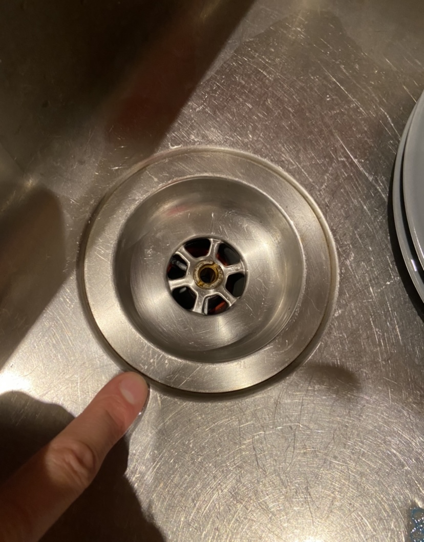

Right, sink started slowly draining again, put some Buster Kitchen Plughole Unblocker https://www.google.co.uk/shopping/produ ... rmr:1,cs:1
Flushed with loads of hot water, now it’s leaking when it’s filled over the plug insert (where my finger is pointing to amd it’s also turning (able to spin)
It’s leaking from the black rubber gasket thing under the sink.
Has the sealant dissolved or what? Does it need a new seal?

Unscrew the right angle bend at both ends, remove it, and you'll find a screw that will enable to tighten the bit you are pointing at down. That should stop the leak.
Posts: 3718
Has thanked: 1059 times
Been thanked: 1646 times
Re: Kitchen sink round 2
Wife sez, check the rubber seal is in the right place and tighten the plug hole up.
You could smear a little silicone sealant on the rubber seal as well.
Hold the underneath and use a large slotted screwdriver to turn the centre part with the two slots in it.
Usually anyway.

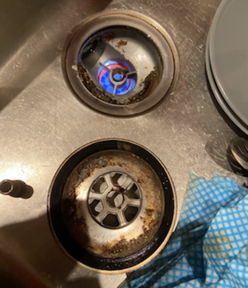

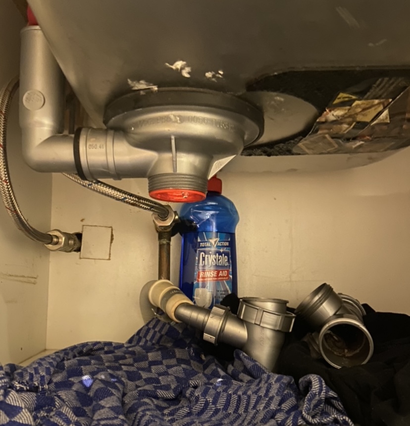

Right got this off, do I need to add silicon or just clean it
CBR650r :mrgreen:
Posts: 5041
Has thanked: 781 times
Been thanked: 1072 times
It looks to me the bit you need to seal is still attached to the sink waiting to be removed. I'm no plumber so treat my advice with contempt.

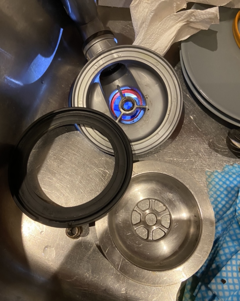

Taken the rubber gasket off, can’t really see any trace of sealant before
CBR650r :mrgreen:

It may just need a clean up and reseating, you probably disturbed it before and broke the seal. The sealant will help if the rubber has aged and doesn't work as well as it should.
I fixed a leaking tap a couple of weeks ago just by descaling the internal bits, you don't always need difficult or expensive remedies.

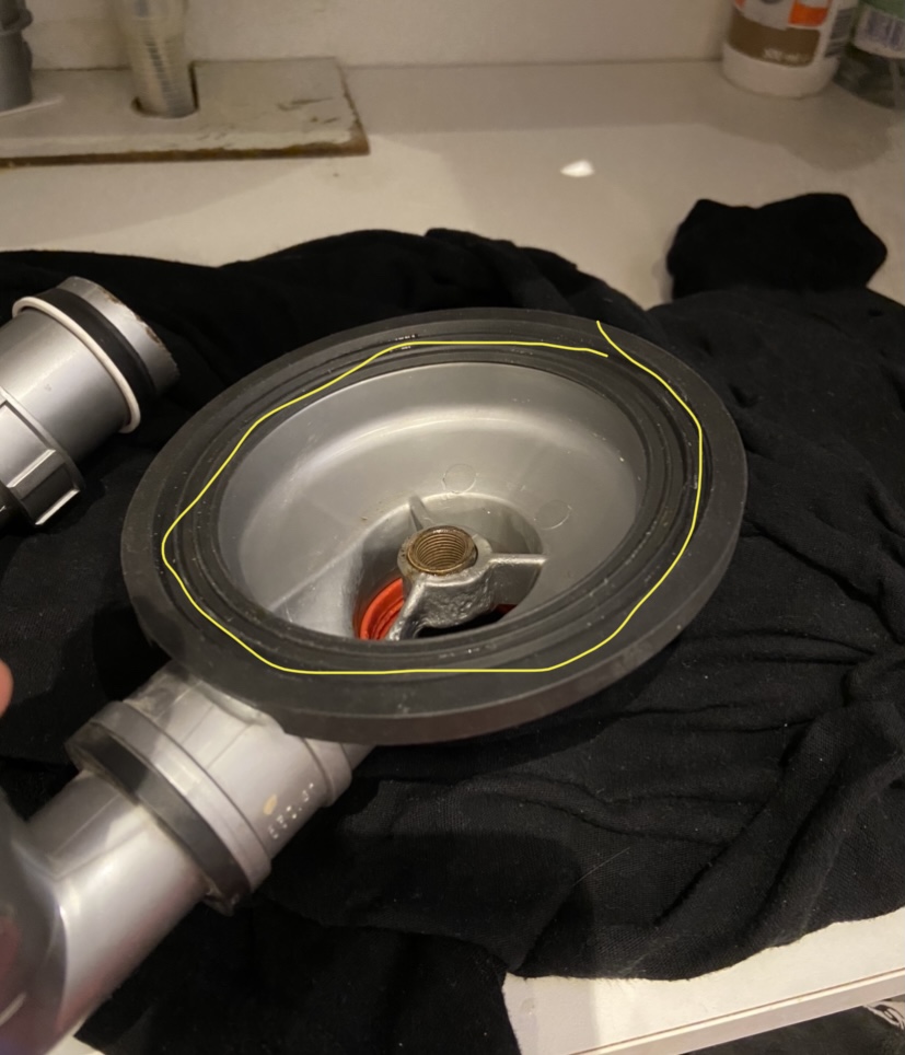

Right so I have it a cleaned and removed the gunk, put it back together but it’s still leaking form the circled bit, I’ve used a screwdriver to tighten the bolt that hold the plug in, and still the same,
CBR650r :mrgreen:
formula400
Posts: 1924
Location: London
Has thanked: 482 times
Been thanked: 1045 times
Post by formula400 »
Should I put a bit of silicon around where I have put the yellow line?
CBR650r :mrgreen:
Posts: 5041
That's what I'd try but I'd only give it 50/50 chance of working.

formula400 wrote: Sat Nov 28, 2020 6:27 pm Taken the rubber gasket off, can’t really see any trace of sealant before

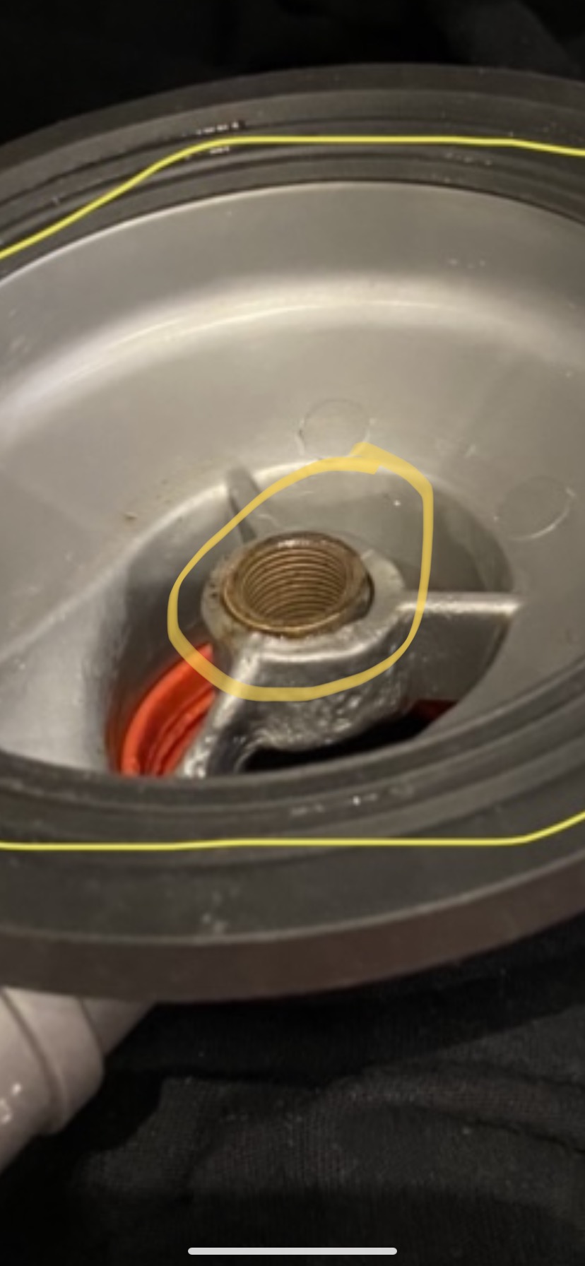

Is there rubber missing from the outer ring or is it supposed to be like that?
chillitt
Posts: 216
Has thanked: 147 times
Been thanked: 169 times
Post by chillitt »
Id put just a smear on both sides of the rubber washer, put it back together do the screw up enough to seat it properly then tighten it up fully once the silicon has set. Dont put any on the metal bit that goes on top. (NB Not a plumber)

This looks like it melted and deformed, could that be why it’s not tight and letting it leak??
