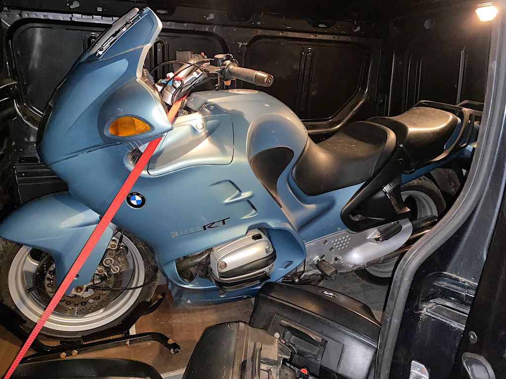

Not so much salt on the roads so the 2cv is mot’d and out and about in its new home in Norfolk. However was driving it the other day with the roof down, uphill and into a head wind and struggled to go much over 50 so it’s upgrade time, when I get time.
Donor engine obtained…
It’s a 2001 r1100rt with 40k on it. Pretty tidy although that doesn’t really matter and the engine sounds perfect, really quiet and smooth. Got it for £500 because the gearbox is broken and I don’t need that.

Is the 2CV motor going into the RT? :D
