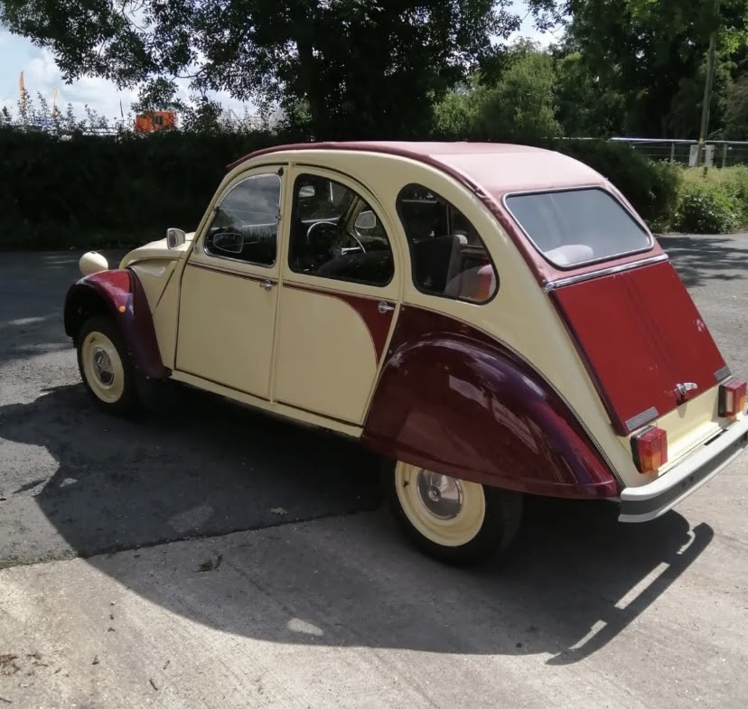

Hopefully this is of interest to some of you but I'm quite happy chuntering away to myself.
I bought this yesterday...
It's had all the rot cut out and replaced with new panels and then blown over with some pretty good paint. It sits on a galvanised chassis and underneath looks amazingly clean. These cars definitely require looking after which I didn't do with the one I had 30 years ago which probably explains why it's no longer on the road. This one was used as a wedding car before it was taken off the road to sort all the rust out. I posted up a picture on the 2cv facebook group and the previous owner got in touch telling me about the car and telling me good things about the guy who did the car.
I drove it home yesterday afternoon and the current to do list is...
- Car pulls hard to the left when braking hard which is pretty scary. I can't yet tell if it's the front discs or the rear drums but I'm going to guess that it's the front given how hard it pivots. All the hardware looks pretty new so I'm guessing I'm looking a seal (can't see any oil), contaminated pads, stuck piston, something like that. The pedal feels hard so I don't suspect air at this point.
- The revs sit high sometimes when I come to a junction and when I got home I found that the choke cable had disconnected so the choke is just wandering around on its own so that's an easy fix.
- The indicators are very slow so I'll check the voltage and wiring.
- It leaks in heavy rain but that's just the way they are.
- The windscreen washer 'system' is shit and needs upgrading to a pump rather than a plunger.
- The hose from the air filter box to the carb is perished and needs replacing.
- I need to make a platform for the back for the dogs.
I suspect this list will grow faster than it shrinks.
Good times.

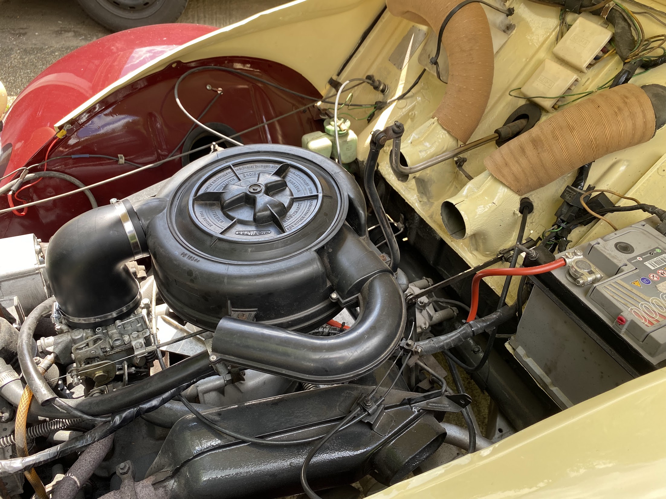

Small update today. The great thing about these cars is that it's possible to do simple stuff very easily over a lunch break.
Jobs done today were...
- Install a new positive battery lead. The old one was frayed and definitely going to cause a problem at some point. It simply runs from the battery to the starter motor and then onwards to the loom from there. The starter motor end was frayed so if that had snapped the car would stop and the lead would just short out on the engine.
- Install a new hose from the air filter to the carb. The old one was cracked and falling apart. It didn't cause a huge issue with running but pulling all the air through the air filter is always a good plan.
- The choke cable came adrift on the way home so I reinstalled and secured that.
I can't see any immediate issues with the brakes so need to do more digging. I can push the pads back and they all move freely back to the callipers and then back to the discs when the pedal was pressed. I was expecting one to be stuck but that doesn't seem to be the case. I'll have a closer look at the weekend if I get time.
The rear view mirror vibrated but there doesn't seem to be a way to stop it as the adjustment ball joint is a bit loose so will order a new one. I fixed it in the short term but turning the mirror upside down and it doesn't vibrate in that position. The dip switch no longer works but it'll do for now.

Re: 2CV6 Project Thread
That looks very clean!
Good luck with the brakes. Could be anything, maybe even a tired flexi-hose.
