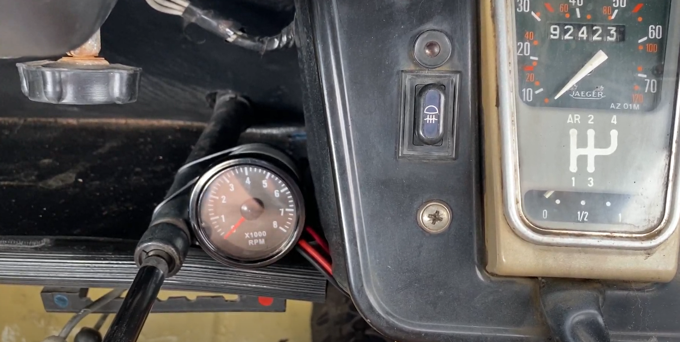

Also fitted a tacho because I wanted one...
Screenshot 2023-08-07 at 10.59.56.png (1.38 MiB) Viewed 2755 times
It's a bit heath robinson at the moment but I'll tidy it all up at some point. Interesting to see what the engine is doing though. It's routine to take the engine all the way to 6k before changing up and cruising flat out is at 5-6k. Earplugs are needed for long journeys.

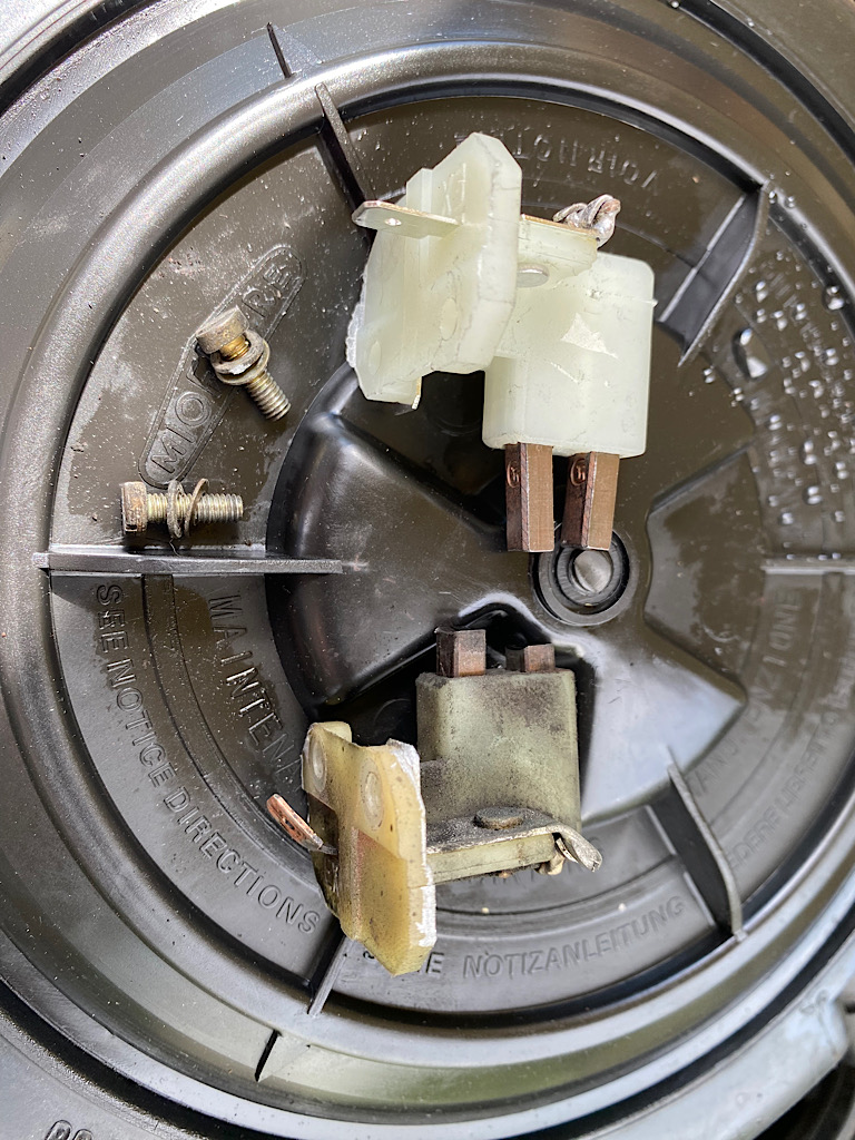

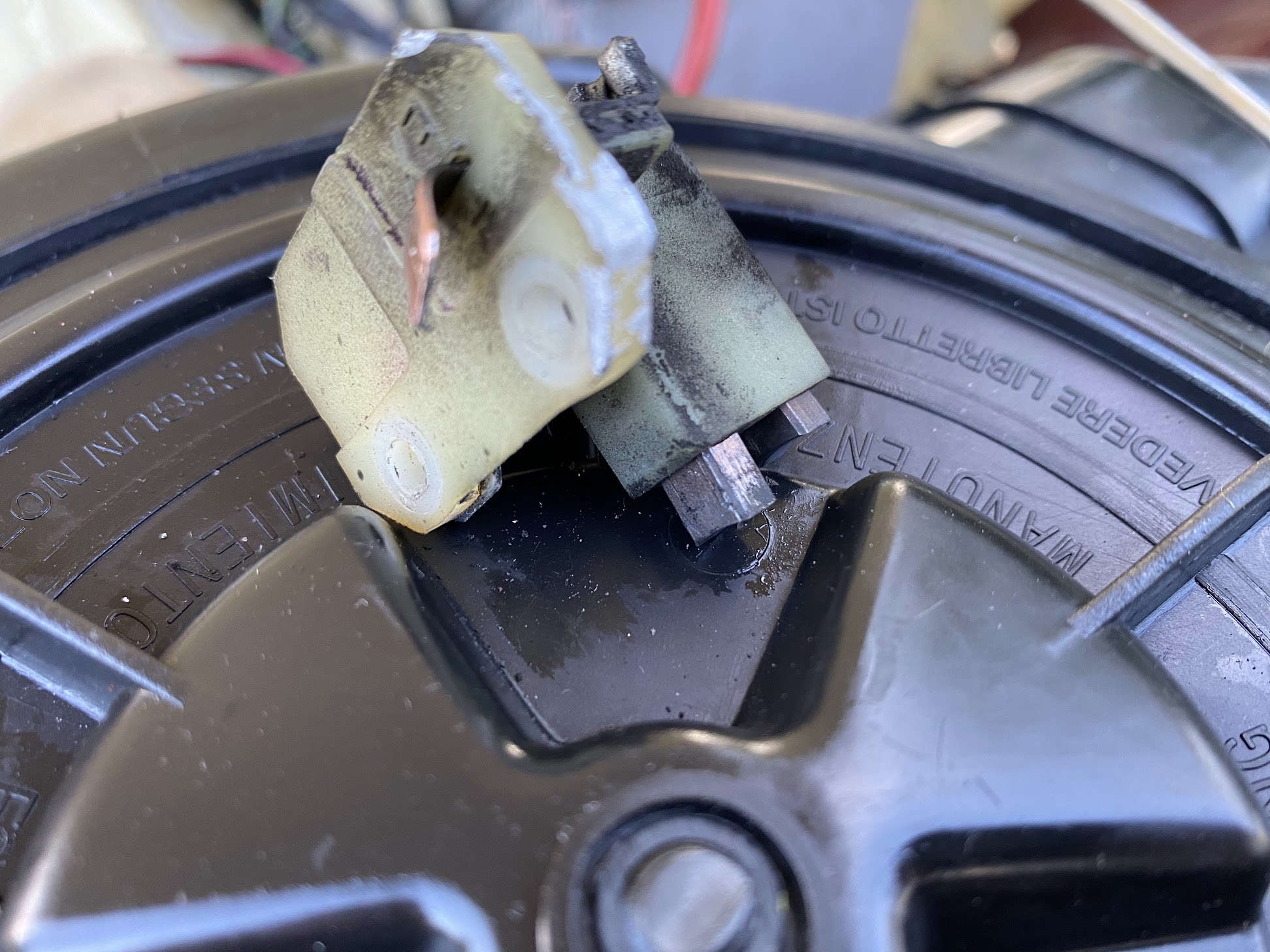

The job for this lunchtime to make the most of the unseasonably dry weather was to replace the bushes in the alternator. The battery wasn’t charging reliably and everything else looked ok so pulled the bush holder out and found they were very worn indeed. New bushes installed and the battery is charging again.
Bush comparison…

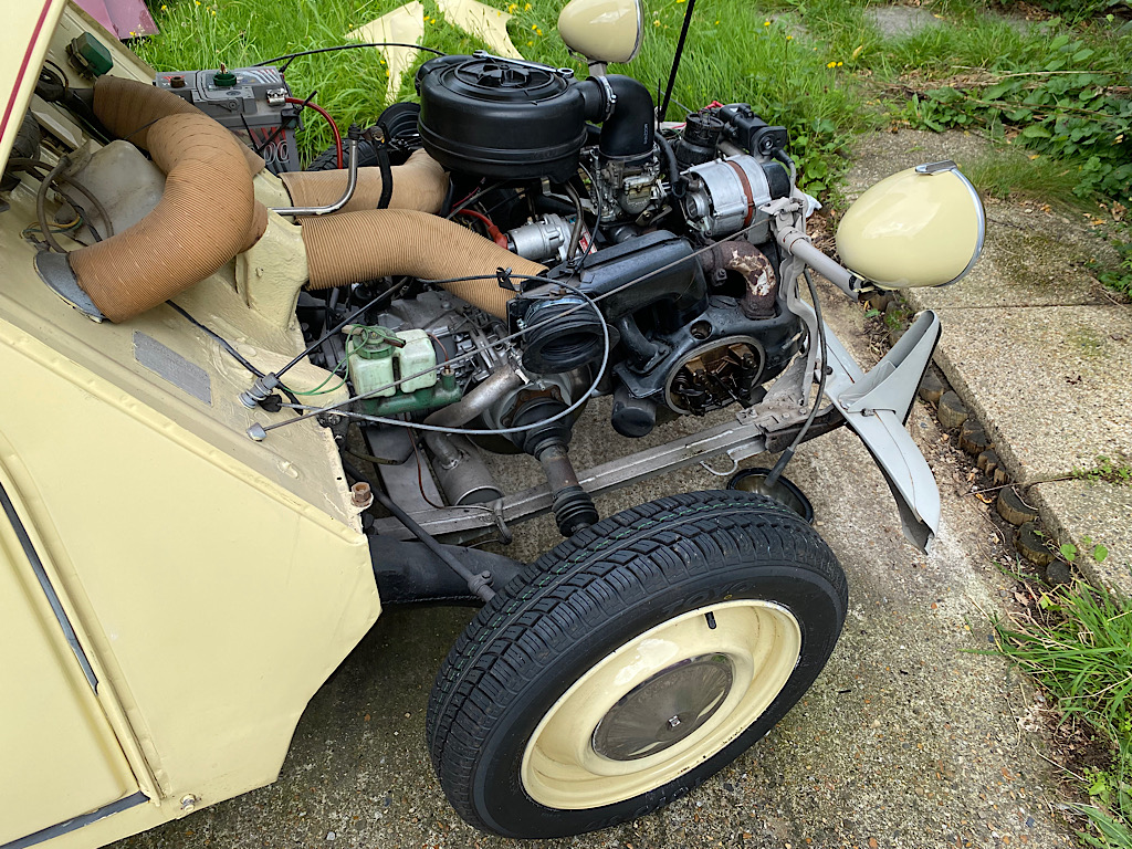

Bit of a service today. Oil and filter and checking the points and valve clearances. Oil was pretty mucky but it doesn’t stay good long in these engines. Points gap was fine but the valves needed adjusting. No pattern to it really, just small adjustments and the engine is running more quietly now and both sides of the engine sound the same.
It’s very easy to take the bodywork off to get to the valves and generally makes working on the engine a lot easier.

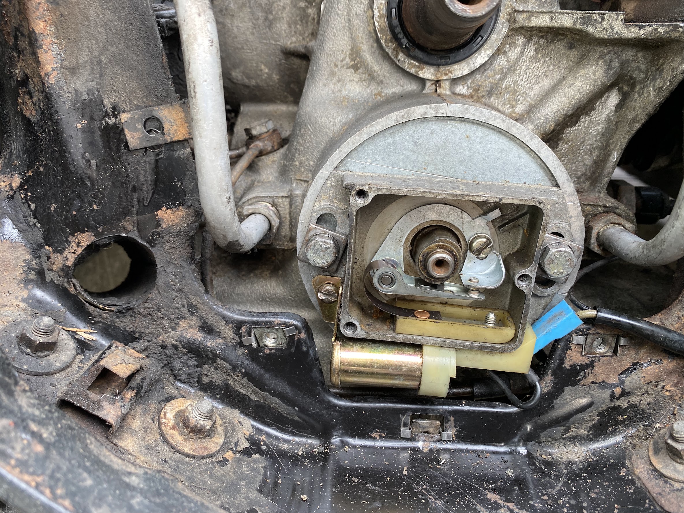

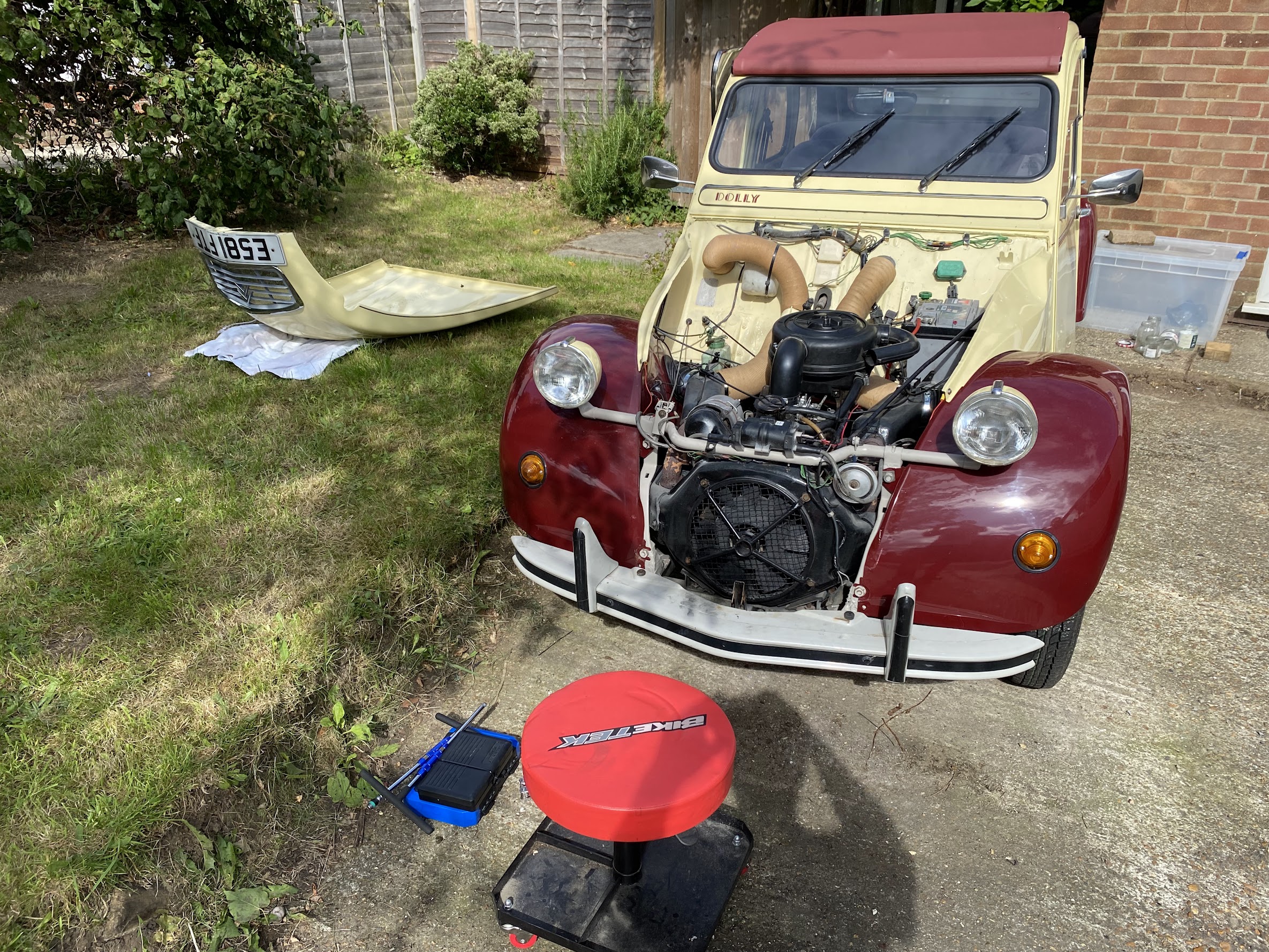

Decided to replace some parts to increase reliability and improve starting.
First job was to take the bonnet off and reinforce the leading edge that the catch bolts to with fibreglass. This flexed too much for my liking.

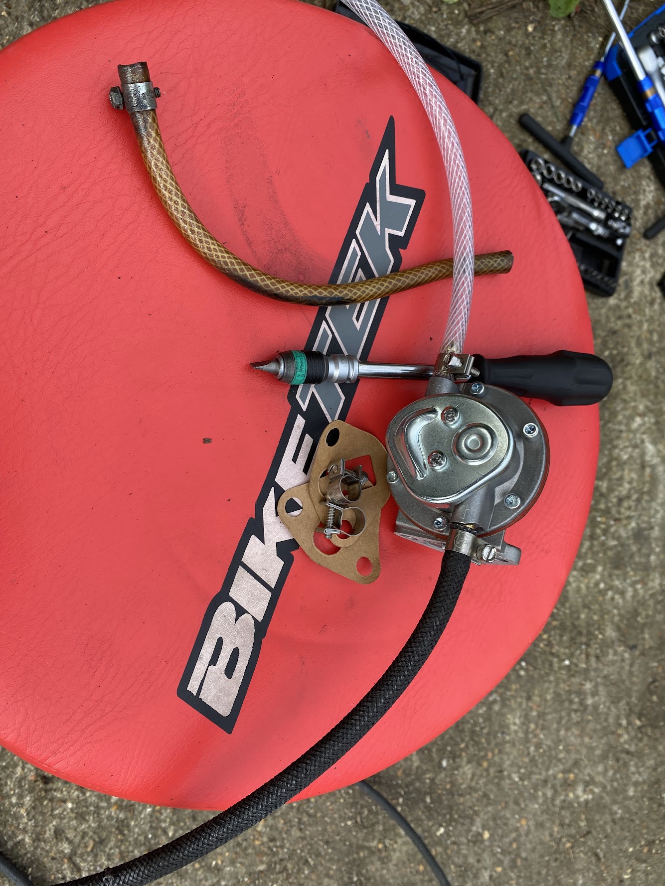

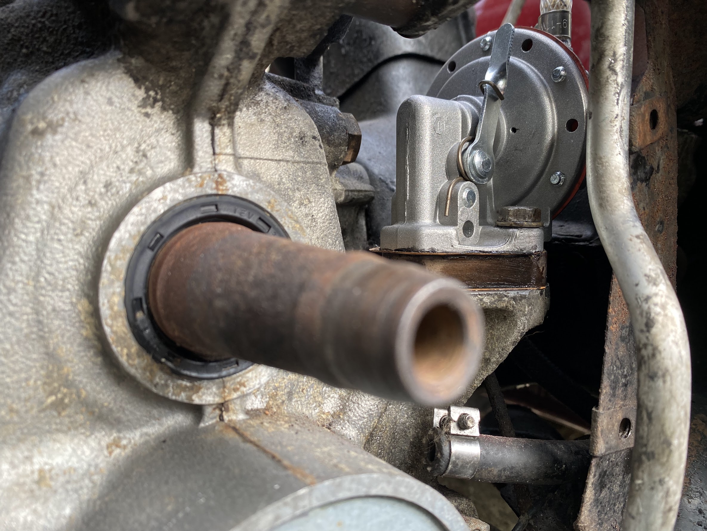

Next job was the fuel pump. I'd noticed that there were some air bubbles in the fuel line just before the carb so bought a new one. It's a mechanical pump that runs off a cam on the camshaft that pushes a rod which actuates the fuel pump. I fitted a version that has a priming lever which is kind of neat I think but probably not needed. Does make priming easier and the fuel can drain back to the tank if left for a while.
dern
Posts: 2538
Has thanked: 1183 times
Been thanked: 2277 times
Re: 2CV6 Project Thread
Post by dern »

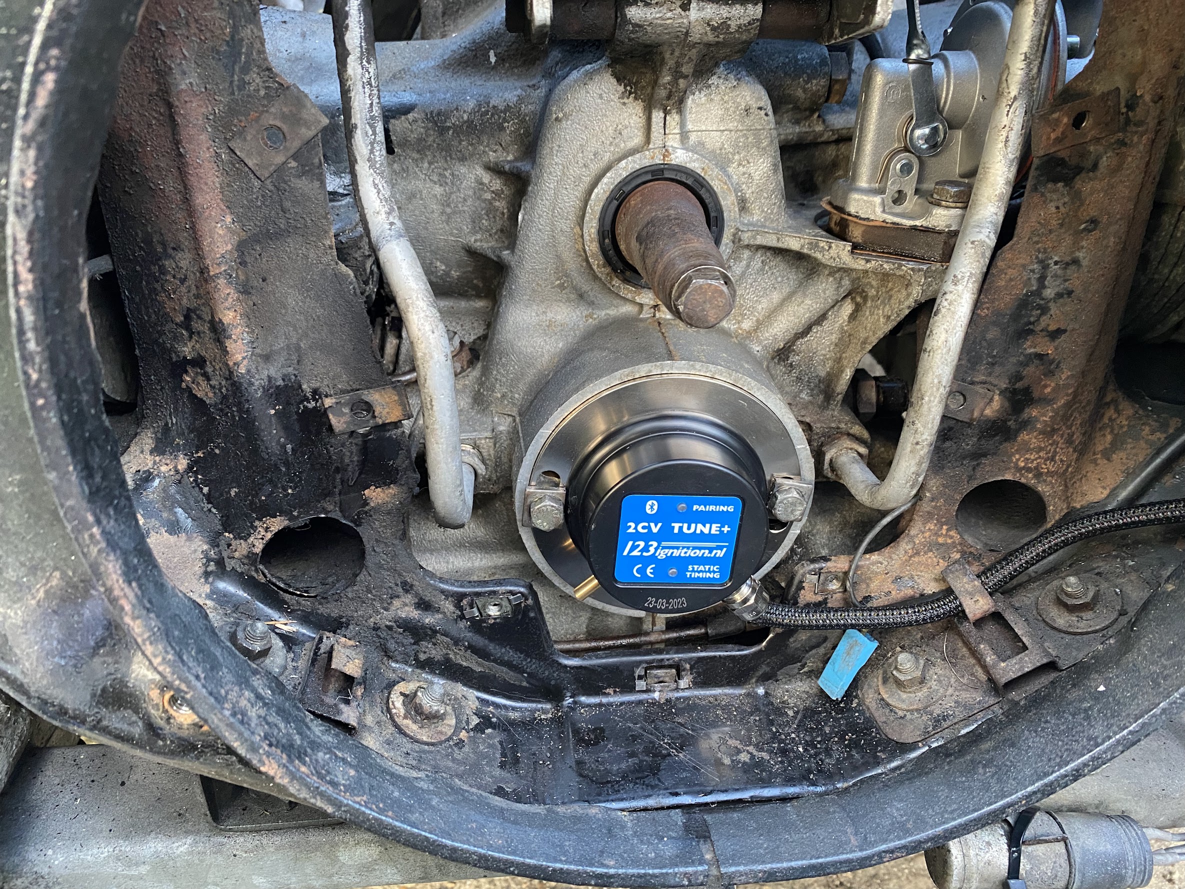

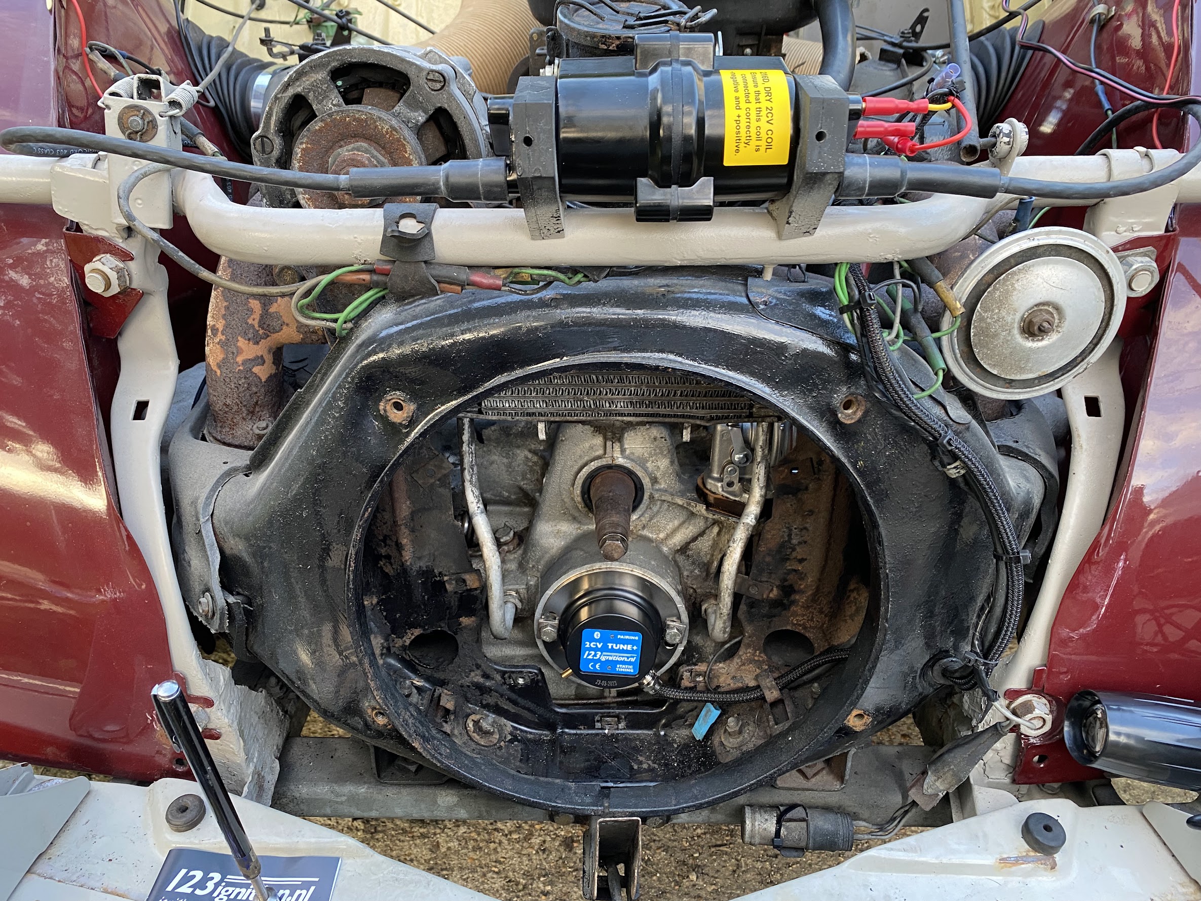

Next job was to replace the old contact box with an electronic ignition system. It does away with the contacts and the centrifugal advance system and instead has a couple of magnets and a hall sensor to detect engine rotation and handles all the ignition and advance. You can also pair a phone to it and through their app you can see a tacho, voltage, current drain, unit temp and the state of the advance. You can also edit the advance graph if you want. The last thing it does is that you can put a pin code in the app so that the car is immobilised until you put your pin in.
I also replaced the coil and the HT leads for good measure. Starts immediately now whereas before it wasn't that keen.
That ignition is cool....it's like the Boyer boxes fitted to a million old bikes, but more advanced. Maybe I should get one :D
