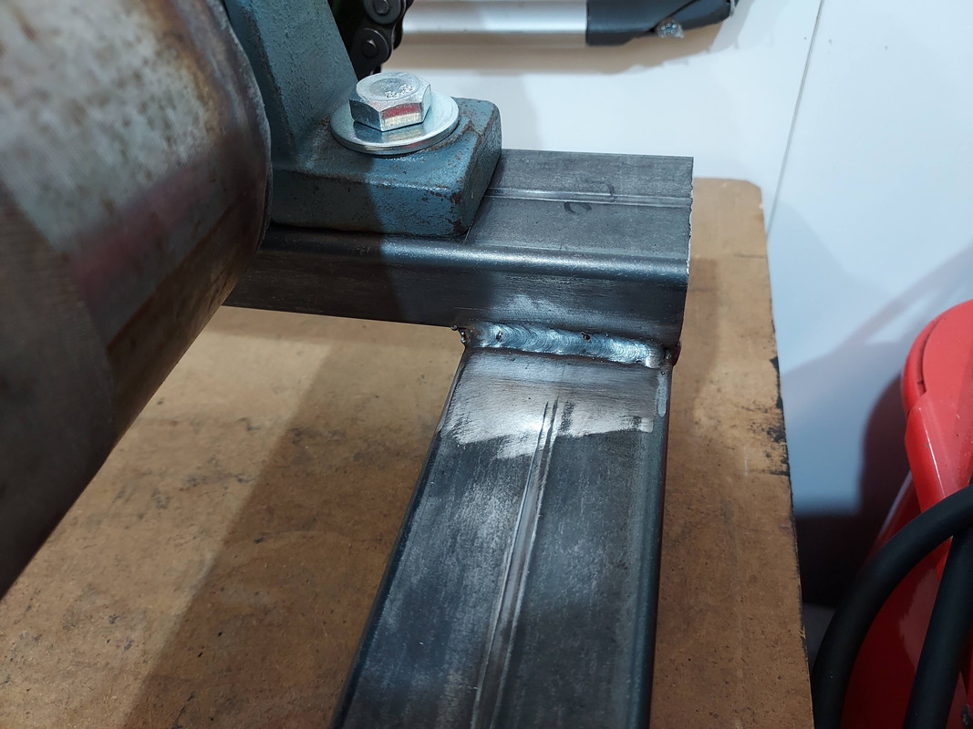

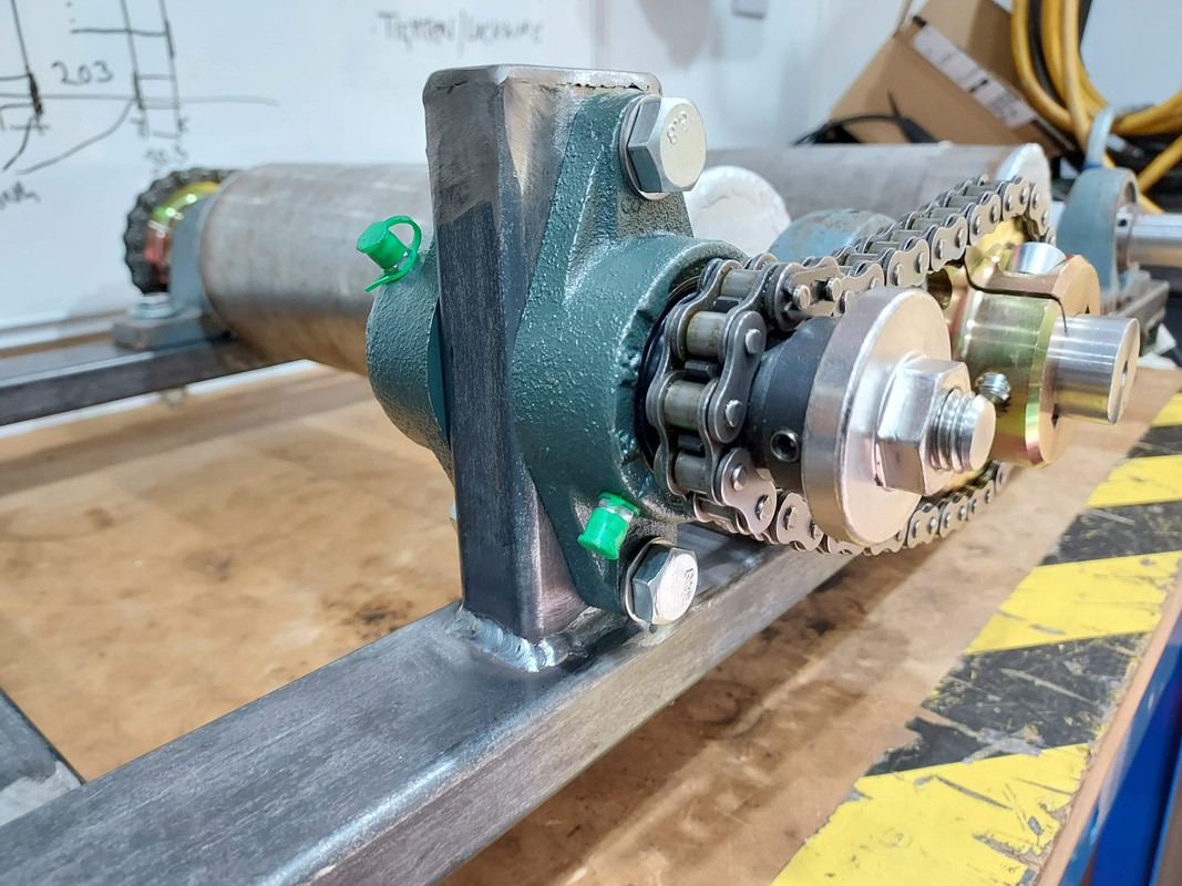

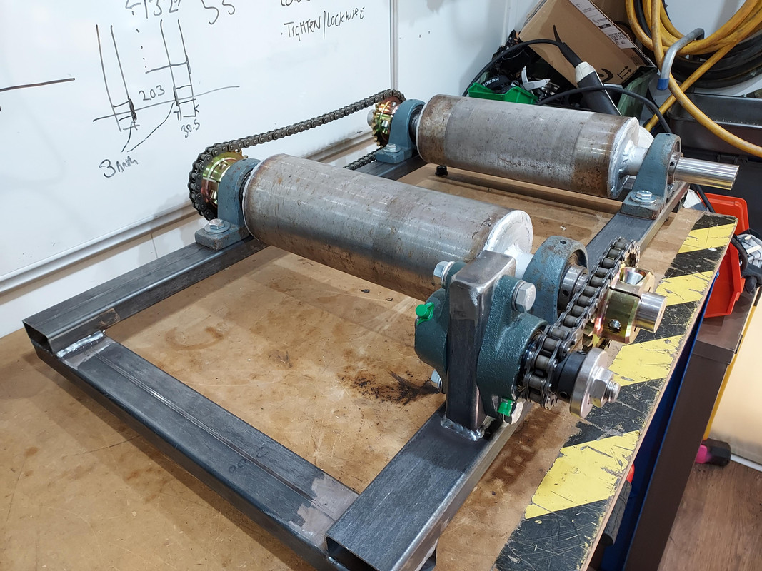

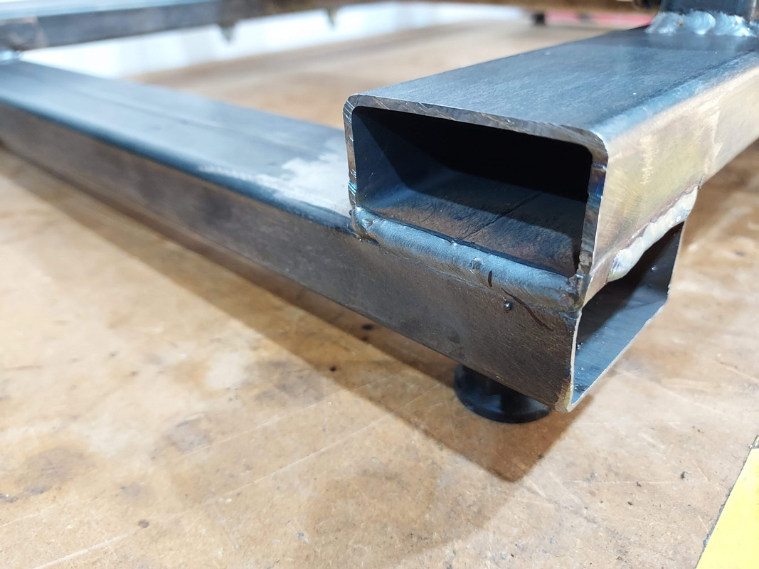

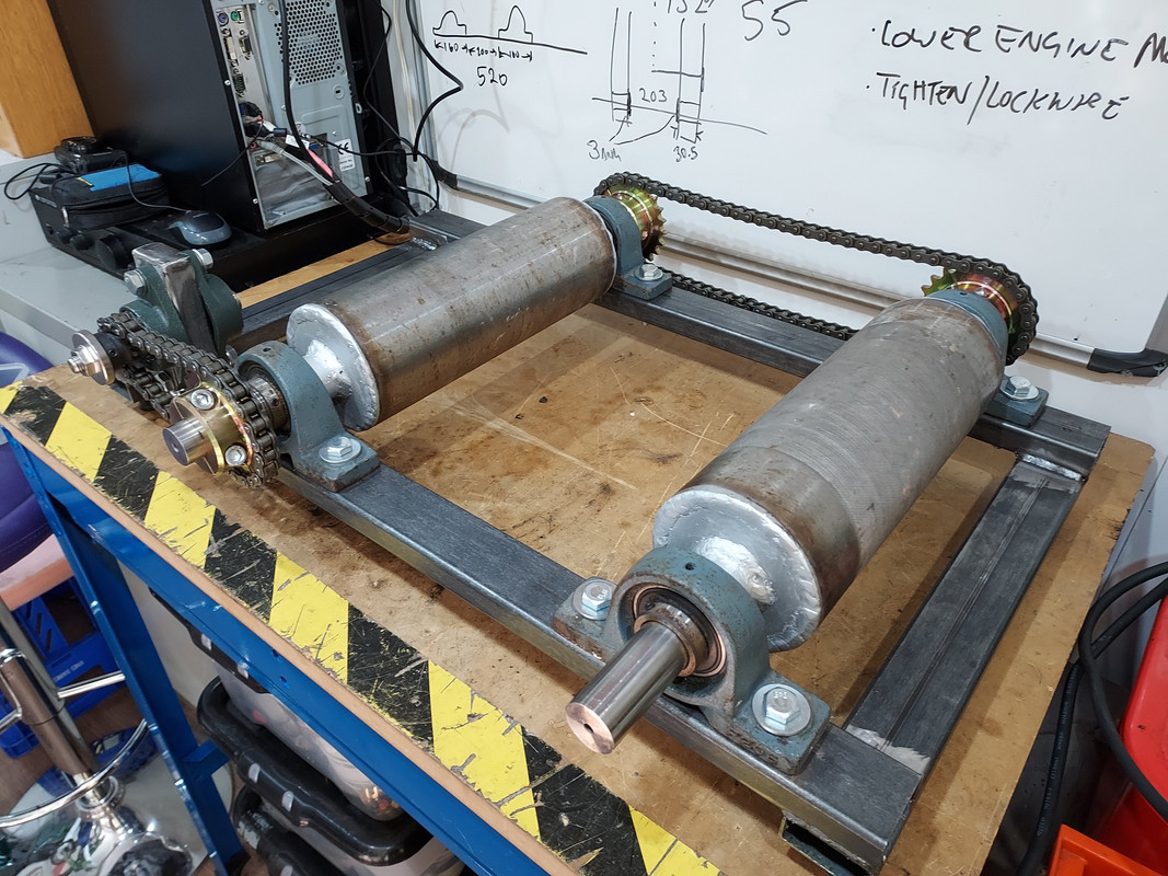

Welded up the frame today, argon/5% CO2 is so much nicer to use than pure CO2. Bearings all bolted down and chains on. Fitted some adjustable feet to the bottom and then gave it a spin up with the angle grinder. Fucking scary thing. Chain guards and brackets for the grinder next.

Nice welds! :thumbup:

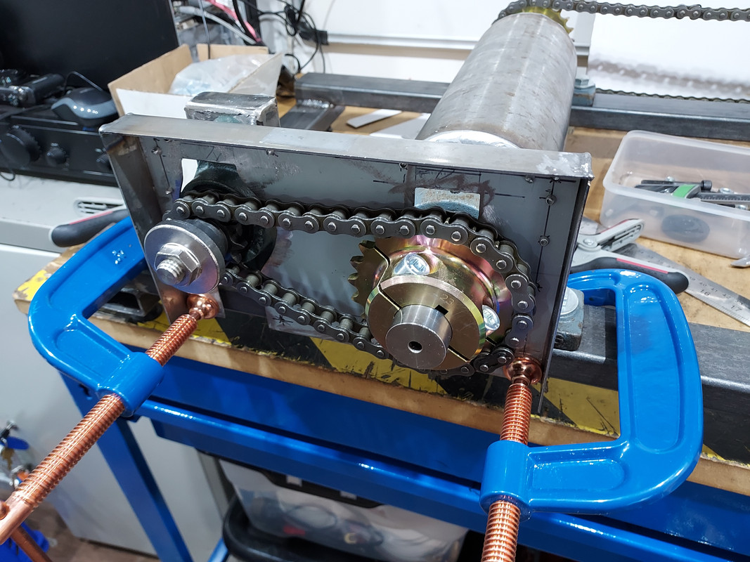

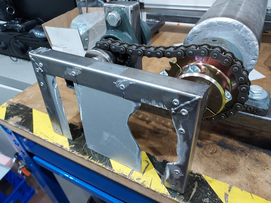

Made a small start on the chain guards today.
They need to be two parts. The back bolted to the frame and the front bolted to the back.
