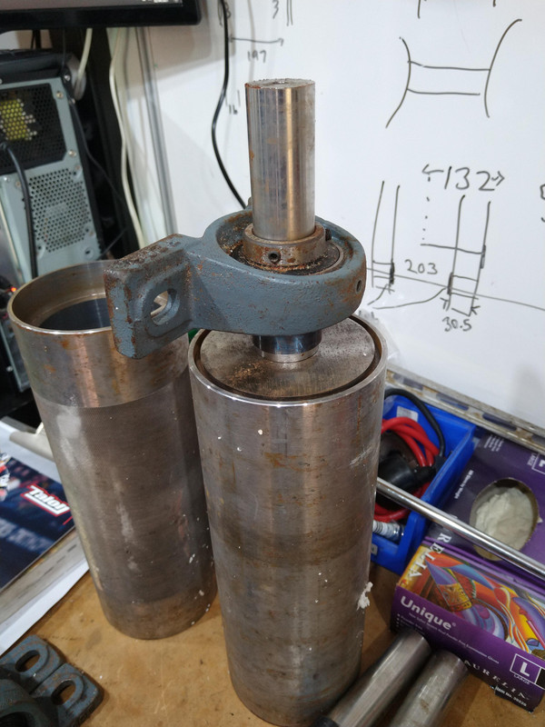

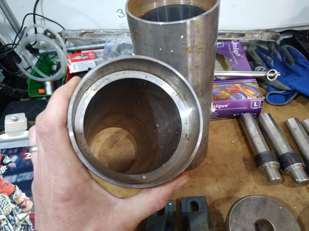

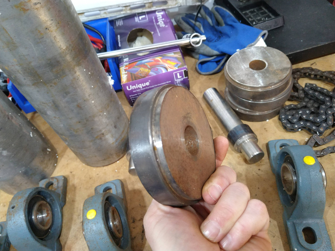

Just picked these up on eBay very cheap. The guy had a local engineering firm make up the parts and then they sat in his shed for years. He's also thrown in some chain and sprockets that he forgot to include in the advert. So the plan is to drive the rollers with either a 9" grinder and remote switch or a small engine with a centrifugal clutch...then use it to start the bastard KX500. The end plates need welding onto the drums and the shafts and I need to knock a frame up to mount it all too.

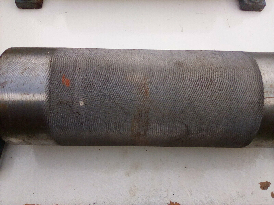

One of them is knurled. I've seen the rollers in metal, polyurethane and rubber coated. Well suck it and see. They seller had planned to use a 24v van starter and connect it direct to his race van, but a crash in an Irish road race changed his plans. Hence the parts being stuck in a shed all these years.

Fookin' hell they've been properly engineered. Heavy and well made rollers and shafts.

That knurling looks a bit superficial - I'd coat it with grit.

iansoady wrote: Sat Apr 03, 2021 10:17 am That knurling looks a bit superficial - I'd coat it with grit.
It's better then it looks in the photo. Skateboard grip tape is my plan if it starts slipping.

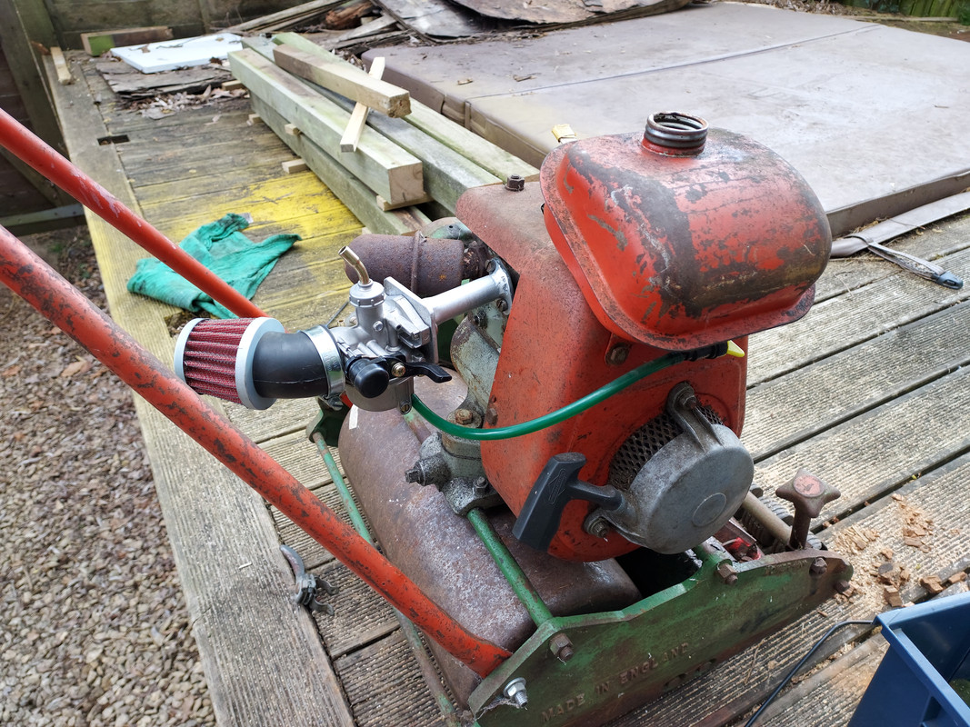

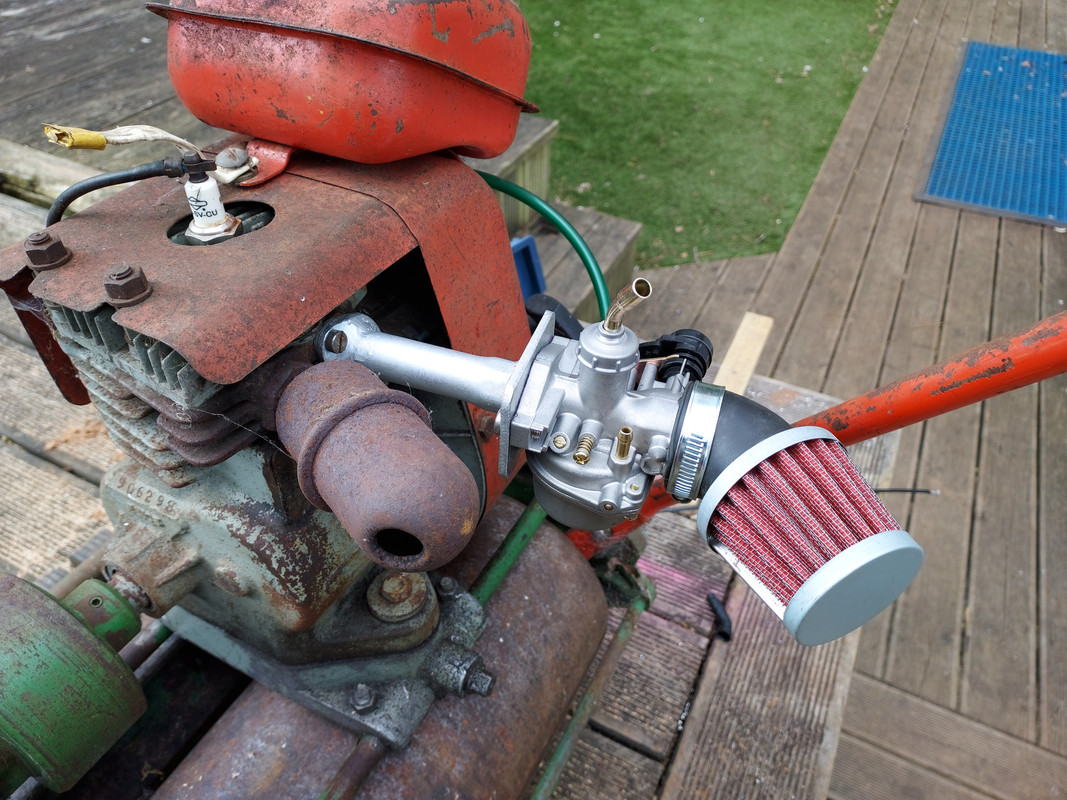

Right, so I dragged the Suffolk Punch mower out and welded up an intake manifold out of some 4mm plate and some steel tube. Attached a carb off a pit bike and it runs great. It's got a centrifugal clutch so it could be a goer if I can sort out a bearing mount for the shaft. It's also got a bunch of chains and sprockets in the end plate that might be useful.
