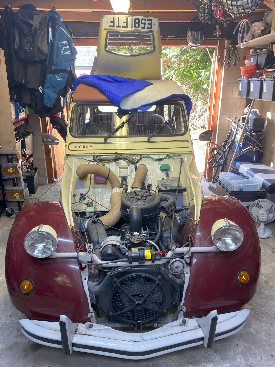

Getting there…

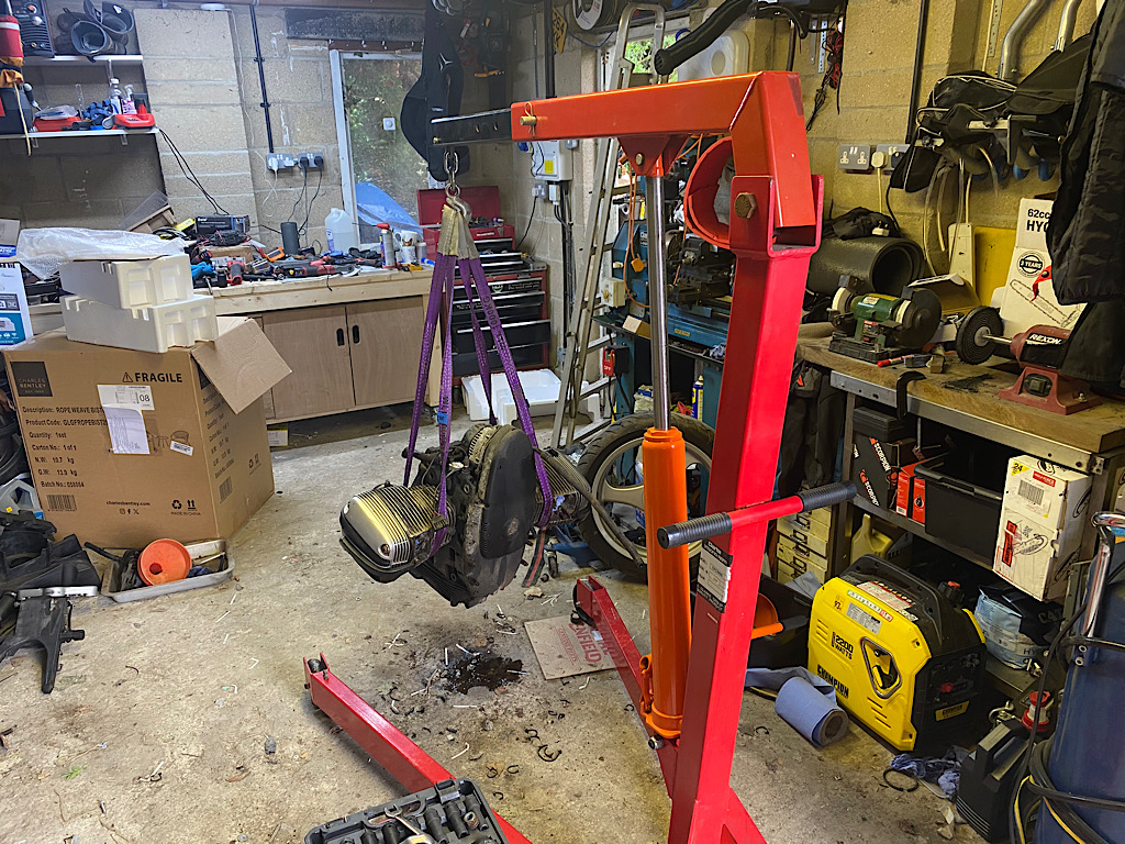

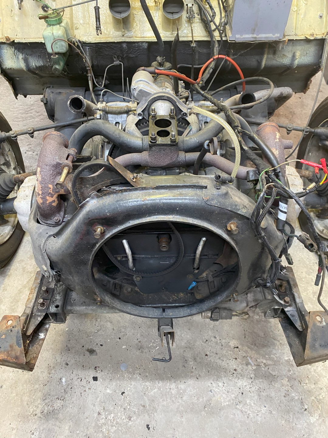

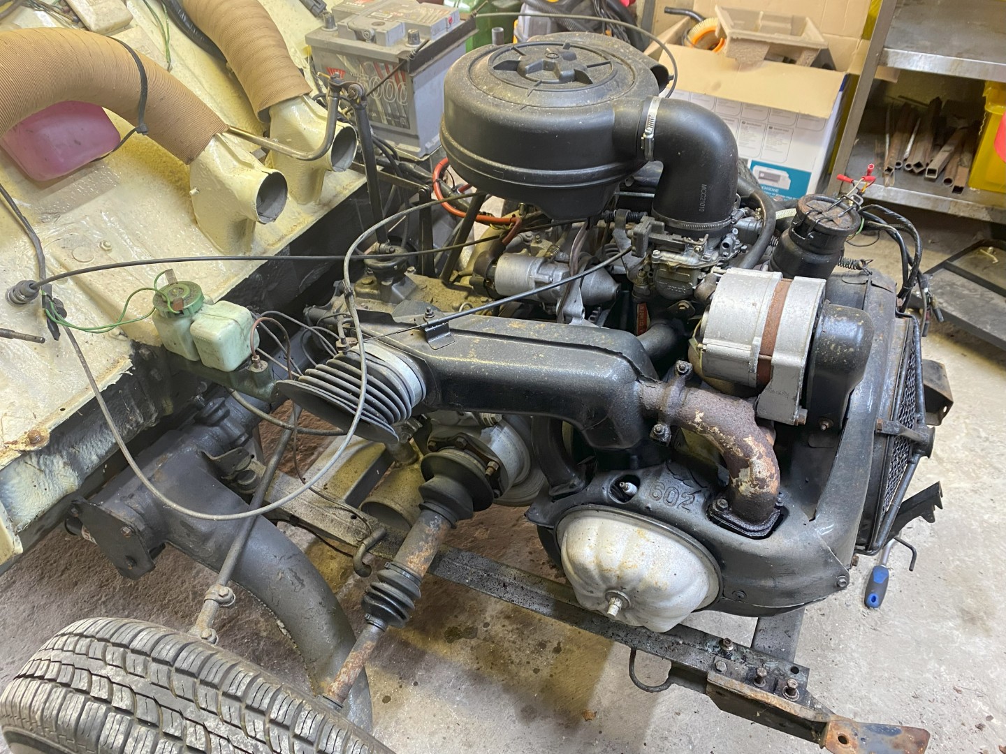

More progress.
The next move requires some care.

That was a mission. Next step cleaning, painting, fitting the adapter plate and clutch. Then to start stripping the 2cv down.

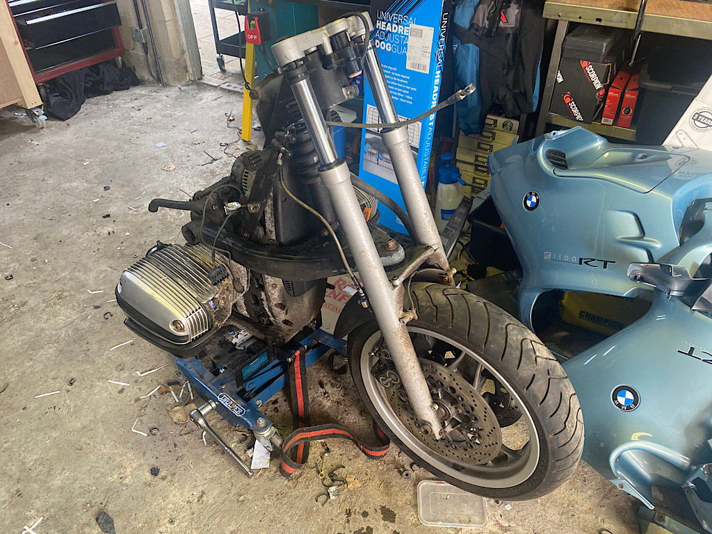

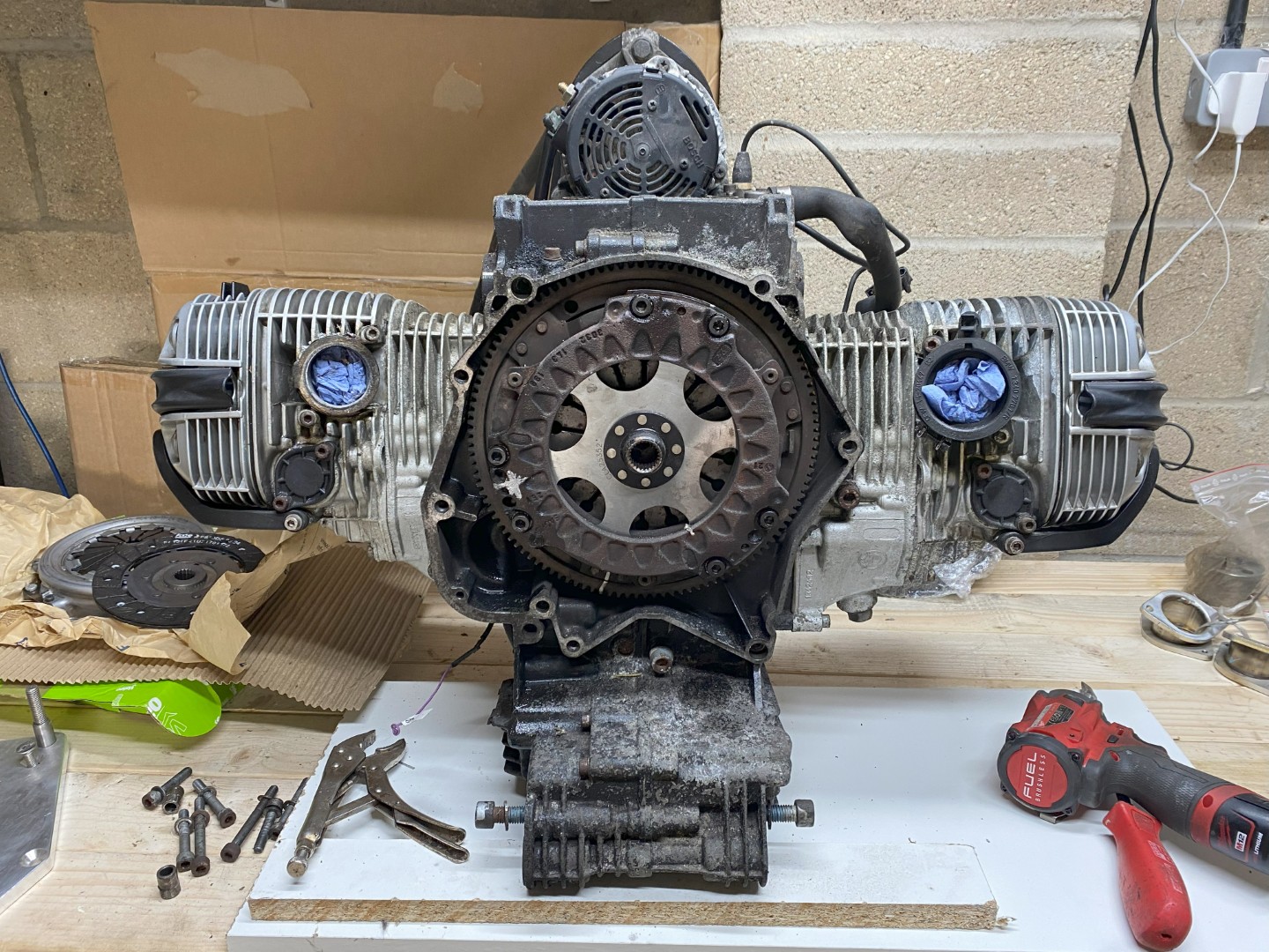

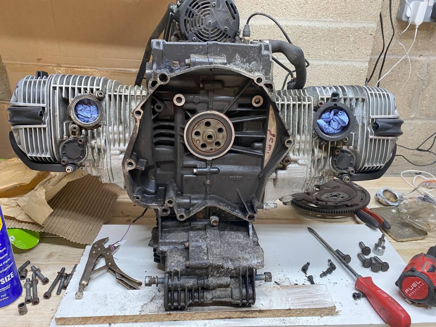

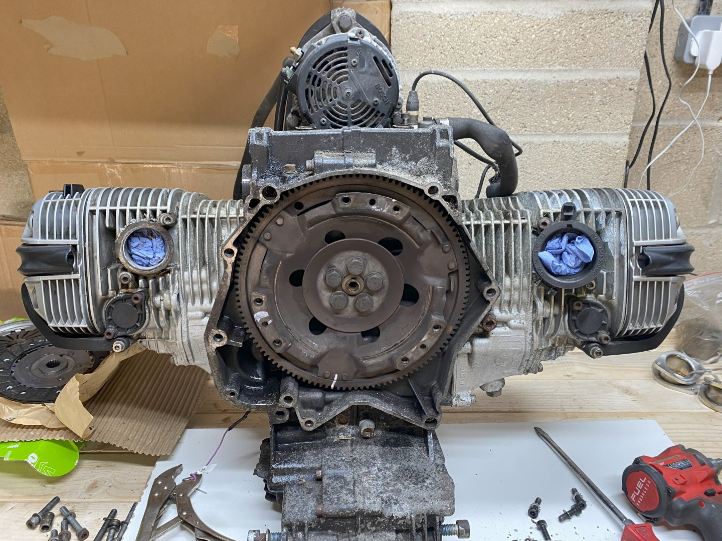

More work done over the last few days. First images are the removal of the bmw clutch and flywheel...
IMG_8673 (Large).jpg (488.74 KiB) Viewed 1737 times
IMG_8674 (Large).jpg (476.7 KiB) Viewed 1737 times
IMG_8675 (Large).jpg (499.99 KiB) Viewed 1737 times

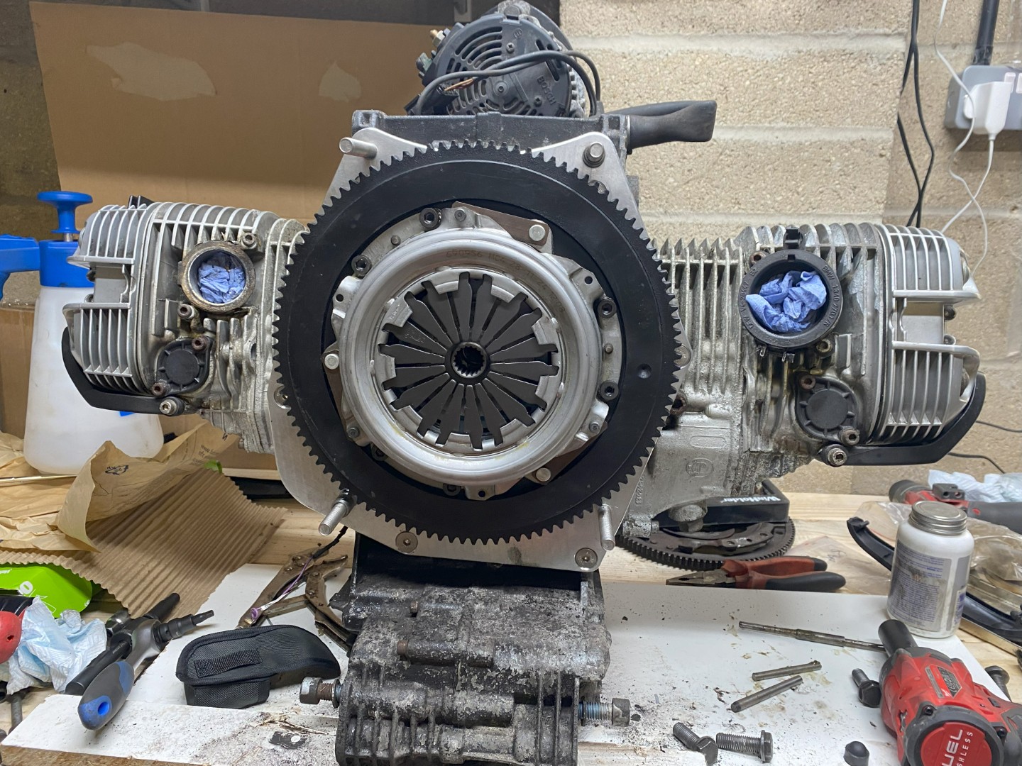

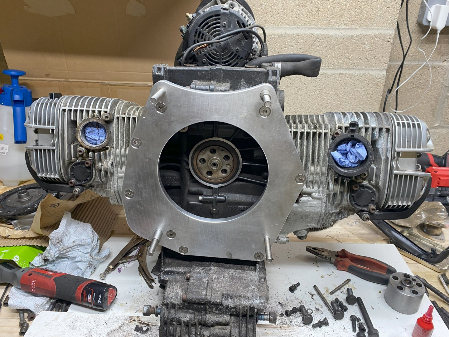

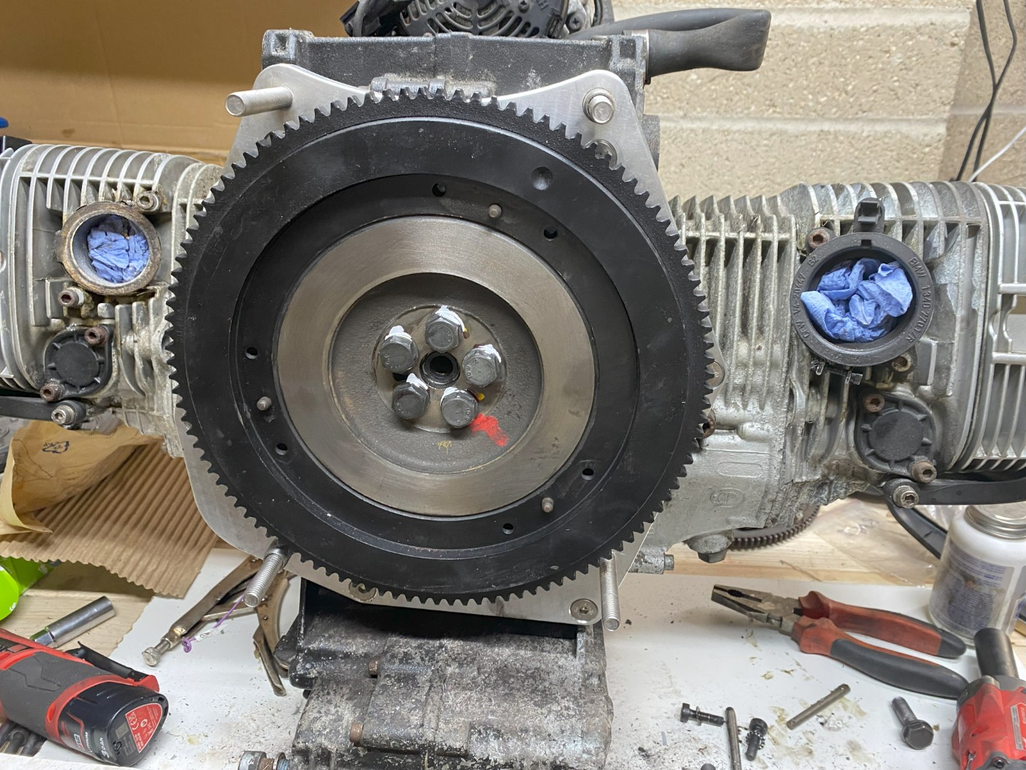

Then the gearbox adapter, crank adapter, modified 2cv flywheel and 2cv clutch are fitted...
IMG_8677 (Large).jpg (488.72 KiB) Viewed 1736 times
IMG_8678 (Large).jpg (429.08 KiB) Viewed 1736 times
IMG_8679 (Large).jpg (461.4 KiB) Viewed 1736 times

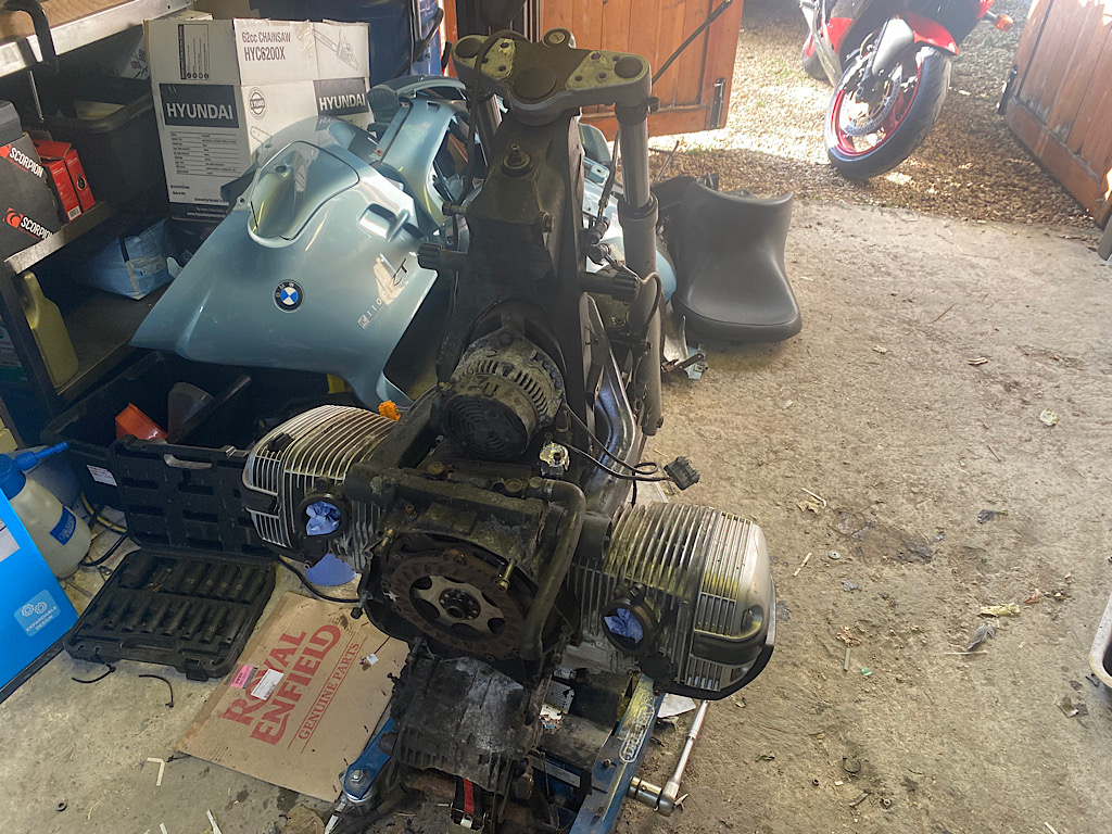

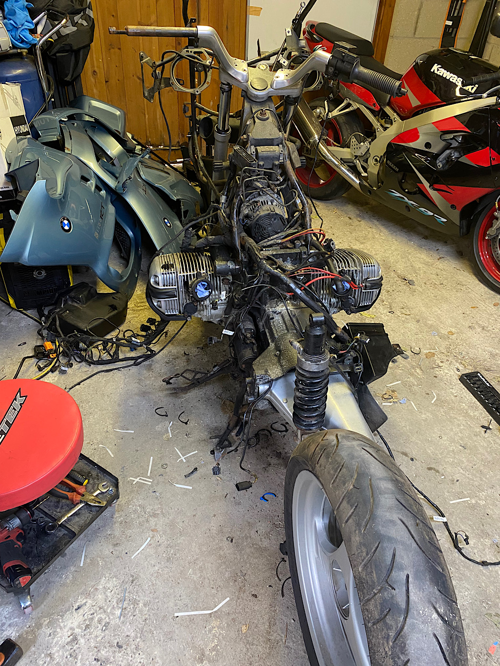

Start to remove some bodywork to give better access...
IMG_8681 (Large).jpg (434.17 KiB) Viewed 1735 times
IMG_8682 (Large).jpg (499.24 KiB) Viewed 1735 times
IMG_8687 (Large).jpg (496.63 KiB) Viewed 1735 times

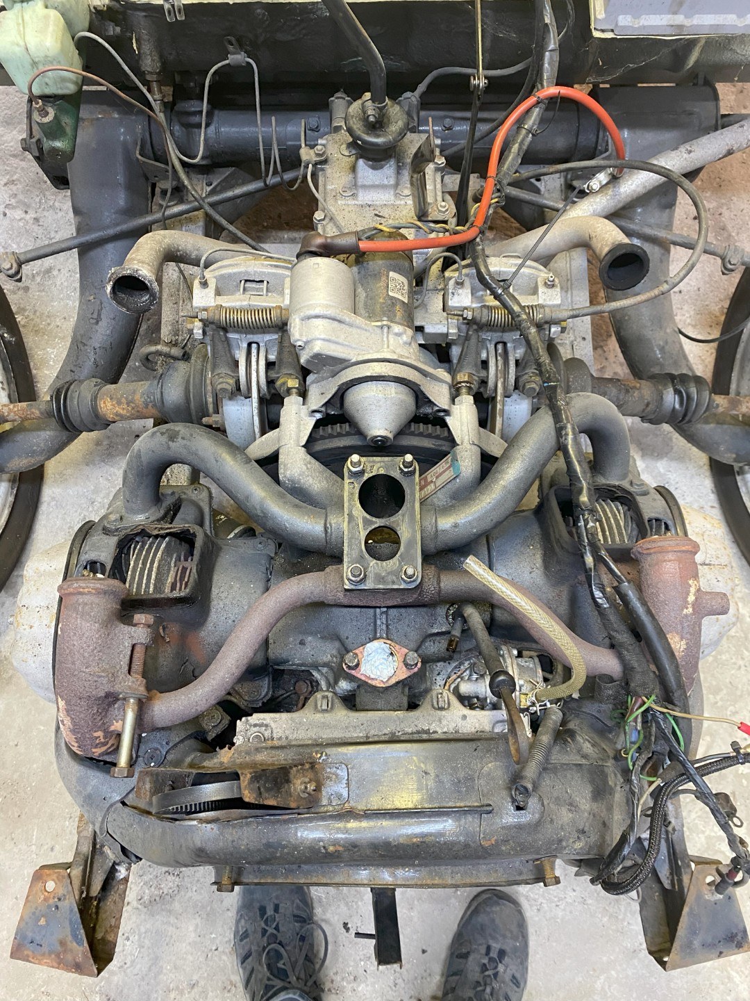

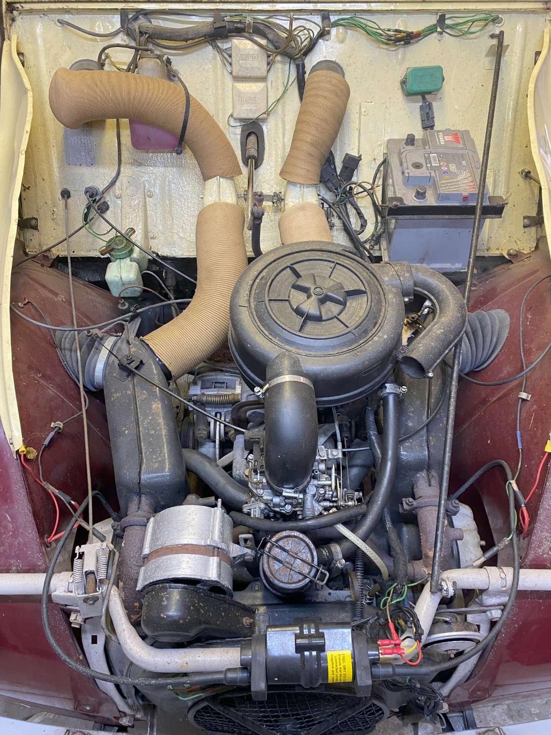

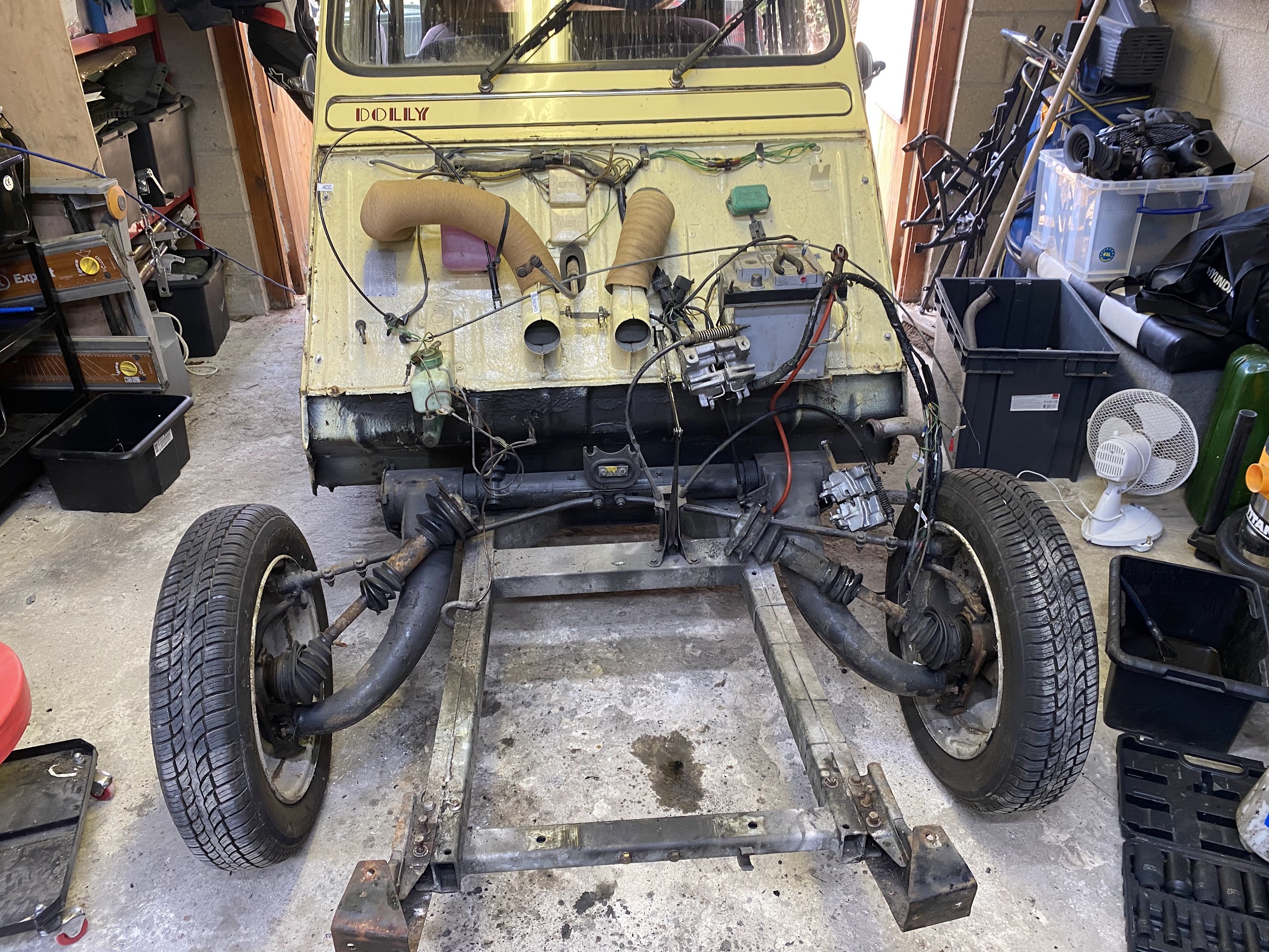

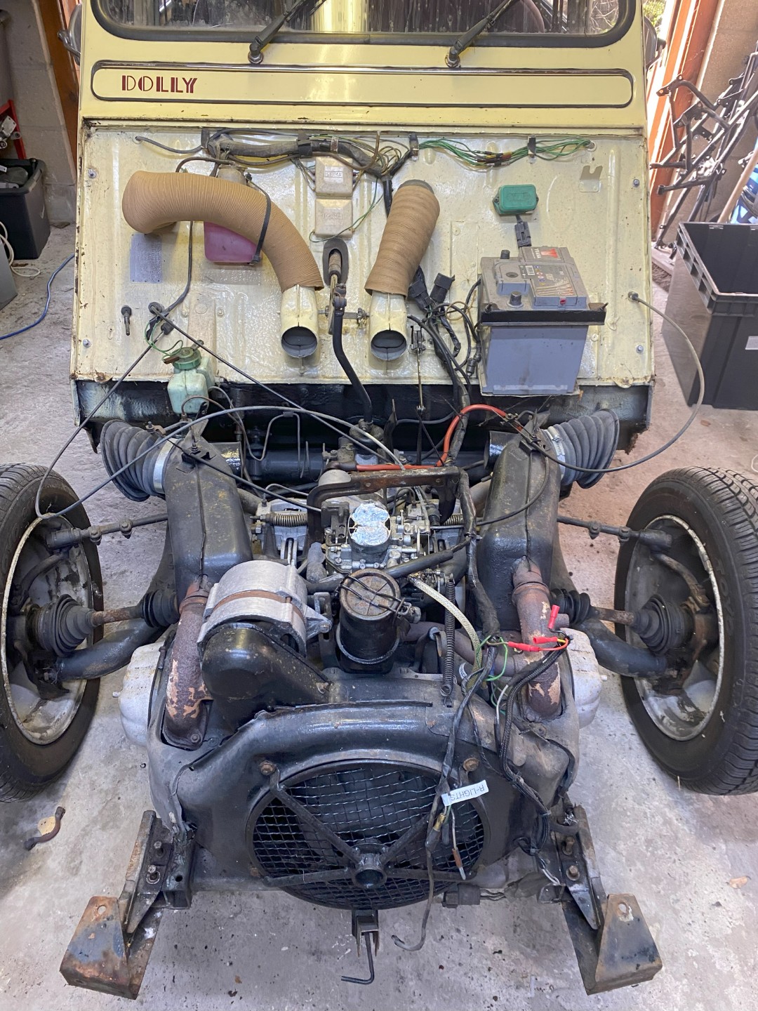

Finally for today some other bits are removed. Next step is to pull the engine. The gearbox has to come out for a small modification too.
IMG_8688 (Large).jpg (499.46 KiB) Viewed 1733 times
IMG_8691 (Large).jpg (479.94 KiB) Viewed 1733 times
IMG_8692 (Large).jpg (519.42 KiB) Viewed 1733 times

Rockburner wrote: Wed Jul 09, 2025 8:14 am Do you keep the fan?
Good work, really looking forward to the end result!
No. The fan connects directly to the crank on the 2cv engine. The bmw engine has an external oil cooler which may have to be enlarged and fitted with electric fans, we’ll see.

Ah - ok. Given that the engine is partially air-cooled (as designed) are you going to look into any other means of feeding air over the barrels?, or do you think the air-flow through the grill will be sufficient?
Are you keeping the BMW alternator (I'd guess you might be?) I hope it's height (on top of the cases) doesn't interfere with the bonnet, mind you - it looks like the engine is pretty low in the chassis so is that actually an issue?
dern
Posts: 2538
Has thanked: 1183 times
Been thanked: 2277 times
Re: 2CV6 Project Thread
Post by dern »
I think that more air will flow over the barrels in the car than in the bike but I can make some ducts if that’s not the case.
The alternator will fit and takes up the space where the fan/carb would be.

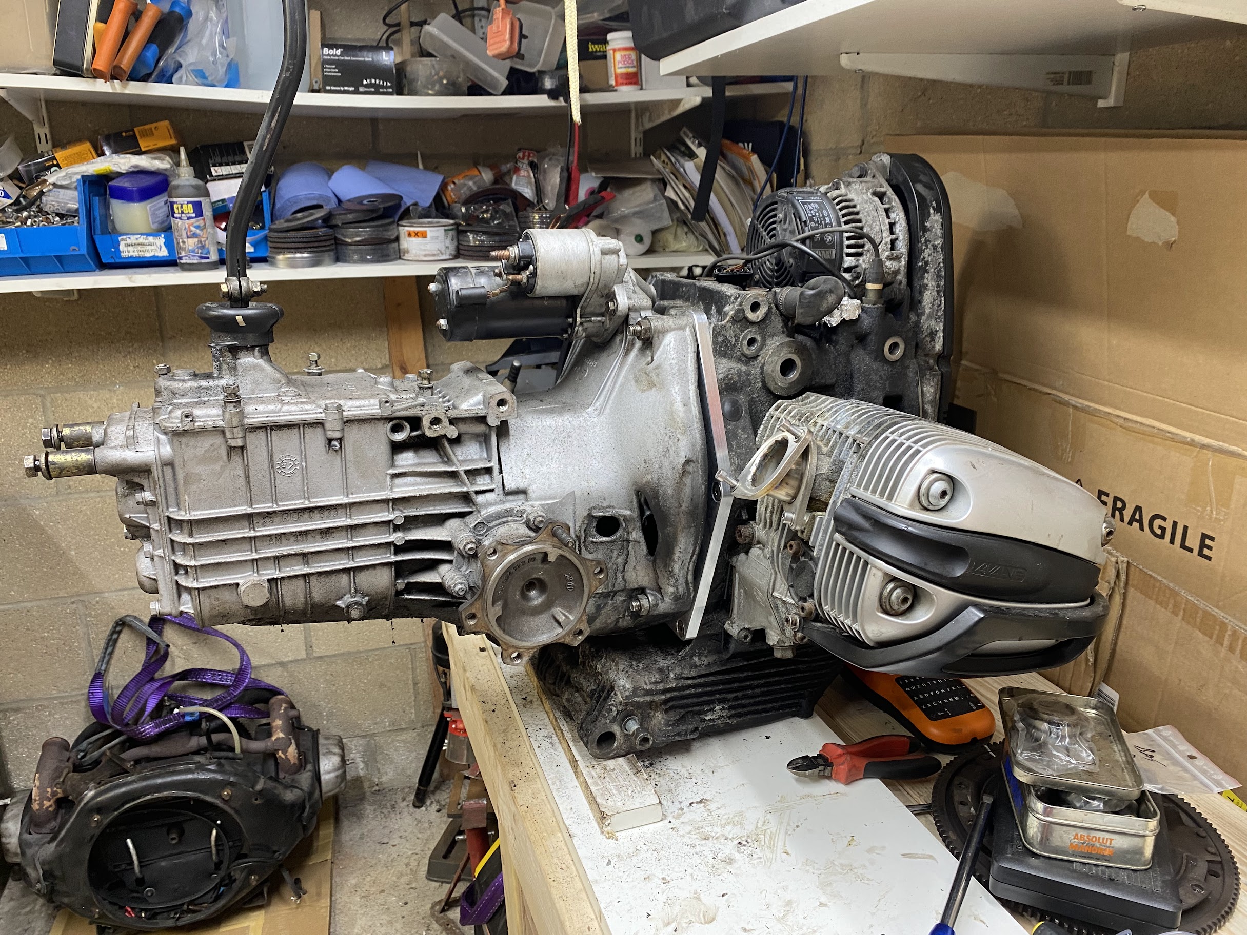

Dry run fitting the gearbox to the engine and the engine bay ready to accept them both.
I have to pause now while I wait for a part for the gearbox that's broken. Next step is to get the engine and gearbox in place in the car so I can make some engine mounts and start to plan the exhaust.
