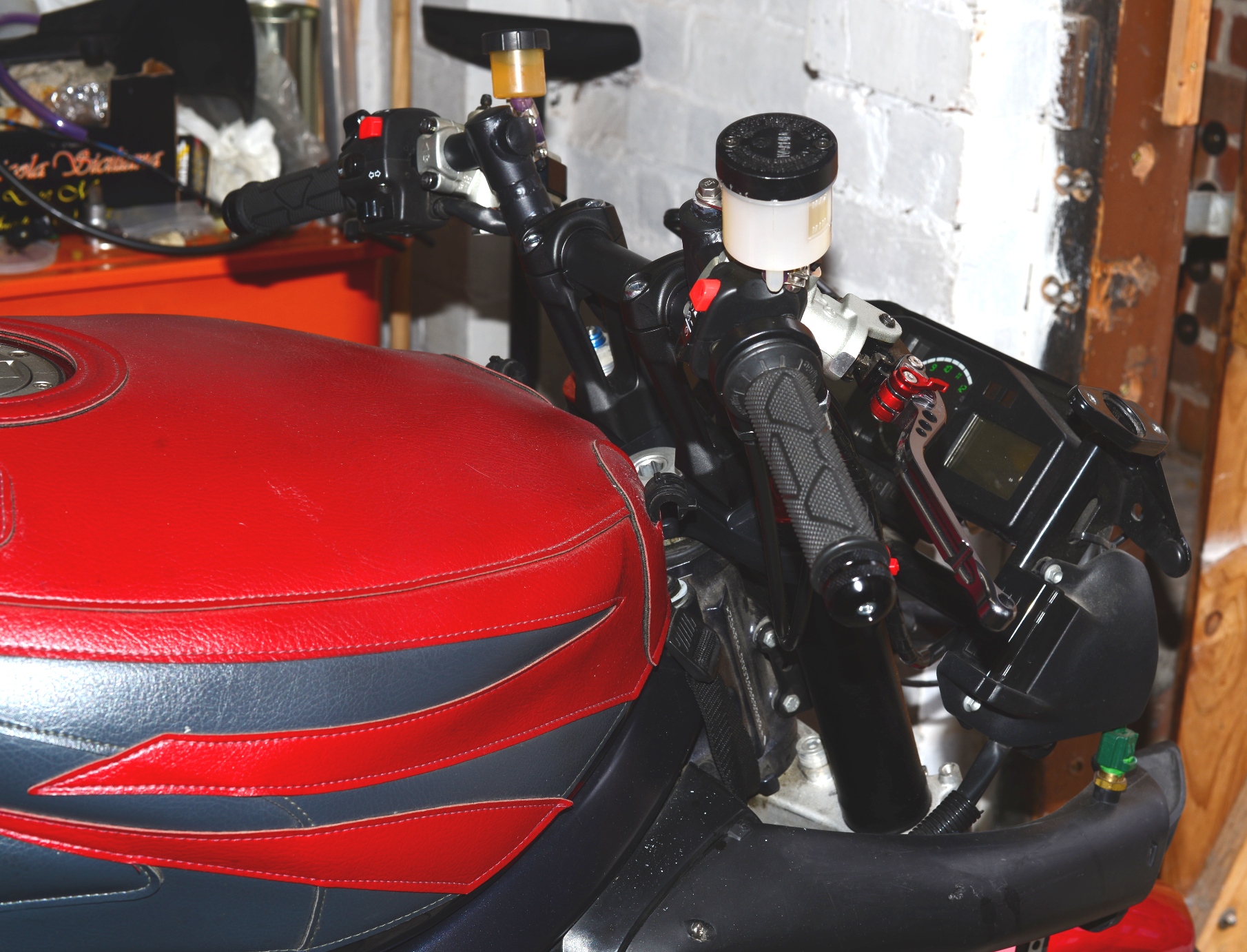

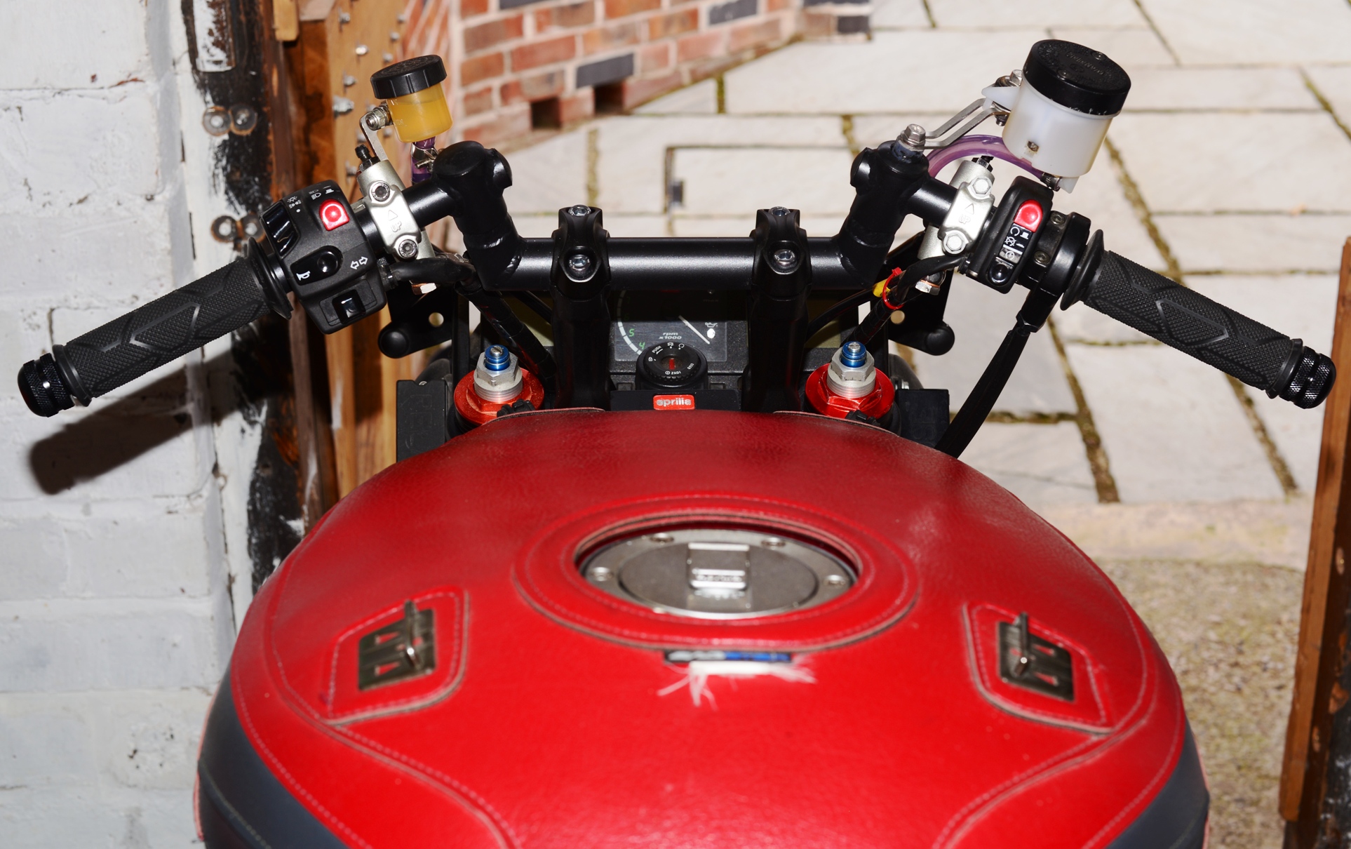

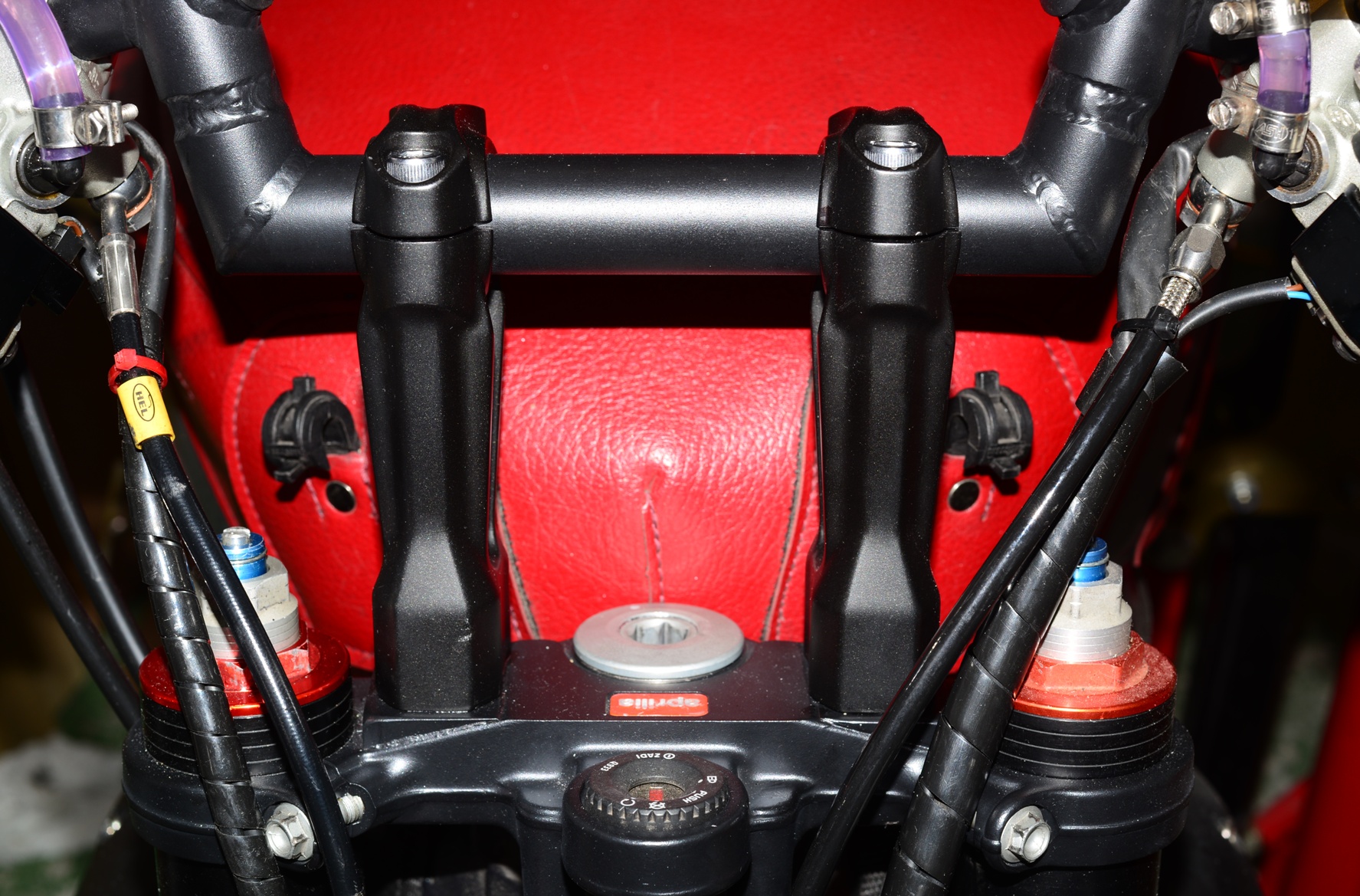

The top yoke and handlebars have (finally) come back from being Xylan coated and all the little bits and pieces that are required for a conversion like this have at last popped through the letterbox, so a couple of days ago I set about putting all the pieces together. The second top fairing is (unsurprisingly) still at the painters, albeit a different painter than last time. Having said that, they all seem to work to extremely relaxed timescales. At least this means you can get a decent view of the yoke, risers and bars, doesn't it?
Whether you'll enjoy that view remains to be seen...
So without further ado, here's the view as you walk into the shed:
To recap, the top yoke is OE Aprilia, as fitted to the RSV and Falco, but with two triangular aluminium wedges JB Welded to the sloping top sections. To strengthen that bond, a steel insert was pressed in to mechanically join the two parts. The risers are off an MT-09 SP and the bars are home-brewed out of 1 1/8" (28.6 mm) section steel tube for the base and uprights and 7/8" (22.2mm) tube for the grips and controls. They're basically home-brewed 'fat bars'. Welding was done by professionals, not me (my welding is shit - really shit.) Here's a closer view of the risers and bars:
I was pleasantly surprised how easily all the parts went together. No real gotchas were encountered and things like the throttle action is better than it's ever been, even from new. This is because the throttle routing is much more relaxed and there's no tightness or binding when going from lock to lock. Having the throttle cable exiting straight down from the grip helps, and the cables are custom ones from Venhill to their 'featherlight' specification which uses marine-grade stainless steel inner wire for maximum flexibility, and a 'teflon' liner, to reduce friction and give a lighter action. All I can say is they work. And this is the rider's view:
The bike is still on the Skylift and will stay there until the bodywork has been fitted, but I did a test sit on it, and the riding position feels massively improved. I'm still leaning forward - it's not 'sit up and beg', but it no longer feels like the bars are an extension of the wheel spindle. I'm sure my back, elbows, shoulders and wrists will thank me.

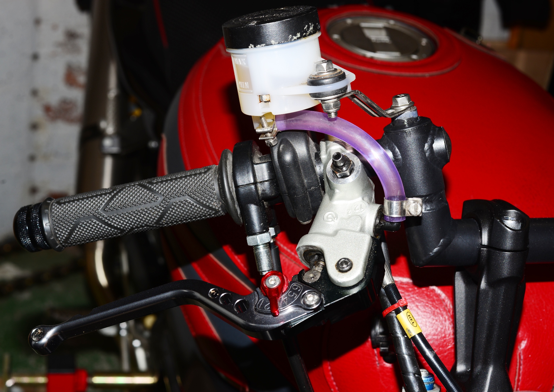

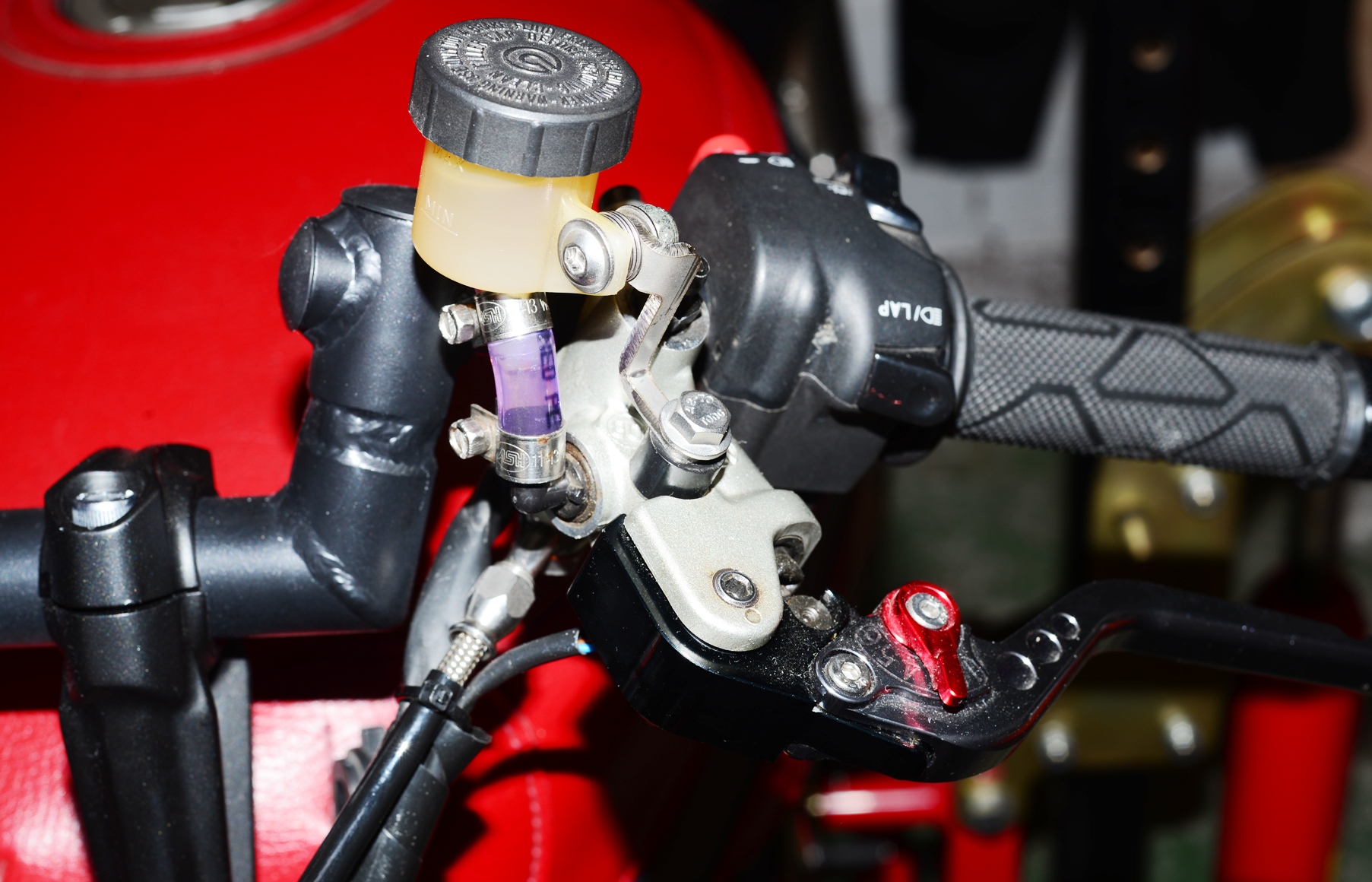

In cas anyone's interested, the remote reservoir brackets came from Racetorx - they're on FB and the Web. The bracket I used for the clutch reservoir was their 'side angle perch':
And the one for the brake reservoir was their 'Z perch':
And here's a side shot of them both:

Perfect. Full lock to lock clearance without changing the lock stop positions. The risers just touch the tank harness, which is a loose-ish fit on the tank. I was really surprised at how well it all went together.

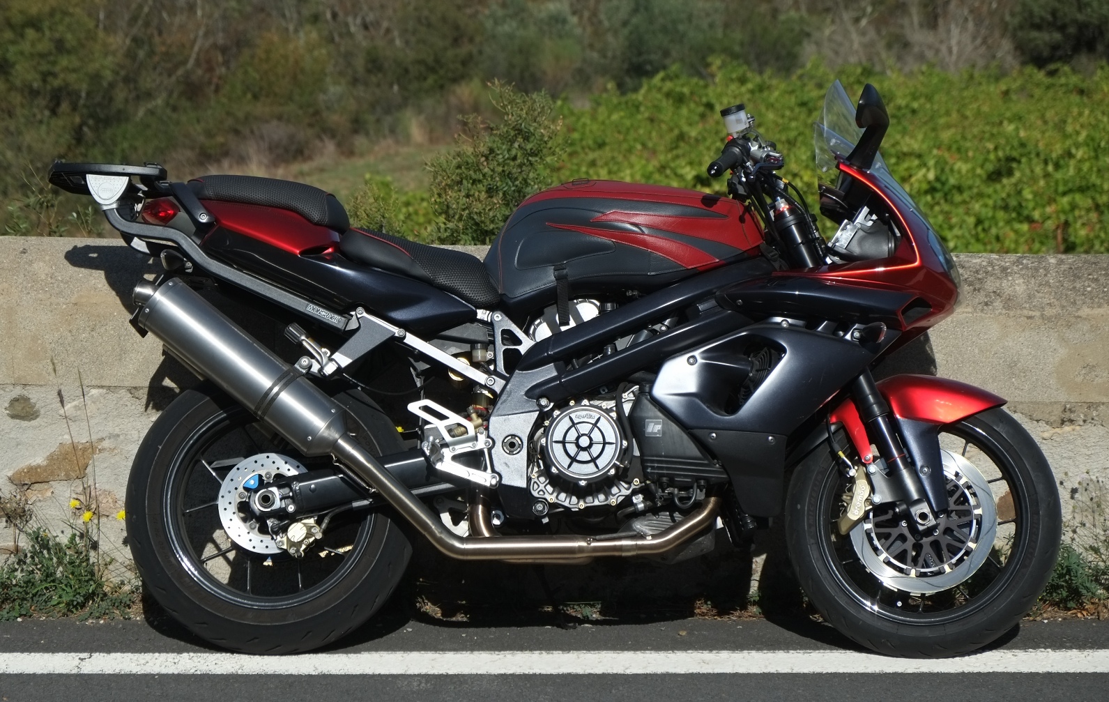

Today I have been mostly riding my bike, and in lovely sunny weather. I decided to head off on my 'local loop' which encompasses about 30 miles of some of the best roads in the region. The loop starts in Roujan, heads through Neffies and towards Cabrières on a section of road that can only have been designed by a motorcyclist; it's just plain bonkers. And the scenery (if you've got time to take it in) is pretty cool as well. Cabrières is also home to some of the best quality and best value red wine in the region. This pic was taken on the other side of the village heading out to Clermont-l'Hérault.
The big rock in the picture is one of 'Les Deux Rocs' that dominate the skyline in the area. If you look closely there is a small building perched on top that I believe is a chapel. The French do like to do that sort of thing. it's not uncommon to see hang-gliders circulating around the rock, playing with the thermals, in the company of birds of various sizes. And of course, the vines. Lot of vines. And a close-up of the Falco.
Not too shabby for a 15 year old bike, no? The road from Cabrières intersects with the D908 which runs from Clermont-l'Hérault to Bédarieux (and further) and which is a glorious biking road. it has a billard table smooth surface with recently laid grippy tarmac, fast sweeping bends and great views. One section has 70-80mph corners which flip flop between left and right handers for a couple of miles. No intervening straights, just pick the bike up and flip it on the other side of the tyre. Fabulous. A bit later on there are a couple of corners that feel like they cover more than 360 degrees. Obviously they don't but it feels like it. And when we get close to Bédarieux, this is what greets us:
