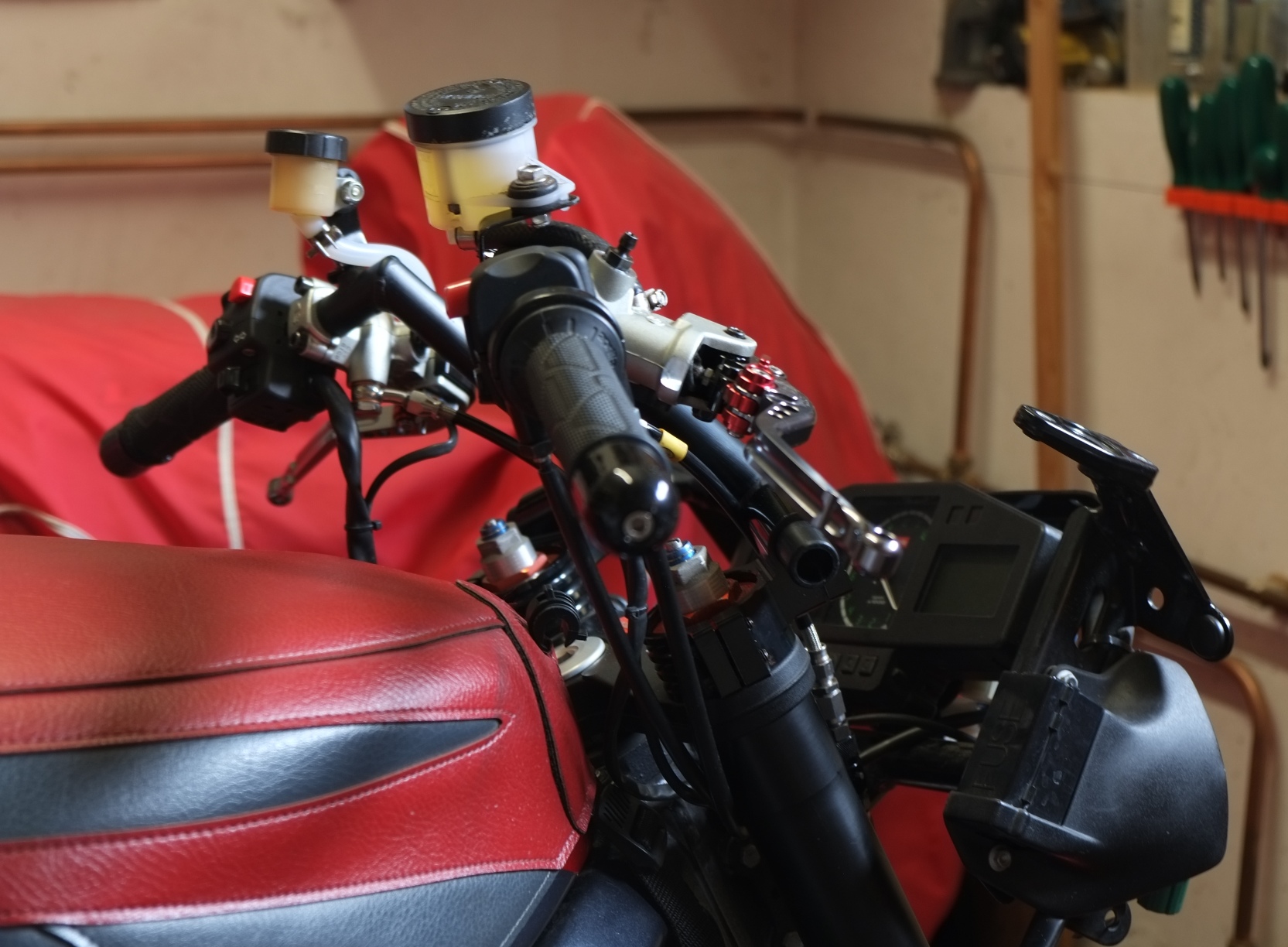

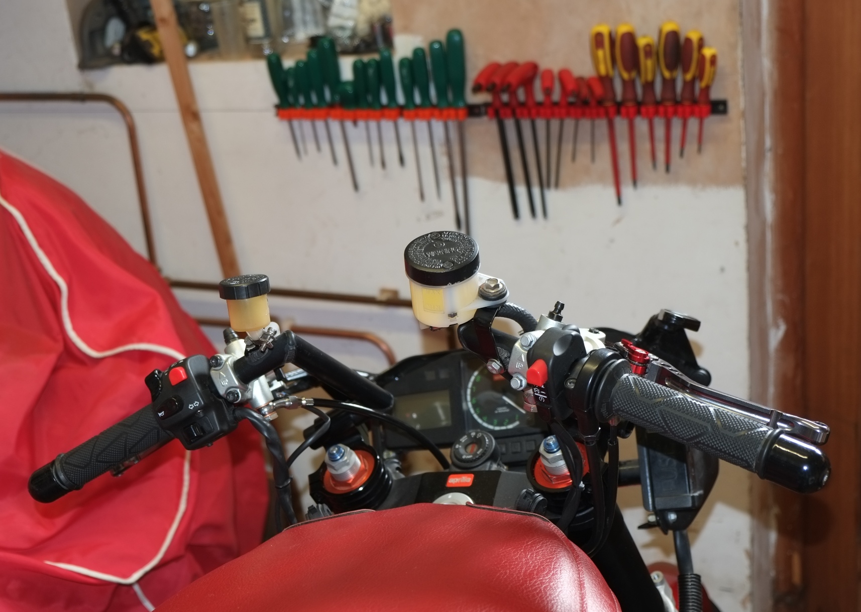

I'm still highly ambivalent on the looks (OK, I think it looks a Bit Shit), but I'm hoping the comfort aspect will make up for it. Here are some pics from various angles of the bars with all controls and switchgear fitted. First of all, the front view:
Everything will need tidying (particularly switchgear cables), but I'm very pleased with the new (straight exit) throttle cables, custom made by Venhill. The throttle action is perfect at all bar positions with no tightness or binding. My brake hose making skills are at least adequate as the brakes bled quickly and easily with no leaks. Perhaps the bars will look better when there's a top fairing to partially hide them (he said hopefully). Next, the side view:

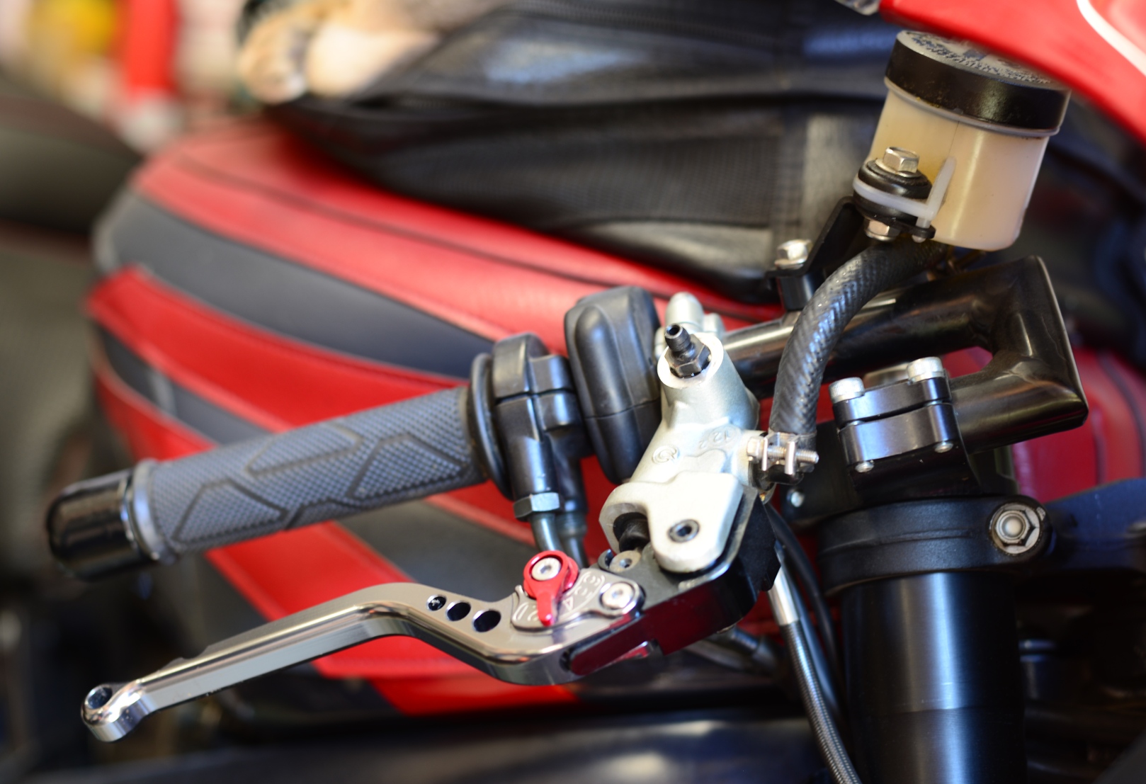

When it came to bleeding the clutch, things didn't go so smoothly. I was adding fluid to the (tiny) reservoir and bleeding from the nipple thoughtfully provided by Brembo on the master cylinder's highest point, but not getting any clutch action. I decided to bleed from the slave cylinder end, which was then I noticed a small puddle of brake fluid on the floor. On closer inspection, fluid was oozing out of the small bleed hole on the back of the aftermarket slave cylinder. Bugger. My other slave cylinder has had one of its o-rings renewed but hasn't been tested for leaks. Guess that's next on the list. And now the (almost) rider's eye view:

It does look a bit 'prototype' and those cylinders sitting proudly up there don't help.mangocrazy wrote: Thu Apr 07, 2022 7:38 pmI was rather afraid that might happen...
I can put it back to how it was if I really don't like it. All the old parts are untouched, that was a basic part of the plan.
Thing is though, if it rides right you can always work with that geometry and refine it later. Wouldn't bin it if it all does what you want. Function first, form later.

Yes, the reservoirs look like an afterthought and definitely need tidying, as do the switchgear cables. It will definitely get a chance to prove itself on the road - I've come this far with it, I have to see if it works as intended. I think a heavily smoked screen on the top fairing might help with the front view...Count Steer wrote: Thu Apr 07, 2022 7:45 pmIt does look a bit 'prototype' and those cylinders sitting proudly up there don't help.mangocrazy wrote: Thu Apr 07, 2022 7:38 pmI was rather afraid that might happen...

Yeah it ruins the looks of a (to my eyes) fine looking bike. If you (or anyone) can suggest how I achieve the same kick back of the bars without it looking like a bag o' shite, I'm all ears. The fixed point around which I had to work was the top fairing (and mirror) main mounting points. I cut the donor top fairing back until it just missed the mounts, effectively shortening the fairing as much as I could. Then I had to fabricate the shortest extended bars so the controls just missed the top fairing and cut down screen.Mr. Dazzle wrote: Fri Apr 08, 2022 8:49 am Love it.
Well, obviously I don't love it, it looks fucking atrocious.
Way more interesting than slightly longer rear mudguard though right?
The result is what you see, unfortunately.
I didn't want to go the top yoke bar riser/swept back bars route, ironically on aesthetic grounds. I may revisit that view in time...

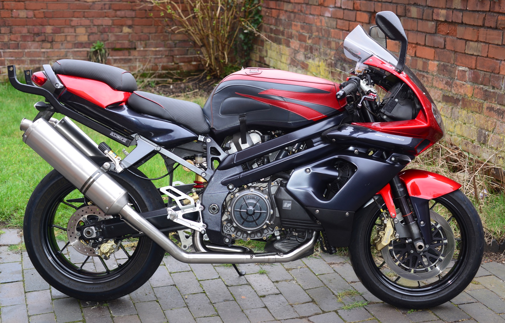

Sorry, missed your post... Here are some pics of the (relatively unmolested) Falco.Yorick wrote: Thu Apr 07, 2022 7:39 pm What were the original bars like before you fitted the apehangers ?
