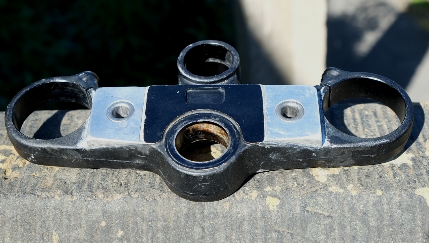

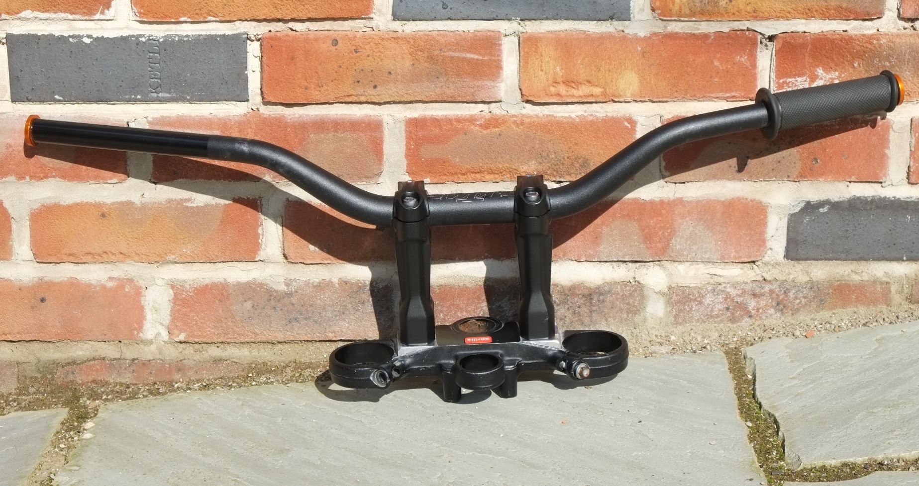

The top yoke and handlebars have (finally) come back from being Xylan coated and all the little bits and pieces that are required for a conversion like this have at last popped through the letterbox, so a couple of days ago I set about putting all the pieces together. The second top fairing is (unsurprisingly) still at the painters, albeit a different painter than last time. Having said that, they all seem to work to extremely relaxed timescales. At least this means you can get a decent view of the yoke, risers and bars, doesn't it?
Whether you'll enjoy that view remains to be seen...
So without further ado, here's the view as you walk into the shed:
To recap, the top yoke is OE Aprilia, as fitted to the RSV and Falco, but with two triangular aluminium wedges JB Welded to the sloping top sections. To strengthen that bond, a steel insert was pressed in to mechanically join the two parts. The risers are off an MT-09 SP and the bars are home-brewed out of 1 1/8" (28.6 mm) section steel tube for the base and uprights and 7/8" (22.2mm) tube for the grips and controls. They're basically home-brewed 'fat bars'. Welding was done by professionals, not me (my welding is shit - really shit.) Here's a closer view of the risers and bars:
I was pleasantly surprised how easily all the parts went together. No real gotchas were encountered and things like the throttle action is better than it's ever been, even from new. This is because the throttle routing is much more relaxed and there's no tightness or binding when going from lock to lock. Having the throttle cable exiting straight down from the grip helps, and the cables are custom ones from Venhill to their 'featherlight' specification which uses marine-grade stainless steel inner wire for maximum flexibility, and a 'teflon' liner, to reduce friction and give a lighter action. All I can say is they work. And this is the rider's view:
The bike is still on the Skylift and will stay there until the bodywork has been fitted, but I did a test sit on it, and the riding position feels massively improved. I'm still leaning forward - it's not 'sit up and beg', but it no longer feels like the bars are an extension of the wheel spindle. I'm sure my back, elbows, shoulders and wrists will thank me.

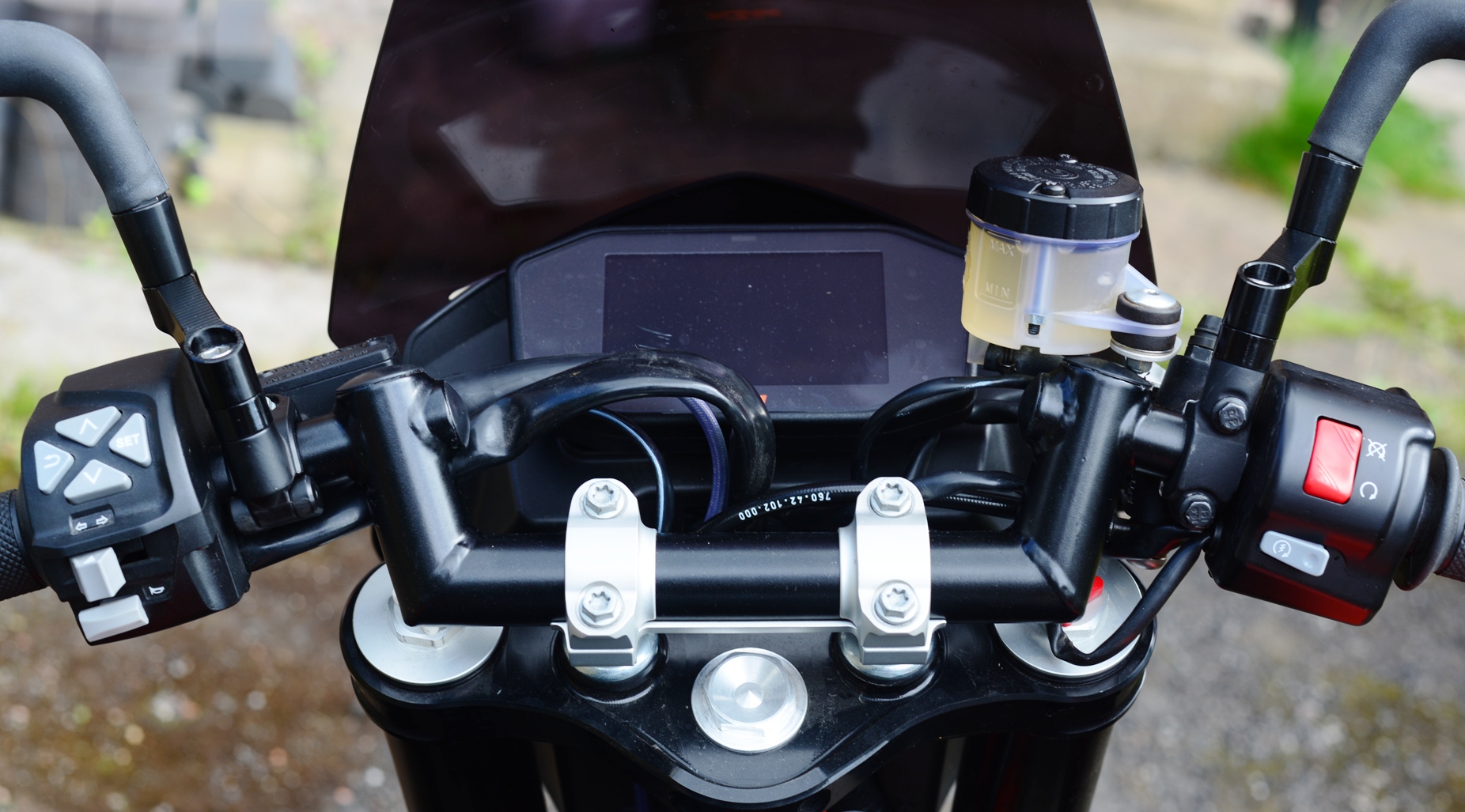

In cas anyone's interested, the remote reservoir brackets came from Racetorx - they're on FB and the Web. The bracket I used for the clutch reservoir was their 'side angle perch':
And the one for the brake reservoir was their 'Z perch':
And here's a side shot of them both:

How's the tank clearance at full lock?
Posts: 6902
Has thanked: 2405 times
Been thanked: 3630 times
Perfect. Full lock to lock clearance without changing the lock stop positions. The risers just touch the tank harness, which is a loose-ish fit on the tank. I was really surprised at how well it all went together.

Looks like you've sorted the cable runs too which is where a lot of these types of conversions go wrong.
