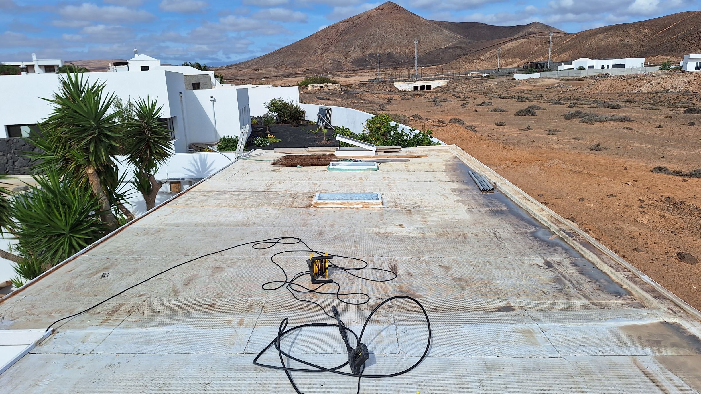

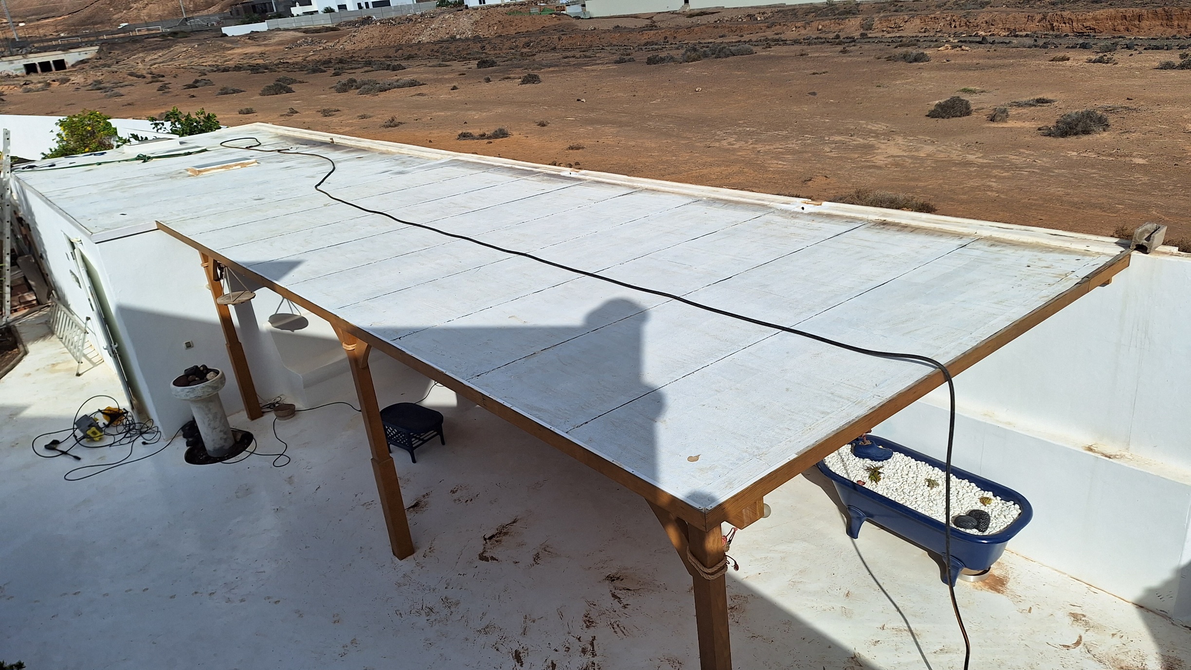

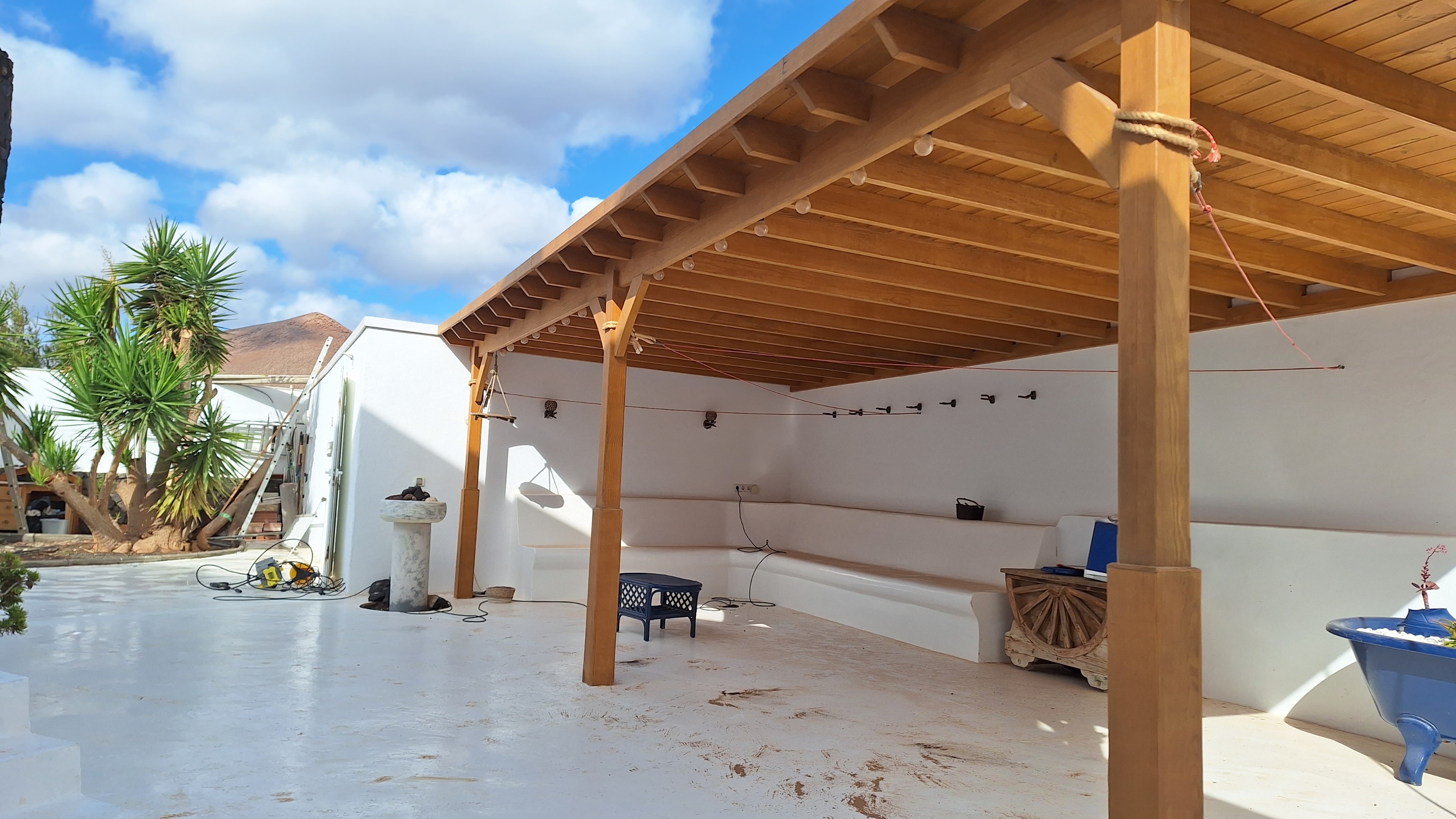

We have a beautiful pergola attached the Man Cave.
In the rare downpour on Friday, lots of rain came through :(
The garage part has 4" of concrete, so doesn't leak.
My enduro pals are all tradesmen and they've told me what to do to stop leaks. The wood was very expensive so want to keep it looking good.

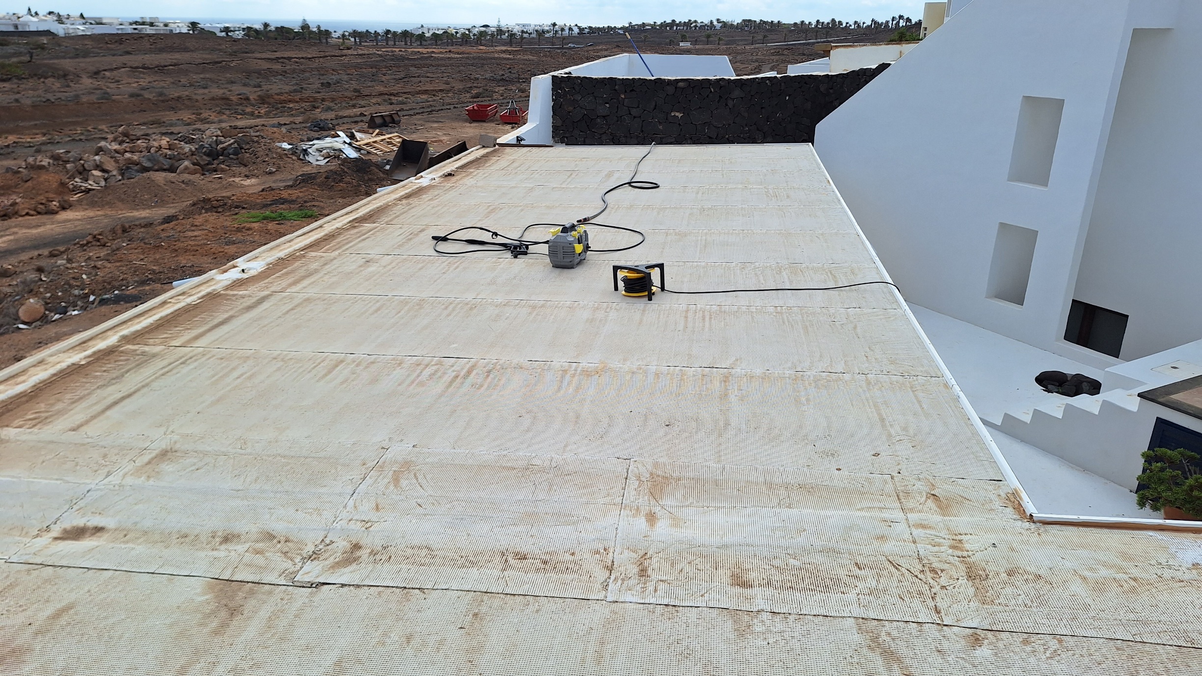

First job was to jet wash the roof properly.
Luckily was a cloudy day, as would fry up there on a white roof. Wind was blowing so I was soaking wet, but was warm and so was drying me as well :D
Will need to let it dry for a couple of days as the water will have been forced through into the holes.

I was expecting the roof to have dries so I could sweep up the remaining dirt.
But a heavy overnight dew has put a knocker on that.
Hosed most of it down the drain and hope the sun comes out to dry it quickly.

So what's the plan then?
A fairly flat roof with (what appears to be) a million teatowel sized tiles glued to it is always likely to fail at some point. Not enough fall, too many points of ingress.
Posts: 19945
Has thanked: 12620 times
Been thanked: 8541 times
Re: Today I Have Been Mainly Being A Roofer.
DefTrap wrote: Tue Dec 05, 2023 11:48 am So what's the plan then?

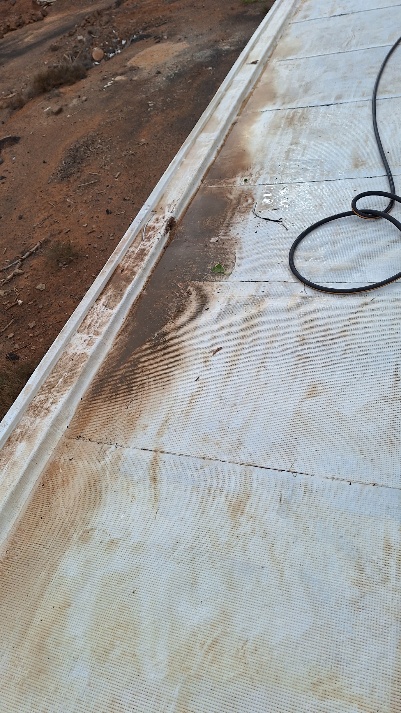

There's about a 5 degree fall. The felt has a few cuts and nicks and a lot of the seams have damage.
My pal's advice....
Poke and prod the expensive Sikafkex rubber paint into all the damage bits and all the seams with a paintbrush.
Let it dry.
Apply the Sikafkex with a roller over the damaged areas and seams.

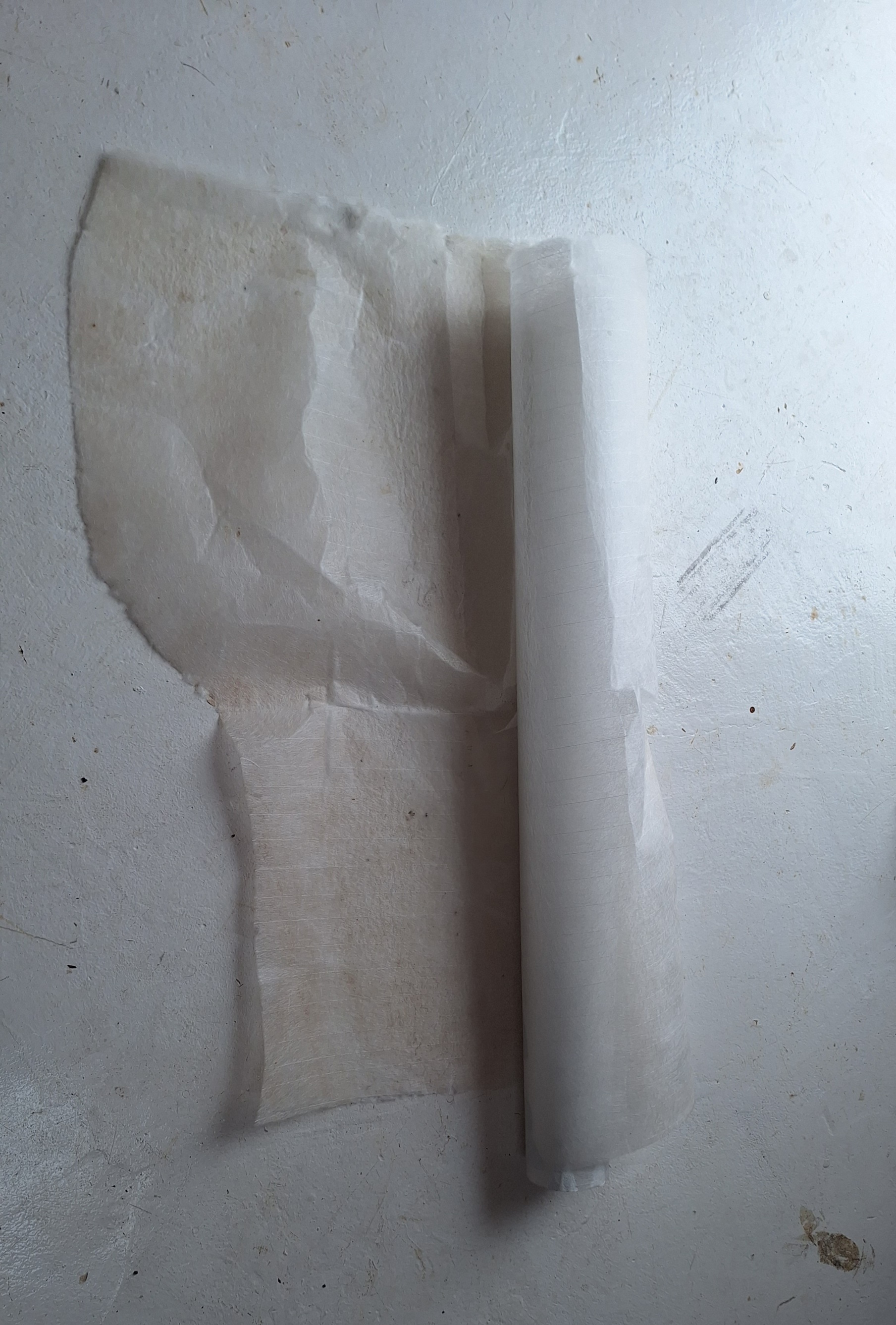

Then strips of Velo. It's like tissue paper.
Then soak with more Sikafkex.
Let it all dry.
Another coat of Sikafkex over treated areas.
Not sure yet, whether to paint the whole roof with the Sikafkex or just normal outside paint.

The felt strips are about a meter wide and run the width of the roof.

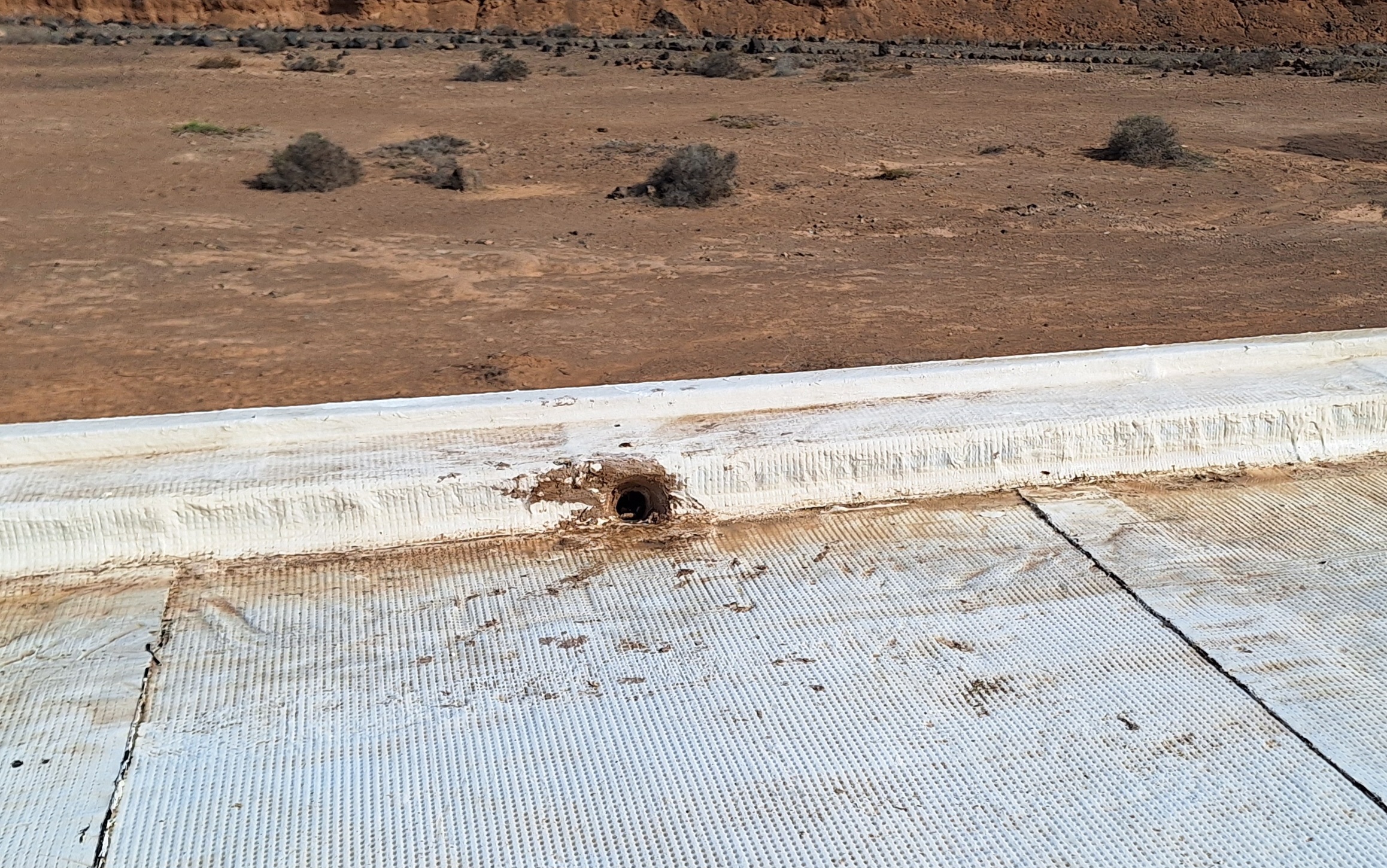

Gonna give roof a day to dry out.

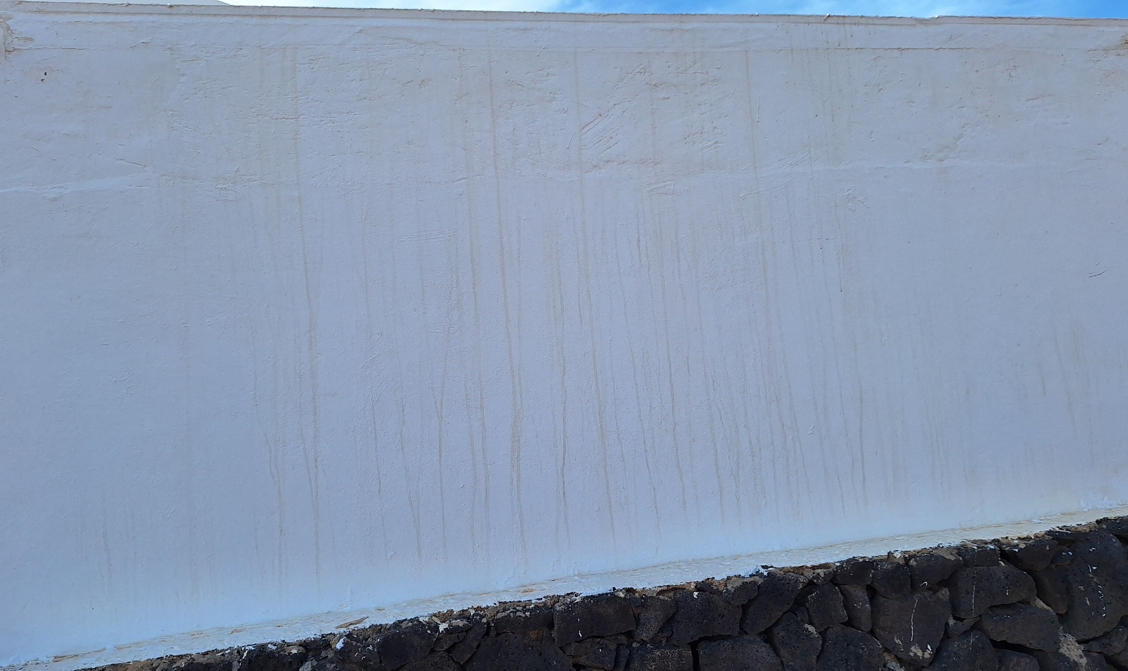

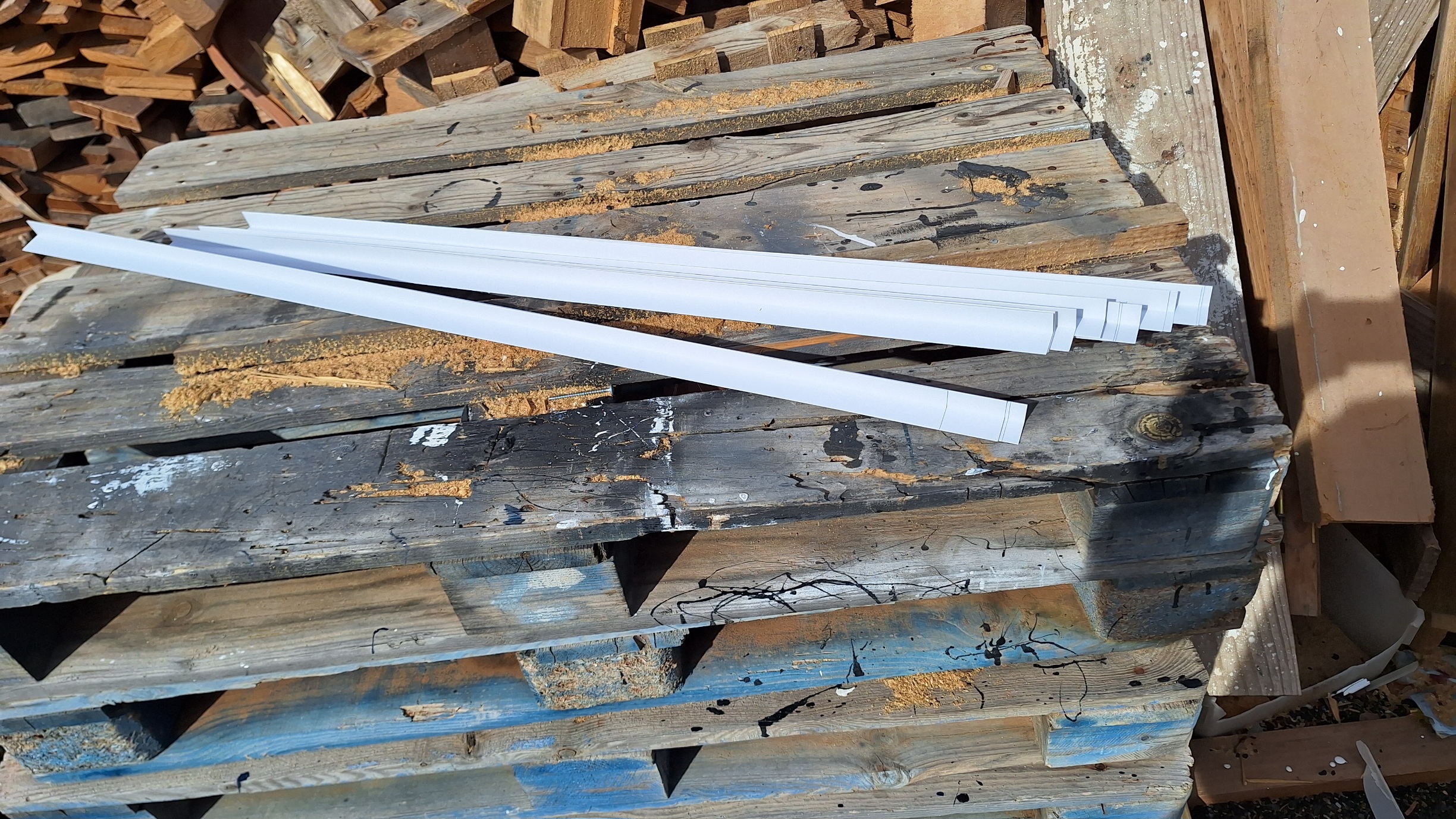

The lip on the outside wall wasn't high enough so in big rains, it overflowed onto outside wall. Making it filthy, but more importantly, damp came into garage.
I put on 25mm batons, but still went over.
So been advised to use these 20mm x 25mm plastic angles as well.
