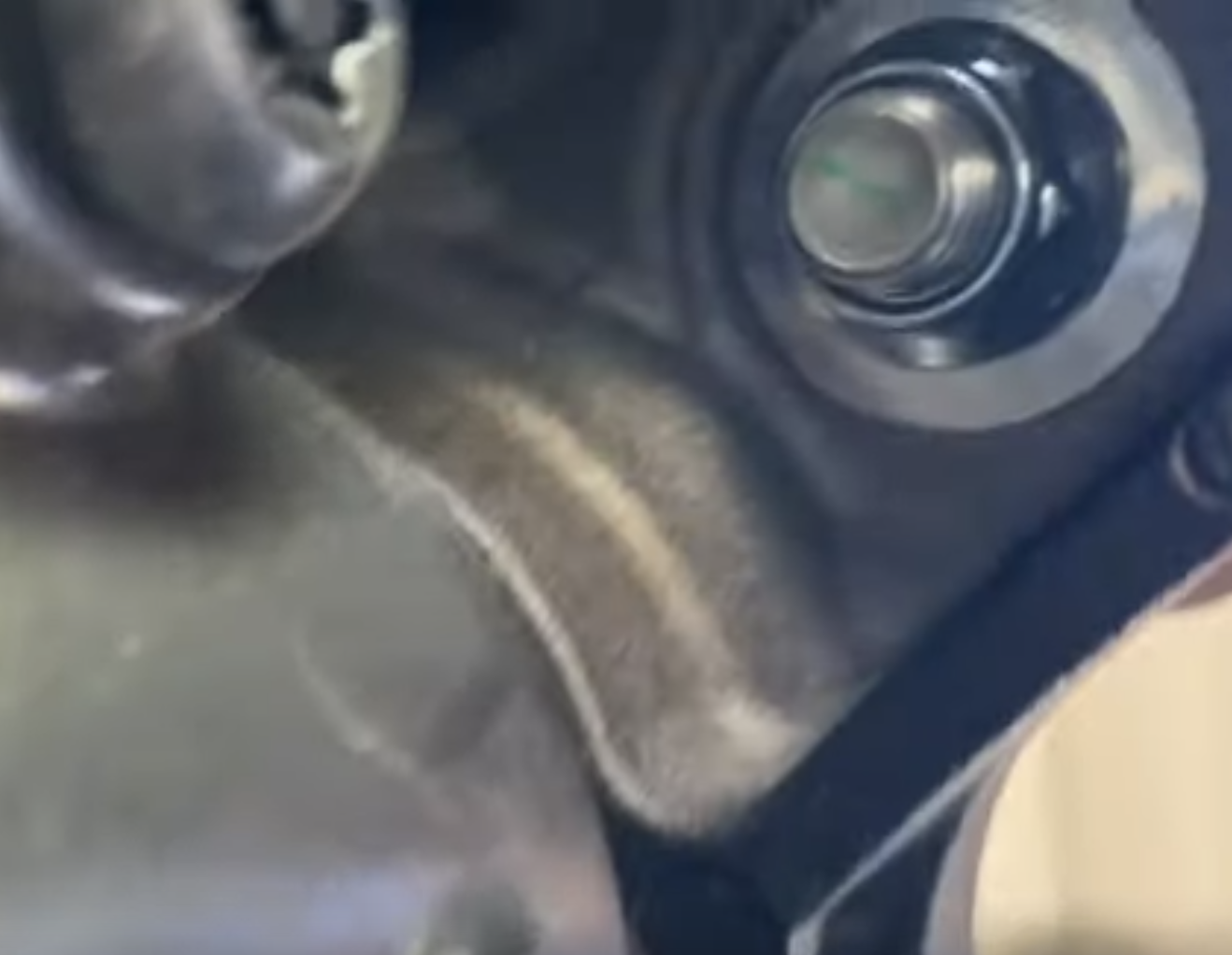

I'm attempting to fit my new Gilles risers. I need to remove the stock ones and to do that I need to undo the nut underneath the top fork yoke (x2). It's specced to 40nm. It's really tight for space. I can just about get my 14mm onto it square, but not much of an angle to turn it. Anyway, my first couple of attempts were futile. I've looked at a breaker bar, but I don't think I have the room to use one due to the chunkiness of the breaker bar end. The headstock and fork legs are very much in the way.
Before spending/wasting more money on this, should I just get a workshop to do it?

Looks like you'd get in there with a long socket or perhaps a 3/8 bar. Can't imagine there's any need to remove the top yoke.
The still's from here if it helps:
Screenshot 2023-11-14 at 18.27.51.png (1.11 MiB) Viewed 992 times

Thanks Chris. It's a standard ratchet bar, so not much leverage.
