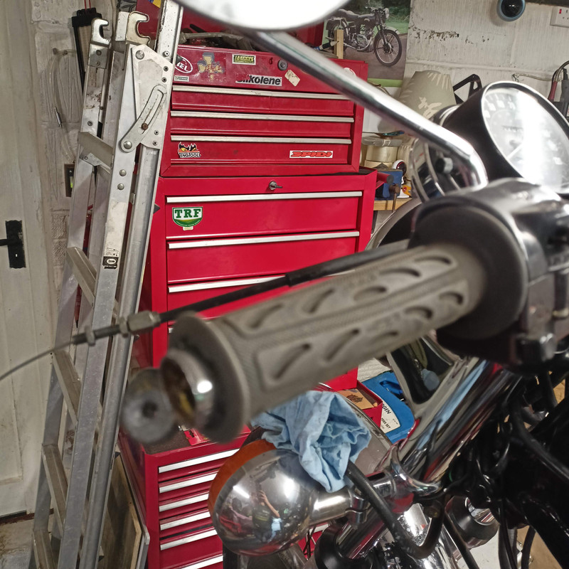

Immediate issues were that the throttle/carbs had seized solid with no movement at the twistgrip, the front brake was seized on and the lever came back to the bar, and when we turned the fuel tap on, disgusting-smelling petrol ( not unsurprisingly) came straight out of the bottom of the carb overflows.
Oh and one of the (non-standard) handle grips was all manky and rotten

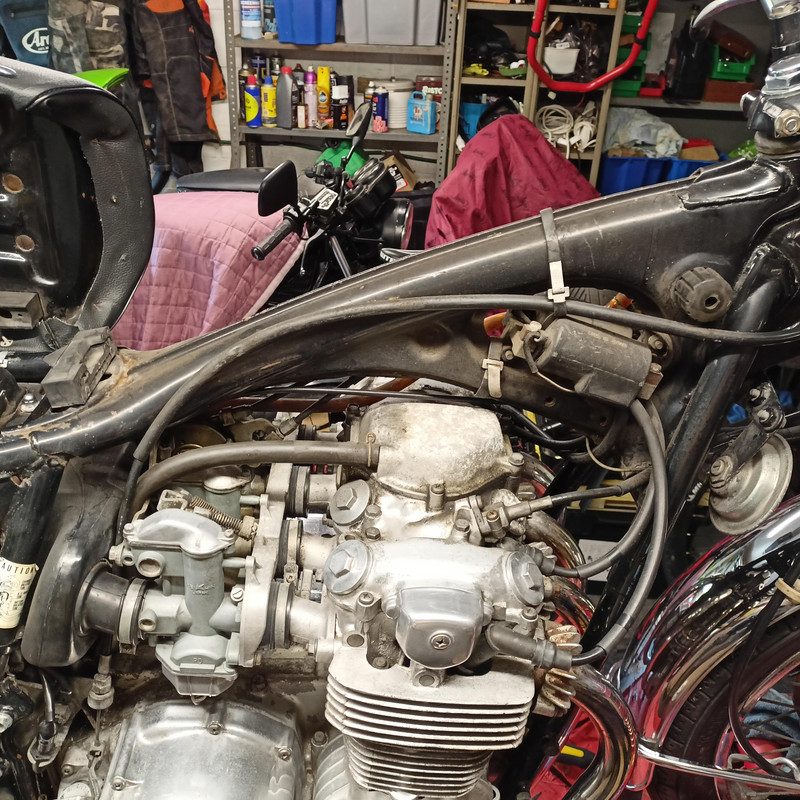

So the first thing once I’d got it on the bench was to get those carbs off, sort the seized throttle issue and leaking carbs- a job I wasn’t particularly relishing as it’s a bit of a pain in the arse getting the carbs on these in and out, ( I take the battery, battery carrier and airbox out rather than fighting with the ( rock hard in this case) carb rubbers and potentially damaging stuff ) and they would of course almost certainly be totally gunged up and require a lot of internal cleaning.
On the positive side though, taking the tank off is a breeze on these with no tools required- flip the seat up, pull the petrol pipe off, pull the rubber back that secures the back of the tank to the frame and it simply slides off- pretty grubby under there, but to be expected, and nothing scary so far

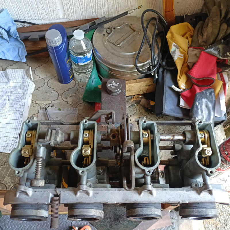

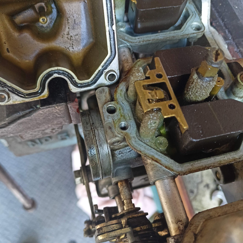

With the carbs on the bench, I started to see the state of them- a bit yucky as expected, and the seized throttle issue was down to the two outer carb slides being gummed/corroded solid in the bodies.
As the job was non-time critical (let’s face it, what’s another few days or weeks when it’s been sitting unloved for the last 10+ years : ) , I squirted a load of Plus Gas down the carb bodies over a period of a few days in the hope that would do the trick.
It did for No4, but after a week, no1 slide was still well and truly internally welded to the carb body, so out came the blowtorch which did the trick.
Once the slide was free, I could then remove it from the carb and clean it and the internal surface of the carb body up, and all was good.
Although the needles looked surprisingly decent and clean, I’d bought carb overhaul kits which included new ones so they went in.
As for inside the float chambers, pretty horrible as expected ...
I removed all the removable bits and put as much as I could through the ultrasonic bath, and after soaking in carb cleaner, gave all the air and fuel passages a good blow-through with the airline before re-assembling with new top gaskets and float bowl seals, along with new emulsion tubes, main jets, pilot jets, and float needles.

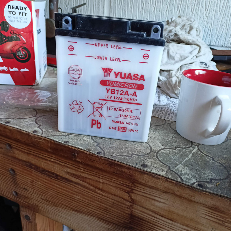

Whilst the carbs were on the bench, soaking etc, I’d had the (Motobatt) battery on charge for a few days on de-sulfate on the Optimate to see if it could revive it- the motor turned over nice and freely on the kick-start, but unsurprisingly the battery was completely dead after all those years sitting idle.
The Optimate failed to revive it, but before admitting defeat and buying a new one, I thought I’d try my Noco charger, it does Lithium as well as convential lead/acid, and it’s definitely better with deeply discharged batteries.
And FMOB, it did indeed revive it overnight, with it showing 13.4v so I whacked it back on the bike and gave it a go- here’s one of the (slightly less cringey or cheesy than most were) vids I was sending my brother to keep him up to date with progress…
I was of course being very over-optimistic expecting the battery to survive after all that time, it was worth a try, but the old one is obviously toast so a new Yuasa one was purchased from a local-ish Halfords, just for convenience really.
When I opened the box though, all was not as I’d expect as hopefully you can see in the pic, with some of the cells well down on acid (that's a different sort of acid that some of us used to get well down on in our younger years, of course )
Although I could have easily popped the lid and topped it up with distilled water, it’s a brand new battery so shouldn’t need to, so back it went for a refund- looking closer at the box it had a 2021 date on it so it had obviously been in stock a while.
I ordered a new Powerline one (I really rate these and particularly the Enduroline ones, having had a few over the years, ) from Tanya, and it arrived the next morning.
And I reckon it’s fair to say that the difference between the old and new batteries is night and day ( extra mature cheddar cheese on this vid )

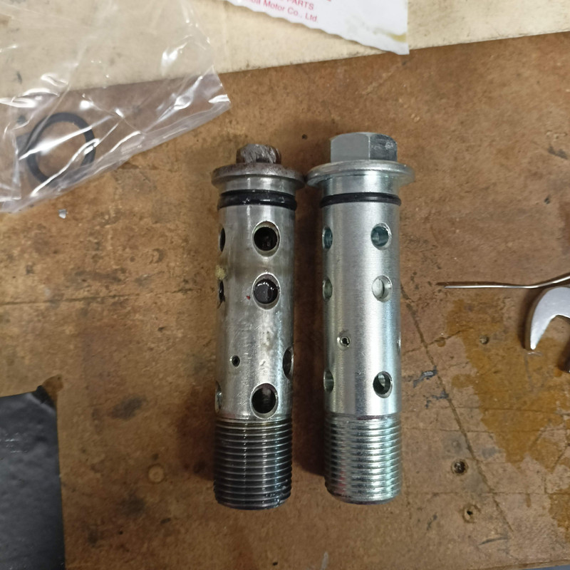

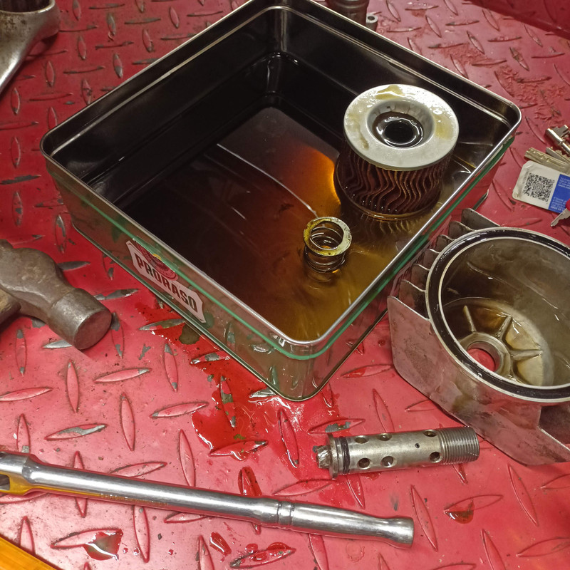

Another thing I’d also done whilst the carbs were soaking was to change the oil and filter.
The oil that was in there looked clean ( most probably because it was likely changed by the dealer when he bought it all those years ago, and had only done 20 or so miles since), but Mart had supplied me with 4l of Castrol’s finest and a new oil filter with the bike and it was of course getting changed as a matter of course.

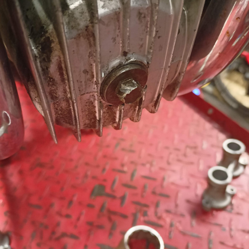

On closer inspection, it became pretty apparent, however, that although it looked as though the oil had been changed when he bought the bike, by the look of the oil filter housing , and it’s central securing bolt the filter hadn’t been done in a long time
It’s a very common occurrence on these old air-cooled Honda 4s and to a lesser extent, CX500s- the bolt itself has an M20 thread, but it only has a 12mm hexagon for your socket/spanner, at a guess to try and prevent over-tightening as it goes directly into the crankcase.

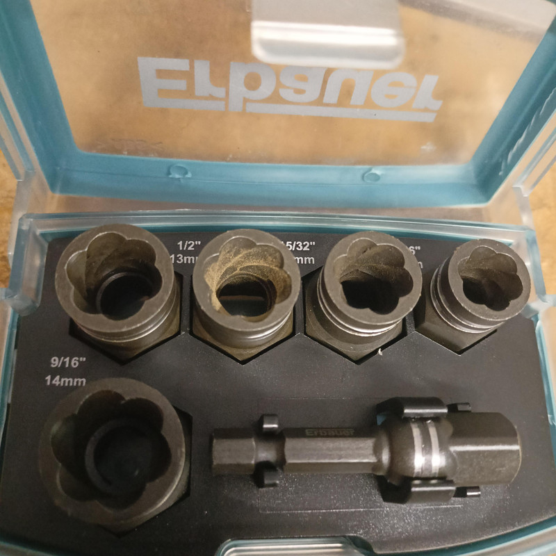

The problem is however, that it still often gets over-tightened, and even if it hasn’t been, if you’re using a 12-point socket or spanner it is very easy to round the head of the bolt, and that is obviously what has happened here, it looked like there have also been unsuccessful attempts to get it out previously too.
There's various approaches to this issue, the most usual is trying to hammer (or weld in extreme case ) a 1/2" or otherwise slightly smaller socket on there, but that can be messy and not almosts succesful.
Luckily, this very much ain’t my first rodeo, as the saying goes, and I have just the tool for the job in these grip-and-twist helical sockets, ideal for this situation
Very useful in cases like this, and made what can otherwise be a tricky ( ) job nice and easy
With the filter housing off, it was apparent that yup, although the oil was fresh, the filter definitely wasn’t.
Anyway, no matter- the old filter whilst it was a bit deformed was intact and it’s got a nice new one in there now, along with of course a new bolt- I went for one of the pattern ones with a 17mm head rather than OE Honda. I know some people are wary of using these as it is very much more possible to strip the thread in the crankcase with the extra purchase the bigger bolt head gives, but if you’re not a mechanical moron it isn’t a problem.

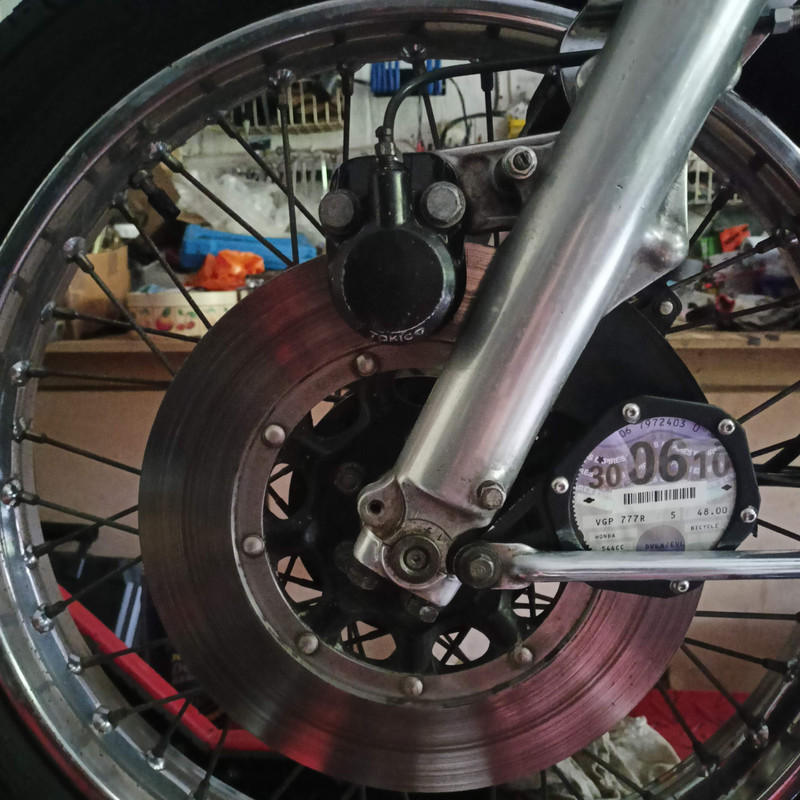

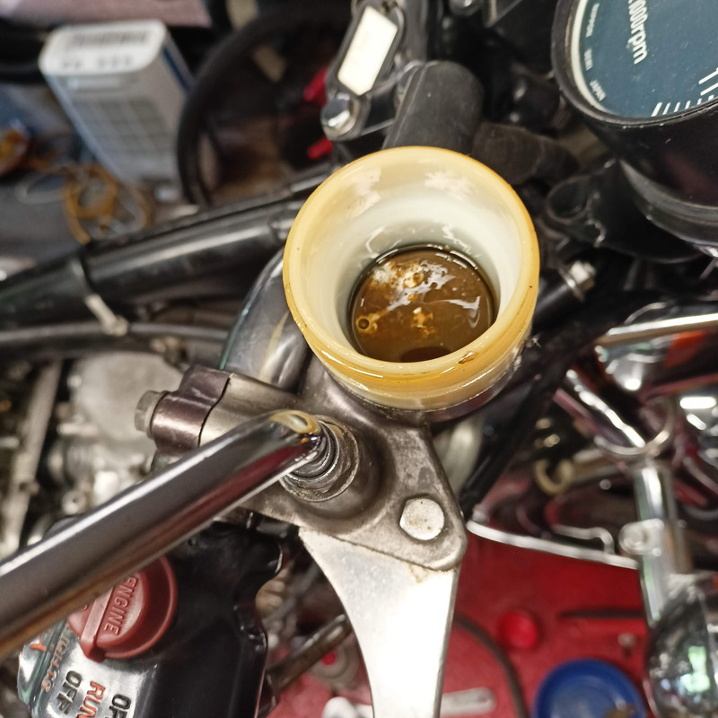

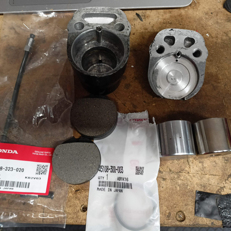

Next, I turned my attention to the front brake.
As previously mentioned, when the bike was pulled from its long-term resting place, the front brake was both stuck on, and the brake lever came back to the bar with no resistance at all, so obviously all was not well.
Mart (my brother) had taken the caliper off so it could be wheeled out of the garage and into the van, he’d also purchased a nice new OE Honda brake pipe to replace the aging and corroding one that goes between the caliper and the first part of the rubber hose, and a new set of pads and a seal kit, all from good old David Silver- as anyone who has an old Honda will know, they really are an excellent bunch, holding most things for these and other 70s/80s Hondas, at what I think are very reasonable prices too- on removing the old piston, it had some pitting on the chrome, so another order was put into David Silver for a new piston, and a few other bits for the carbs, etc at the same time- this is the disassembled caliper with old and new piston
The front brake on this era of Hondas really is a PoS design though- it’s a single-piston caliper that operates on a swinging beam, with the pad that has the piston behind it pulling the static pad onto the other side of the disc when you squeeze the lever, but a less effective brake you’d be hard to find this side of a SLS drum on an MZ I reckon, and that’s in the dry.
In the wet- forget it- they really were poor back then, as any number of us old fuckers on here will likely remember, at least the ones of us that haven’t totally reached senility will.....
Anyway, I removed the reservoir cap and sucked the nasty old fluid out. It was pretty manky in there so it got a good clean
I re-assembled the caliper with the new seal, piston, and pads, bolted it all back together, refilled with fluid, and bled it, which took all of about 10 seconds and we were there
Once that was done I adjusted the caliper swinger to give it the best possible chance of providing any retardation effect at all; - basically you just just wind the screw to the right of the caliper out until the inside (static) pad grips, then back in half a turn or so
