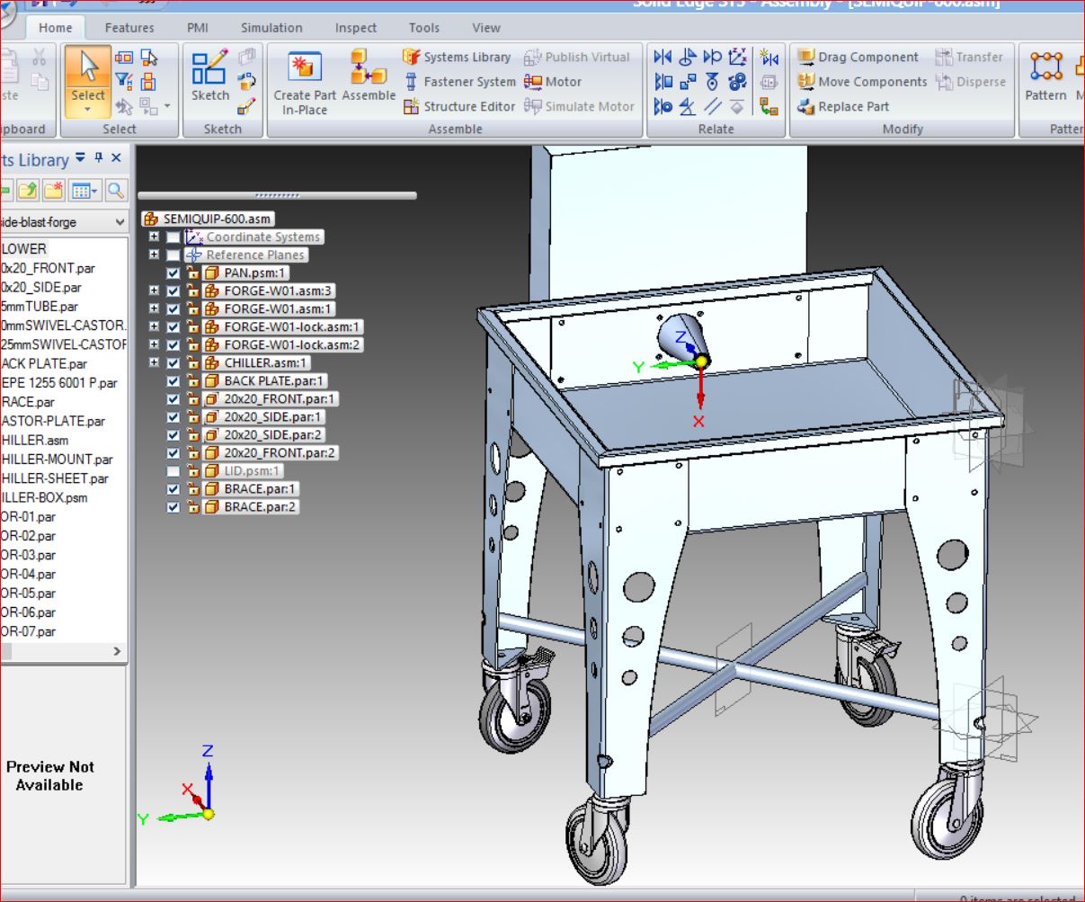

I'm building a barbeque at the moment, out of stainless, it will double as a forge with a water cooled tuyere to blow air through ( lidl airbed inflator)
It's almost finished, I got it laser cut and folded, I just needed to bolt/weld together, shame I've missed the summer.
