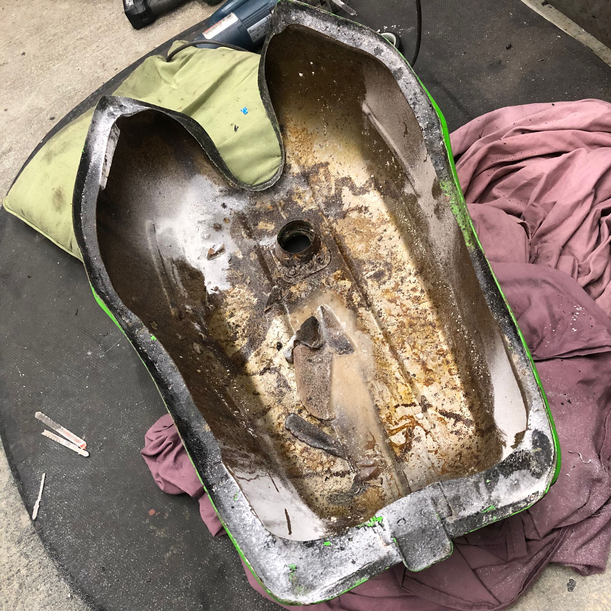

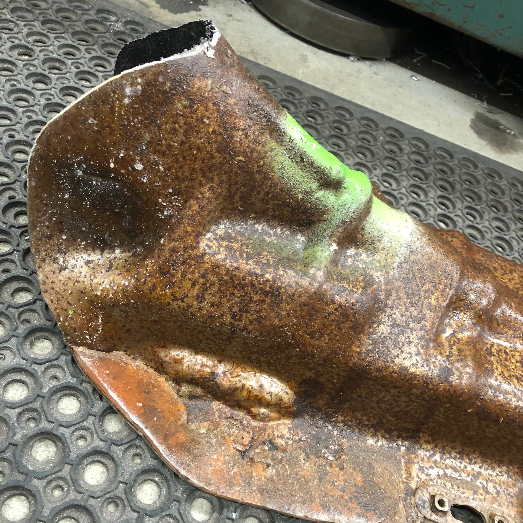

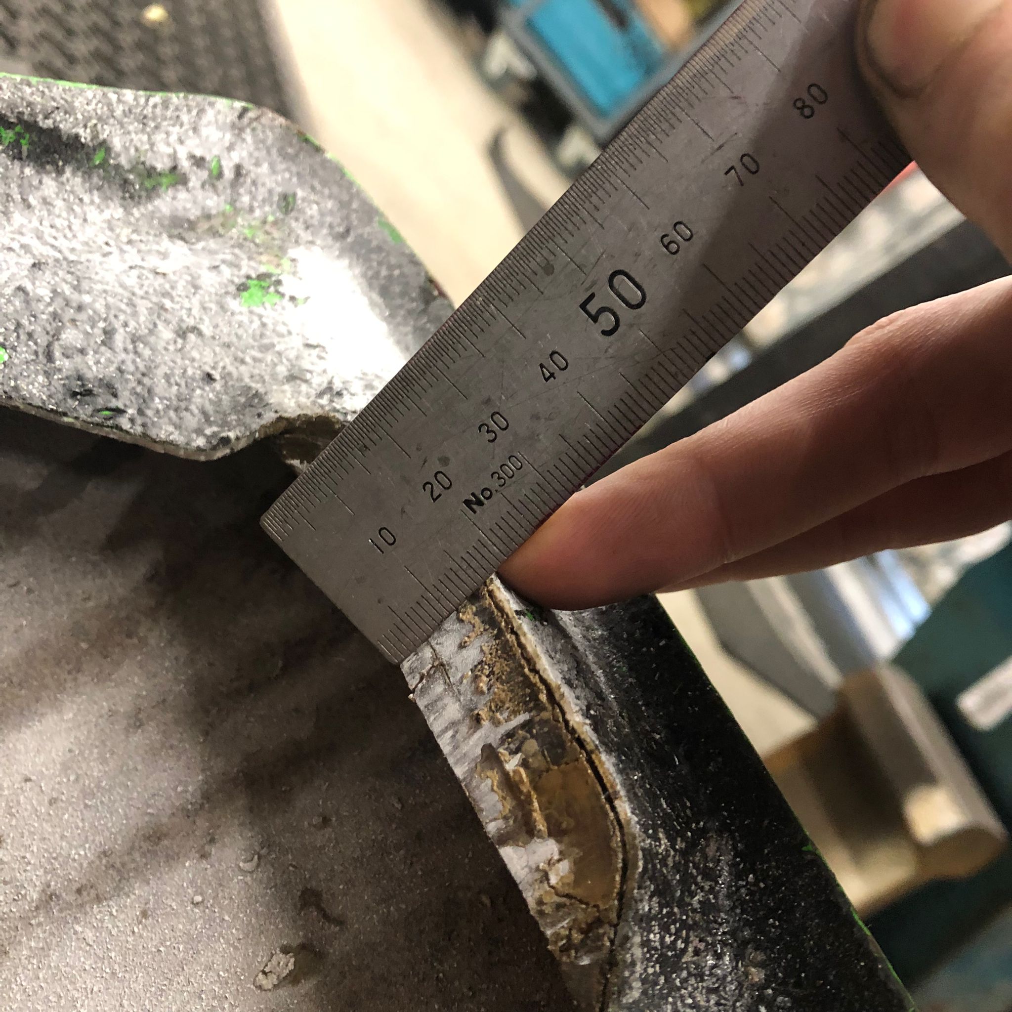

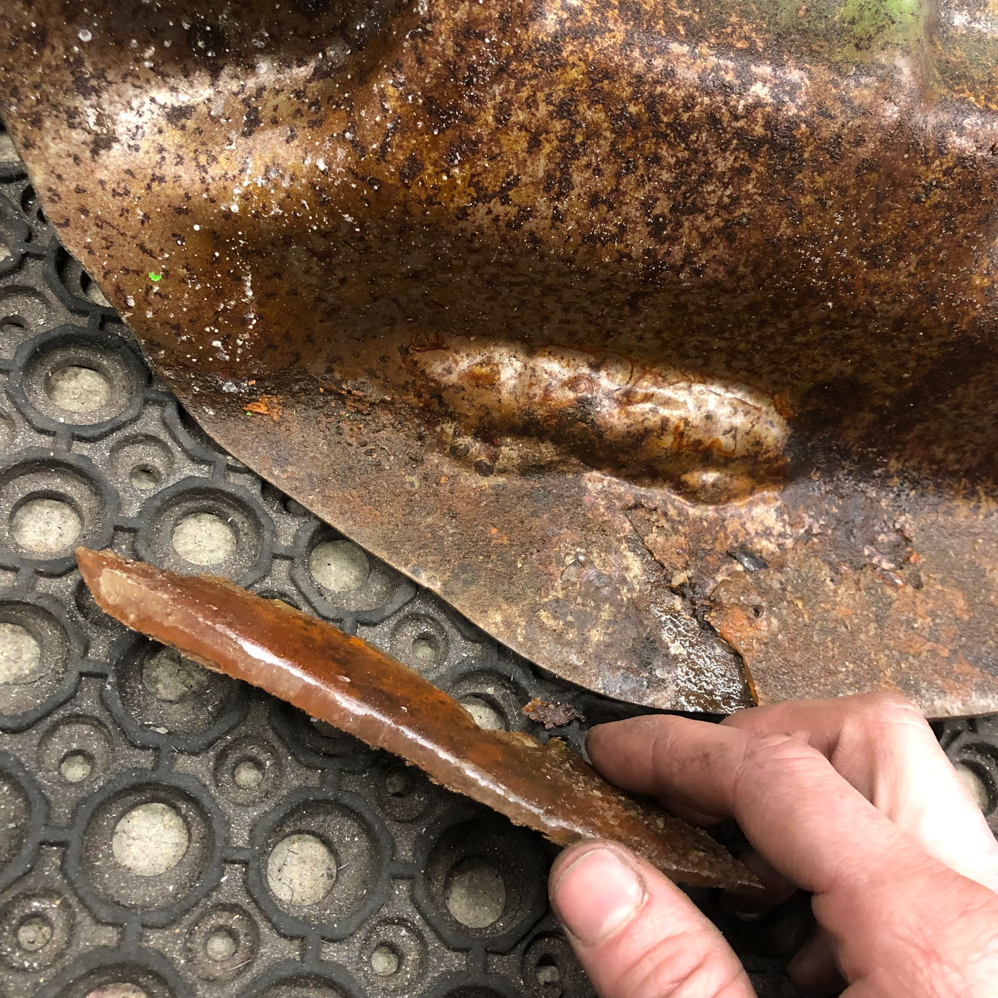

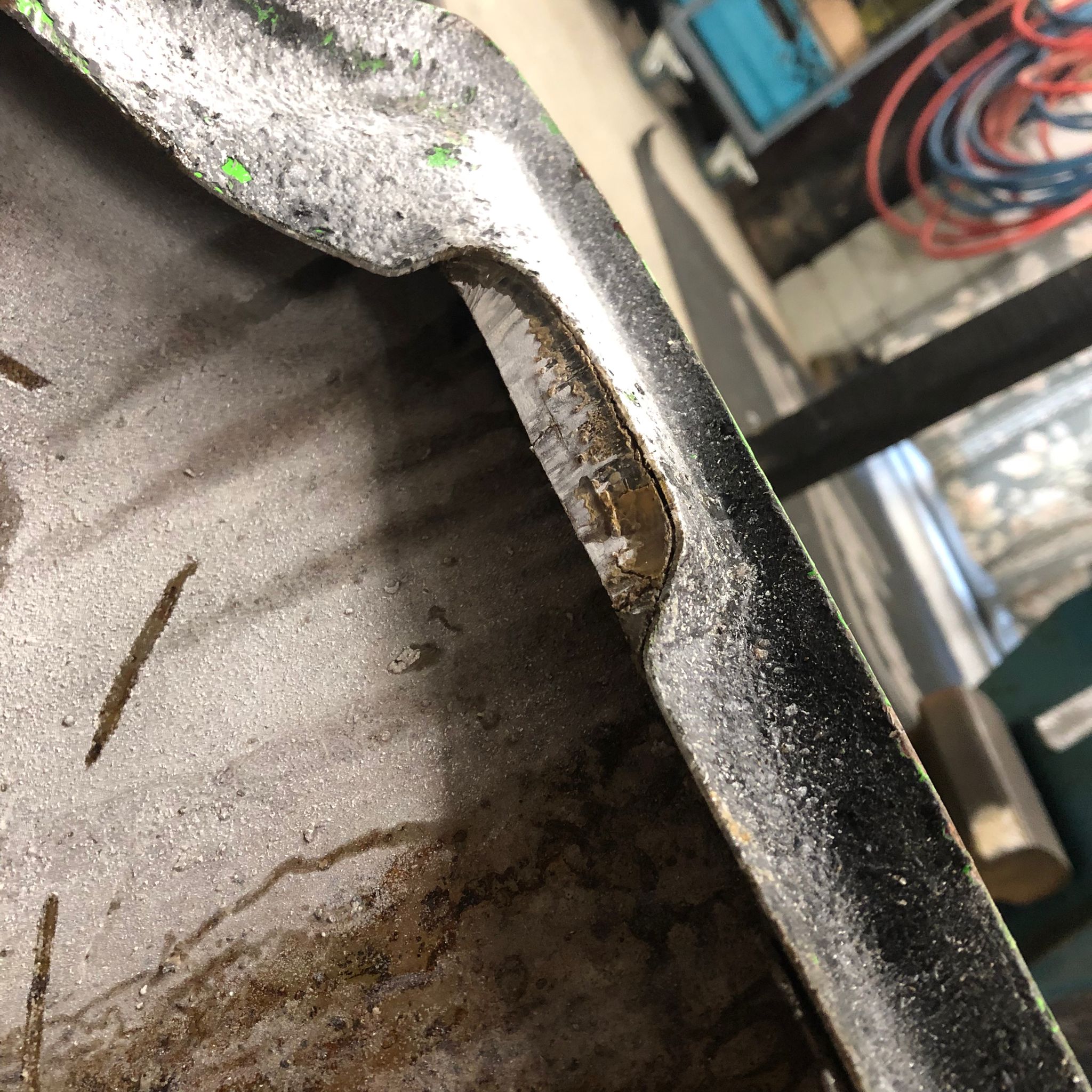

I've decided to get the worse of my Z1000J tanks refurbed, it's been resin lined at some point and the lining is breaking up, so far I've had the tank cut open by someone who knows what their doing, and the upto 15mm thick resin removed, next step getting it shot blasted.

Posts: 5463
Been thanked: 2730 times
Re: 1982 Z1000J Tank Refurb
And that's why I don't like the concept of tank sealers.

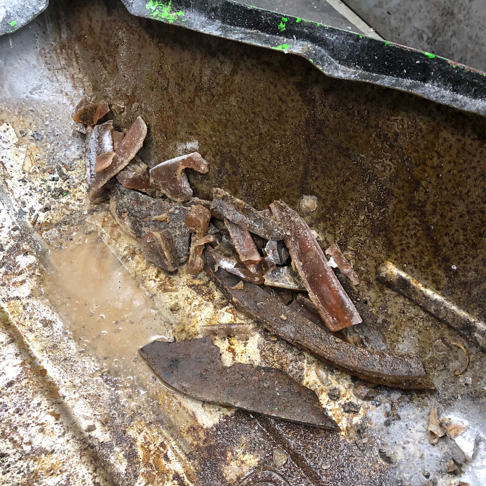

Posts: 12162
That's after it had a couple of days of tank sealer remover in it.

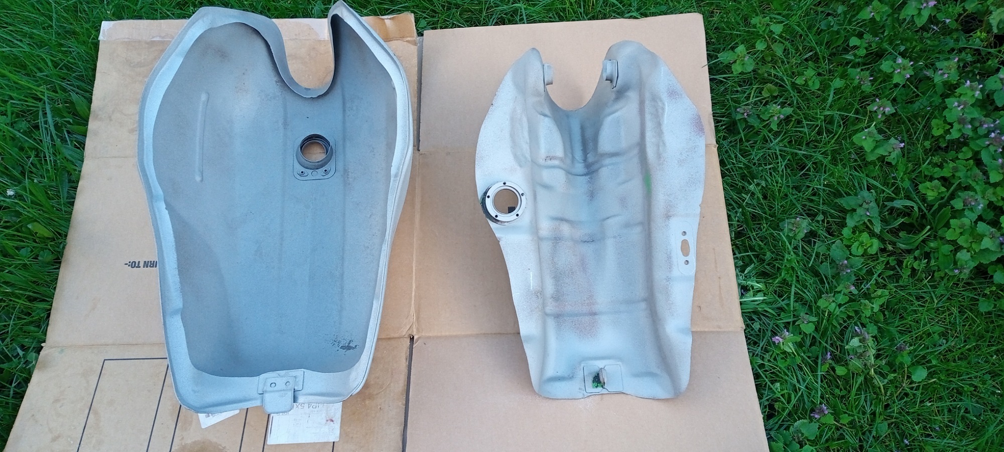

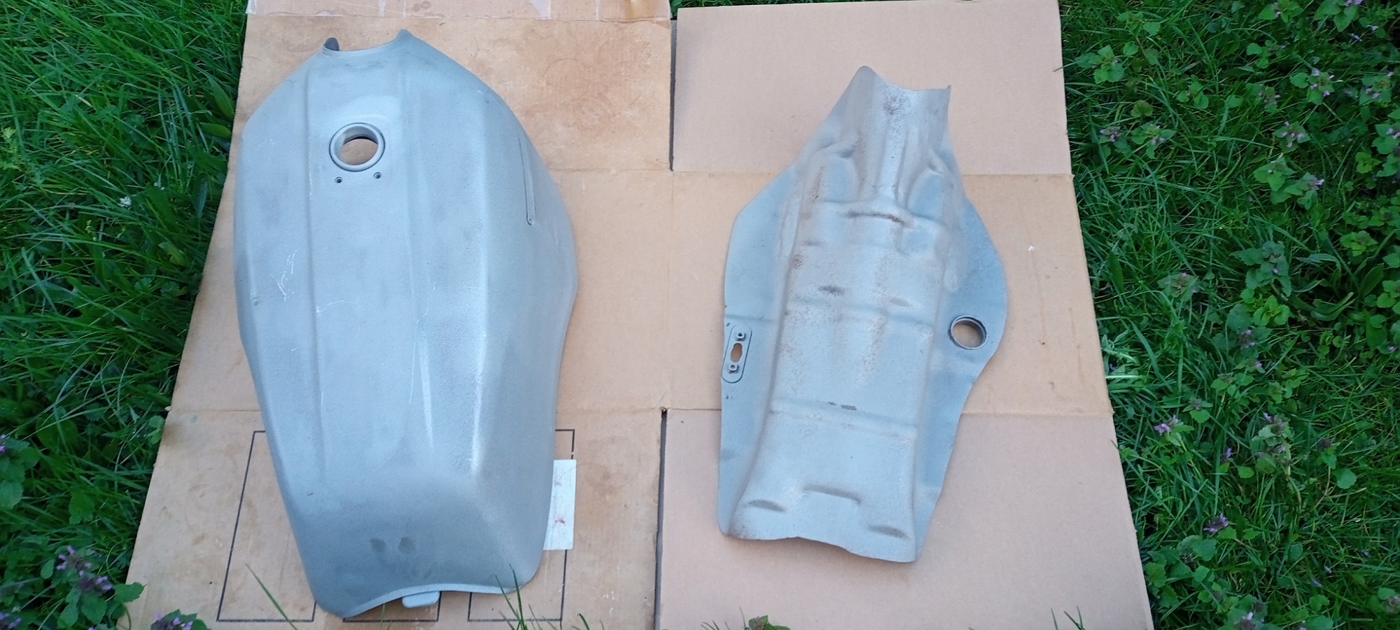

It's back from being shot blasted
I've decided to change the filler cap to an aircraft type, so I've got to wait for that to arrive before the whole lot can be welded back together and painted

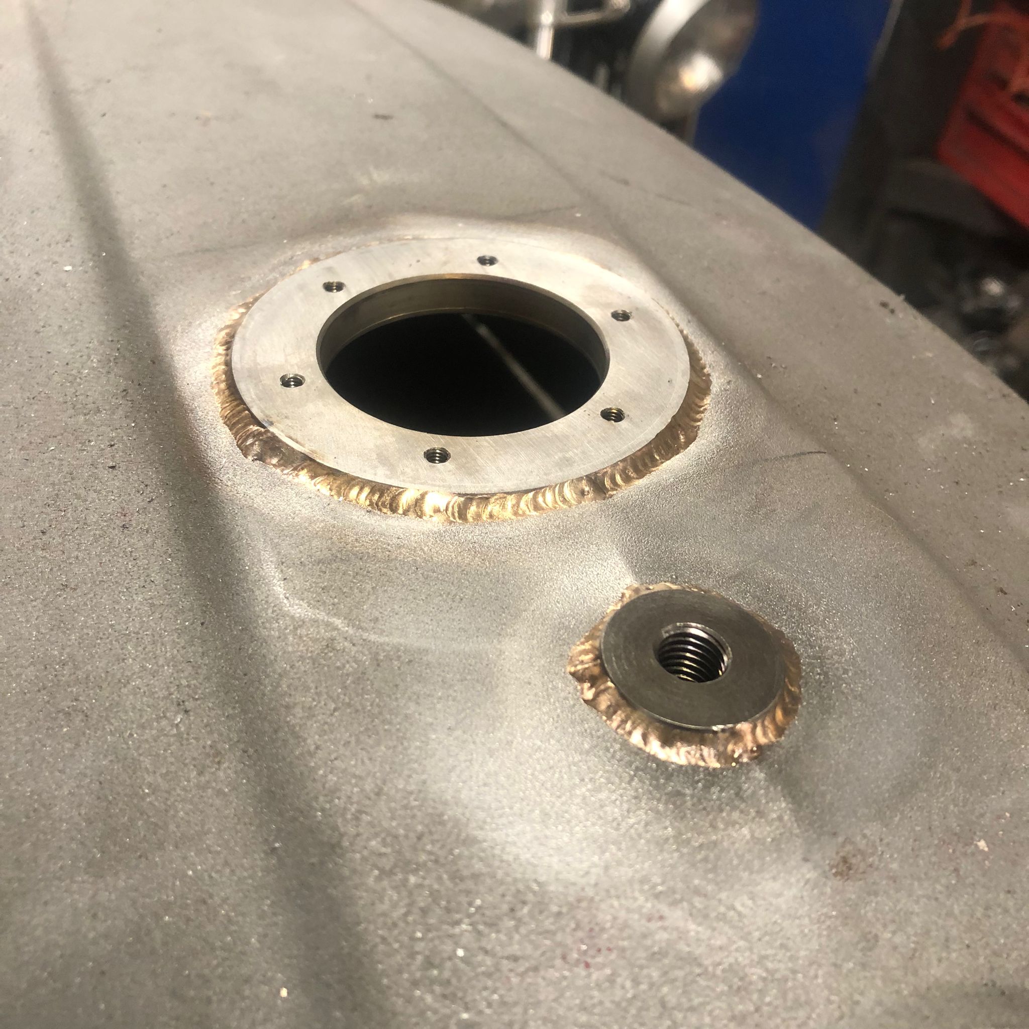

Ring for filler cap and breather welded on, it's going to get the dents knocked out from the inside next to reduce the amount of filler required when it gets painted
