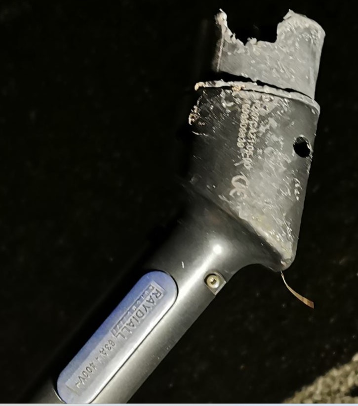

The Type 2 connector on my son's EV charging station has been damaged.
I imagine getting an entire new plug is going to be pretty expensive...these are rated at 63A whereas the only readily available ones seem to be max 32A,
The damage seems just to be to the shroud, that looks like it's probably a separate moulding but I can't see anywhere that sells them separately.
Wondered if getting one 3D printed would be possible/sensible or if a shroud from a lower amperage plug would work...type 2 shrouds should all be compatible as it's a standard size irrespective?

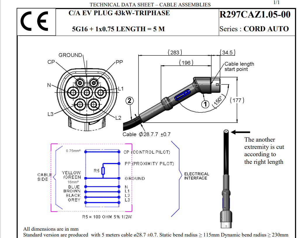

https://www.ev-chargingcables.com/sale- ... -plug.html
Ok it's in China, but it is what you want.
Looks like the 32a is 220v, but the 63a is 415v feed.

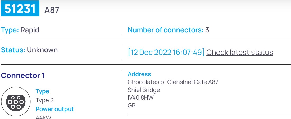

Couchy wrote: Sat Dec 10, 2022 8:59 pm AC is a max of 32A 3 phase
AC Fast chargers are max 32A 3 phase.
The 43kW Type 2 AC 'rapid' chargers are 3 phase 63A.
Couchy
Posts: 2494
Has thanked: 361 times
Been thanked: 2246 times
Re: Type 2 EV connector shroud - Make or buy?
Post by Couchy »
Kneerly Down wrote: Sun Dec 11, 2022 10:00 pm
Are you in Europe ? The 43kw are for 380v 3 phase which is a European voltage, I’d assumed you were in the UK where we have 7/11/22kw for AC and then 25- for DC. 😁
As far as I’m aware only the Renault Zoe has an onboard 43kw charger or did. There were a few charge points in the UK but they aren’t installed anymore.
Kneerly Down
Posts: 719
Has thanked: 135 times
Been thanked: 254 times
Post by Kneerly Down »
Couchy wrote: Mon Dec 12, 2022 8:03 am Are you in Europe ? The 43kw are for 380v 3 phase which is a European voltage, I’d assumed you were in the UK where we have 7/11/22kw for AC and then 25- for DC. 😁
Sorry, my mistake...it's 44kW not 43kW ;) (although the plug spec is 43kW)
