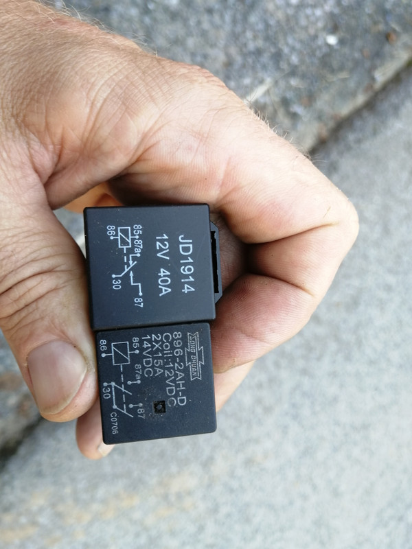

Hello all,
below you will see two relays
The one at the top was bought to replace the one at the bottom. I was led to believe they were the same. I now know they are not.
Which wires do I switch to make the new one work?

Depends how many supplies you want to switch? One or two....

v8-powered wrote: Tue Nov 01, 2022 9:08 am Depends how many supplies you want to switch? One or two....
I'm afraid I don't know :(
Its for the Air con on my van if that helps at all??
Posts: 3058
Been thanked: 1611 times
Re: Help me with this car Relay problem
Would assume it will switch the supply to the compressor maybe? If so following should work:
Pins 85 and 86 - no change
Supply you are switching - 30 and 87 on new relay
Are there cables connected to all terminals on the old relay?

You would have to remove the connection to 87a and connect it, along with the existing connection, to 87 (so both wires are on 87 and none on 87a).
The old relay switches two circuits on and off together, the new one alternates between them.
Or, buy the correct relay, which would be the better solution.

Zimbo wrote: Tue Nov 01, 2022 5:37 pm You would have to remove the connection to 87a and connect it, along with the existing connection, to 87 (so both wires are on 87 and none on 87a).
That's what I had tried to do, I thought I got the numbers matched !!
Would you be kind enough to let me know what I should be looking for, as I'd prefer the right relay if possible :)

A quick search came up with this which looks like the correct relay with 2x 15A outputs.

Big Red wrote: Wed Nov 02, 2022 1:52 pm Just realised the link I posted is for a used relay. Here is a link to 2 x new relays from China.
https://www.ebay.com/itm/115356145844
Those ones are 24v !?

Jody wrote: Wed Nov 02, 2022 7:24 am
Something like this, I'd say
https://www.electricalcarservices.com/s ... 3jEALw_wcB
They aren't that common, you need a double pole, single throw (DPST) relay, not a SPDT (changeover) relay, which is the replacement one you bought and the most common type.

Duarite 0-727-22
Lucas SRB528
Hella 4RA 003 510 137
