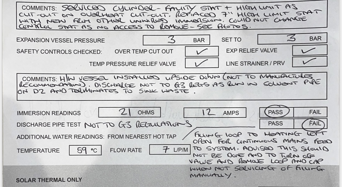

Fast forward to yesterday. I had an engineer from RM cylinders Joule come to service the immersion heater and get it working.
He mentioned a few points that got me slightly worried.
1. Hot water vessel installed upside down (against manufactures recommendations)
2. Discharge pipe does not conform to G3 building regulations (explained in the comments on his report)
3. The filling loop that was fitted to prevent the loss of hot water is a ‘mask’ for a potential underlying problem and is bad practice, and should be removed.
4. The bench mark book (attached to cylinder) has not been filled out as required on installation- please can this be done retrospectively by the installers as it’s also a legal requirement,
Here is a screen shot of the report.
Basically what I’d like to know is
Is the engineer correct
Who can I get round to say it’s been done properly or not???
The developers are slow and not helpful at all.
Sorry if it does not make sense I’ve typed it on my phone

The engineer's report sounds correct, shoddy installation, new builds.
Basically what the shoddy developer has done is constantly fill the system, as it's leaking. Think of it this way, get a bucket, pierce the bottom, fill it up.
Getting fed up with topping it up? Open the tap above the leaking bucket, but only ever so slightly.

I am not a plumber but actually assess engineers on G3 building regs (amongst other things) and all I would add is the engineer is correct.
The installation is shoddy at best and has quite a few installation issues. Also flow rate at 7 ltrs/min is very low would expect pushing double that at a tap.

It'll probably be a small leak that's causing it, but it'll be a bit of a bugger to find as it's not loosing a lot of water. Would you happen to know if it's copper or plastic under the boards? If its copper there are solutions that can be used to stop small weeps as a last resort. Ideally the leak should be rectified properly but tearing up boards and tracing pipework in a brand new property could leave you with a bit of a mess.
The filling loop needs to be refitted, continually adding fresh, oxygenated water to a system is very bad and causes corrosion. It won't have damaged anything yet but over time will cause an issue.
