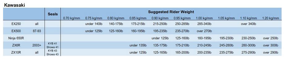

Re: MCN KAWASAKI ZX-10R (2021 - on) Review
It's a possibility, but it's completely contrary to the way fork spring rates are normally expressed. It's always per spring, not some notional amalgamation of rates. You'd only express it that way if only one fork leg was sprung.Mr. Dazzle wrote: ↑Sat Mar 06, 2021 6:35 pm Edit: Or they're just quoting a total figure for both legs...so it would be 10.75N/mm in each. Springs in parallel just sum.
Even then, that's a very high spring rate. According to the table below, that would mean the Big K assumes all their sports bike owners/riders are 280 lb/20 stone pie eating bloaters...
Nah. I don't buy it. Someone in Kawasaki's press department cocked up.
Owners forums seems to think stock bikes (last year) were 11N a side, so 22N in total if you assume Kwak are quoting the total fork as I suspect.
Two legs together is just the spring rate in each leg added together. We tend to think in terms of what's in each leg cause if you buy springs that's what it says on the box, but from a performance/design POV its the sum total of both legs which matters.
https://www.zx-10r.net/threads/stock-sh ... te.354266/
So it would seem, yes...Kawasaki do think their riders have been at the pies!
