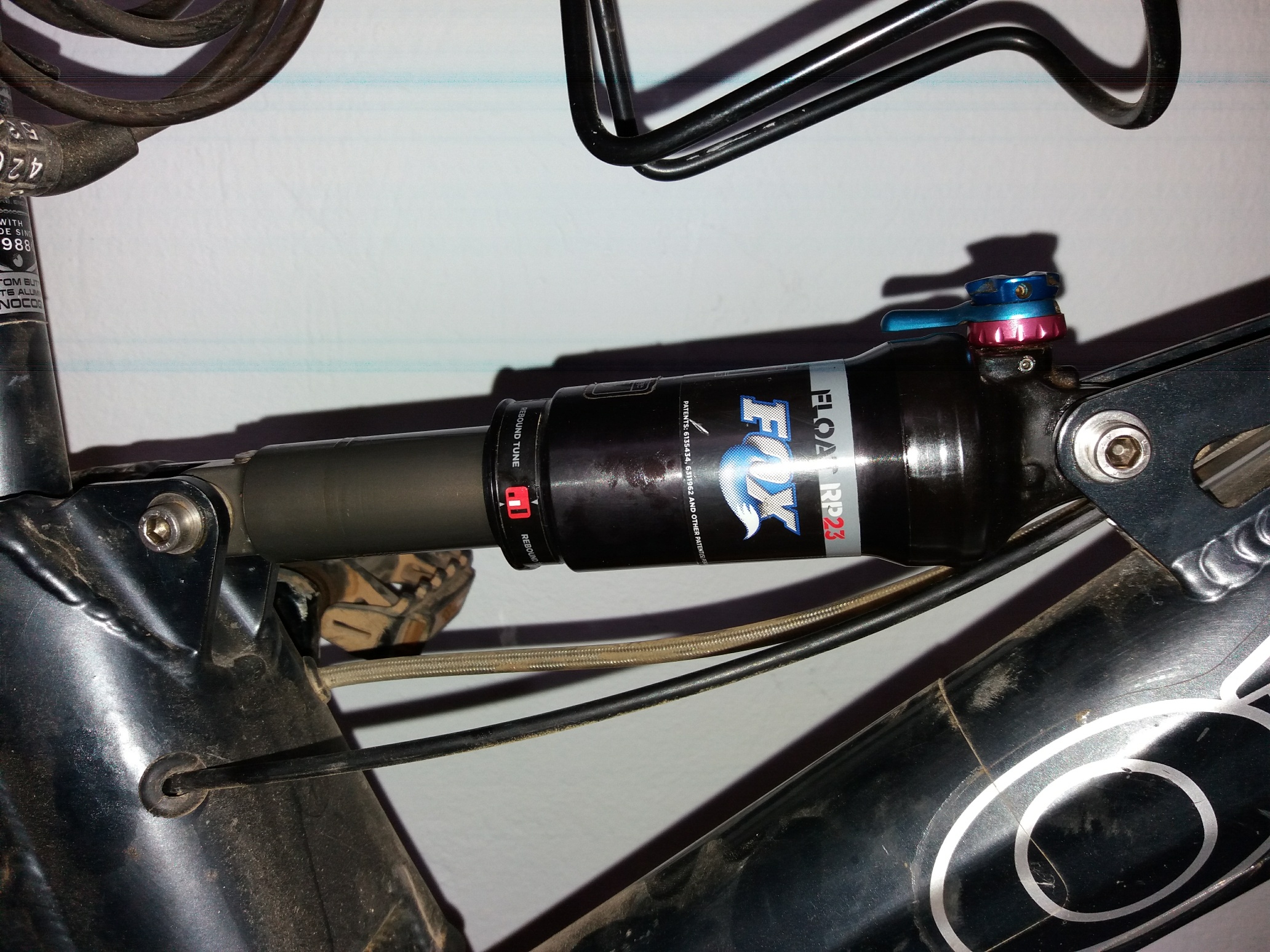

He means nitrogen. In the lower part of the shock body there's a chamber, one side is oil filled, the other side is pressurised with nitrogen (300psi ish, depends on shock) and there's a floating piston in the middle. On fox shocks this part isn't user serviceable, it has to be sent back to a repair centre. Rockshox shocks can be done by anyone with the correct tooling.

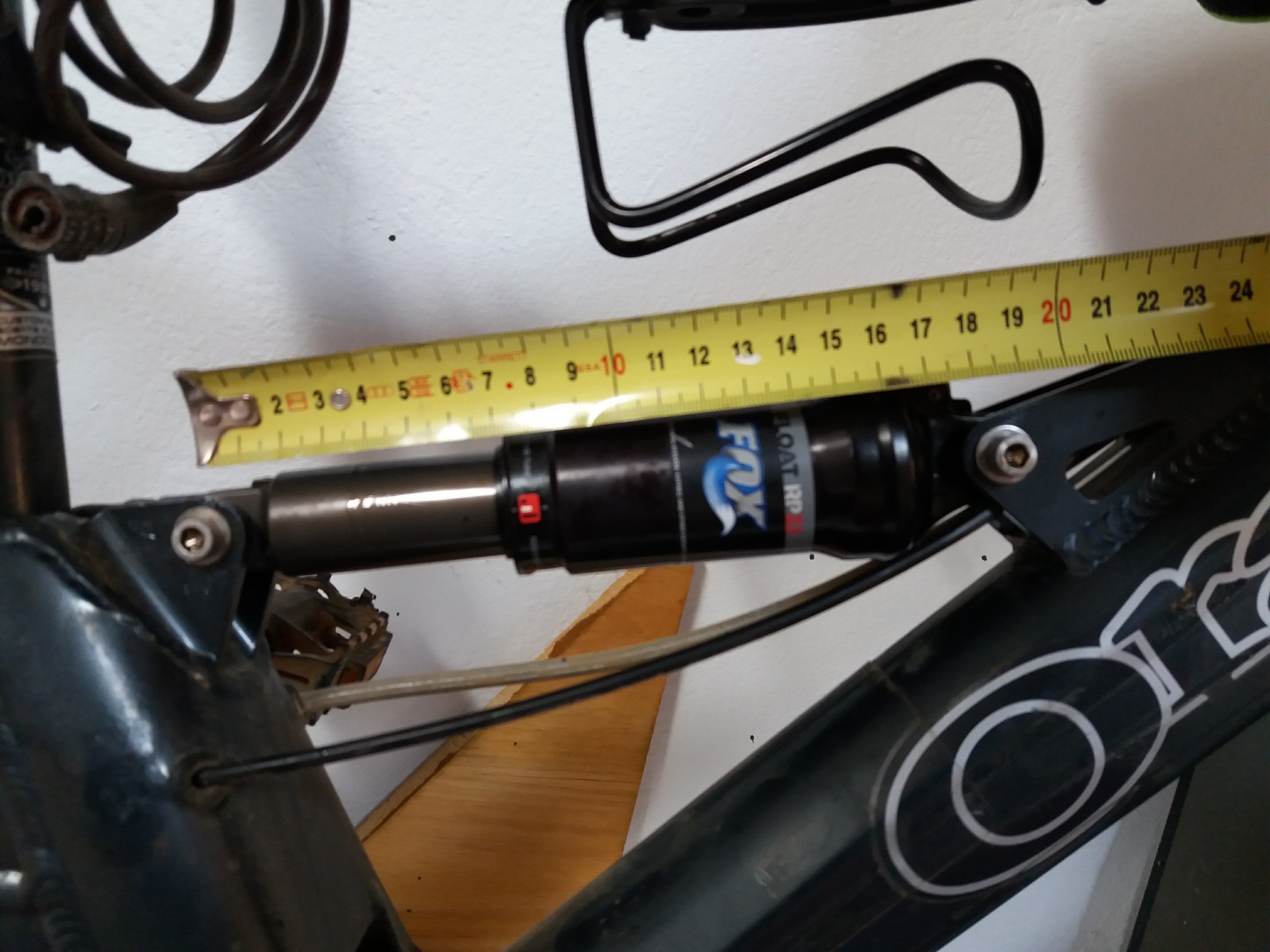

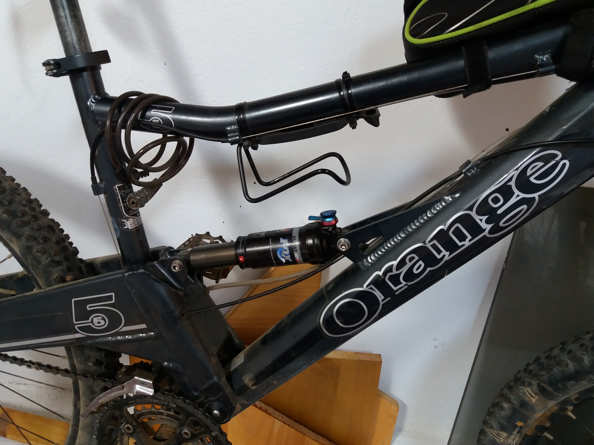

Here ya go :)
The shock has Orange 5 logo on so was made for the bike.
Will a new one be better than this one repaired?
Don't wanna Chuck money away as don't use it that much. But hope I'll like it and ride it more.
Oh and I use it as much on road as dirt.

Lol it has to be exact. Like really exact.
Shock may be 215mm or even 216mm for example but are different. 2mm or 5mm in length can be the difference between it working or not. The wrong length could mean one part of your frame hits another part for example.
Posts: 26930
Re: Talk To Me About Shocks ?
You have a Fox Float RP23 which in its day was a decent enough shock. A new £150 shock will be a cheap but new version of a shock. But technically will work of course.
https://singletrackworld.com/forum/topi ... ke-length/
Implies your shock is 190x51mm
https://www.ebay.co.uk/sch/i.html?_from ... m&_sacat=0
Bear in mind that fitting kits are different so getting a Fox would be easier
https://www.ebay.co.uk/itm/FOX-Float-RP ... ondition=4
But still the same sort of price.

Length 190 (oops measured full length initially )
Stroke 80.
