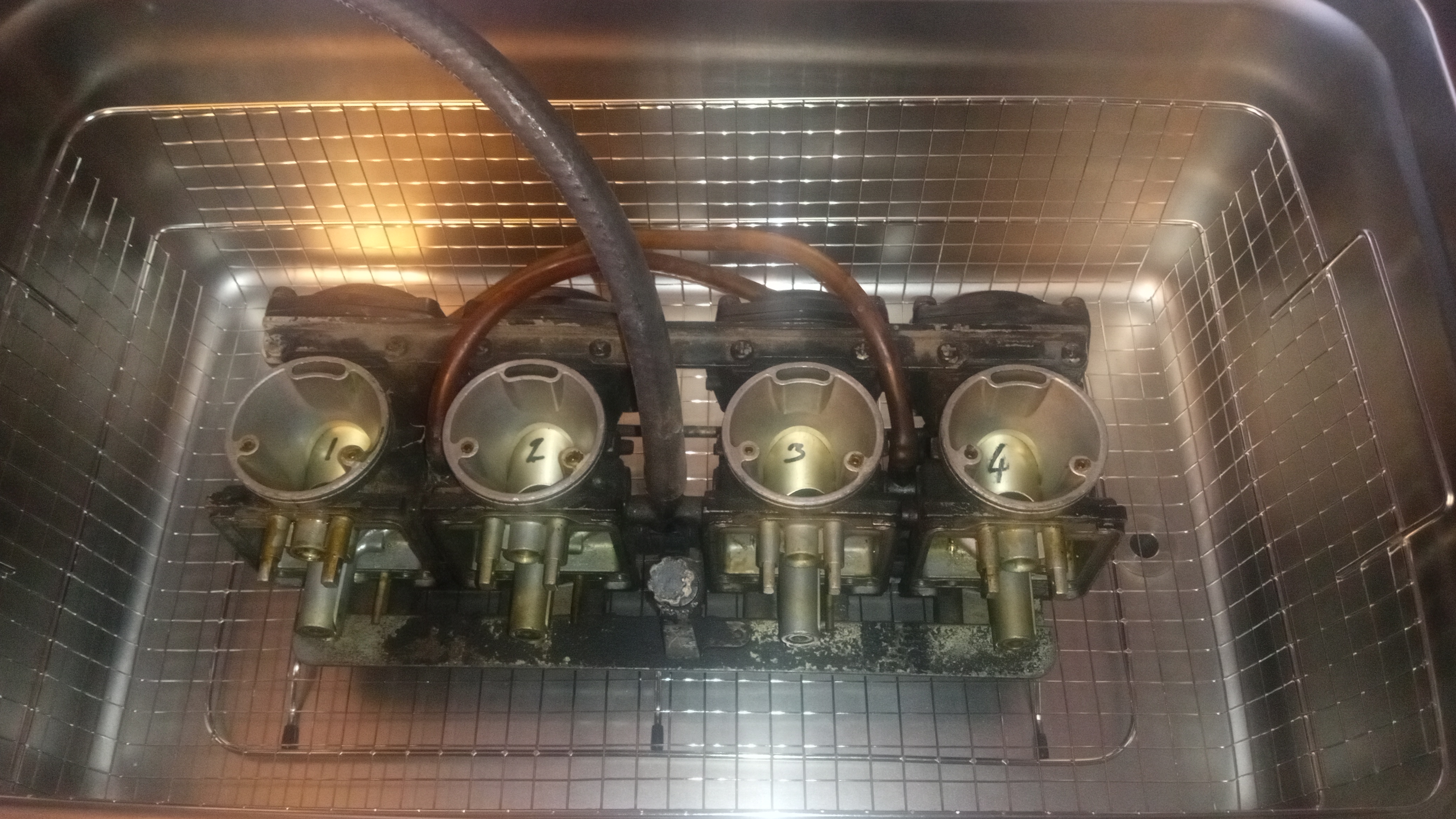

I've got a small(ish) 10 litre ultrasonic cleaner and a 30 litre one. The 10 litre comfortably takes a single carb, the 30 litre comfortably takes a bank of 4 VFR carbs while still bolted together in a V. Dunno if it would manage a bank of IL4 carbs or not.
One thing I discovered early on is that you need to properly degrease any items before you put them in the cleaner, as it hardly touches grease. Give anything greasy a really good going over with your solvent of choice and make sure they are free of any grease residues. then dump them in the ultrasonic tank. Carb cleaning fluid for ultrasonic cleaners is available on eBay.

Re: Ultrasonic Cleaners
mangocrazy wrote: Mon Jan 13, 2025 12:27 pm I've got a small(ish) 10 litre ultrasonic cleaner and a 30 litre one. The 10 litre comfortably takes a single carb, the 30 litre comfortably takes a bank of 4 VFR carbs while still bolted together in a V. Dunno if it would manage a bank of IL4 carbs or not.
Easily.
