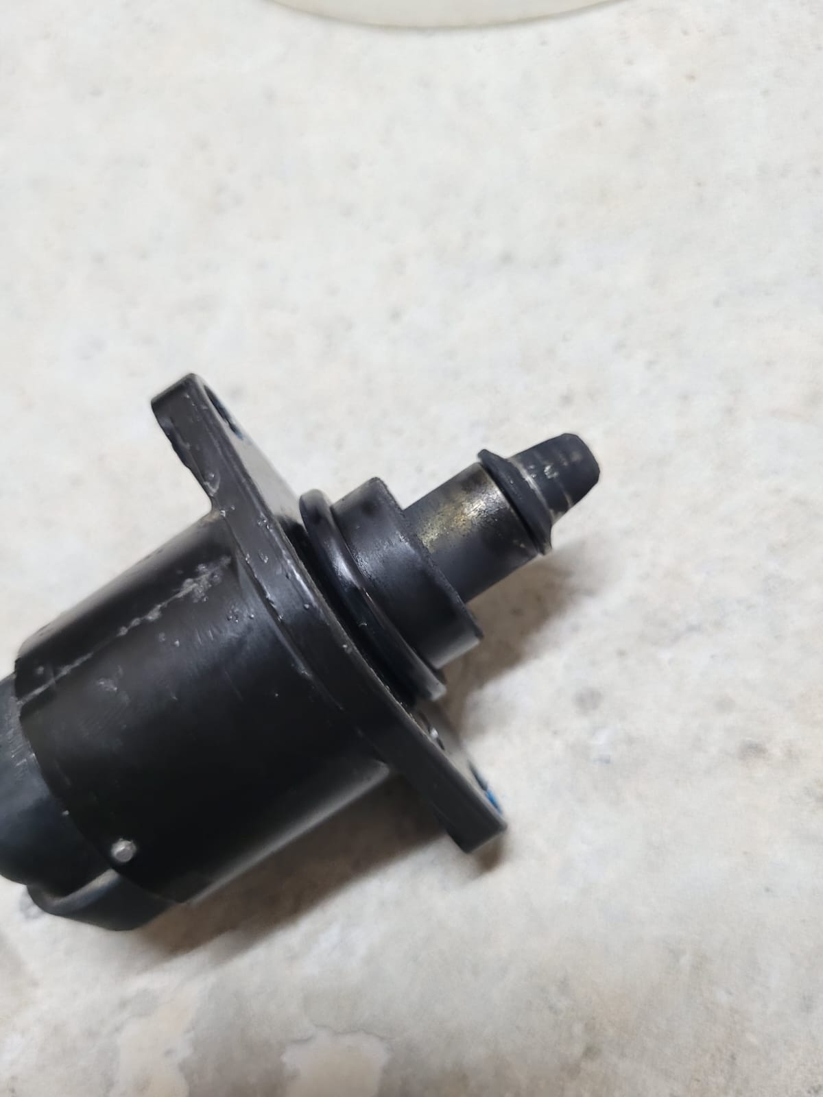

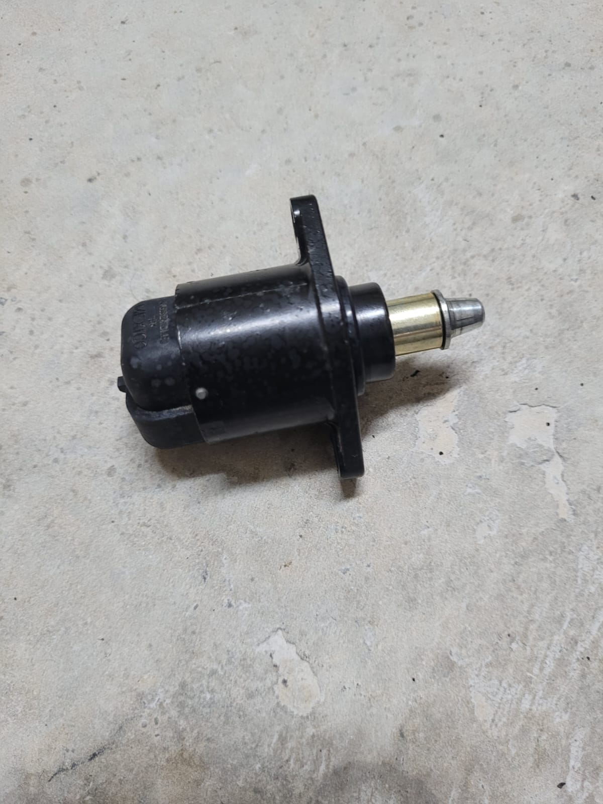

I also removed the IACV. Before:
IAC before.jpg (82.49 KiB) Viewed 1238 times
After:
IAC after.jpg (177.19 KiB) Viewed 1238 times

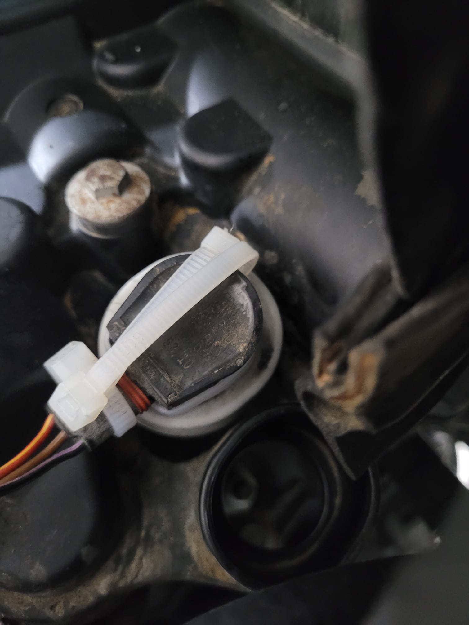

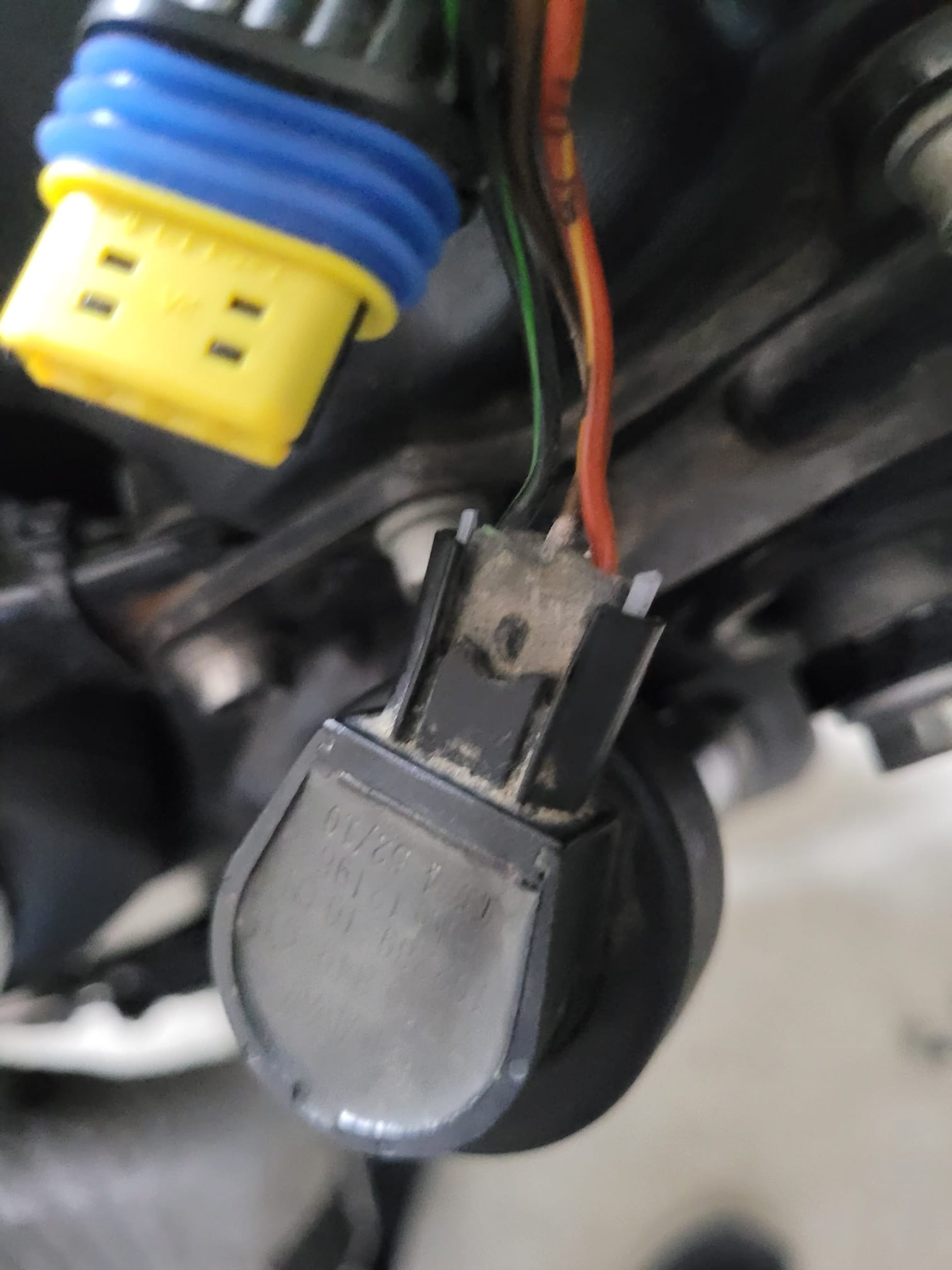

And here's the fix (bodge) for the melted coil plugs.
Two different methods, depending how fucked the coil is.
cable ties1.jpg (140.03 KiB) Viewed 1236 times
cable ties2.jpg (152.13 KiB) Viewed 1236 times

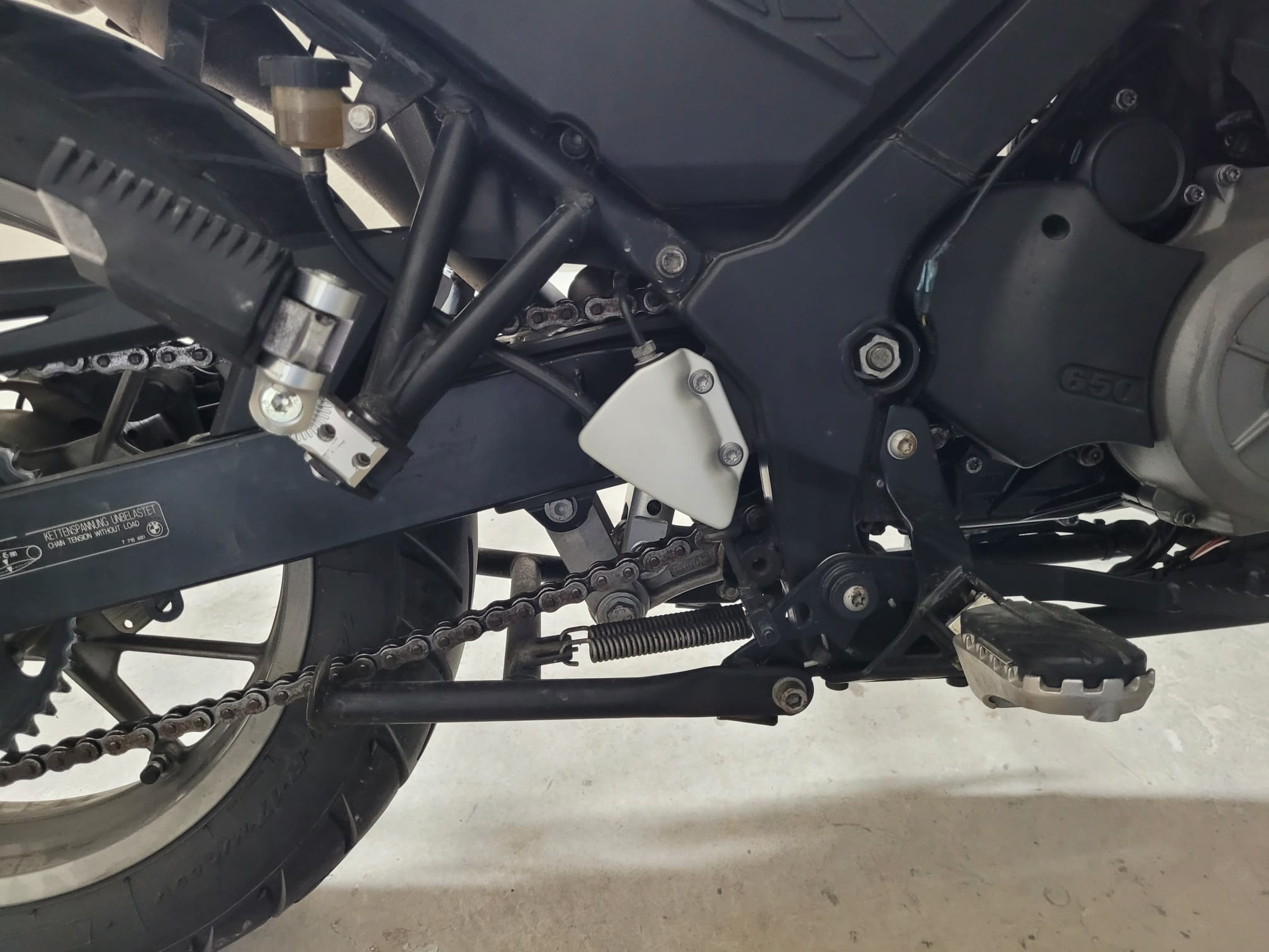

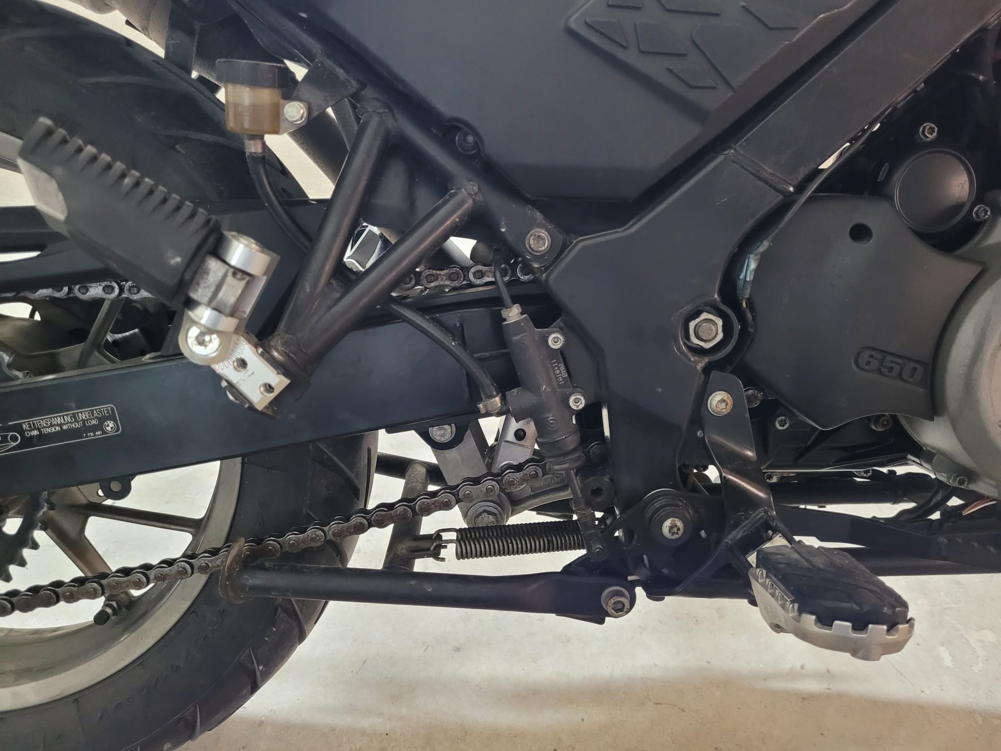

Bike all back together, I gave it a little gift of jewellery.
BMW didn't fit a master cylinder guard from the factory.
without heel guard.jpg (222.94 KiB) Viewed 1226 times
Due to that, the previous owners' boots have worn away at the little rubber boot on the master cylinder. I guess I'll eventually get to rebuild it for that reason, but anyway the stock part from a 1200GS fits and looks the part. I even used some spare bolts from the LED indicators to fit it, they are newer-looking, have a bigger/nicer head, and a torx fitting.
