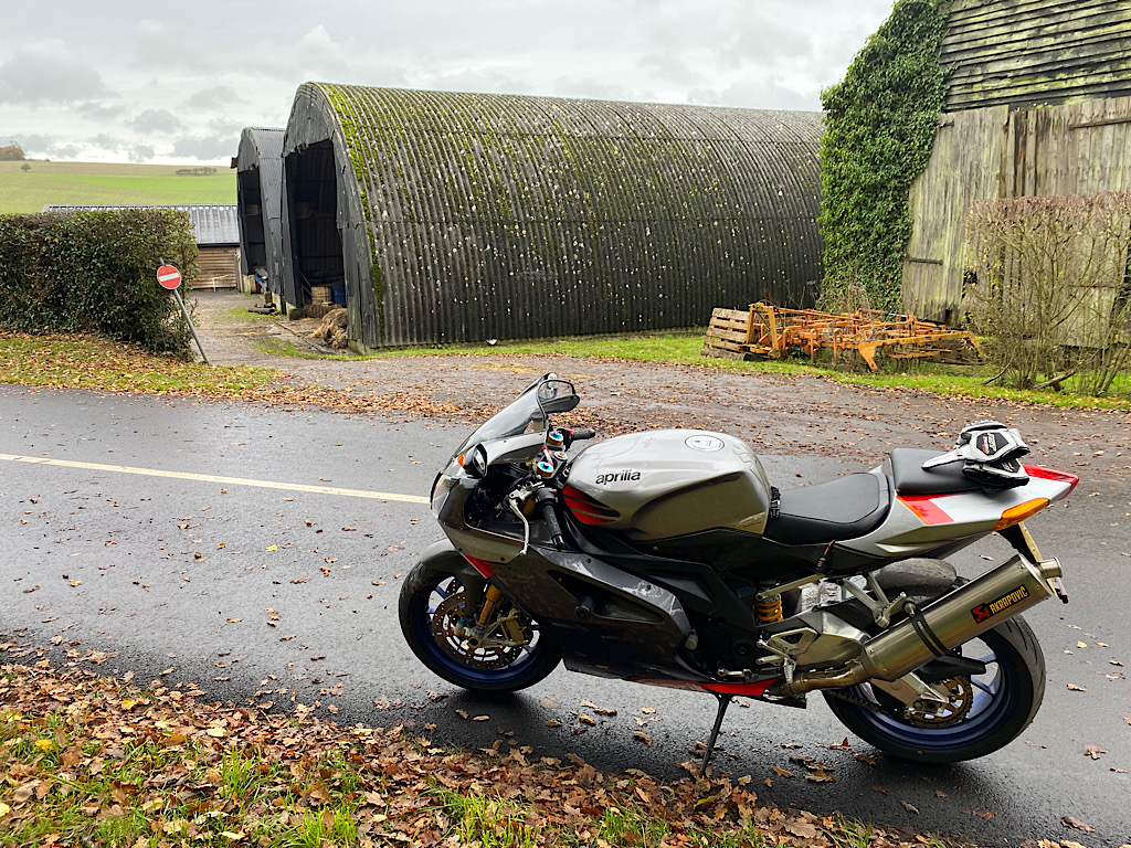

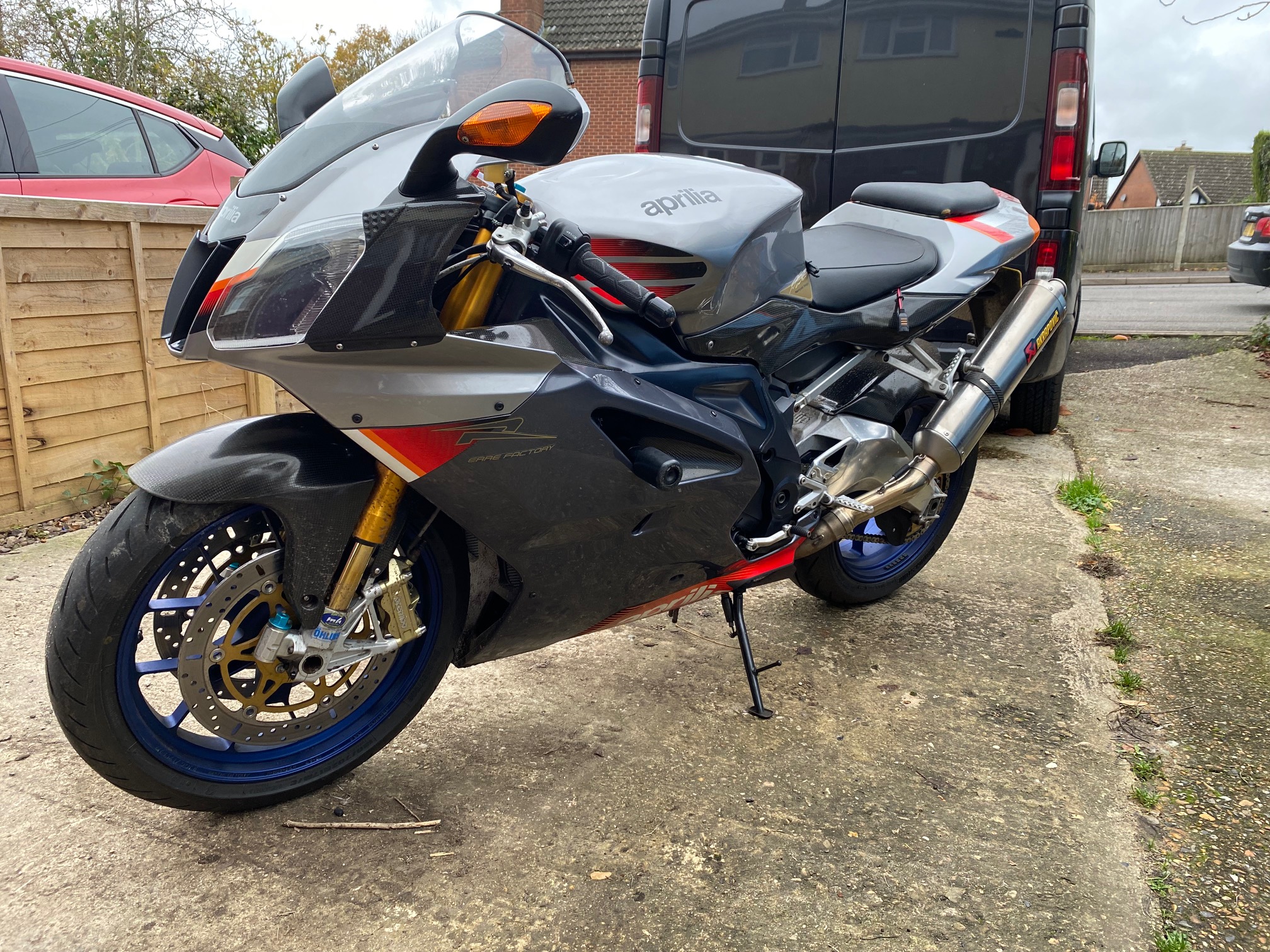

Re: Project Aprilia
Sorted out the insurance and tax as I really wanted to take it out. Was a bit grim today with some slippery roads but mostly it was ok.
Came up nice with some muc-off and a jet wash though.
Bad points...
- Odd little occasional knock from the front end. Suspension has just been serviced and bike has been mot so could be pad/disc movement so will check that out and strip the front end to fix whatever is needed.
- Big hesitation with wide open throttle application. Light throttle is fine but big applications cause it to bog down for half a second, launch forward and hesitate again. Bit sketchy with the roads as they are but was completely rideable and will start looking at this issue when I get time. Will start with plugs and move through the electrics and fuel. Fuel that was in it hasn't been in there for an excessive amount of time and I mixed it with new super before riding it. Could be a partially blocked injector though I guess. Will find the issue.
- Clutch is so so so heavy. Will work out with my left hand.
- Horn is where the indicator switch should be which is irritating.
- The mirrors are shit
Good points...
- Sounds awesome
- Suspension is ace given how crap the roads are, very confidence inspiring. Hit a big lump of shite on the road that was at least 6 inches tall. Was following a car and couldn't avoid it at the time. Must have deformed the muddy lump quite a bit but the suspension just soaked it up amazingly. Rear suspension is hard but fine.
- Steering initially feels heavy but after ten minutes feels brilliantly stable.
- It's not that uncomfortable... it's not sit up bike comfy but it's ok.
- It looks the bollocks and felt really special to ride.
- The engine (misfire aside) feels just lovely
- Gearbox is excellent
- The throttle response is superb, just refreshingly perfect after the KTM
So there you go, work to do but I love it. KTM will be up for sale in due course.

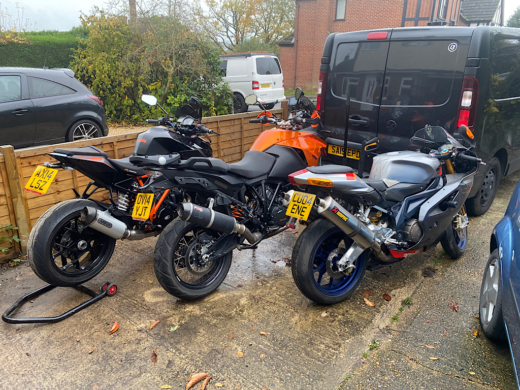

Re: Project Aprilia
V-twins in (next to) da house.
Never used to like v-twins, funny how things pan out.
