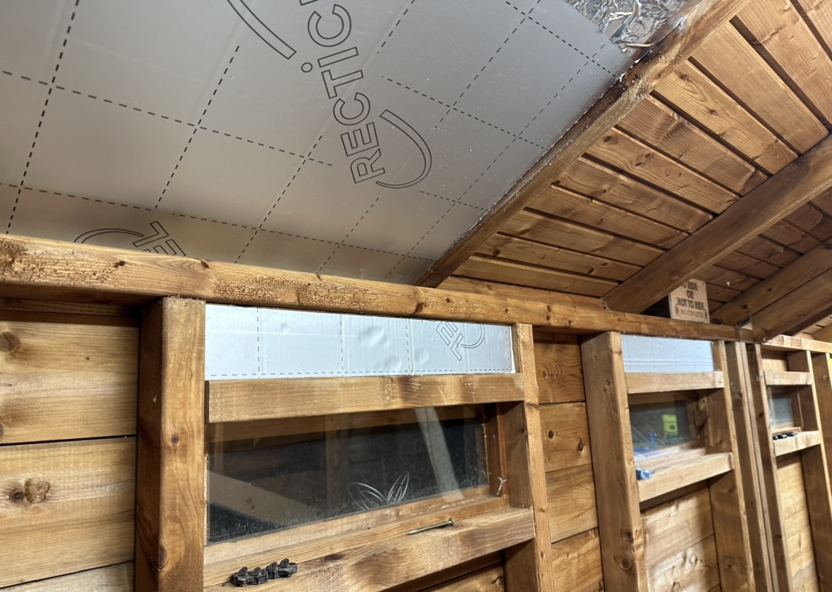

Used a little off cuts to fill the small bits

demographic wrote: Sun Nov 19, 2023 7:54 pm Through the vapour barrier onto the studs. So they hold the vapour barrier holds on til yer fixing the OSB on.
Oh and make sure theres something to fix the OSB to, especially on corners.
Staple barrier to the studs
Screw roof to studs
CBR650r :mrgreen:

Once the OSB is fitted to one plane is there a stud to fix it to in another?
You often have to put additional studs/noggins in to fix the boards to, youll work it out I'm sure.

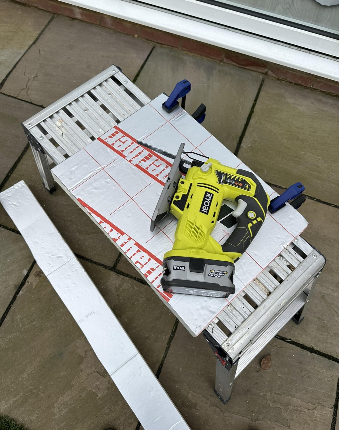

So, found a new type of blade for the jigsaw that are for soft material.
OMG….. so so much cleaner and less f@!king about.
Now I need to work out how many boards I need to do a 4.5x1.70 shed.
