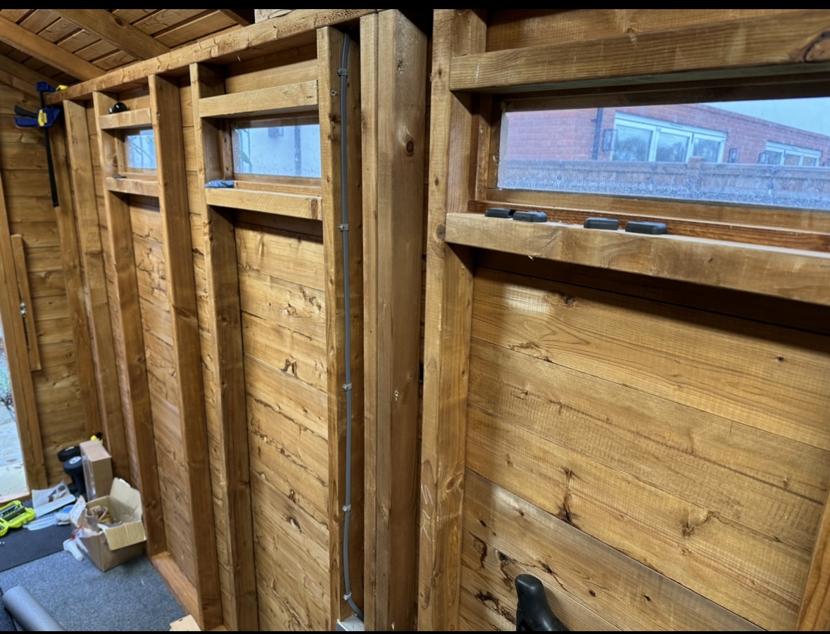

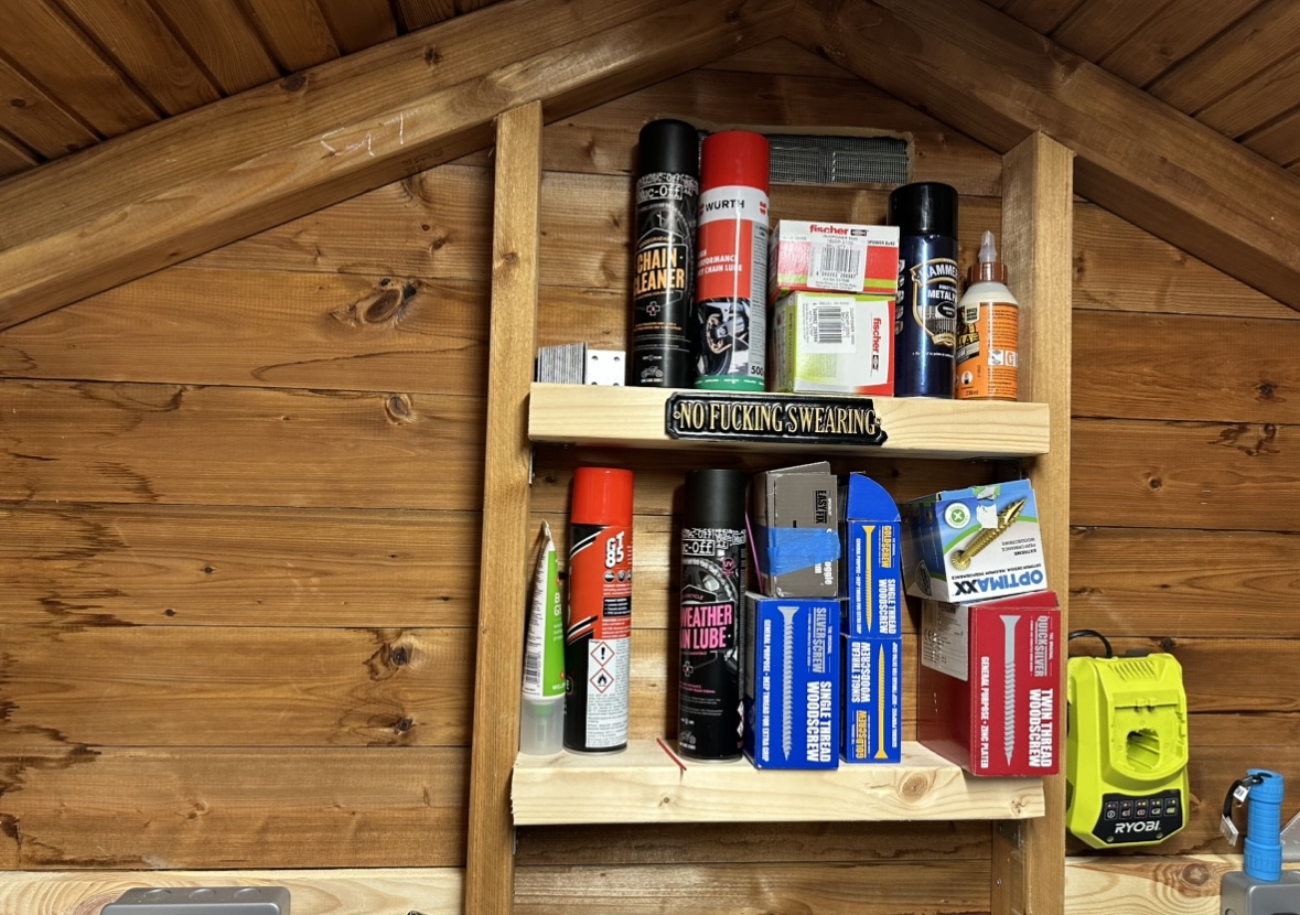

So how much of the shed could I leave without the insulation???
For example I’d like to leave the back wall as I keep stuff there.
Also does the roof need doing??? I know it will make it better but am I wasting my time if I do 3/4 of it and no roof?

More is better but why not do the walls and see how much difference it makes? Personally, I'd do the roof even if it was thinner stuff than the walls (and not bother boarding it) but that's me.
PS it looks like you've had a bit of damp getting in on the left on the back wall?

I know what you meanCount Steer wrote: Sat Nov 18, 2023 1:51 pm More is better but why not do the walls and see how much difference it makes? Personally, I'd do the roof even if it was thinner stuff than the walls (and not bother boarding it) but that's me.![]()
It feels dry to the touch and I can’t see any holes.

Knots can shrink in summer and swell in winter. We used to treat them with something called 'knotting' but I just treat them with all-weather silicone. Wipe it on and press in/smooth it with my thumb.formula400 wrote: Sat Nov 18, 2023 10:17 pmI know what you meanCount Steer wrote: Sat Nov 18, 2023 1:51 pm More is better but why not do the walls and see how much difference it makes? Personally, I'd do the roof even if it was thinner stuff than the walls (and not bother boarding it) but that's me.![]()
