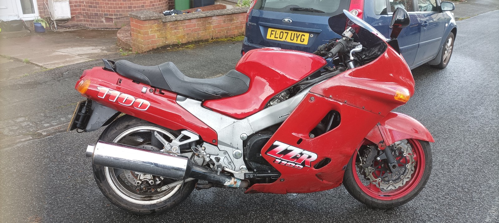

It's back on two wheels
Currently sporting a zrx1200 front with zx12r discs
Fit's straight on, the rear is being a pain, different bolt pattern for the rear disc, it will have to wait
Felt very nice on a short test ride today, maybe one of the Harrison 6 pots needs a quick clean

The poxy rear wheel won't fit, different disc(which I bought) hugely different cushdrive set-up, I don't have the time or dosh to be messing around like that, so I'm looking for a plug and play version, seems some zx7/9's maybe but no concrete evidence on the net
Re: Zzr1100d
Ssray wrote: Wed Jun 14, 2023 8:37 am The poxy rear wheel won't fit, different disc(which I bought) hugely different cushdrive set-up, I don't have the time or dosh to be messing around like that, so I'm looking for a plug and play version, seems some zx7/9's maybe but no concrete evidence on the net
Damn, thats annoying!! Normally the dedicated forums have the answers to these type questions. Is there a zzr1100 forum?

Thanks, I'm a member of all of those,plus a few more, I'm thinking of looking up the cush drive rubbers part number and see what else they fit, then I should be able to get the correct sprocket carrier, the zrx12 wheel may still fit.
Posts: 9040
Has thanked: 2289 times
Been thanked: 2673 times
Re: Zzr1100d
Ssray wrote: Thu Jun 15, 2023 6:24 pm I'm thinking of looking up the cush drive rubbers part number and see what else they fit, then I should be able to get the correct sprocket carrier, the zrx12 wheel may still fit.
I know people fit ZX11 wheels to ZRX's so it should be doable.

The MOT is up as of last Friday, so I thought I'd do some jobs on her and also this month I'm having to do a load of work on the family car(brakes,tyres and new Aircon condenser, hopefully fitting next week end)
So I've found the l/h frame spar has a dent, the tank lines up correctly,so I'm thinking it's a dent rather than a bend
So ... Do I reframe it? just use it as it is ? If I keep it I'm probably going to get a used 4 into 1 as the std exhaust weighs about 20lbs per side.
The brakes have never inspired confidence, even with the r1m master cylinder, I've used a few calculators online but I'm not sure £309+ is the way to go.
Posts: 9040
Re: Zzr1100d
Dented frames are fairy common, how bad is it?
