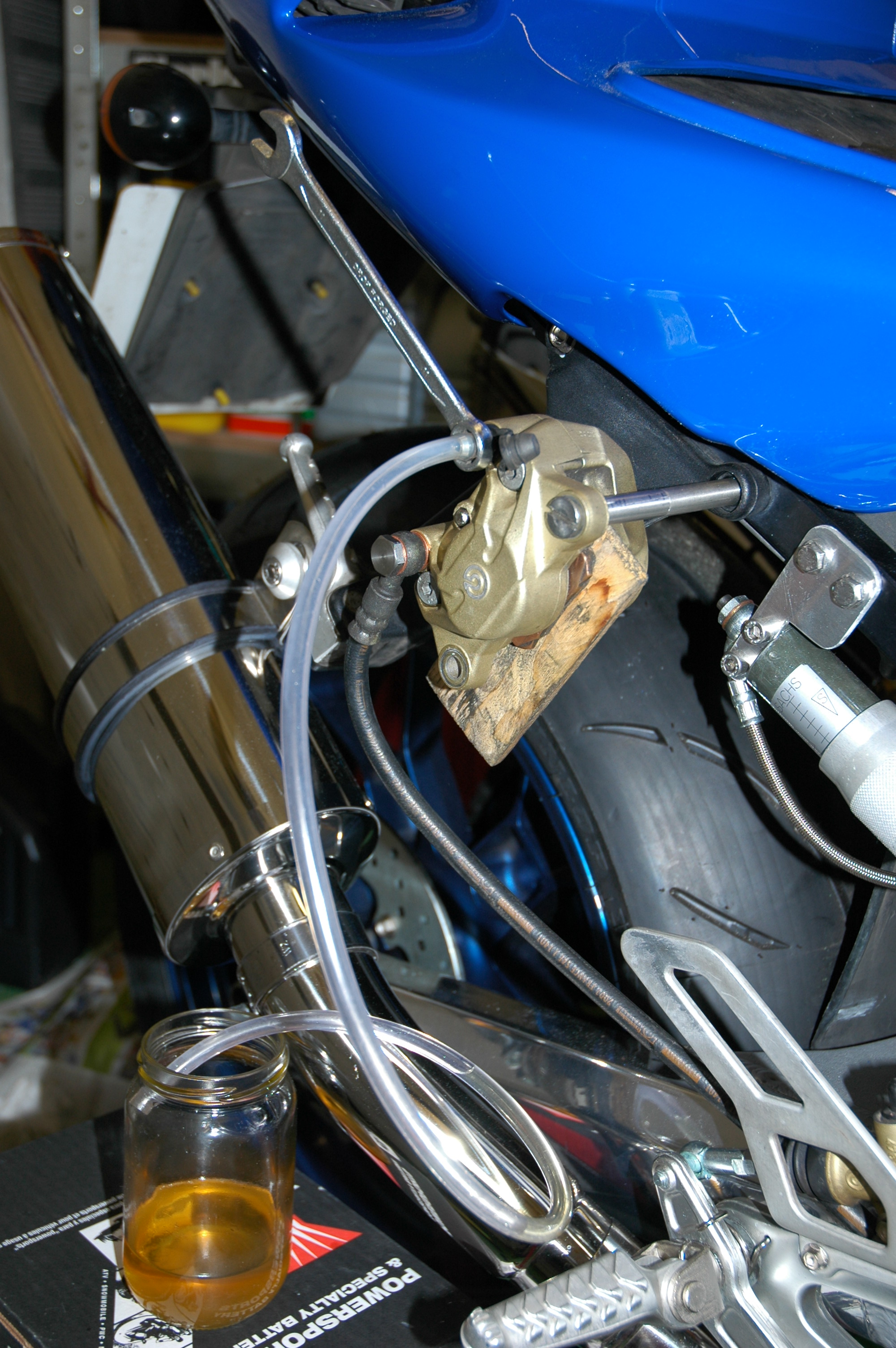

I'm not sure if the RSV layout is the same as the Falco, but this is how I bled my rear Falco caliper. It needs a length of metal tube of the right i.d. and a long bolt, but does the job.

mangocrazy wrote: Tue Nov 01, 2022 11:17 am I'm not sure if the RSV layout is the same as the Falco, but this is how I bled my rear Falco caliper. It needs a length of metal tube of the right i.d. and a long bolt, but does the job.
I think thats the common solution for bleeding the rear brake on the Multistrada as well. They dont work well for long as the reservoir is next to the catalytic converter so the heat from it boils the fluid. The common fix is constant bleeding and flushing the fluid or the proper fix is to use high temp brake fluid at about 75 quid a small bottle .....most people remove it, turn the caliper upside down and place it high to bleed it ;)

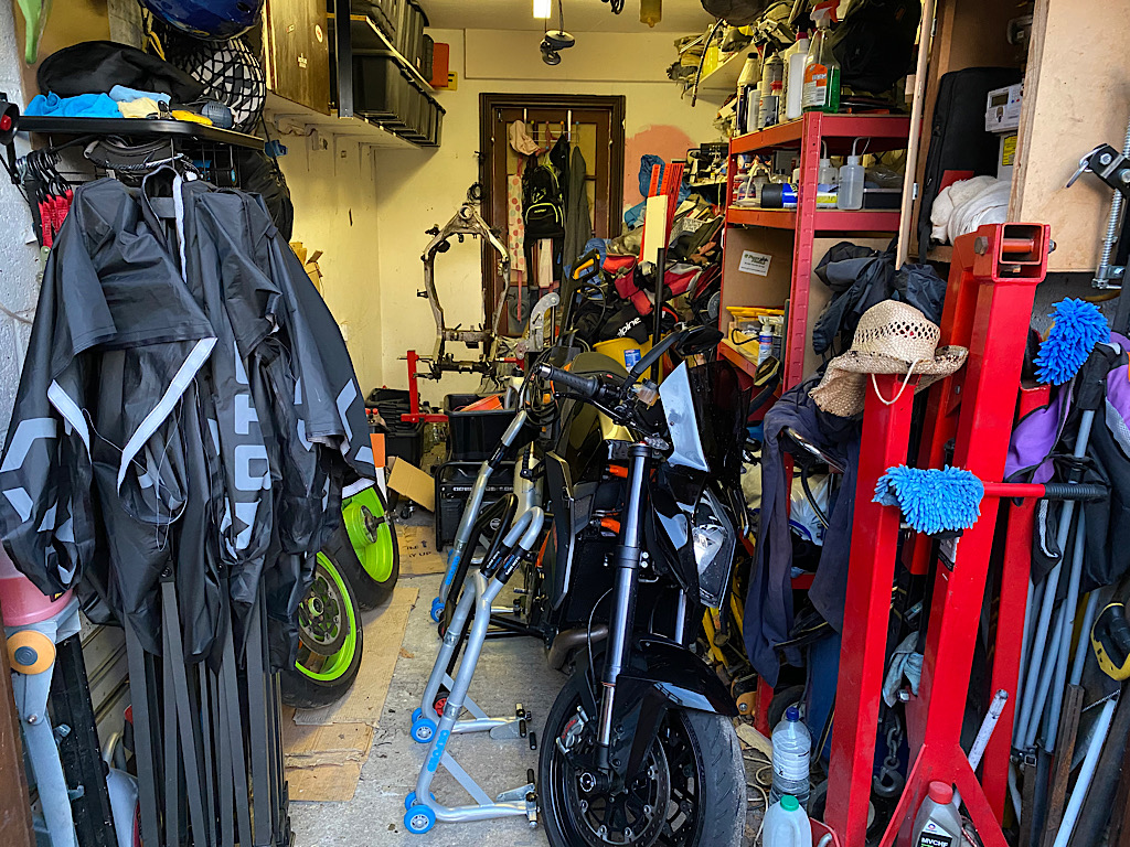

Started to tidy up the garage to get the aprilia in. In the current state I can’t get all the bikes that were in there in. I’m sure it’ll be ok in the end.
Re: Project Aprilia
dern wrote: Fri Nov 04, 2022 4:29 pm Started to tidy up the garage to get the aprilia in. In the current state I can’t get all the bikes that were in there in. I’m sure it’ll be ok in the end.
Fair play to you,I couldn't contemplate working on a bike in there! Sets all my bells ringing. :(

No choice. Houses are expensive. It’ll be fine :)
