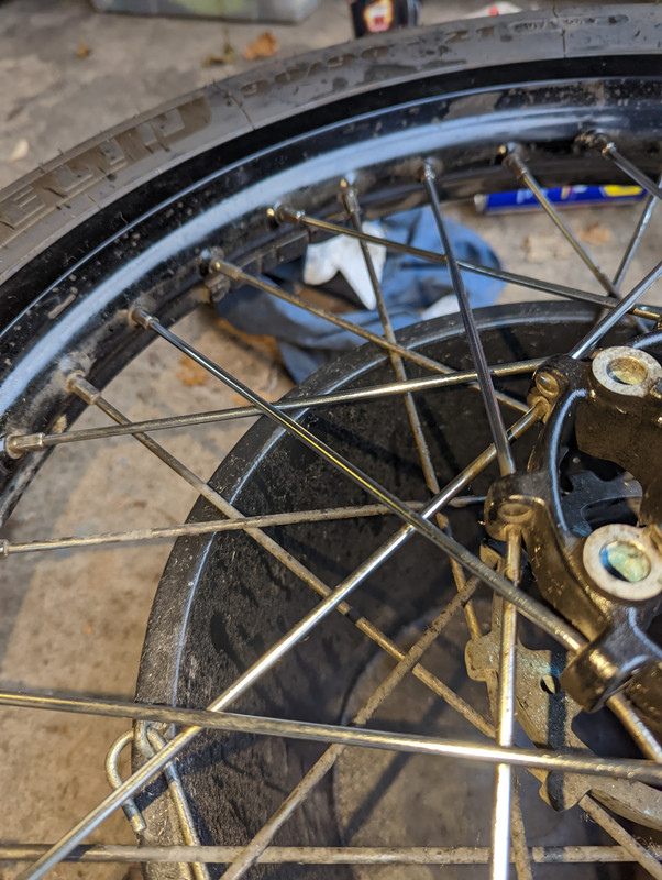

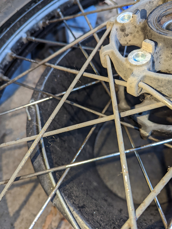

I did say right at the start that I haven't really cleaned this bike in 60k miles didn't I?
Front wheel spokes are a right pita to clean, so I haven't.... Until today
Wheel out, disks off and chucked in the bin and out with the wire wool
Fortunately there nearly zero corrosion under all of that shite

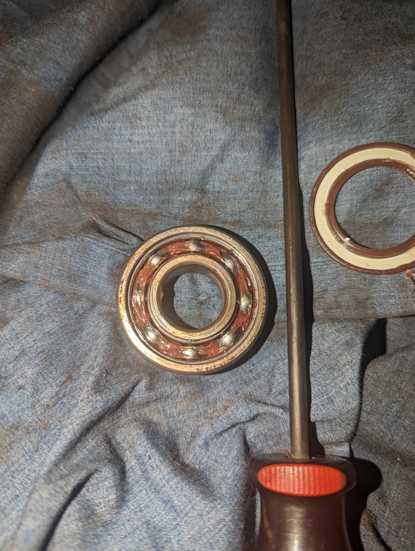

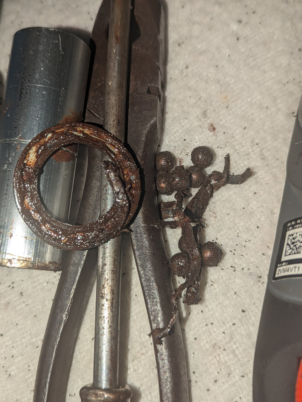

The front wheel bearings turn out to be a story of two halves. There's the one bearing that the seal had done a great job and the grease looks surprisingly new.... (The camera flash makes it look dirtier than it is)
And then there's the others side that the seal had obviously failed and the inner race kind of fell out leaving the outer race in place.
Now to figure out how to get the outer race out as it's bigger than my biggest blind bearing puller.
The last time this happened to my I took a Dremel to it which is probably what I'll land up doing to this one

Yeah, in all the wheels I've ever done there's been a small cut out in the hub that allows you to get a drift on the outer race.
Taff
- Posts: 1467
- Has thanked: 334 times
- Been thanked: 1191 times
Re: Dragging the Tiger out of the swamp
There's a very small lip that I could get a drift on, maybe 1 or 2mm, by I'm concerned about the race not coming out square and damaging the hub.
Really, I'd prefer to drop a socket through from the other side but there's a lip right in the middle of the hub that holds the spacer tube in place, so that narrows the hole too much to get the socket through.

I'll have another look at it later onKungFooBob wrote: Mon Dec 20, 2021 7:24 pm Yeah, in all the wheels I've ever done there's been a small cut out in the hub that allows you to get a drift on the outer race.

If you favour each opposite side in turn if it starts to go slightly wonky it normally works out ok. Obviously if you just wallop it askew and keep going like a brute it'll be a terrible mess.Taff wrote: Mon Dec 20, 2021 7:38 pm

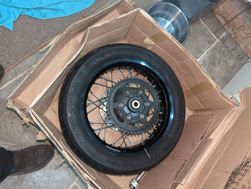

I'm waiting for the postie to deliver a replacement wheel that I got off eBay, this turned out to be the cheaper option.

I went at the inner race with a drift and hammer with the intent of giving it lots of gentle taps around the edge and see what happens, and it just came out bit by bit. So slowly slowly I worked it out until it popped into the floor.
New bearings in using my (cycle) bottom bracket bearing press and in with the circlip. I don't understand the logic of only having a circlip on one side ???
Anyway, new disks on and the front wheel is ready to go back in once I've done the calipers.

Santa had arrived early
What looked like tarnishing on the spokes turns out to be chain lube & shite and the wheel is actually really really good.
Tyre and brake disk have probably about 80% life left in them, but they will be getting swapped out for the brand new brake disk I've got here, and the tyre on my old wheel that has only done a couple of hundred miles.

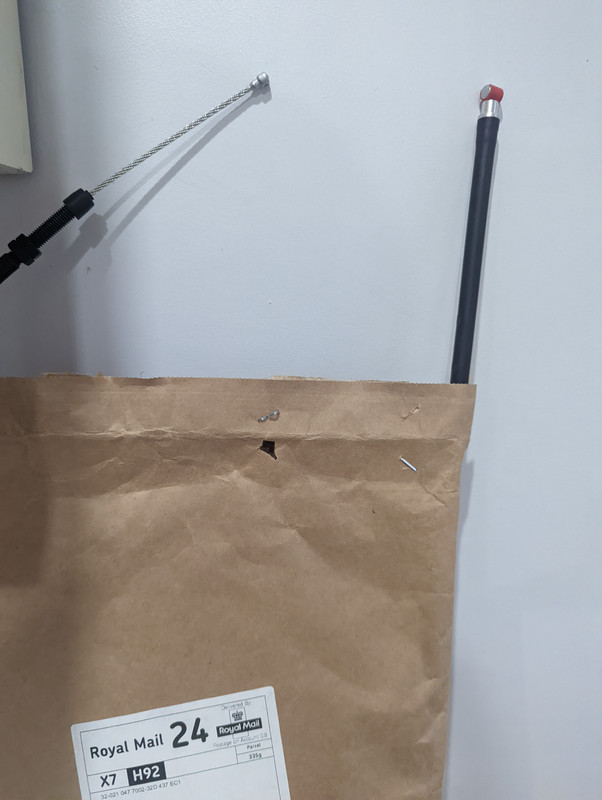

He also dropped off a clutch cable

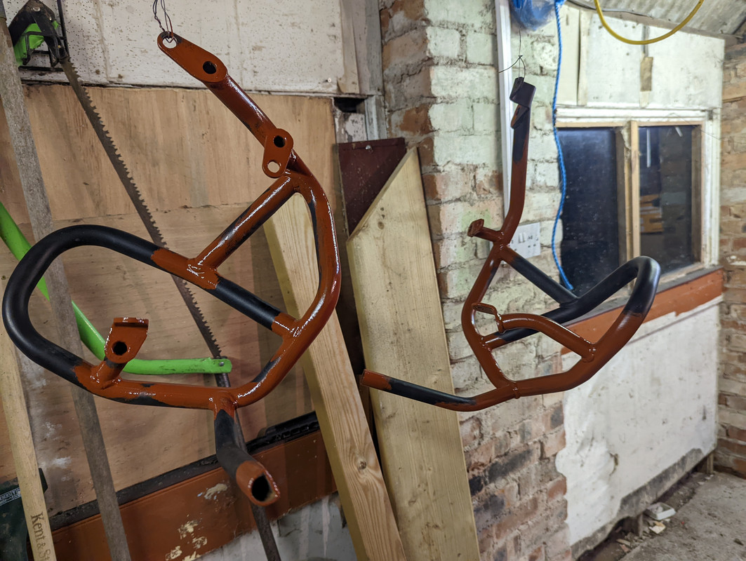

Engine bars removed and prepped for paint. They have corrosion around the welds so blasted then with a wire wheel and given them the first coat of primer.
Front wheel refitted and both brake calipers cleaned within an inch of their lives, pads are now moving nice and freely.

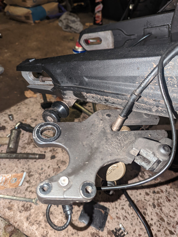

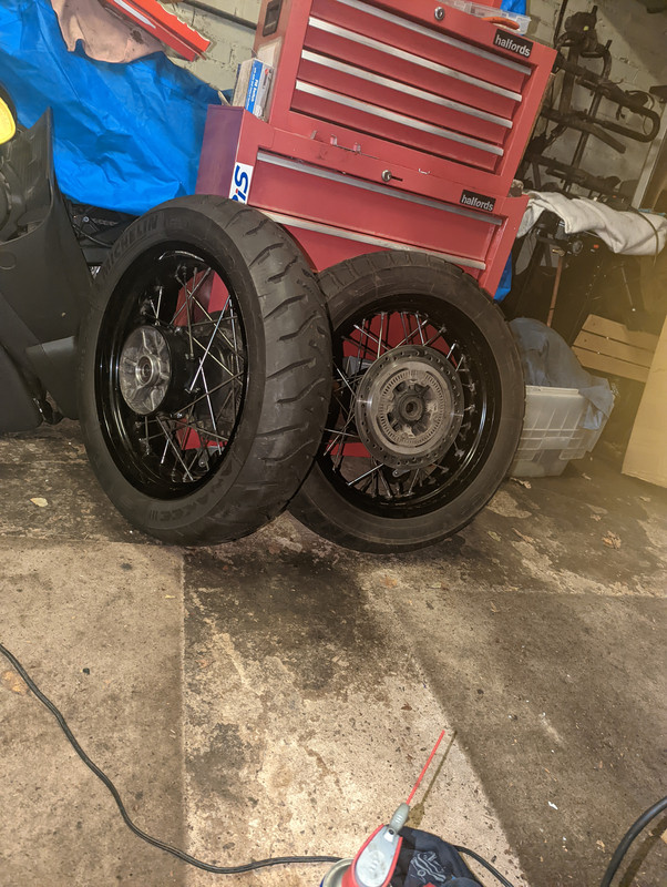

More cleaning today, this time down the back end, brake and rear sprocket
Why is it that the flash makes everything look minging again
Wheel out ready to take over the shop to have the tyres swapped around

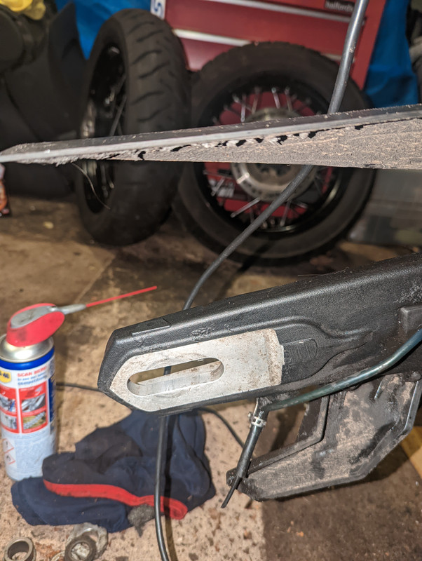

Got the adjuster bolts out of the swingarm ok?
Apparently they seize in and can be a real ballache to remove.
