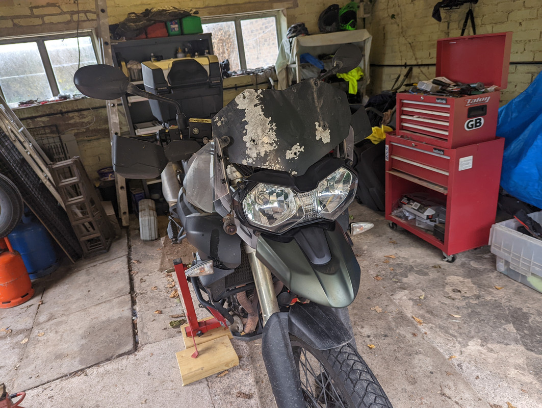

I ventured in to the garage this morning and I could barely move the bike because the brakes are binding, there's fur growing all over it and it is actually looking pretty shit tbh, so it's time to chuck a little bit of cash and time at it to freshen it up and get it looking acceptable again. This is absolutely not a strip & refurb project, this is do enough to make the cosmetics better.
I have to keep in mind that I could be recalled to the office at any time so I need to be able to get it back on the road within a weekend's work
this is what I'm starting with

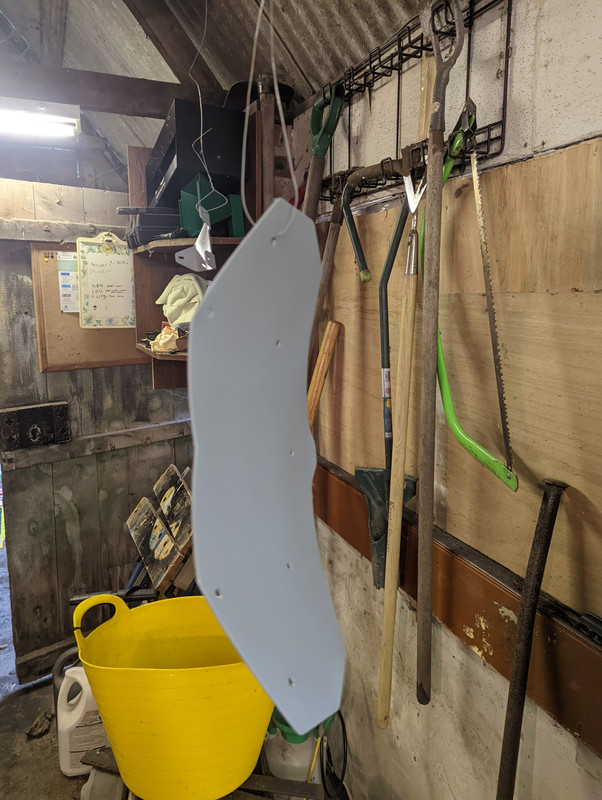

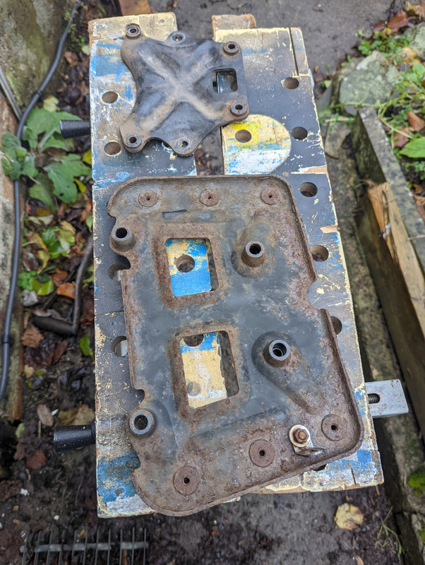

I've already taken the screen off and this is the mounting plate

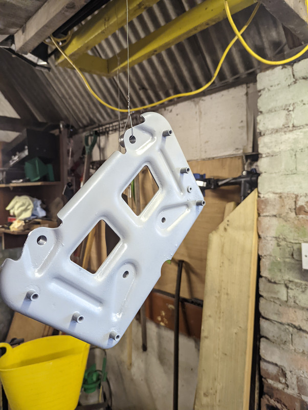

other than the cosmetics, there's a few mechanical bits that I'm going to replace while I'm at it, wheel bearings, brake disks (which I bought a year ago before dumping the bike in the garage) and the clutch cable because it's pretty heavy and I was having trouble with my left hand when filtering & slipping the clutch.
The rubbing down and re-painting stuff has started today

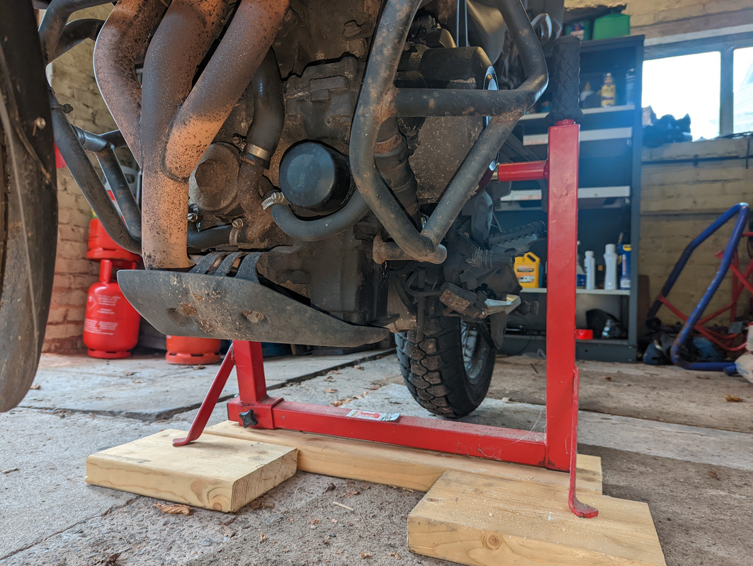

I've arranged to borrow a bike ramp off a neighbour so I'll be able to get the bike up in the air a bit to do the engine and stuff later this week :thumbup:

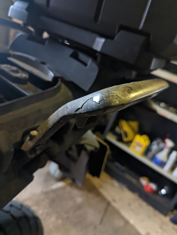

the metalwork that supports the top box had to come off to get the rear grab handles off, so they got a rubdown, treatment with rust killer stuff and primed

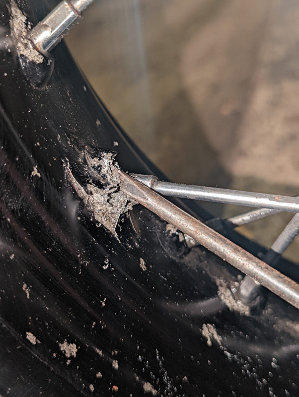

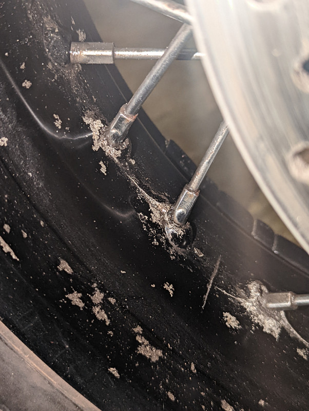

when I got back from training I though I'd start to give some attention to the wheels, but after cutting my finger open on a razor sharp shard of metal, I found that the rim is corroded to fuck and cracking between the spoke holes
it's better to find this now than when it lets go on the motorway :silent:
I suppose I'll need to find a replacement wheel or find someone that can build a new rim onto this hub ???????

Oh wow, that's pretty dramatic!!!! Any other bikes wheels that may fit? I suspect aftermarket may be crazy money

There's a good chance that the 'roadie' version alloy wheel might fit, I'm sure they have the same size tyres and I can't imagine for a minute that the swingarm / fixings are going to be different.
there is a wheel in ebay for £225

I've had a few quotes from a variety of companies that rebuild the wheel with a new rim, and they all seem to come in at about the £300 mark including postage etc, which I don't think is too bad and is definitely the route I'd be taking if I was trying to get a pristine bike at the end of this, but I'm not so the cheaper option it is :D
complete wheel on ebay including tyre, disk, cush drive etc £235
but it's not all sweet. From what I can gather there's 2 standards of wheel from the early bikes.
Ones like mine which have stainless spokes and bad rim corrosion problems, and ones with chromed spokes that don't have such bad rim corrosion problems but the spokes tarnish. The ebay one has tarnished spokes which is not brilliant but not the end of the world either.

Tarnished spokes isn't going to lead to them failing. They would need to turn brown and rusty before corrosion compromises their strength.

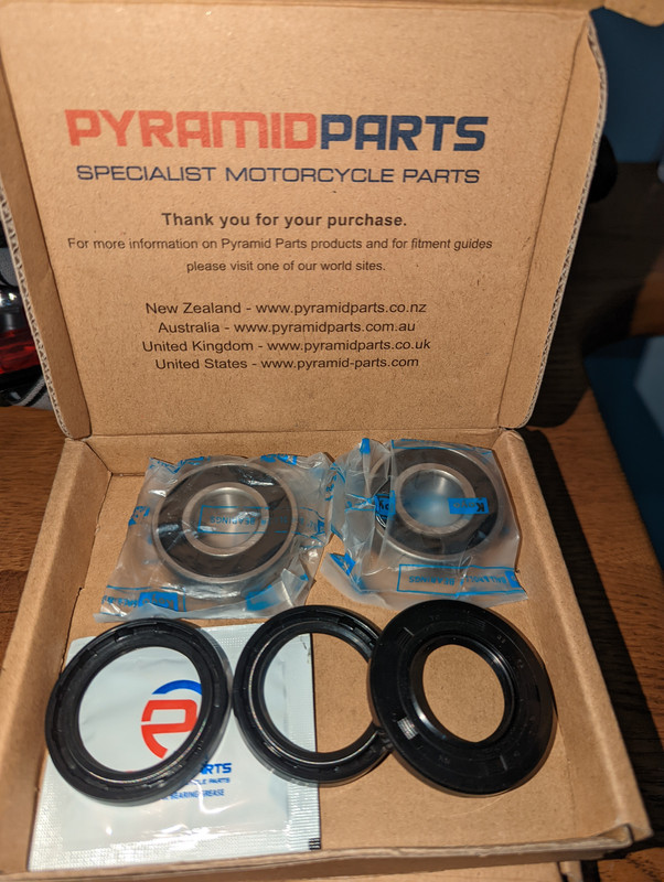

The postie has been, wheel bearing kits for front and rear wheels

Sorry, misread, I thought you were suggesting that the tarnished spokes were a structural problem. Riding on the old wheel is an absolute no go. It's fucked.
