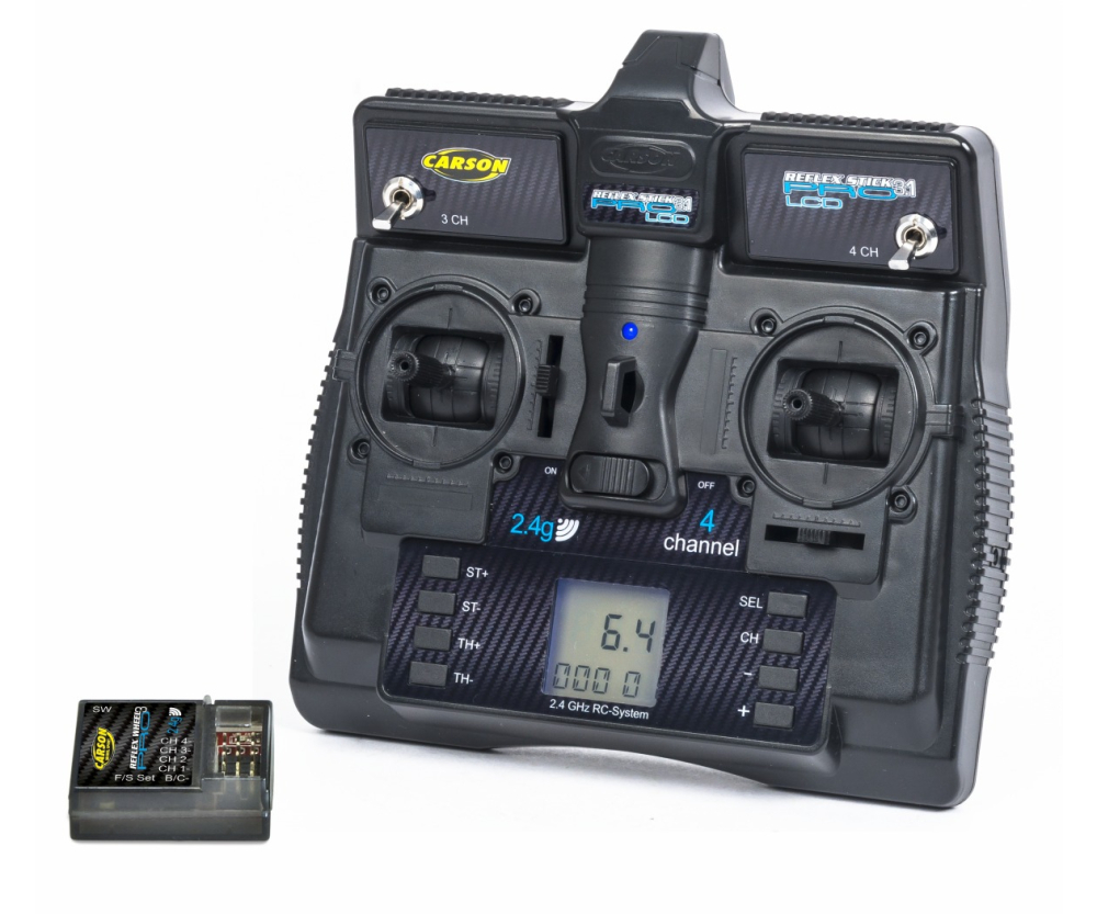

Can you turn the control lever on the handheld radio control box through 180 degrees?
Posts: 26933
Been thanked: 15490 times
Re: Tamiya Grasshopper, new RC car day.... Build thread.
cheb wrote: Wed Apr 15, 2020 8:42 am Can you turn the control lever on the handheld radio control box through 180 degrees?
Don't believe so... well, apart from using it upside down of course :)

Sorry I meant the connections on the joystick. Or turning the joystick through 180 degrees.
WTF I didn't think of using the word before is attributable to my stupidity
Posts: 26933
cheb wrote: Wed Apr 15, 2020 9:06 am Sorry I meant the connections on the joystick. Or turning the joystick through 180 degrees.
https://www.carson-modelsport.com/en/pr ... 500500085/
description says
• servo reverse for both channels (reversal of the running direction)
Which implies i can change direction for motor as well as steering servo.

SORTED !!
a) “REV” setting (reverse direction of servo rotation) Press the “CH” button and choose between ST, TH or 3C and 4C. Press +/- for normal or reverse.
So, using the CH button, the first click is for ST (steering), click it again and you get TH (throttle), then + to set to 'rev' for reverse throttle..... which is now forwards at full power.
