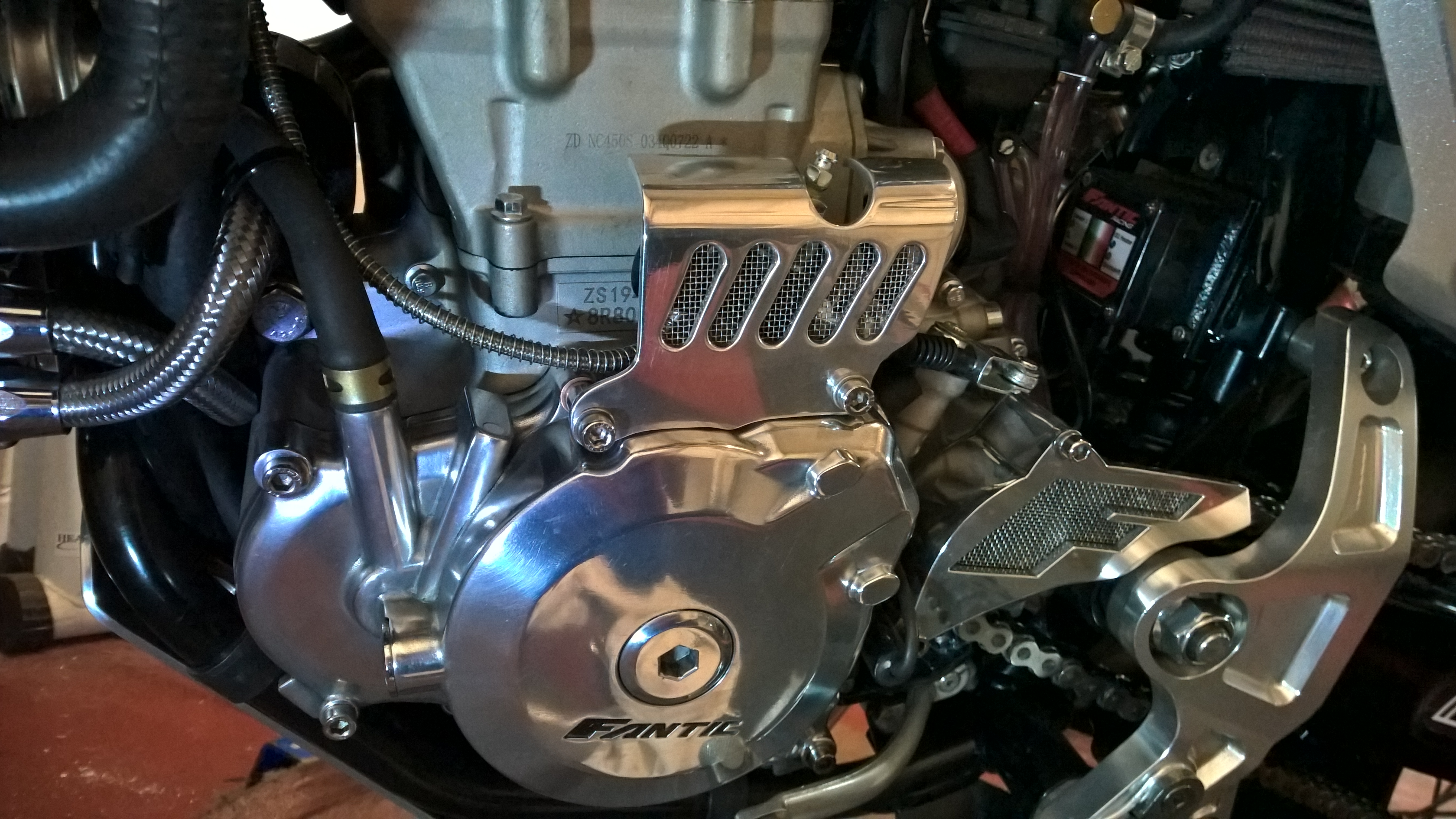

Unfortunatey I had to relocate the rectifier/regulator when I fitted the DOHC engine so it's no longer fitted.

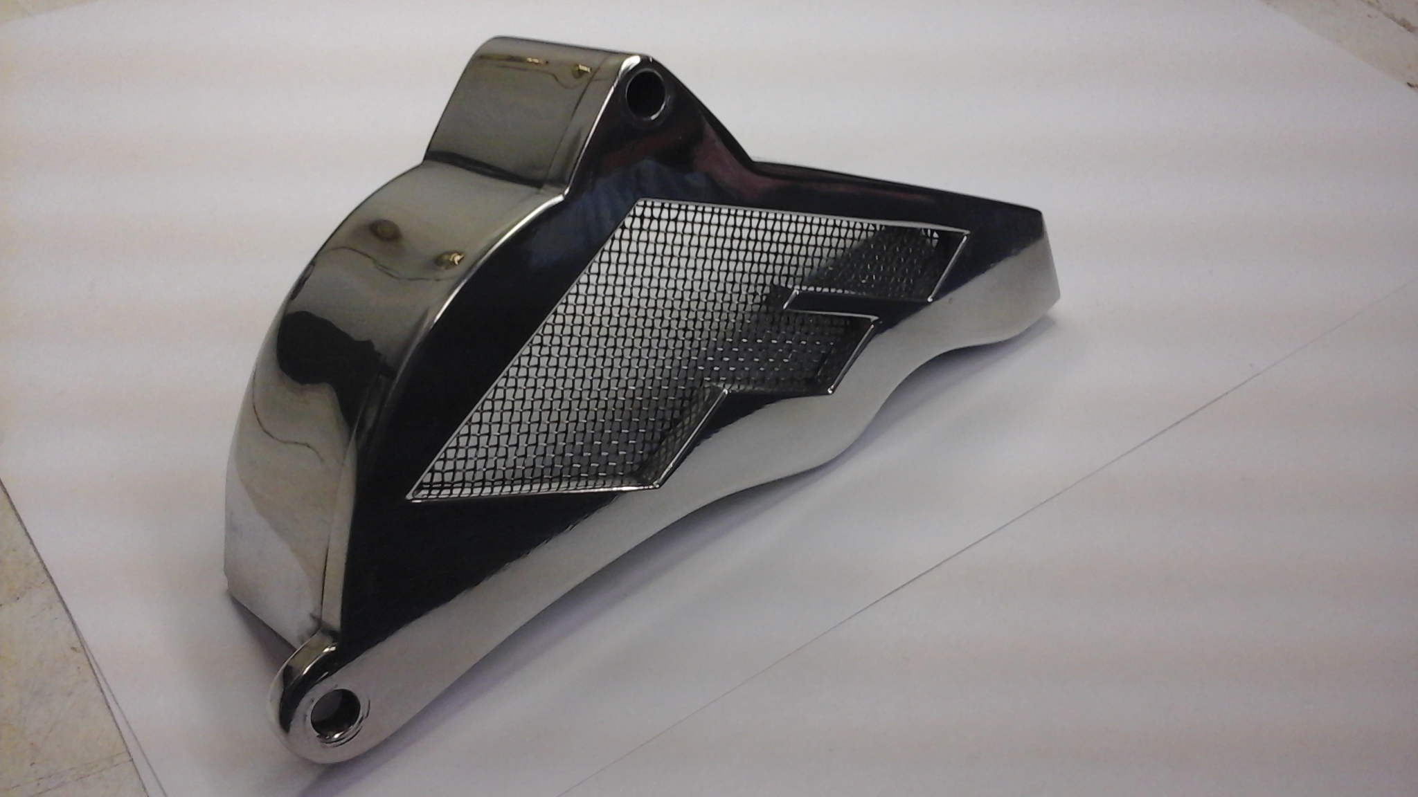

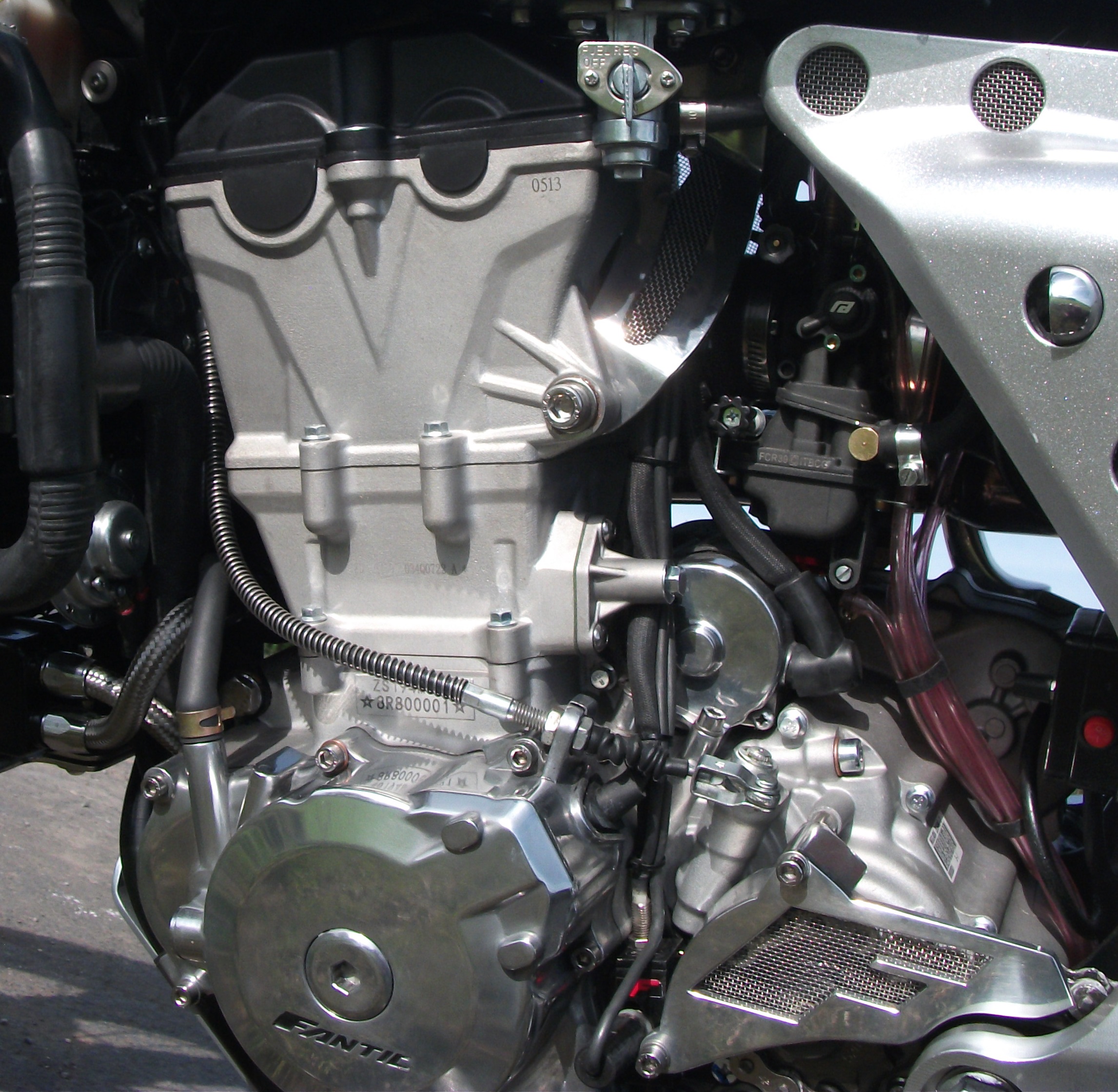

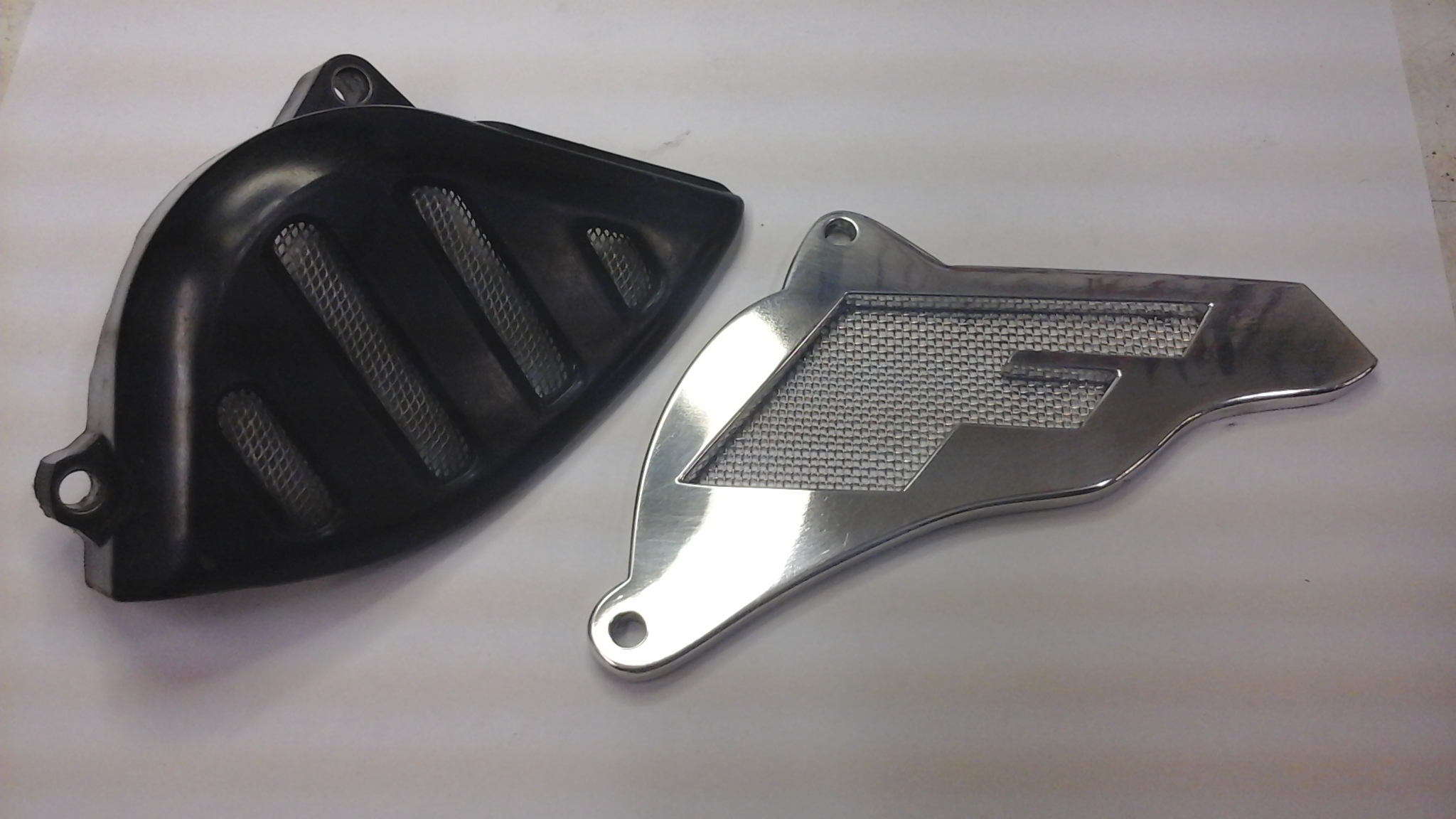

This front sprocket cover is also all stuck together with JB Weld.
This pics shows it fitted.
NC450S engine_1.jpg (1.24 MiB) Viewed 1747 times
Re: Projects using JB Weld
Very pretty job.

Thanks, this was the original plastic version, that looked cheap I thought!

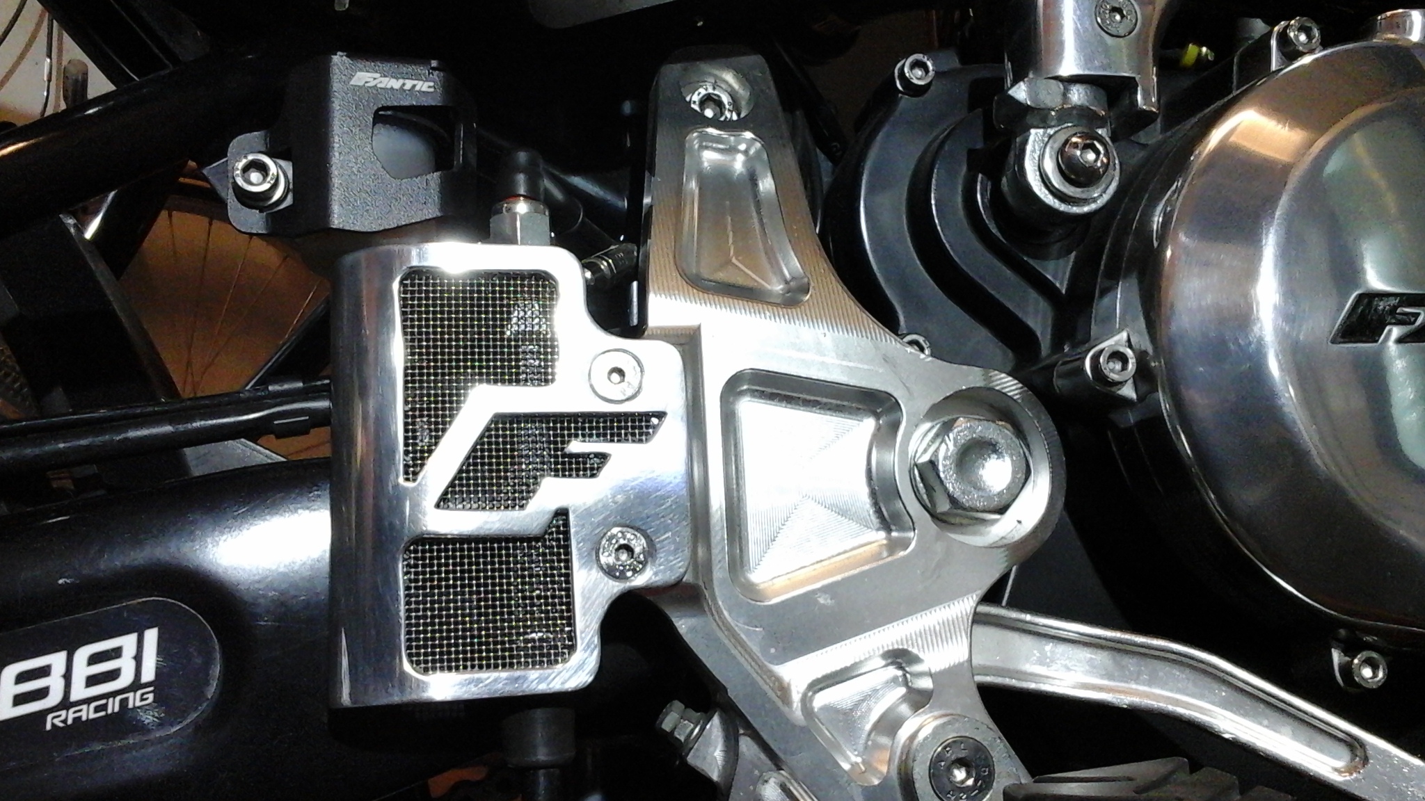

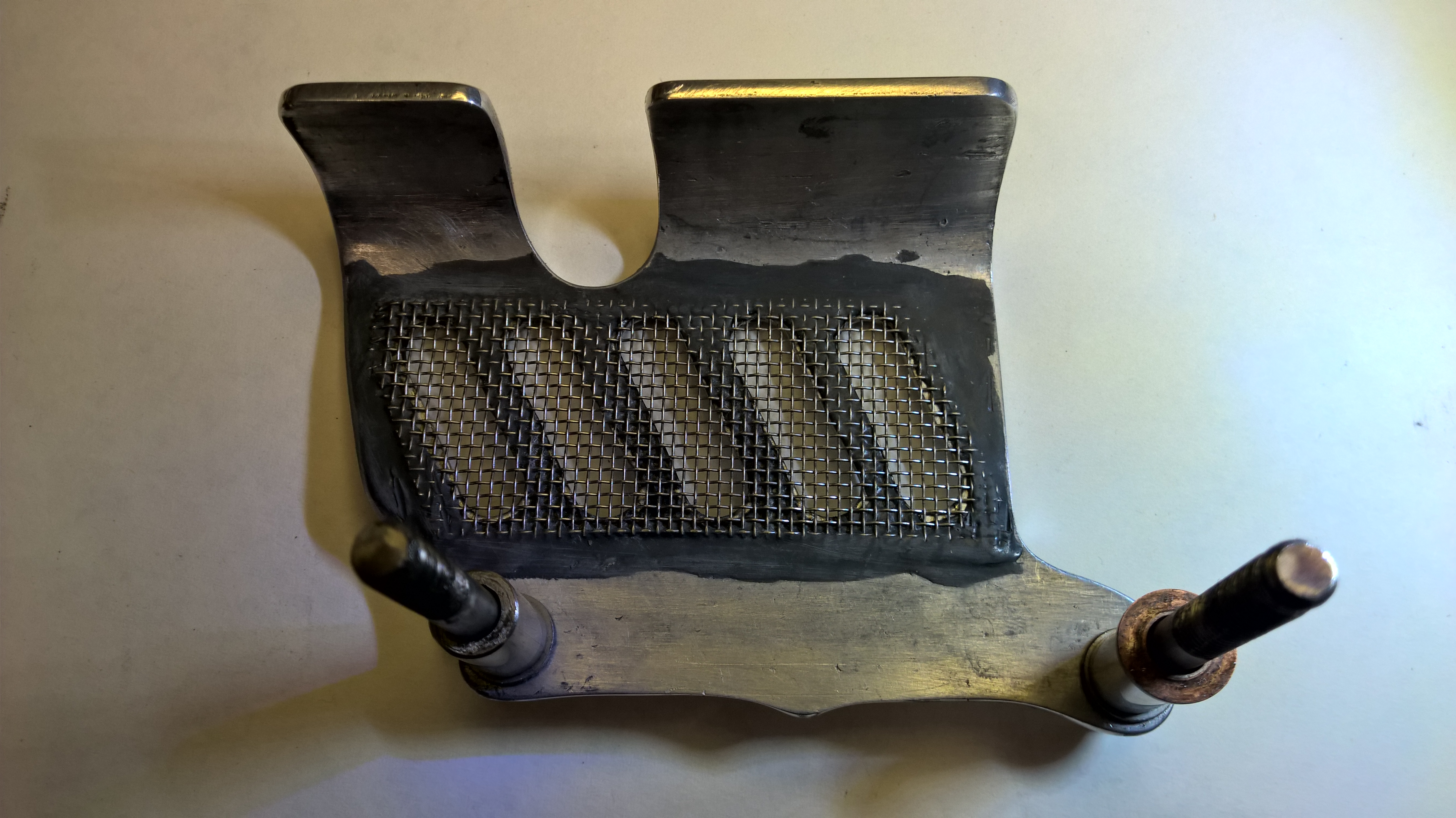

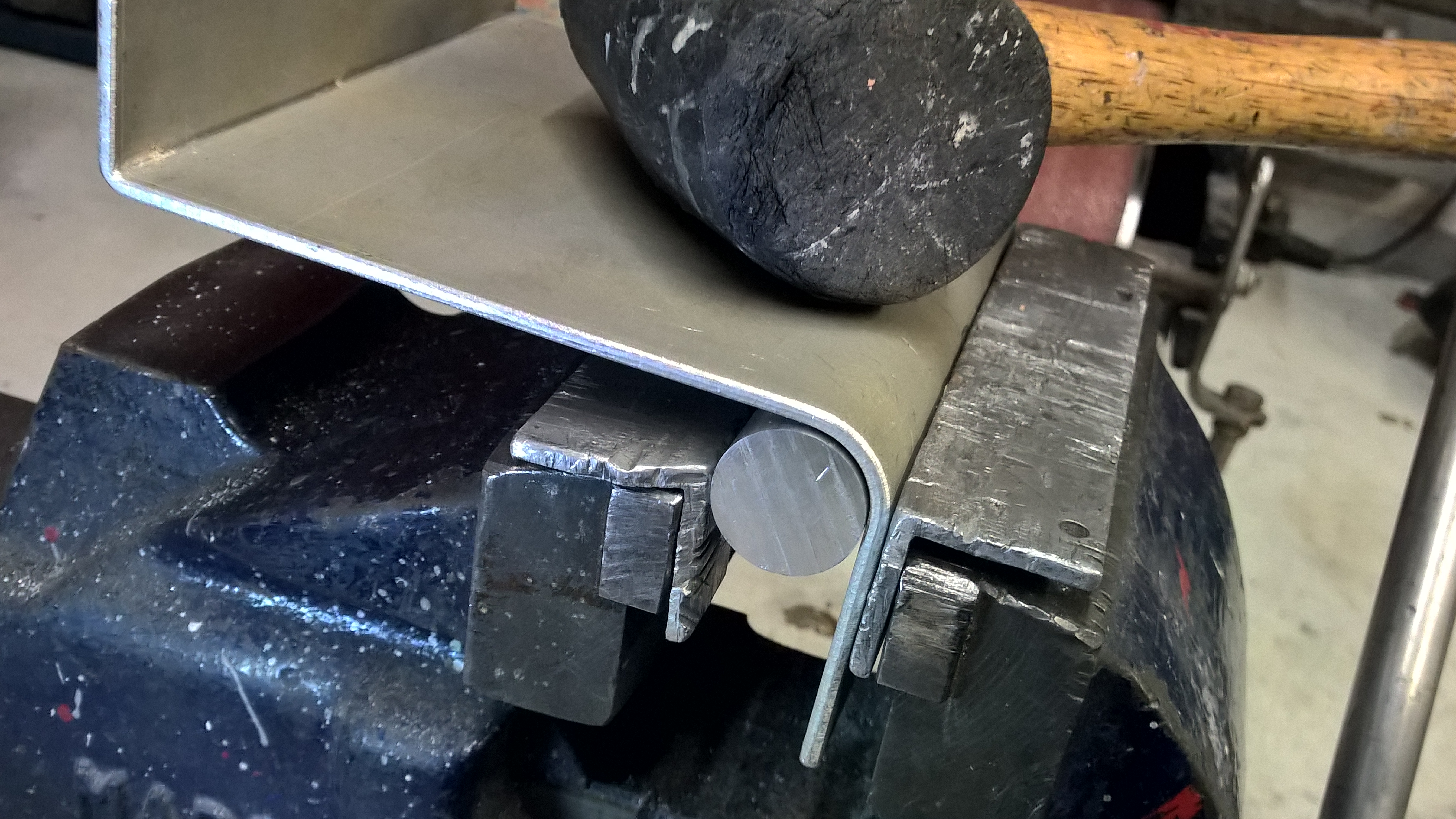

Here's a rear brake slave cylinder guard that I made from some 3mm scrap ally plate that was rolled around a 20mm former polished and then shaped. JB Weld was then used to fix the mesh behind the cut out.
Brake Actuator Cover.jpg (835.63 KiB) Viewed 1528 times
This is what it lokks like fitted.

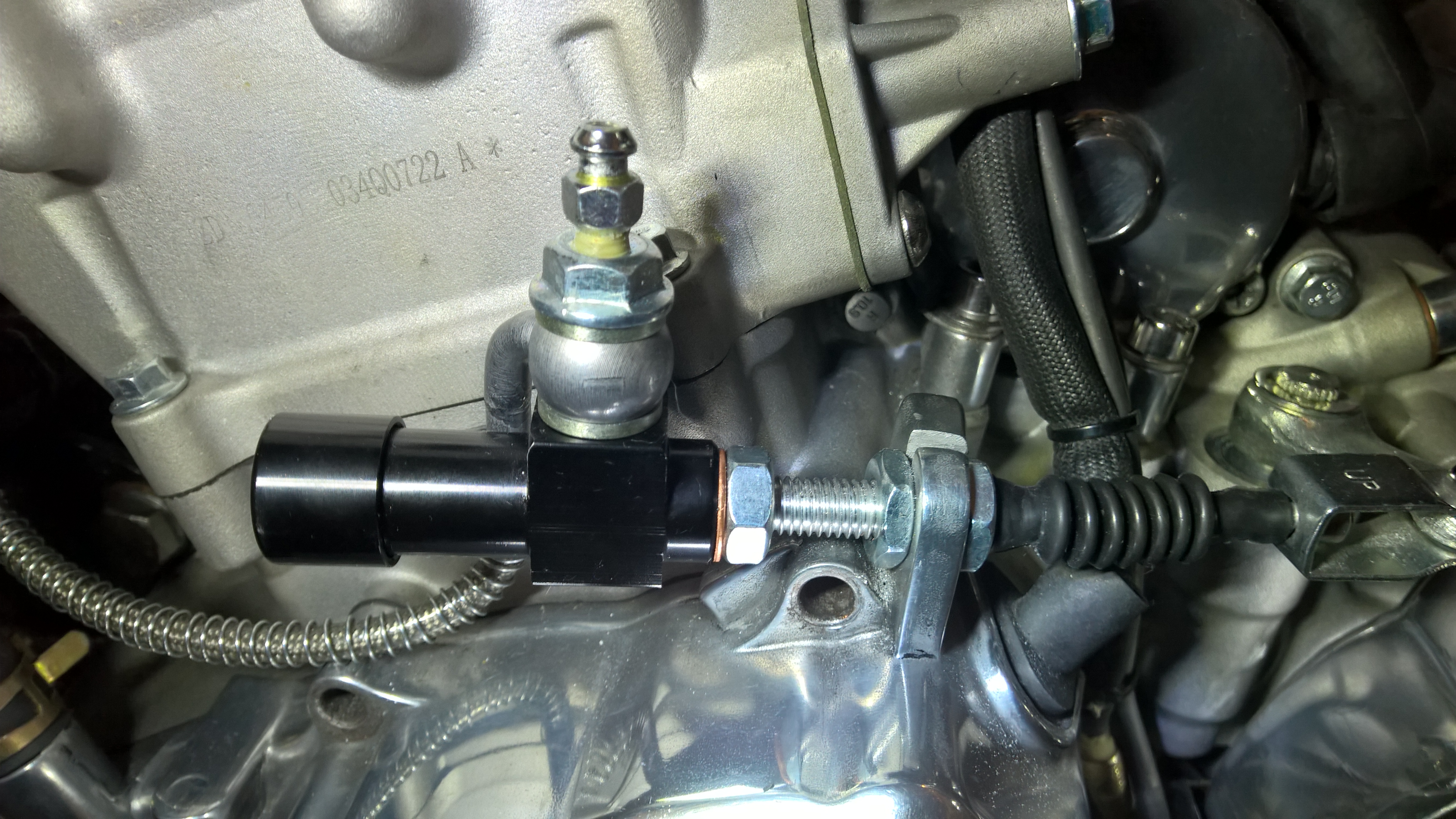

Cover made to protect new hydraulic slave cylinder and finished off with stainless mesh fixed using the usual stuff.
