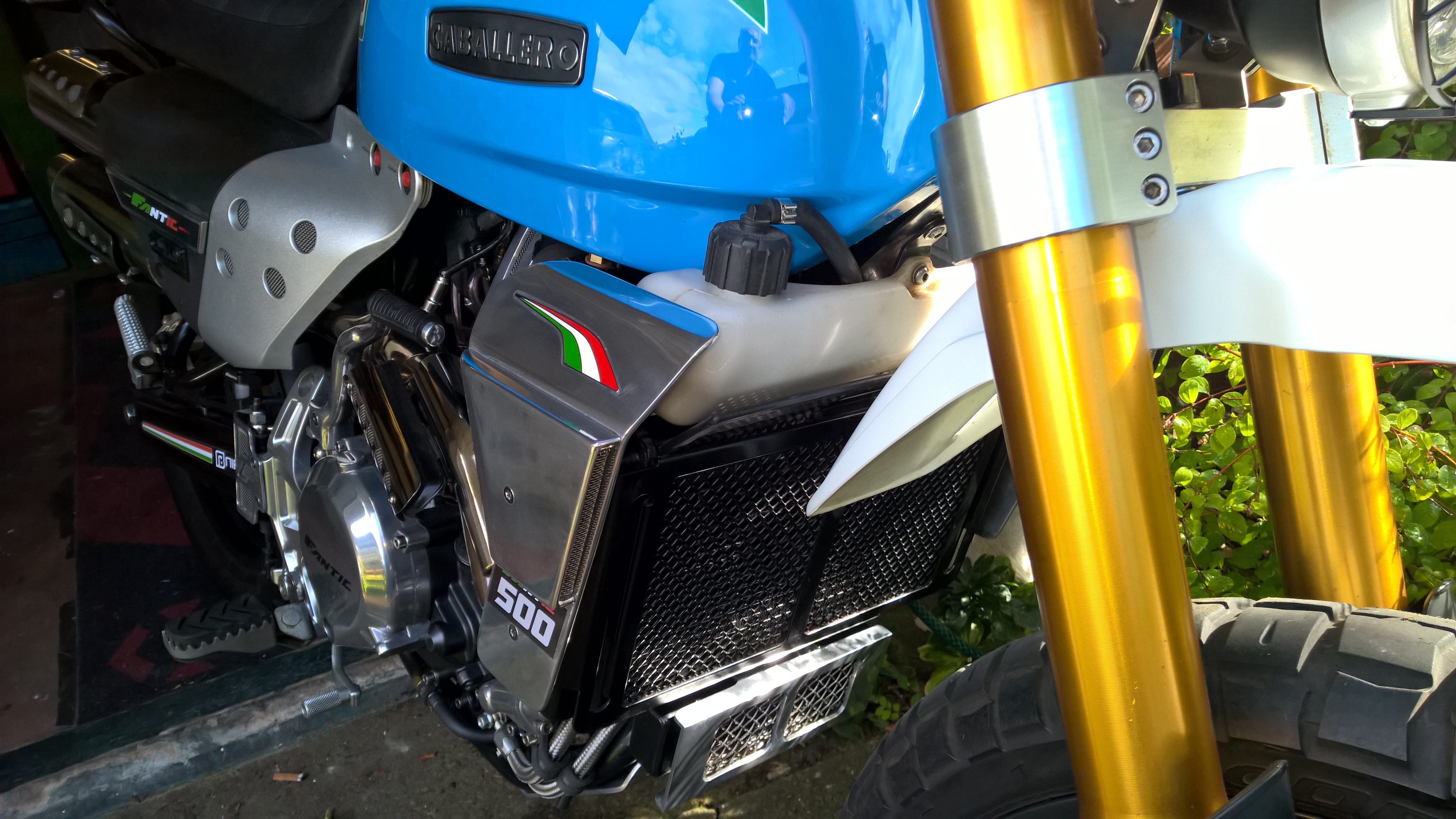

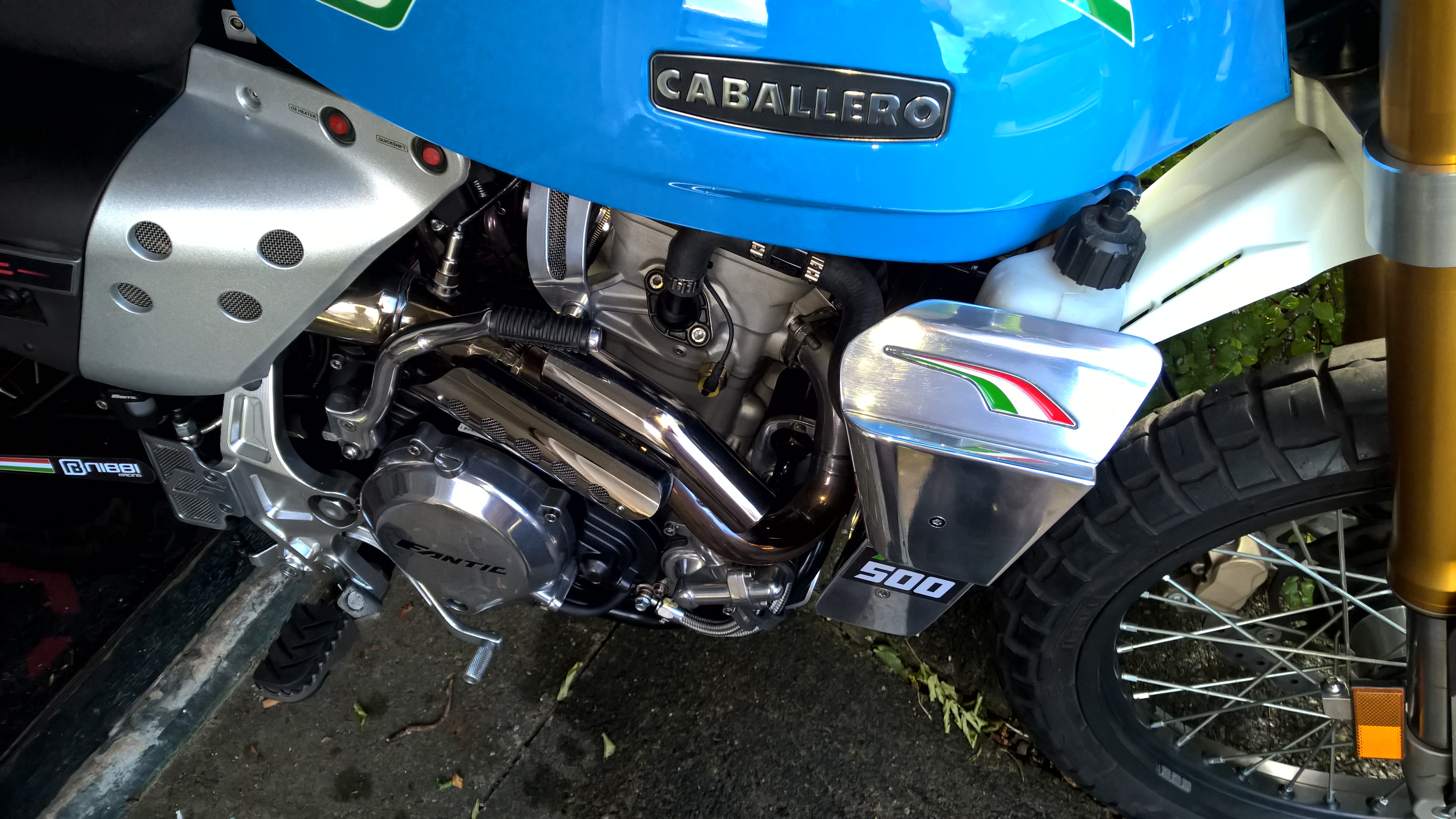

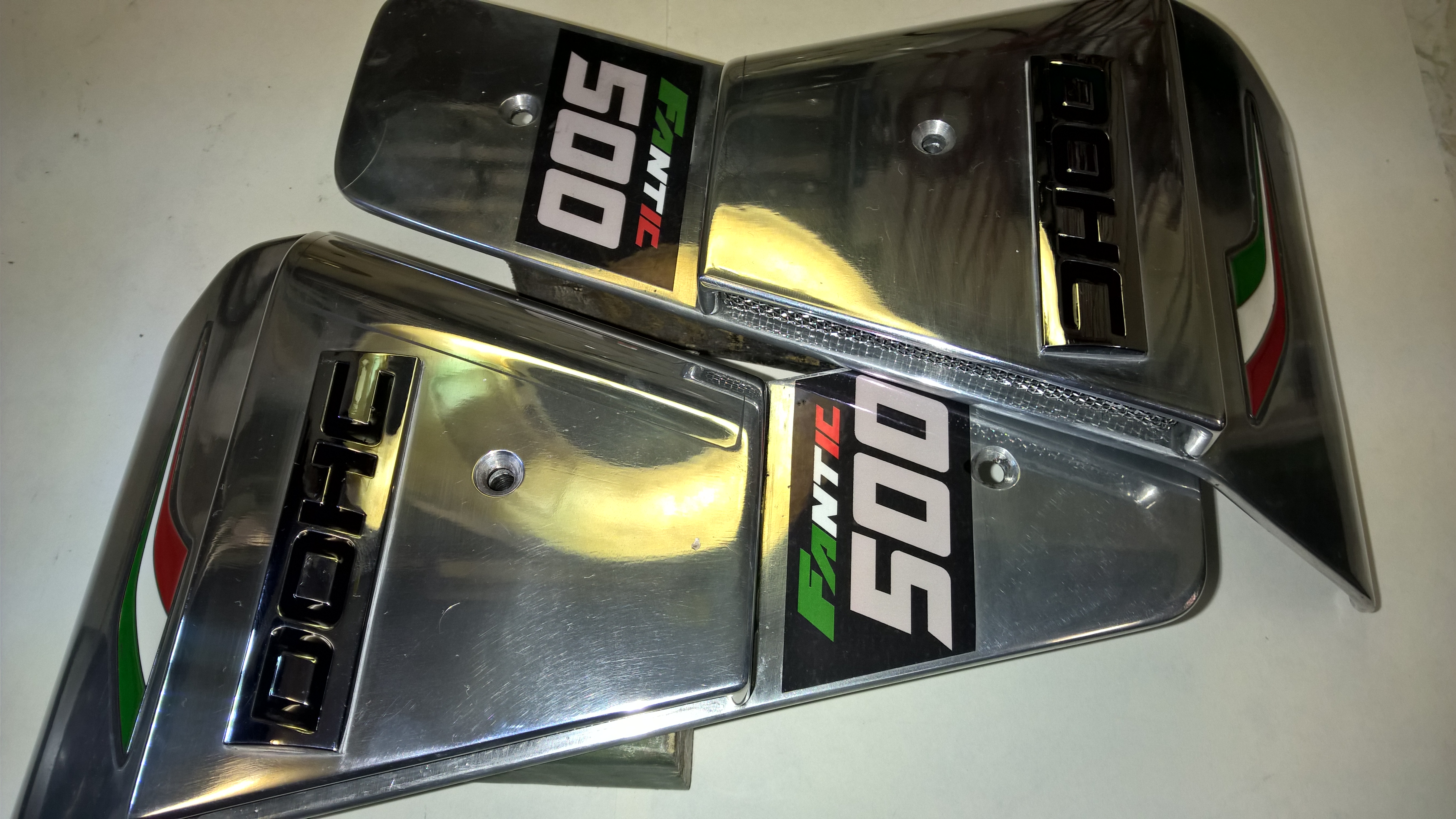

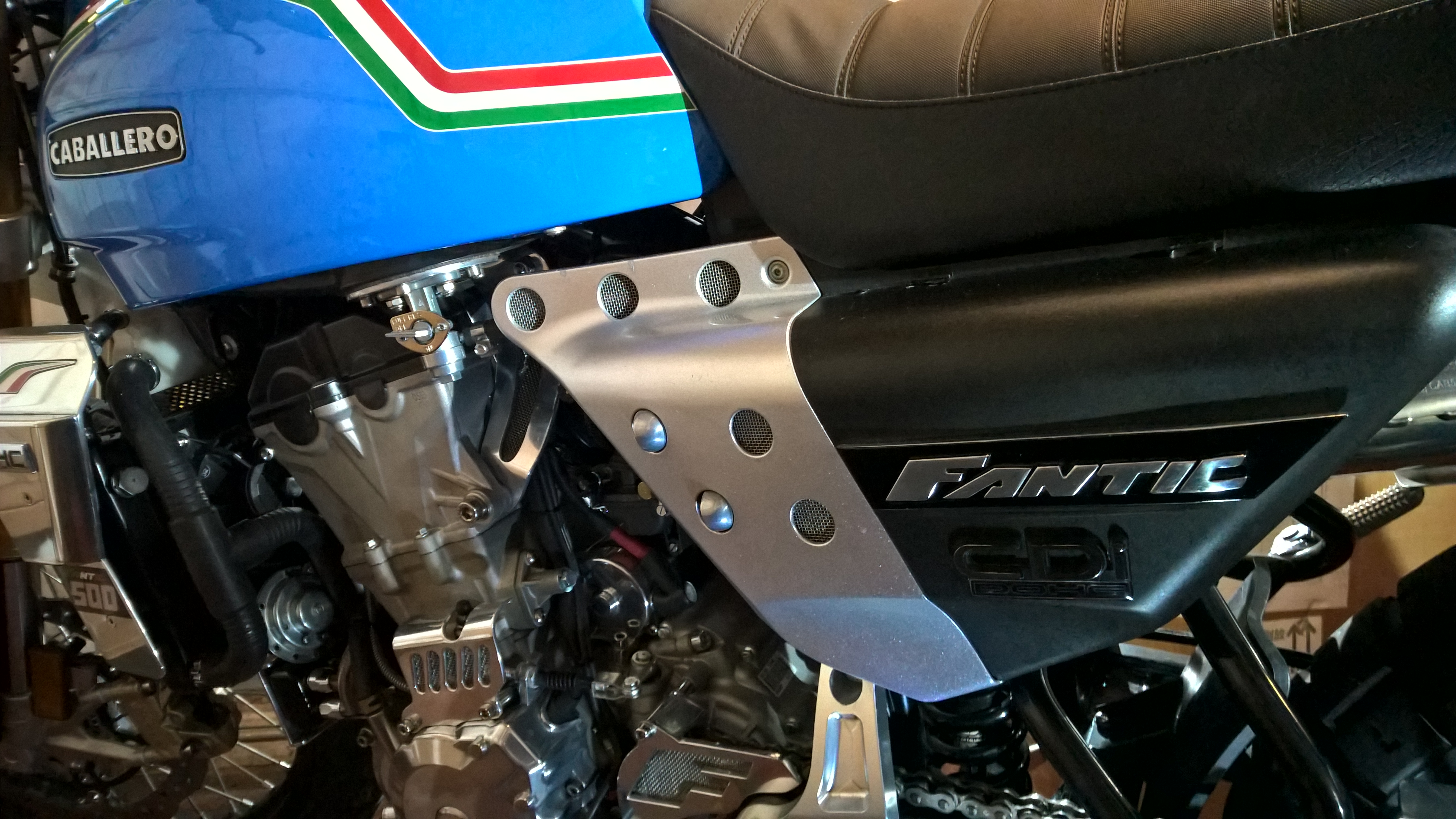

Has anybody else got examples of motorcycle projects held together with JB Weld. I've been using the stuff for probably 5 years now and the uses seem to be endless. I always wanted to make things but without a welder this was almost impossible until I discovered this product. Here's one example.
I used some scrap bits of ally and 4mm plate to make these radiator side cheeks.
All parts stuck together with JB Weld.
Here's a couple of pics before I got the DOHC badges from USA.

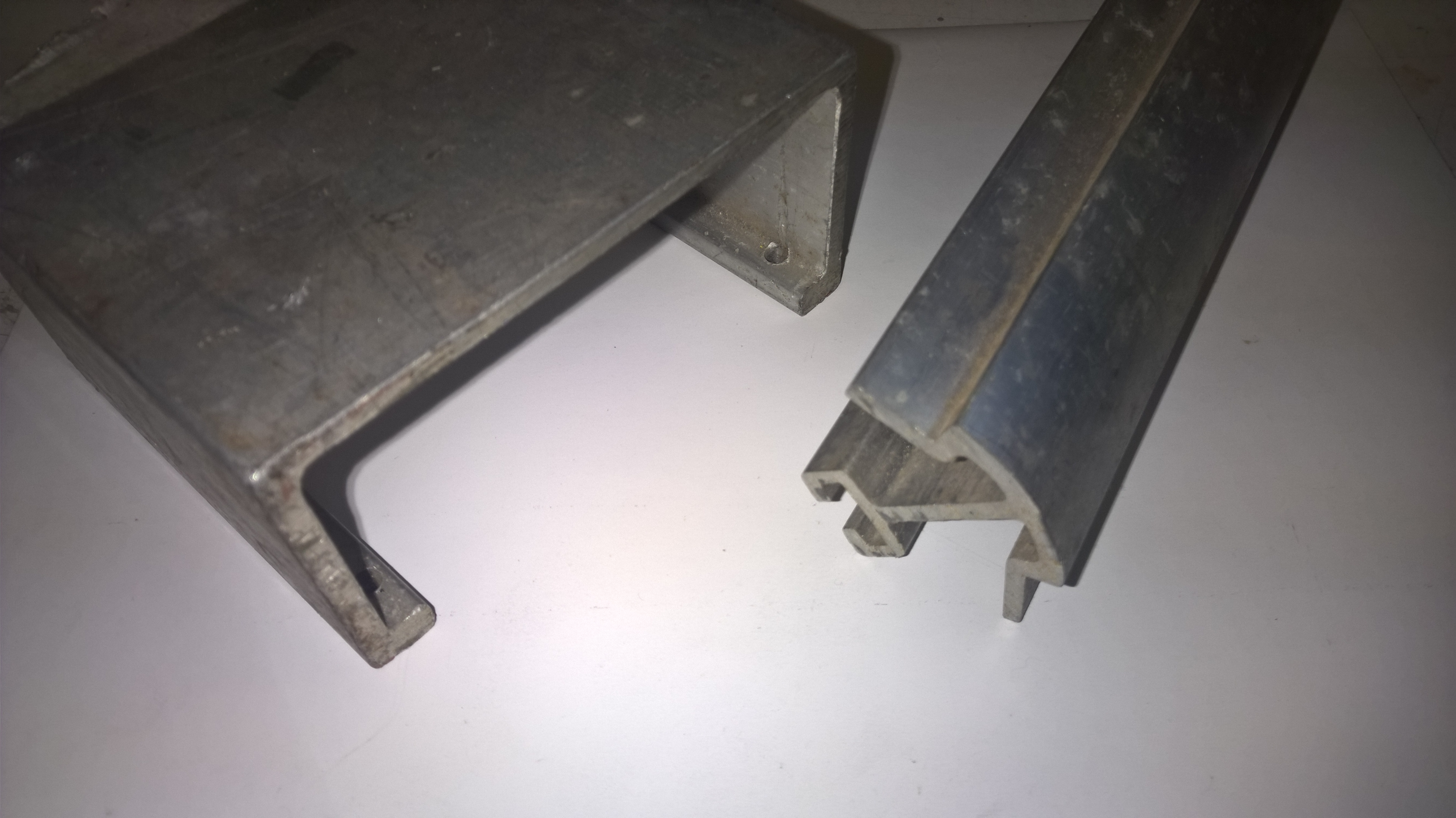

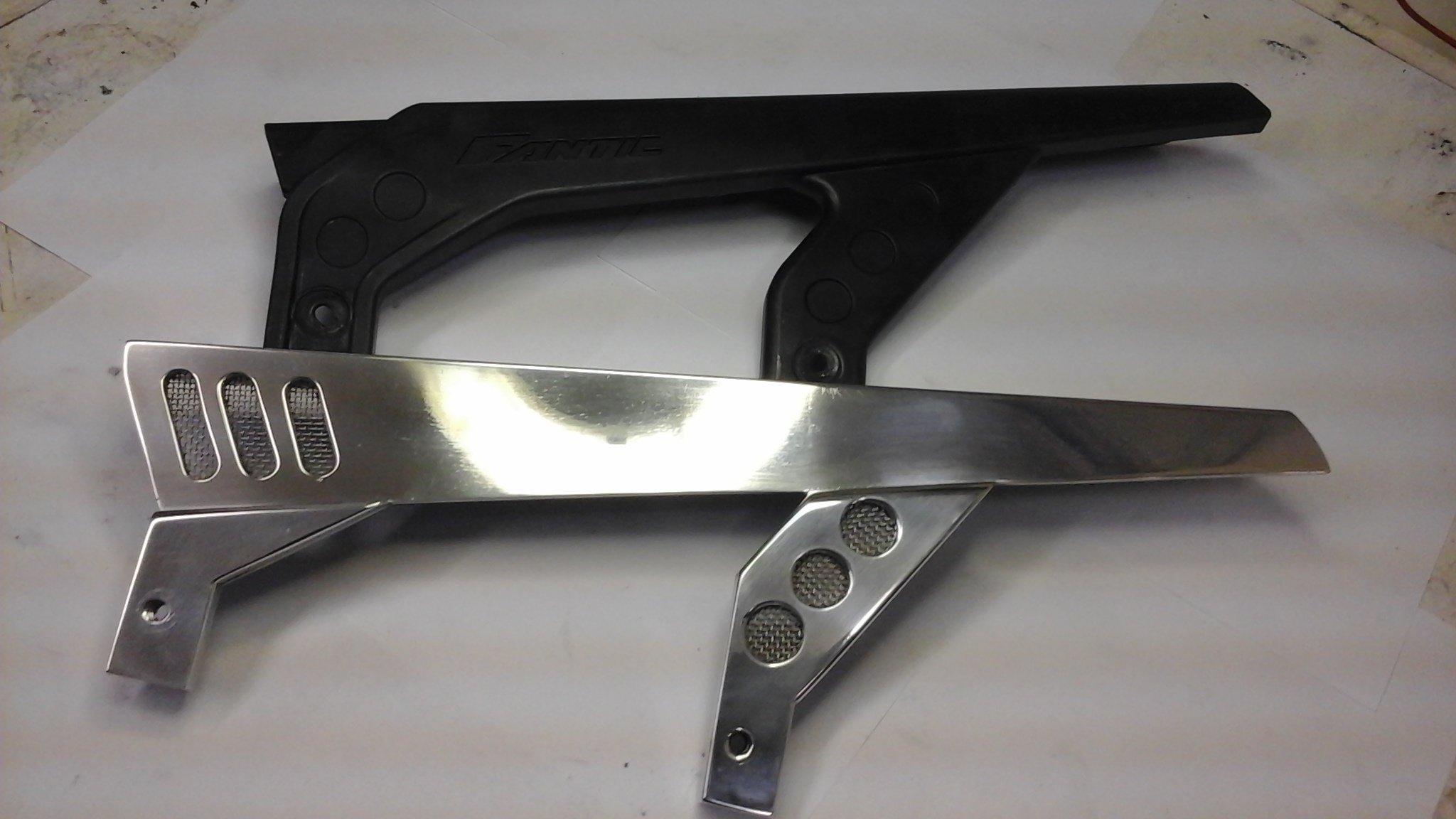

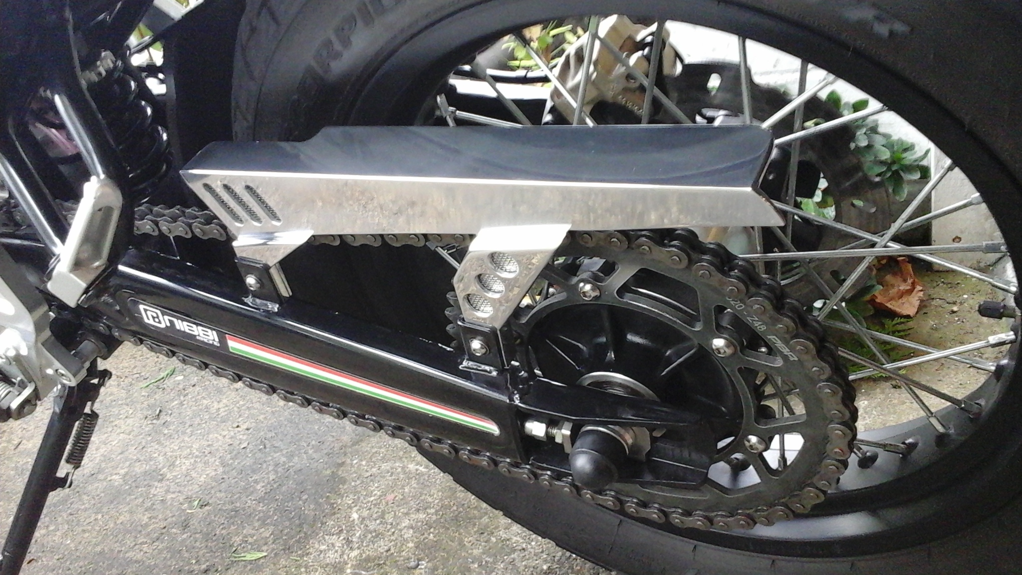

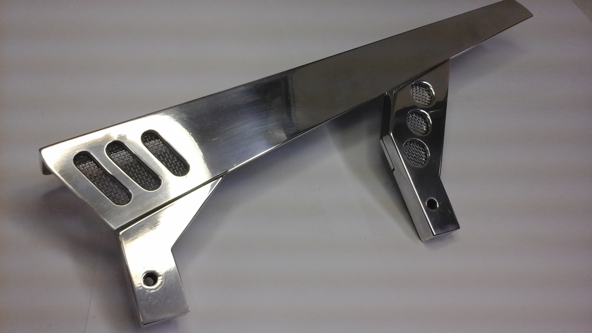

Here's a chainguard that I made from some scrap 'U' section ally and glued the fixing stanctions with JB Weld.
Top chainguard is the original.

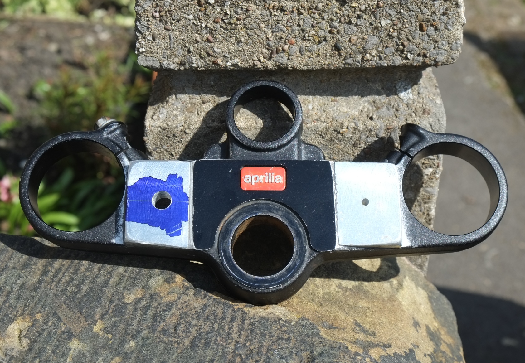

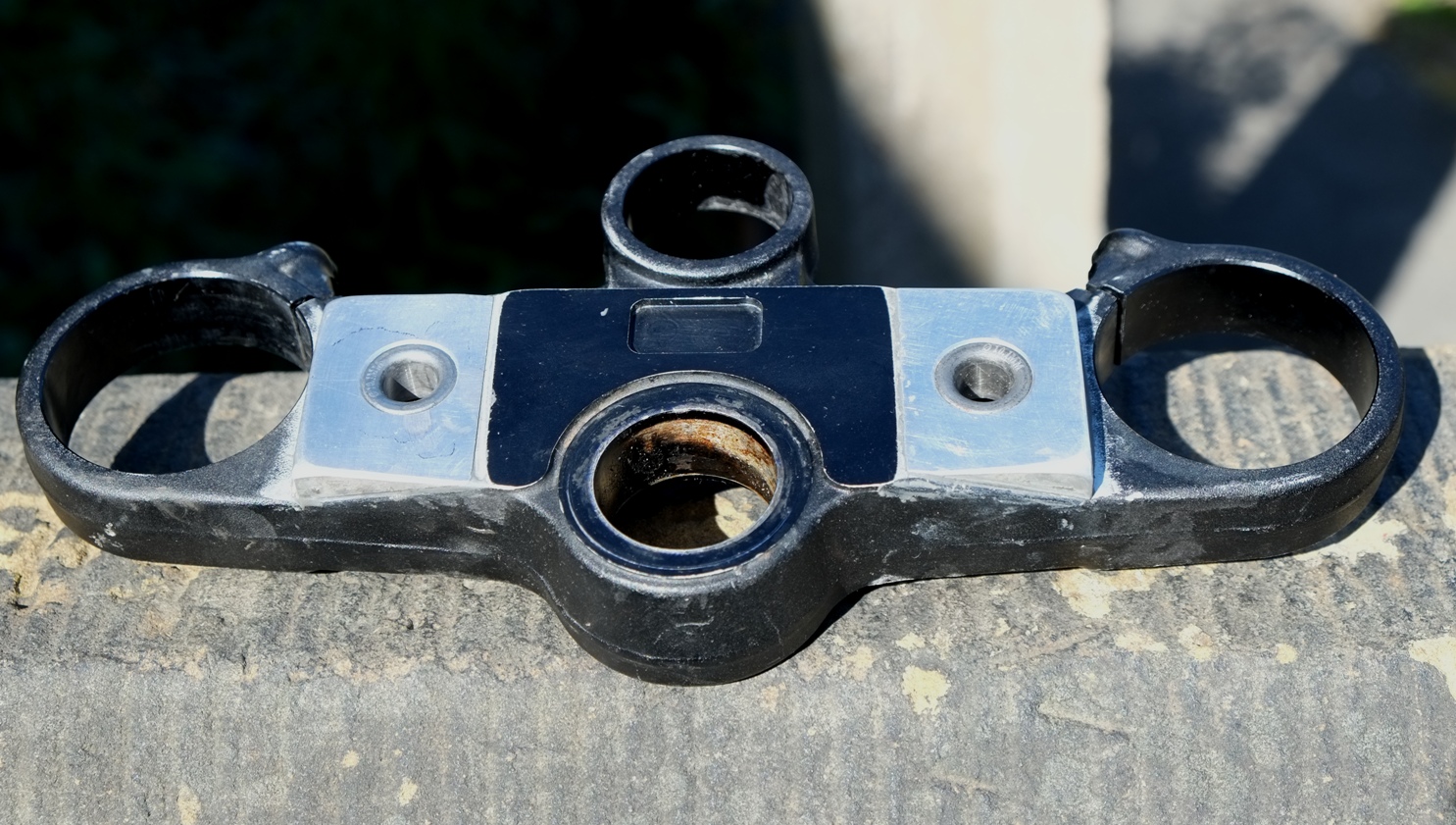

I used JB Weld to repair the table on a pillar drill that had the 'arc of shame' where people had drilled through the table, leaving it looking like swiss cheese. I then got it surface ground flat and it's been fine for years. Also used JB weld to bond two 'wedges' to the top plate of my Falco top yoke so it had a flat surface to mount risers on. Been great for nearly three years.
and another view:

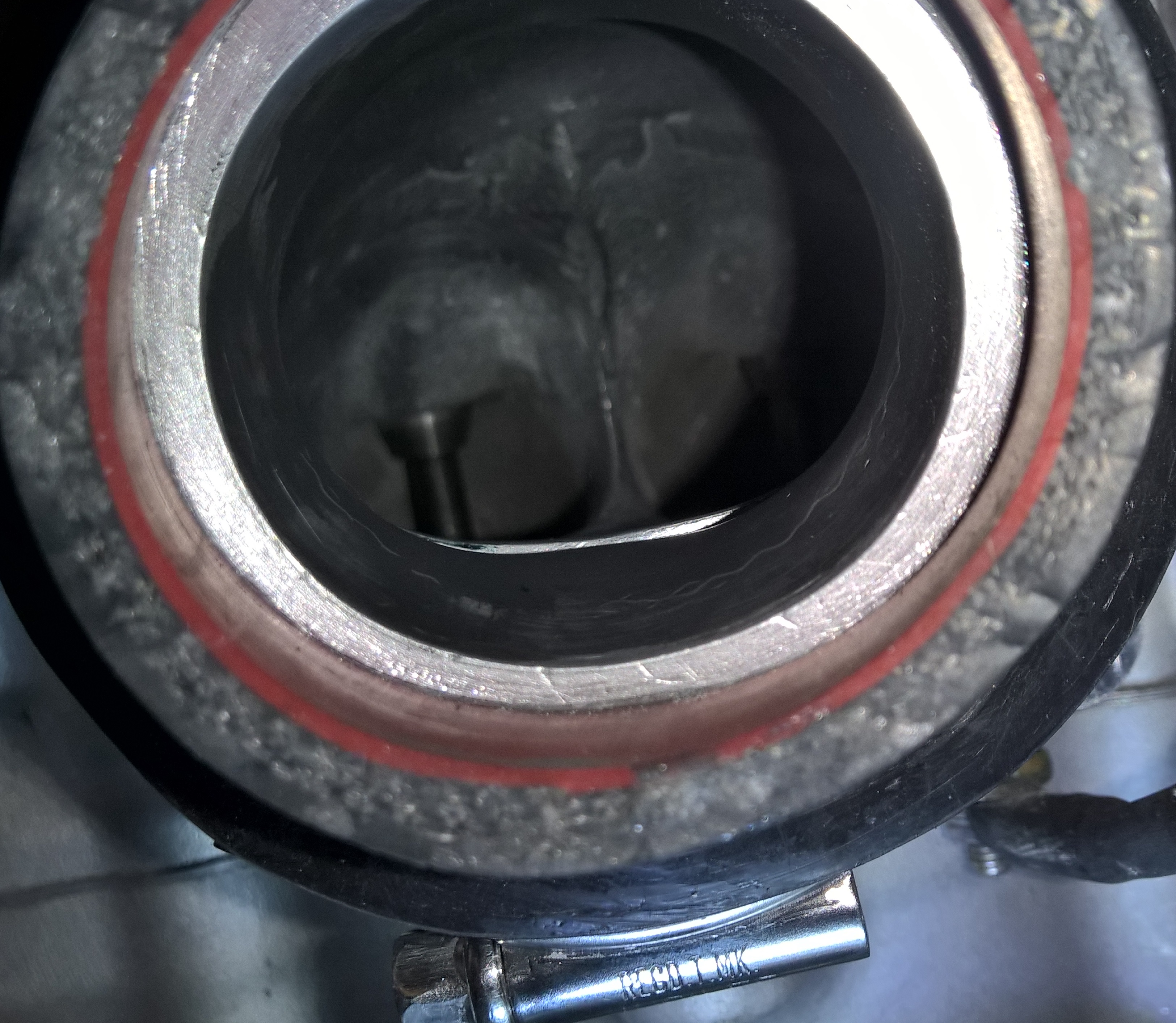

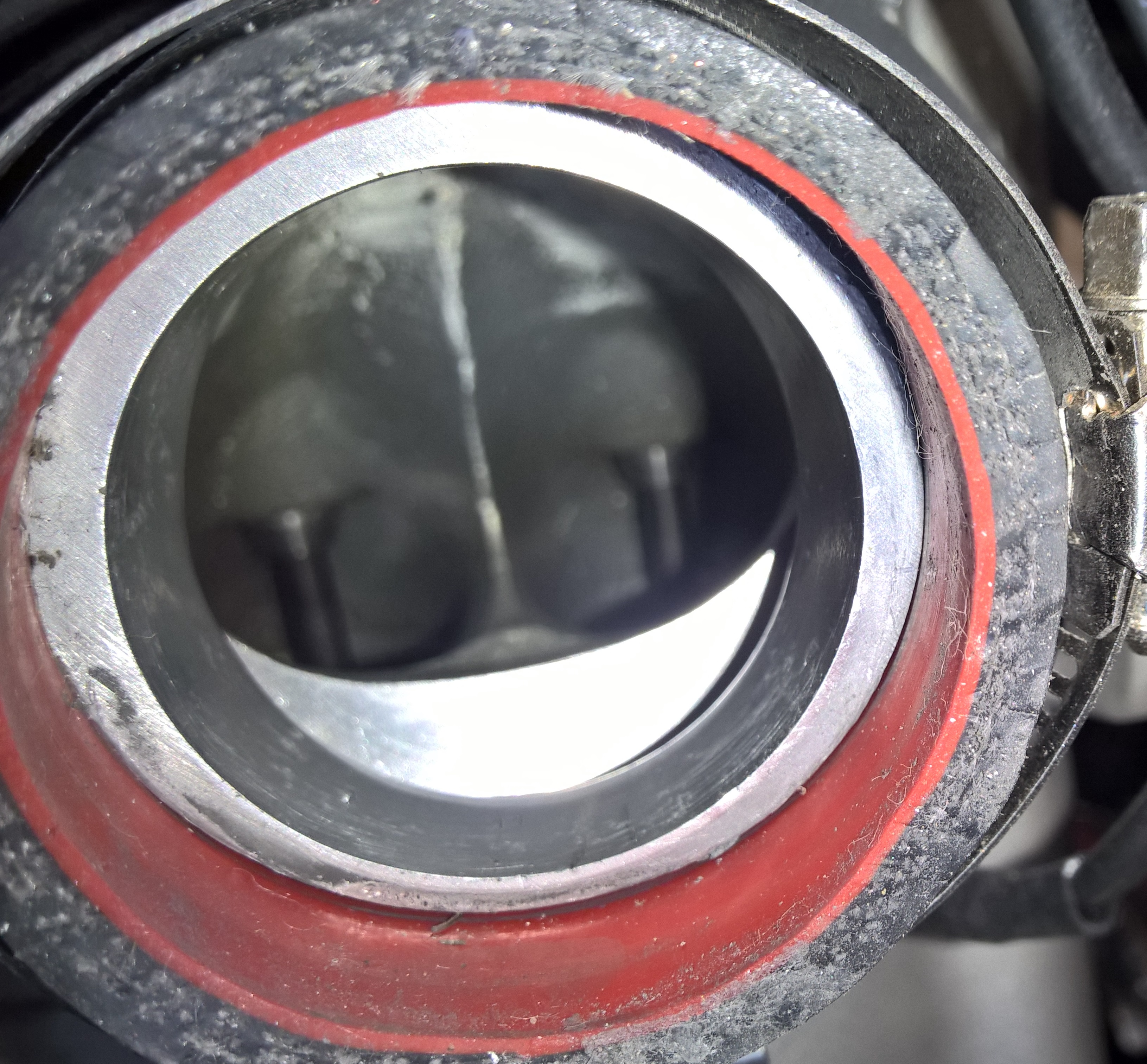

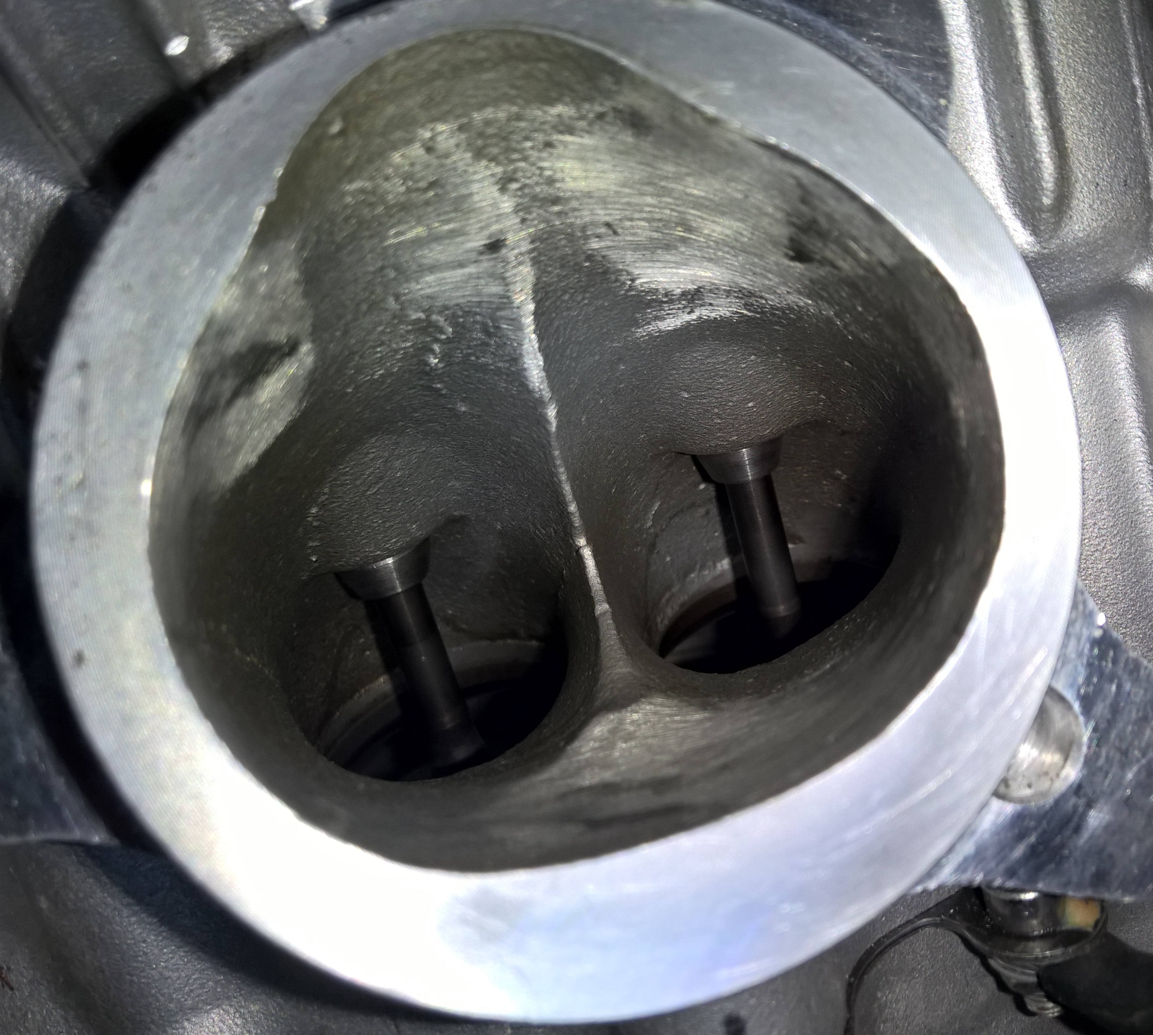

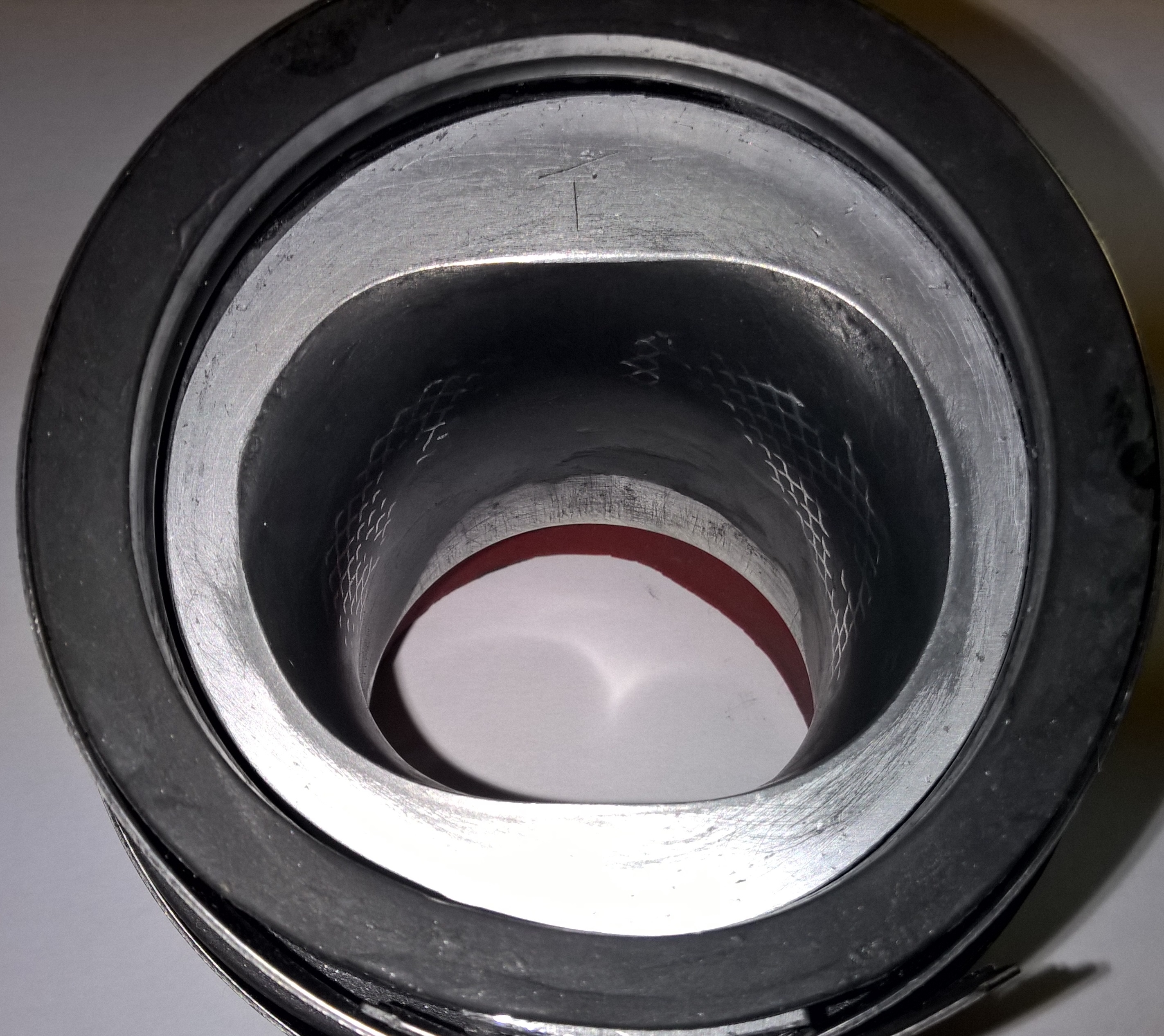

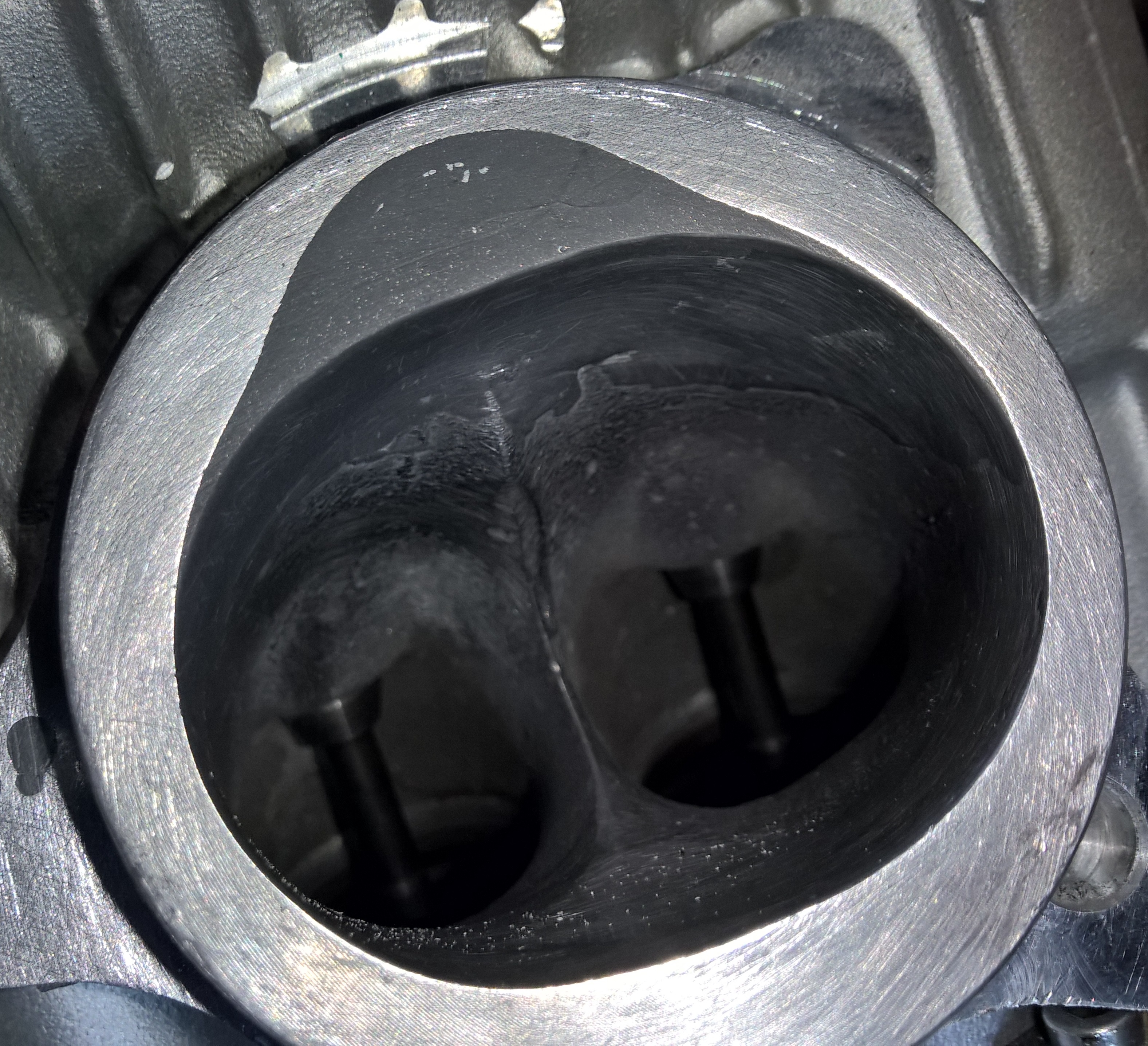

I used JB Weld to reshape the inlet port on my dohc engine. The engine had a recess at the top of the inlet port to assist fuel injection but since I'd fitted a carb this wasn't needed so I filled it in. I first drilled and threaded the top of the port and secured some ally mesh into the recess, I then filled it with JB weld. Finally I smoothed an polished the newly filled area. I did similar to the inlet port adapter to match them together.
Before
after
Inlet port adapter shape modified with ally mesh and JB Weld
Inlet port adapter before modifying showing bottom ridge
Modified adapter fitted to inlet port (Ridge now gone)

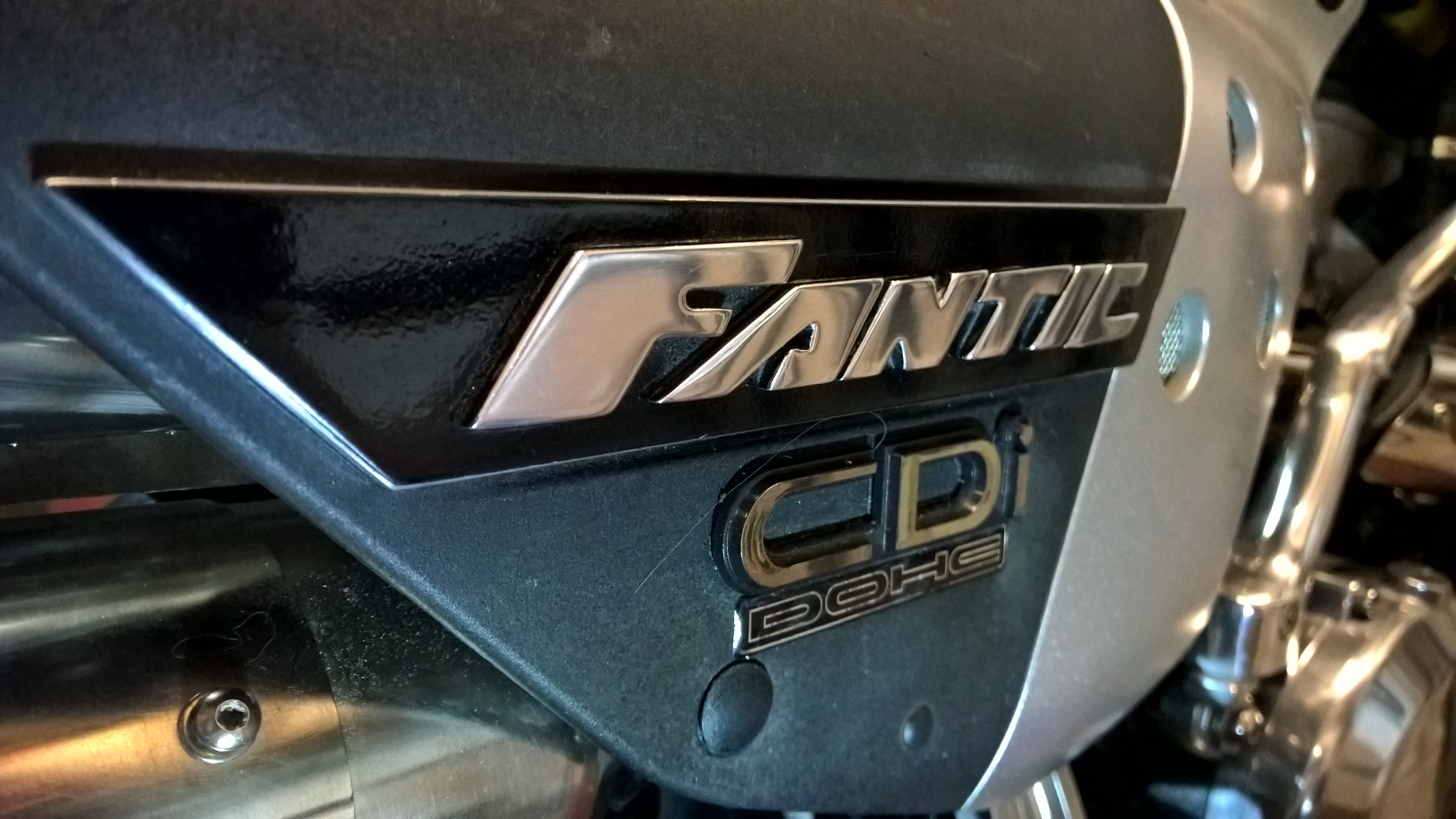

Made up these side panel badges. Basically the letters were cut out of 3mm scrap ally then glued with JB Weld to some 4mm plate. Then some masking, black spray and polishing.

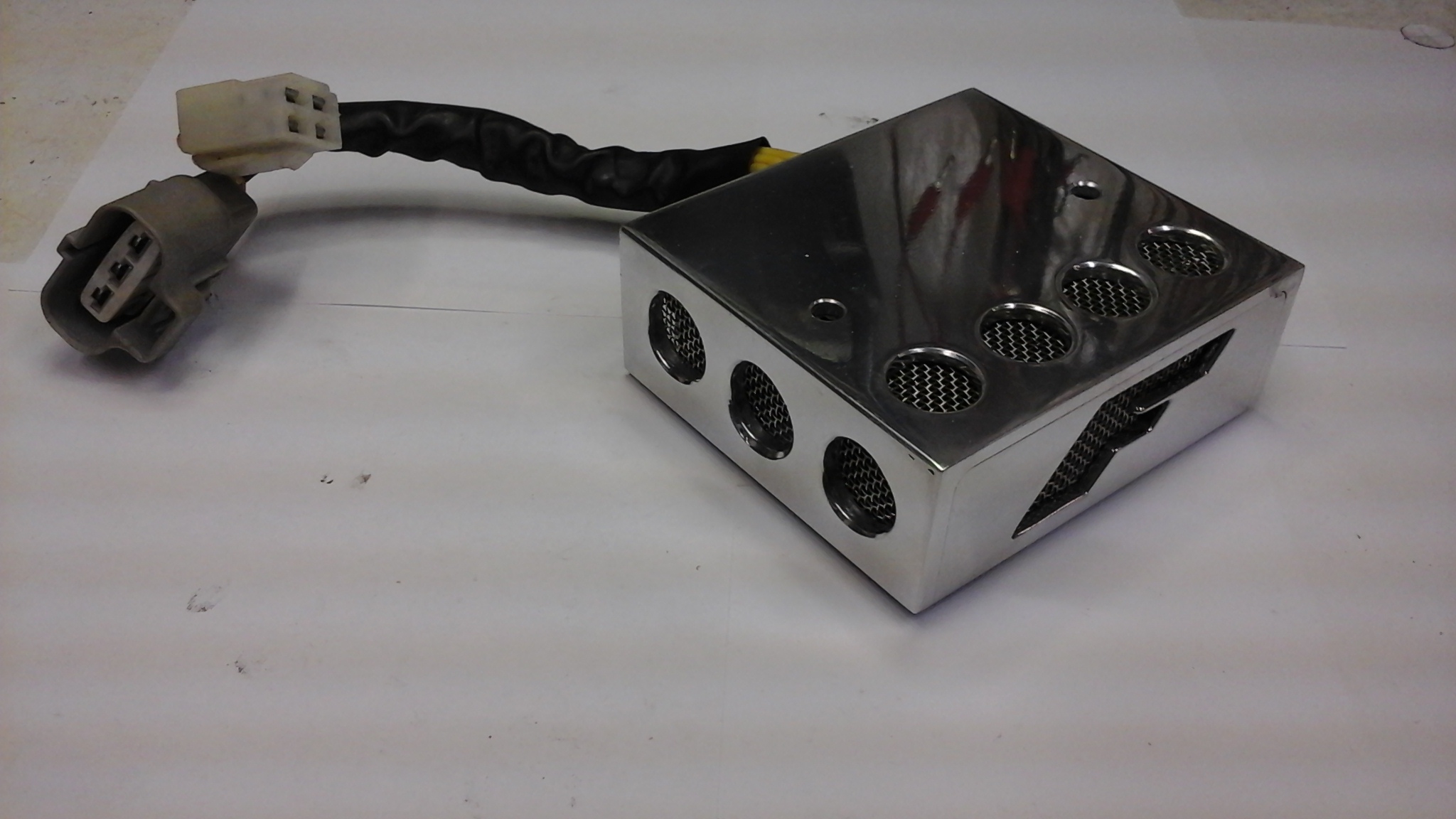

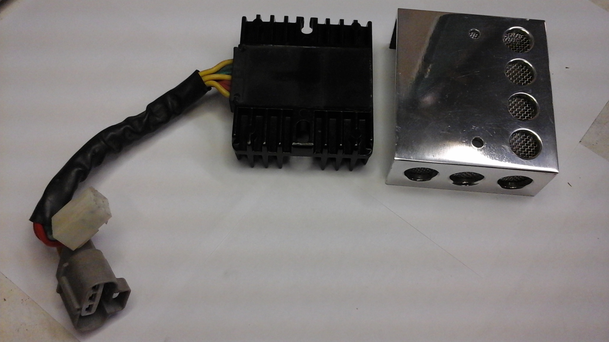

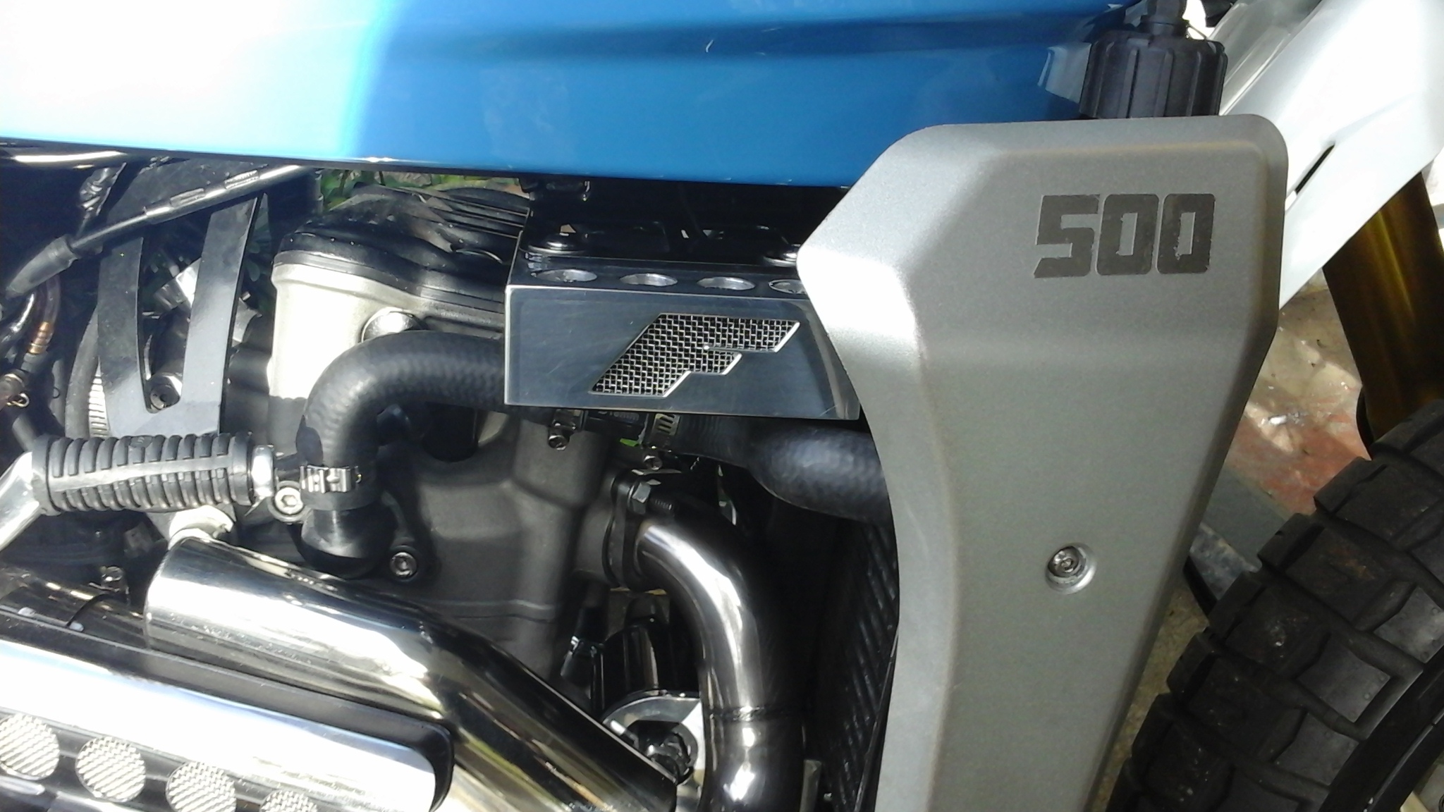

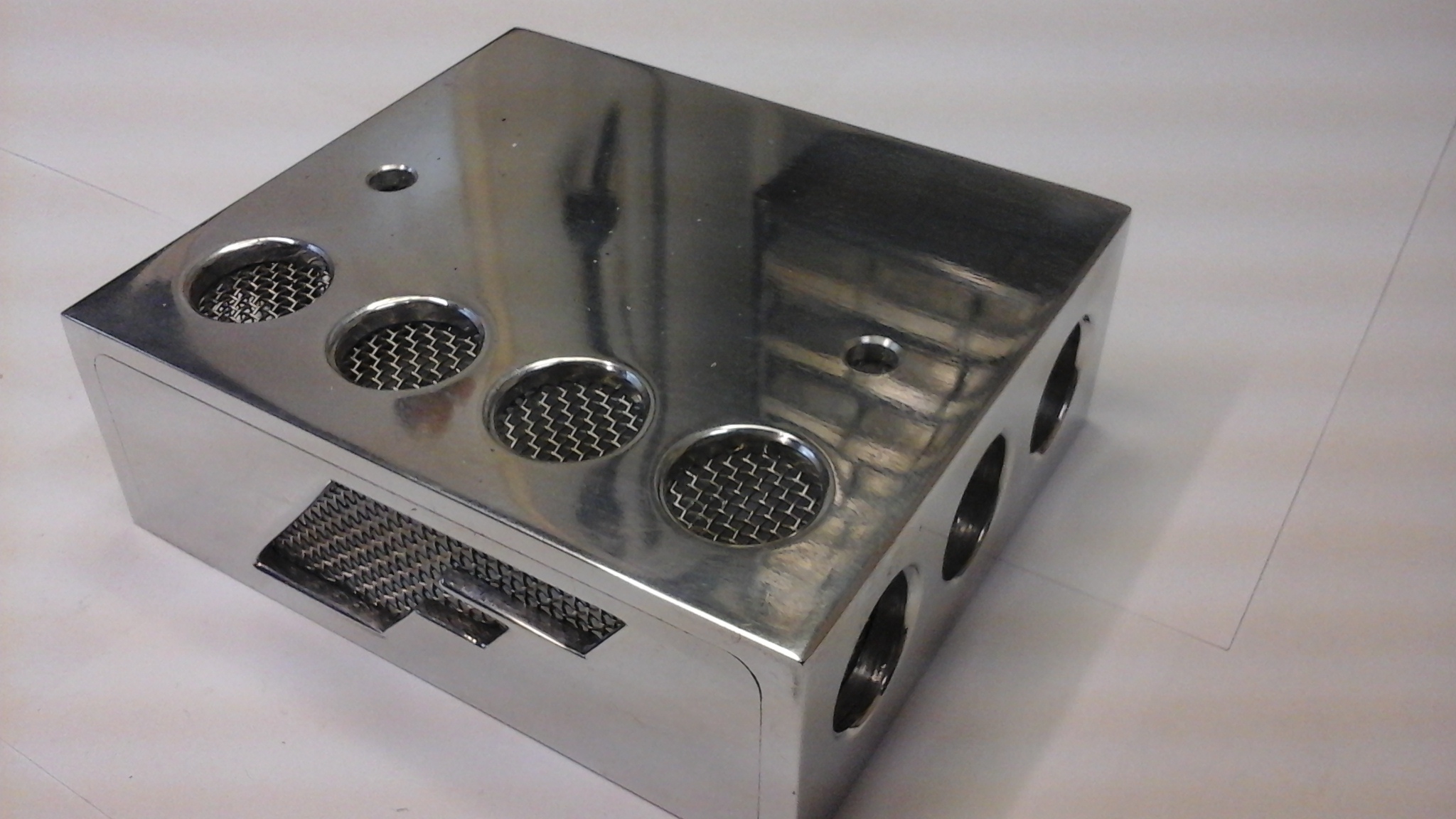

Here's another project I did, it's a cover for a rectifier/regulator that's stuck together with JB Weld.
