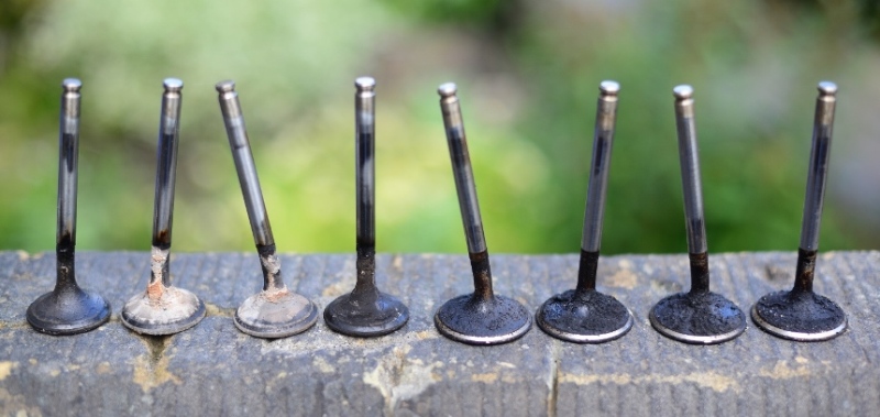

The real kicker will be whether there has been valve/piston contact. I presume it's an interference type design? Most are these days. When an incompetent French garagiste Donald Ducked my Beta motor fitting a timing belt I never asked him to, 7 out of 8 valves were bent.
And that was only at tickover.
