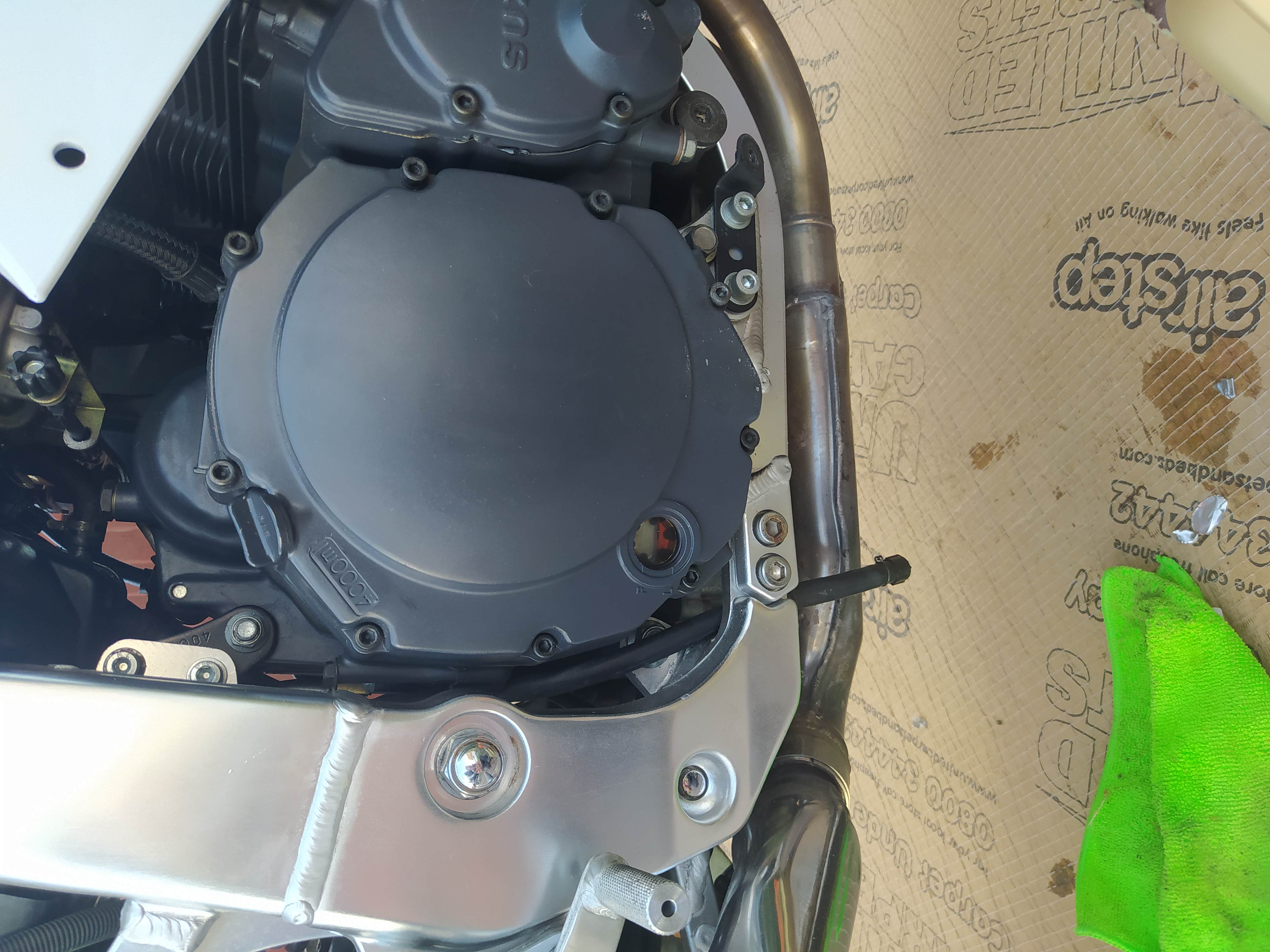

Had a look last night.
With the bike upright the sight glass was more than full.
Pulled the filler cap off and it smelt of petrol.
There can't be more than a litre or two in there, but I suppose I should change it sooner rather than later in case the ethanol starts eating stuff.

Re: It's only a teeny bit pink: GSX-R1100N
KungFooBob wrote: Fri Aug 19, 2022 8:40 am Had a look last night.
If by sooner rather than later you mean 'today' then yes...
Drain it as soon as possible, it's better with no oil in it than having contaminated oil in it.
KungFooBob wrote: Fri Aug 19, 2022 9:03 am If I run it long enough and it gets hot enough, the fuel in the oil will just evaporate off, right?
<this is a joke>
I suppose I might drain it tonight, but it'll seriously eat in to my Elden Ring time.
Don't run it, just drain the oil and change the filter.
KungFooBob wrote: Fri Aug 19, 2022 6:06 pm Is everyone happy now?
How much came out
Posts: 17505
Been thanked: 9496 times
Lots, next problem, it now appears to be a triple.
It's a four again!
I think I found the carb with the sticky float, I think I'd disconnected the vacuum pipe on pot 4s carb by accident so the tap wasn't working and was running on the fuel in the float bowls... Except pot 4 which must have had an empty float!

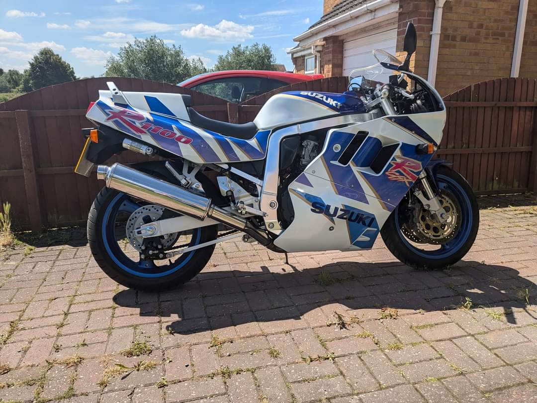

Posts: 15910
Has thanked: 8045 times
Been thanked: 5696 times
Delirious. :D
How old is that bike? From that shot it looks mint! :thumbup:
Posts: 17505
Count Steer wrote: Fri Aug 19, 2022 6:46 pm
Delirious. :D
1992, the last of the Oil Cooled GSXR1100's.
It's only got 13k miles on it and yes, it's in excellent condition, thats the reason I paid way too much for it :)
