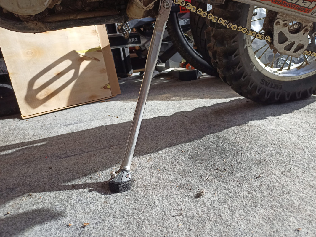

One other issue with the raised suspension is the side stand is too short, 15mins later with the lathe a lump of nylon and we have a solution......and the bike now has a name, Clubfoot :)

Love it - was great to see it in the metal yesterday too :thumbup:
And although admittedly my effort arguably isn't as well engineered or durable as yours (mainly as it's made of wood :lol: ) , it's equally functional- great minds eh! 8-)
