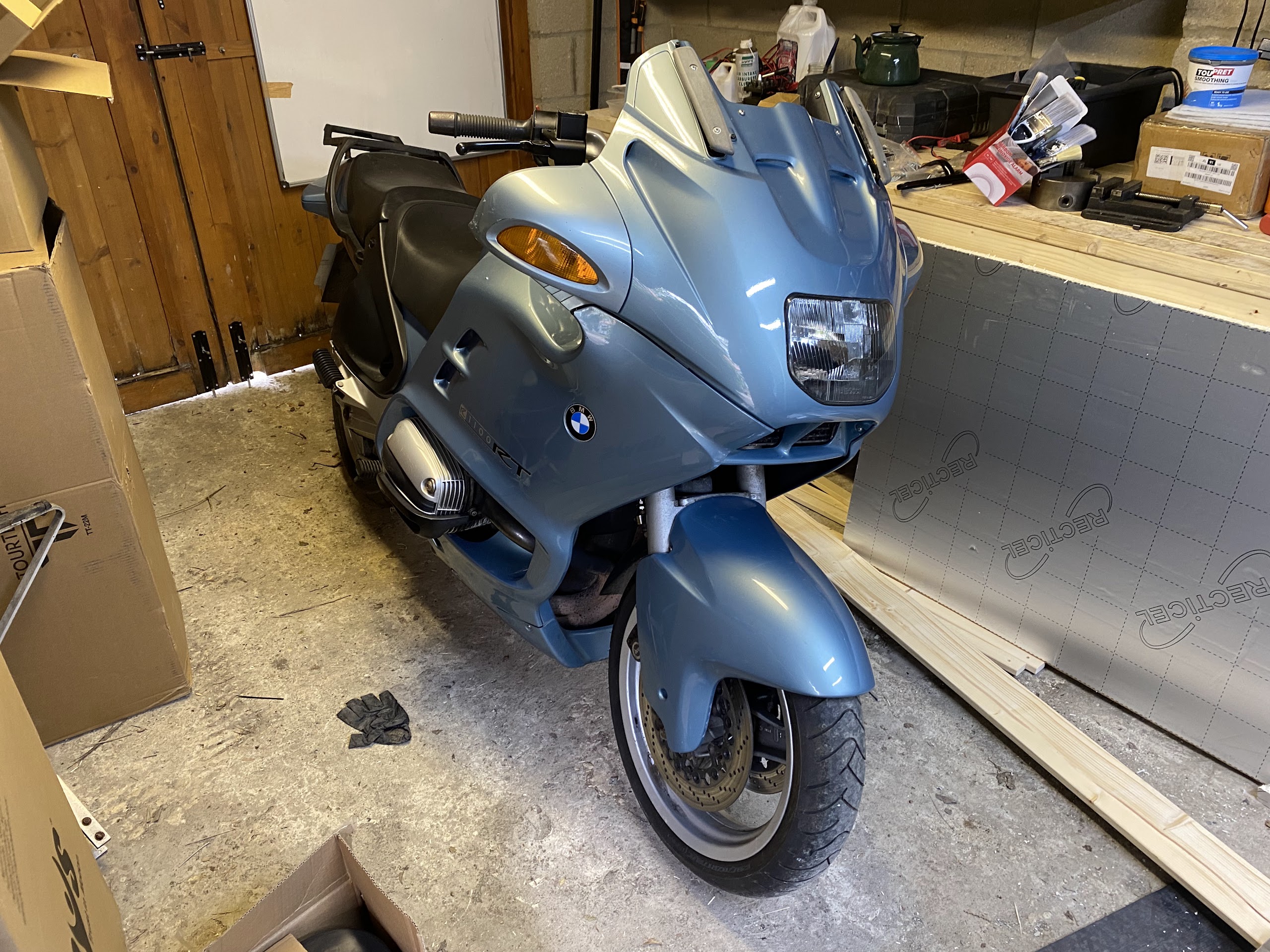

Donor engine obtained…
It’s a 2001 r1100rt with 40k on it. Pretty tidy although that doesn’t really matter and the engine sounds perfect, really quiet and smooth. Got it for £500 because the gearbox is broken and I don’t need that.
What motor does the CV have in it. ?? Interesting project this @dern 👍

dern wrote: Mon Mar 24, 2025 10:23 pm Not so much salt on the roads so the 2cv is mot’d and out and about in its new home in Norfolk. However was driving it the other day with the roof down, uphill and into a head wind and struggled to go much over 50 so it’s upgrade time, when I get time.
Those panniers are worth £200 easy, you'll get your money back on the rest of the plastics no worries.
The first step will be stripping it down, working out what I need and what I don't and ebaying/scrapping the rest. I should get a few quid for the bits.

Finally motivated to get it out of the van as I need to pick up some furniture for my daughter. Took it for a run up the road and I can't see that there's anything wrong with the gearbox. Rides like a bloody lump though, don't feel bad at all splitting it for parts.
The fitting kit for the 2cv has arrived as well as the John Gemi chip. I just need to clear the decks of projects and start stripping the bmw down in a couple of weeks.
