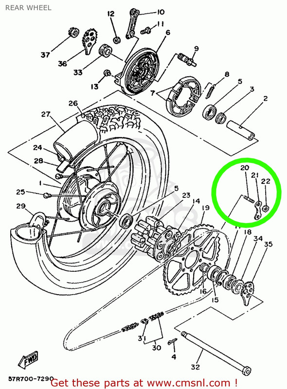

They were on a XT350 which shares the same 15mm axle as my KLR650 forks. The rear will need a bearing swap or some top hat spacers.

Captive spacers for the win. Maybe not the win, but a lot less cursing when putting the wheel back in.

Good spot! You seem to be good (or lucky!) finding these online bargains.
I see that rear sprocket appears to be held on with three bolts. Just be aware that I think the standard mounting method on the XT is with six threaded studs and nuts with three double tab washers (presumably to minimise the possibility of stripping the threads in the aluminium hub).

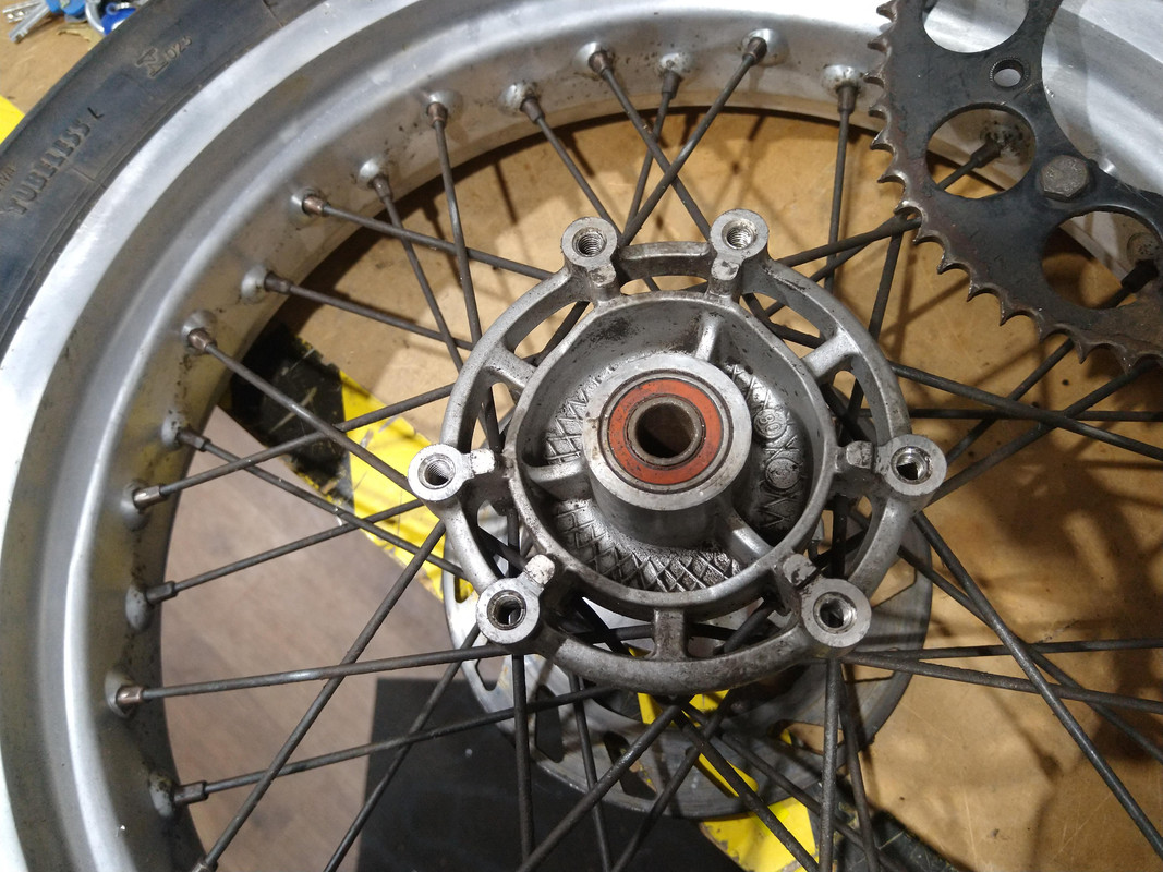

Cheers. Three bolts are indeed missing, and the XT350 is a drum rear so these are off something else completely. The rear had an AJP caliper in the photo so I'm guessing it's a European 125 motard or similar. What's the worst that could happen bolting it to an open class 2stroke....Luddite wrote: Sun Jan 10, 2021 2:09 pm Good spot! You seem to be good (or lucky!) finding these online bargains.

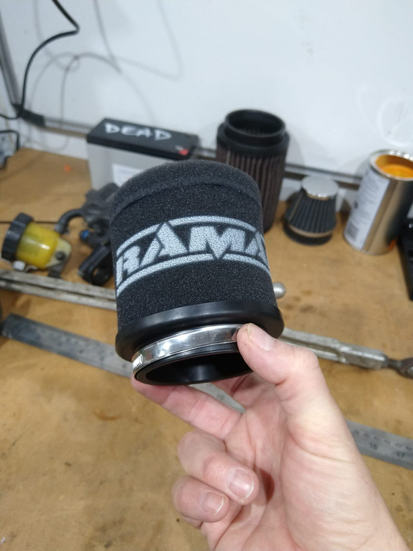

New airfilter pod arrived.

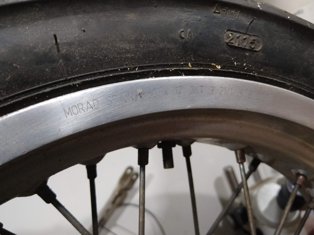

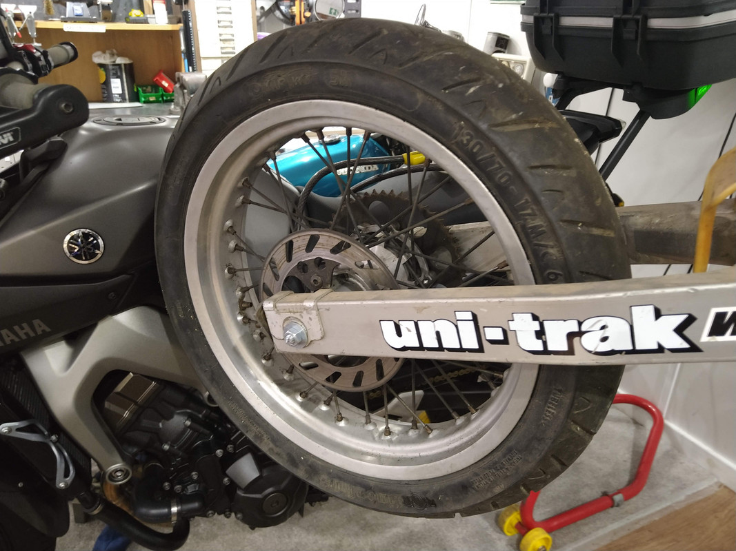

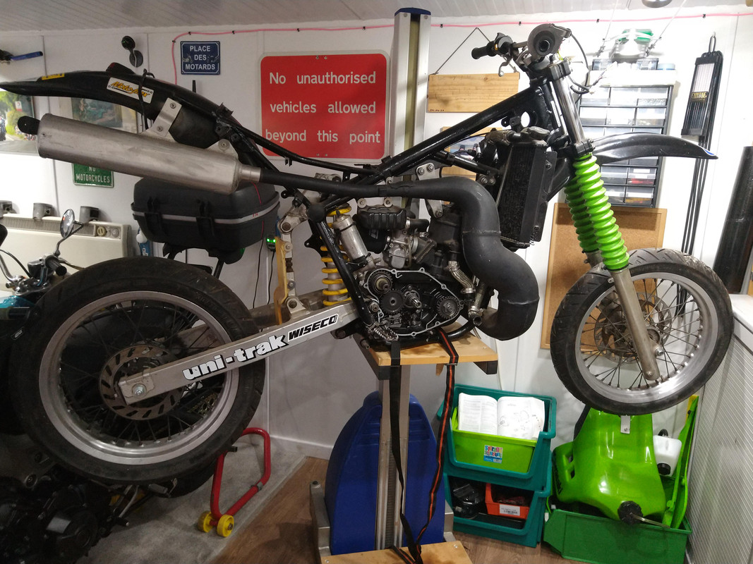

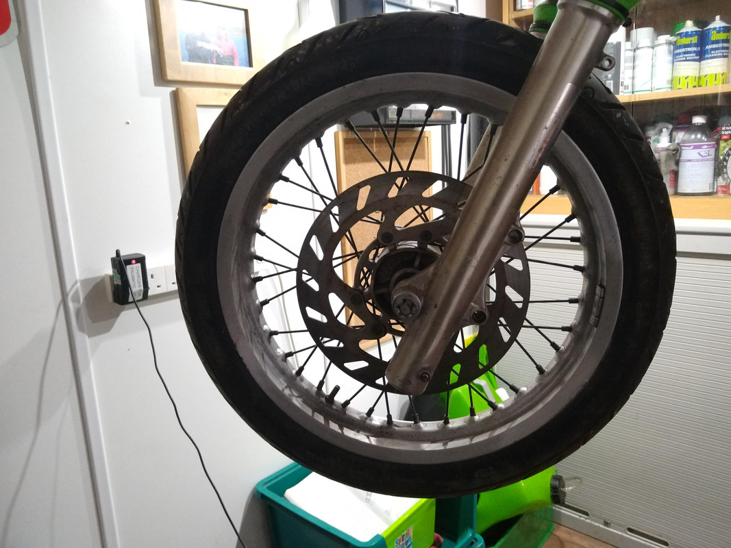

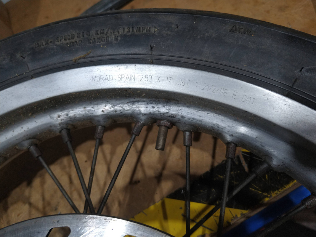

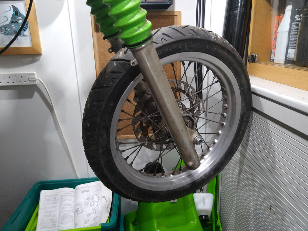

The wheels arrived today. As suspected they look to be off a 125. After some googling I think they were on a Motorhispania Arena 125 https://bikez.com/motorcycles/motorhisp ... d_2006.php as the disk pattern and the rim sizes match.
The front has a 100/80-17 tyre and the rear a 130/70-17. Not wide, but it should be okay and I want to keep it fairly 'period' looking. I think fat tyres, USD forks and a 320mm disk would look out of place. I can get Pirelli Rosso 2's in this size.

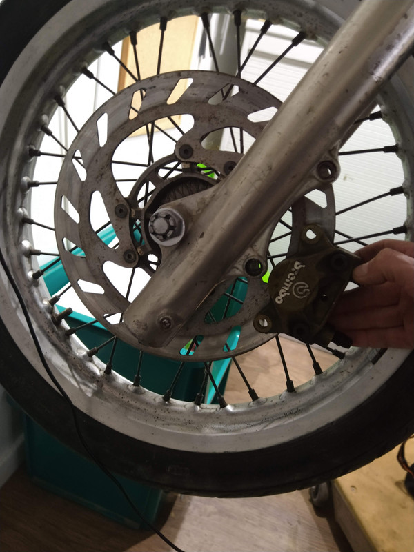

From disk is 260mm, again this should be fine for what I'm doing. Just need a suitable calliper and mounting place, I'm thinking this twin opposing piston Brembo might do, it's the rear off a 900SS Ducati. Again it looks like period and not overkill.
I need to find a rear one with a 20mm axle hanger and use the existing torque rod.

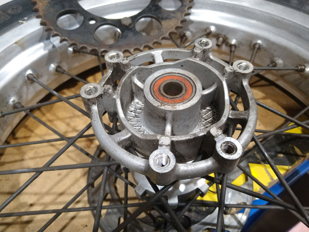

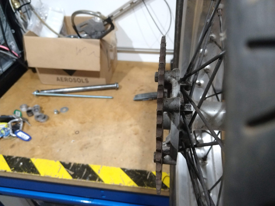

The rims and spokes look of decent quality, I'm a little bit concerned about the rear hub though. The sprocket doesn't seem to be bolted to that much 'meat' as it were. Fine for a 12bhp bike, but 50bhp? Hmmm, what do you lot think? As I say the rims are Morad jobs so I could always get the rear relaced to a different hub. Dunno. I'll see if I can get a custom 520 sprocket with that bolt pattern and then at least get it MOT'd.

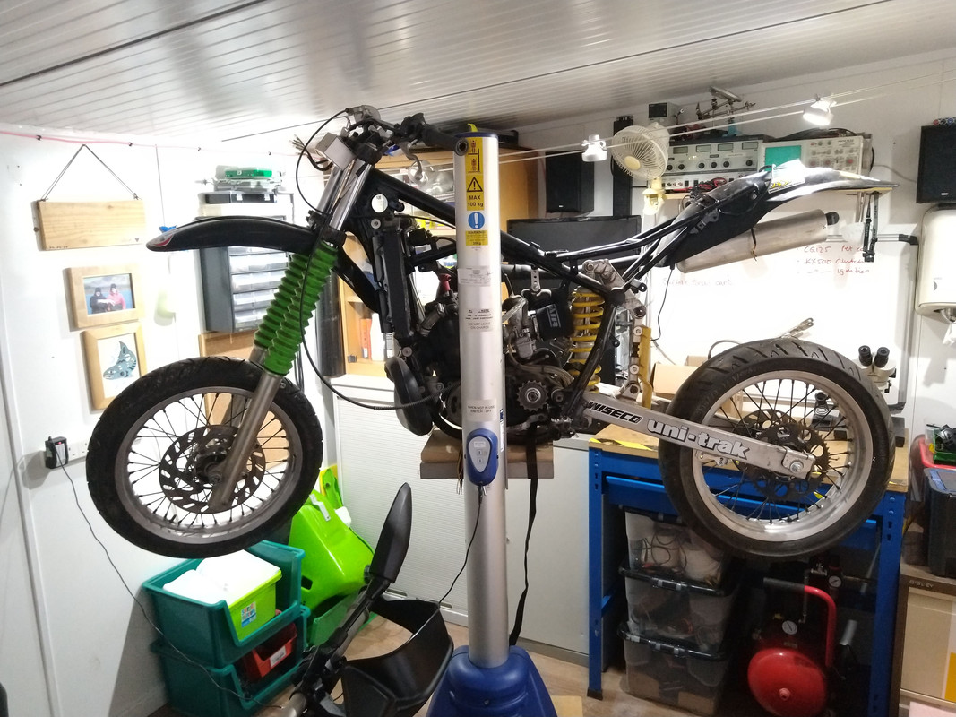

Anyway, the spoked wheels certainly look loads better than cast ones when they are on the bike.
