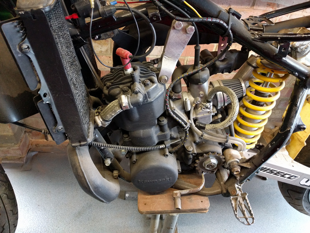

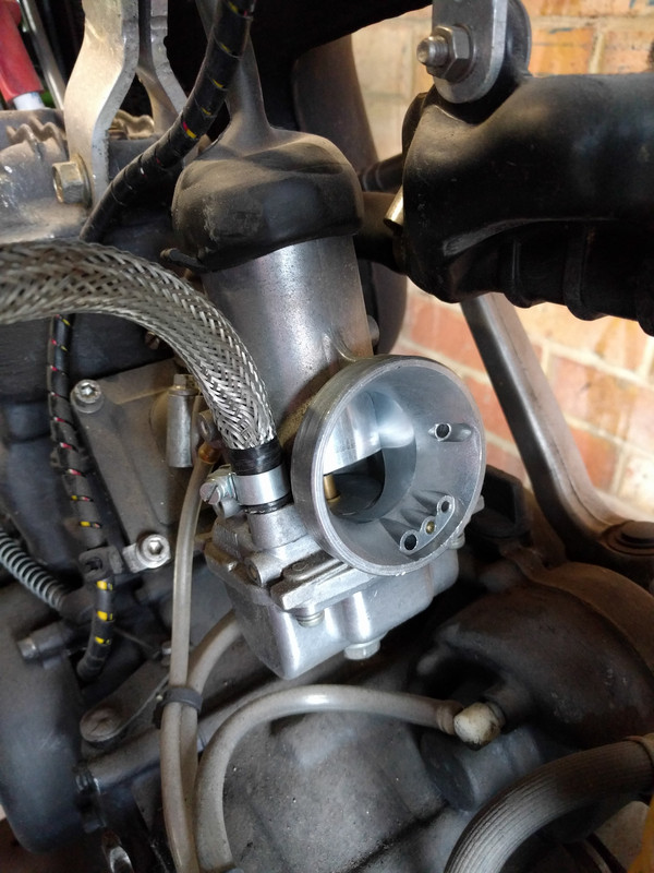

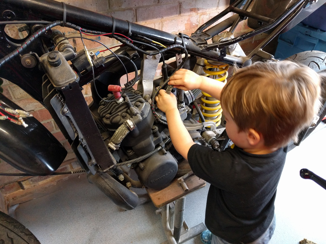

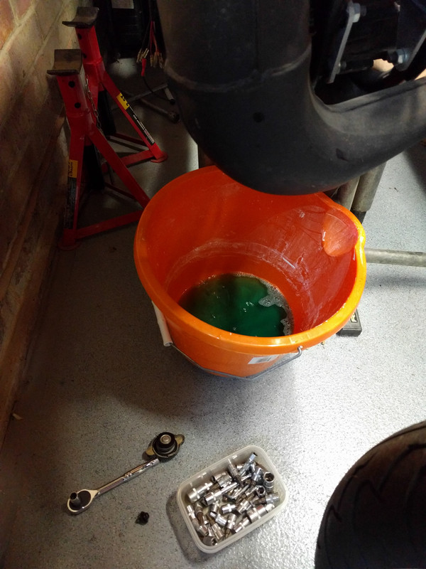

So today I had a spare hour so I took the body work off and made a start on getting the engine out. Strangely enough the kick-start seemed to be working but I'll still be opening her up to check the mechanism. The replacement part arrived and is in good condition.
I'd honestly forgotten how huge that barrel looks!
The boy comes to give me a hand.
Massive carb...
Coolant was in good nick, no change in colour and no indication of corrosion. Good news as it's been sat for so many years.
Massive carb...

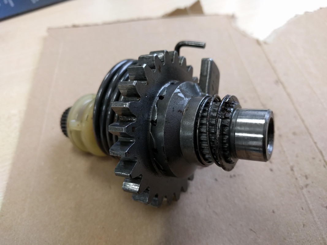

To recap, it's never run. I had a full top and bottom rebuild then couldn't get a spark and while trying to get it started the kickstart started slipping so it couldn't be turned over.
I've dug out a new coil and a 2nd hand CDI I bought at some point over the last decade and also another kick start assembly. Tonight I drained the gearbox oil and took the water pump and crank case off.
Once I've got it kicking over again I'll be back to the ignition issue. I've ordered one of those temp fuel tanks you hang from above in anticipation of it firing up. The plan is then to make a list of what needs doing, break it down into chunks like sort the wheel spacers, chain alignment and brakes. Then it needs registering and an MOT.

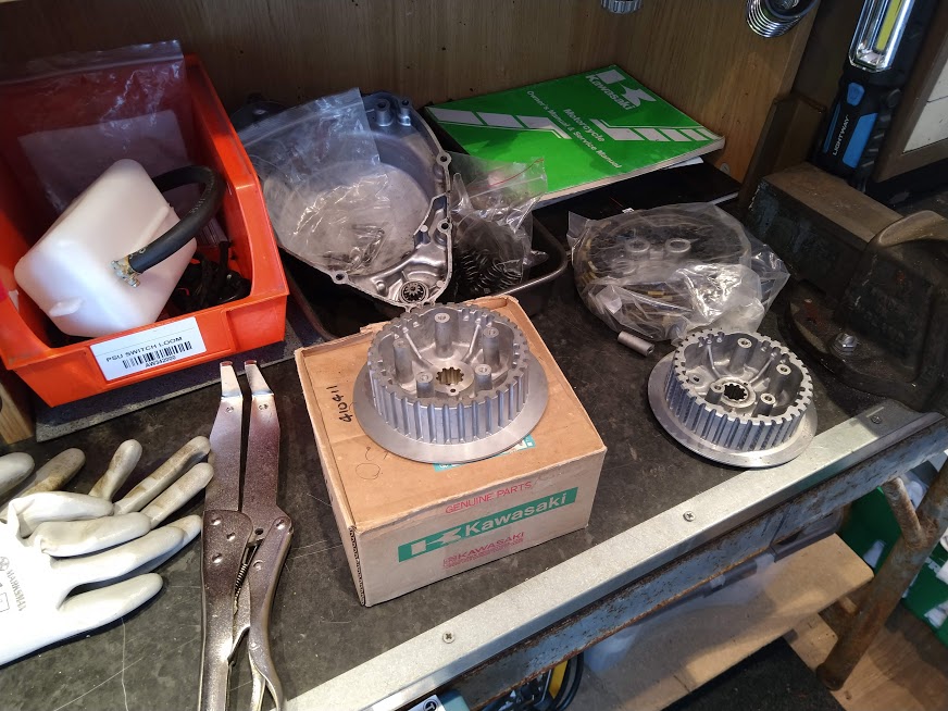

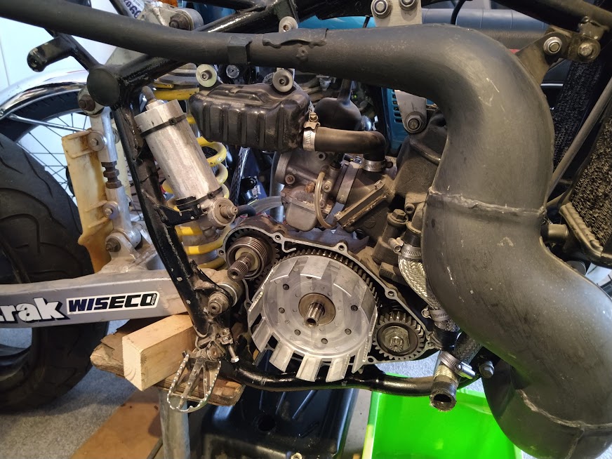

Always use a clutch tool to hold the hub when torquing up the nut... there's a €90 lesson.

New clutch hub and the correct tool arrived.
Sadly self isolating with 3 kids at home means I still don't get a lot of time to progress things.
