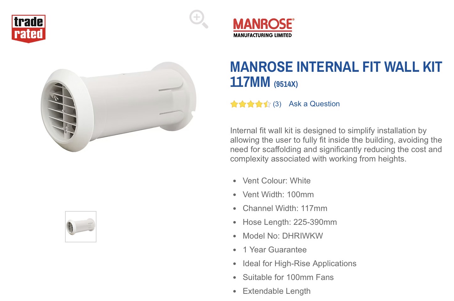

Re: 2nd floor extractor fan: allows a gale to blow into the bathroom!
Post by Silly Car »
These fans are fitted from the inside and have a baffle / flap device in the tube.
https://www.screwfix.com/p/manrose-inte ... _container
Post by Mr Moofo »
Silly Car wrote: Sat Feb 14, 2026 4:55 pm These fans are fitted from the inside and have a baffle / flap device in the tube.
Thanks for that - I will now go and have a measure up :thumbup:
Post by Silly Car »
Mr Moofo wrote: Sat Feb 14, 2026 5:32 pm
No worries, IIRC, you can also buy extensions for the telescope section for thicker walls.
