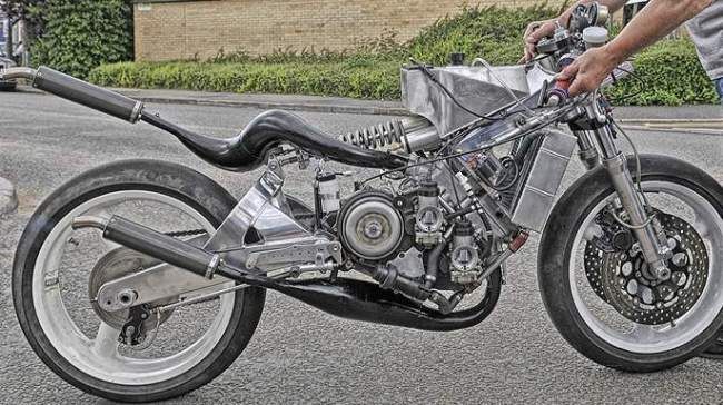

Look at it carefully , the more you look the more you’ll find.
This was the Bike a few years back. It has a new front end now.

That is very pretty.

It's their own engine. A twin tandem disc with 4 carbs. Rear end bolts to the crankcase and front on the cylinder head.
Have you spotted the rear brake system ?

Using a pipe as the stay rod to save weight?

yes , and the master cylinder as the lever as well.

Yes, now I squint at it a bit harder.
