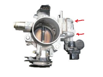

Re: How would you go about removing the screws of the IaCV from this throttle body
I think he means these screws. The two arrowed and two on the other side you can't see.

I thought it was the ones going vertically upwards through the plastic bit.
iansoady wrote: Thu Jul 10, 2025 4:08 pm I thought it was the ones going vertically upwards through the plastic bit.
But that looks like it's only held on with two screws rather than four.

As kung foo bob pointed out the screws, I'm not sure that I can use an impact driver as not sure if I can place the throttle body on a surface where I can hammer the impact driver with out possibly damaging something else. Though, I have a chefs blow torch so localised heat should be easy enough
iansoady wrote: Thu Jul 10, 2025 10:04 am I'm guessing the offending item is the black comonent to the bottom right of the body. It looks like plastic so I'd be very careful with heat. However, if you're replacing anyway it might be worth sonstructively dismantling with a cutting disc in a dremel. The damger with excessive heat / impact is distorting the injector body itself.
Actually the cutting off might be an idea. Am thinking angle grinder and thin disc.
Eclipse wrote: Thu Jul 10, 2025 1:53 pm I thought he was talking about the butterfly valve lol
Yeah if its plastic don't put heat anywhere near it.
Throttle position sensor, which I think isn't physically adjustable.
KungFooBob wrote: Thu Jul 10, 2025 2:03 pm I think he means these screws. The two arrowed and two on the other side you can't see.
Looking at the photos the screws go all the way through, so was thinking very small drill bit and dripping a bit of oil to cool the drill and then mole grips the screws out.
