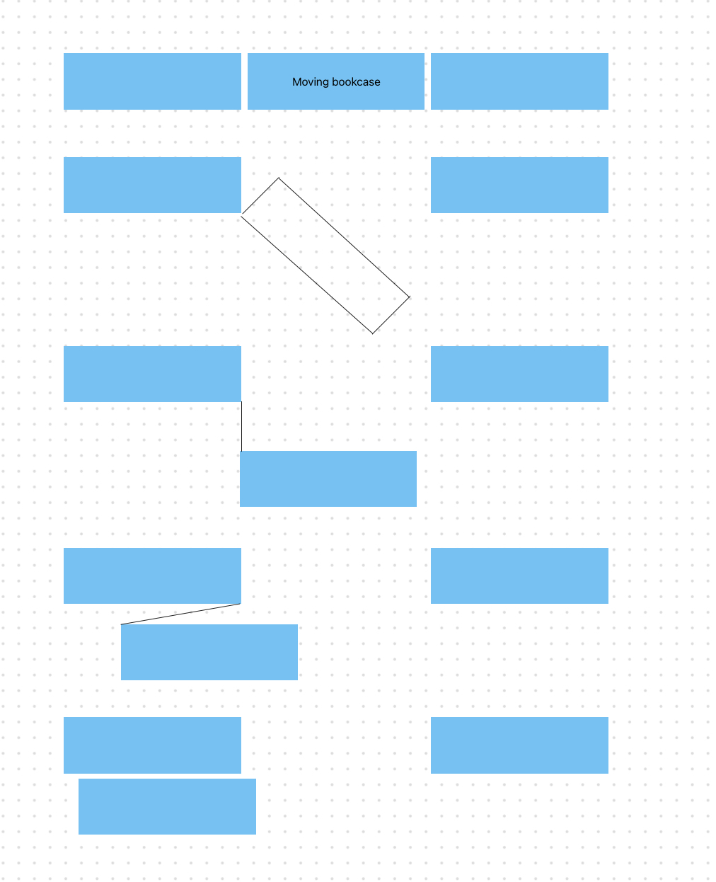

I saw a TikTok / instagram / Facebook short where a joiner had devised a “hinge” mechanism which allowed a bookcase door within a row of bookcases to open like a normal door then fold back in front of the adjoining bookcase much in the same way a sliding door on a car / van but without the tracks just operating off hinges.
I probably haven’t explained myself very well but hopefully the below will kinda help:
Fingers crossed someone can find the short video clip / find something similar / etc

The hinge would need to be above the book cases and pivot half way* along the left hand case to make that work.
* Variable depending on how far back it is attached to each.

I completely understand where you are coming from but in this missing clip, the hinge appeared to be mounted on the side of each bookcase rather than the top.

There's a third piece of wood in that list video. So you have 2 sets of hinges, either side of a "filler" that will be the half the width as your desired "offset" from the original position (or, more likely, the same width as the depth of the "door")
(Or something)

I have managed to draw it up in sketchup whilst wasting the last afternoon at current employer’s expense, I’ll upload a picture of it later, but essentially RB has got it nailed.
L shaped piece which offsets for depth and width of moving bookcase with hinge at either end.
A ‘packer’ on the side of fixed bookcase and another on the back of the moving bookcase to account for thickness of the L shaped piece
I’m pretty sure the entire mechanism could be fabricated out of steel for added strength/ reduced thickness which may work better than just using wood.

I haven't got a clue how to animate within Sketchup 2017 but hopefully the attached images make sense, there is an alignment issue I need to resolve as part of the L shaped piece gets embedded into the sidewall.
