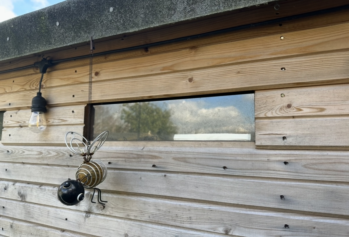

As above really, I think it would be good to allow some air in to the shed at time’s.
From what I can tell it’s a bit of plastic held in my a tiny bit of silicon and some small wooden battons.
How would I make it so I can open and close it??
Cheers
Cheers

You could see what kind/size of glass louvres are available for greenhouses then make the hole the right size to fit. IIRC (without going out to look
) you just screw the mechanism on each side and slide the glass into the slots so, in theory, provided you can get the glass slats cut to size you can make 'em fit just about anything.
Otherwise you could get someone to make you a window to drop in and secure. The double glazing folk seem to be able to get any size made up to fit.

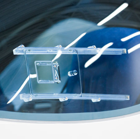

Another piece of perspex that slides side to side in a channel, kinda like this:

That’s cool, where can I order it?ZRX61 wrote: Sun Mar 02, 2025 8:08 pmAnother piece of perspex that slides side to side in a channel, kinda like this:options-ventilation-window.jpg

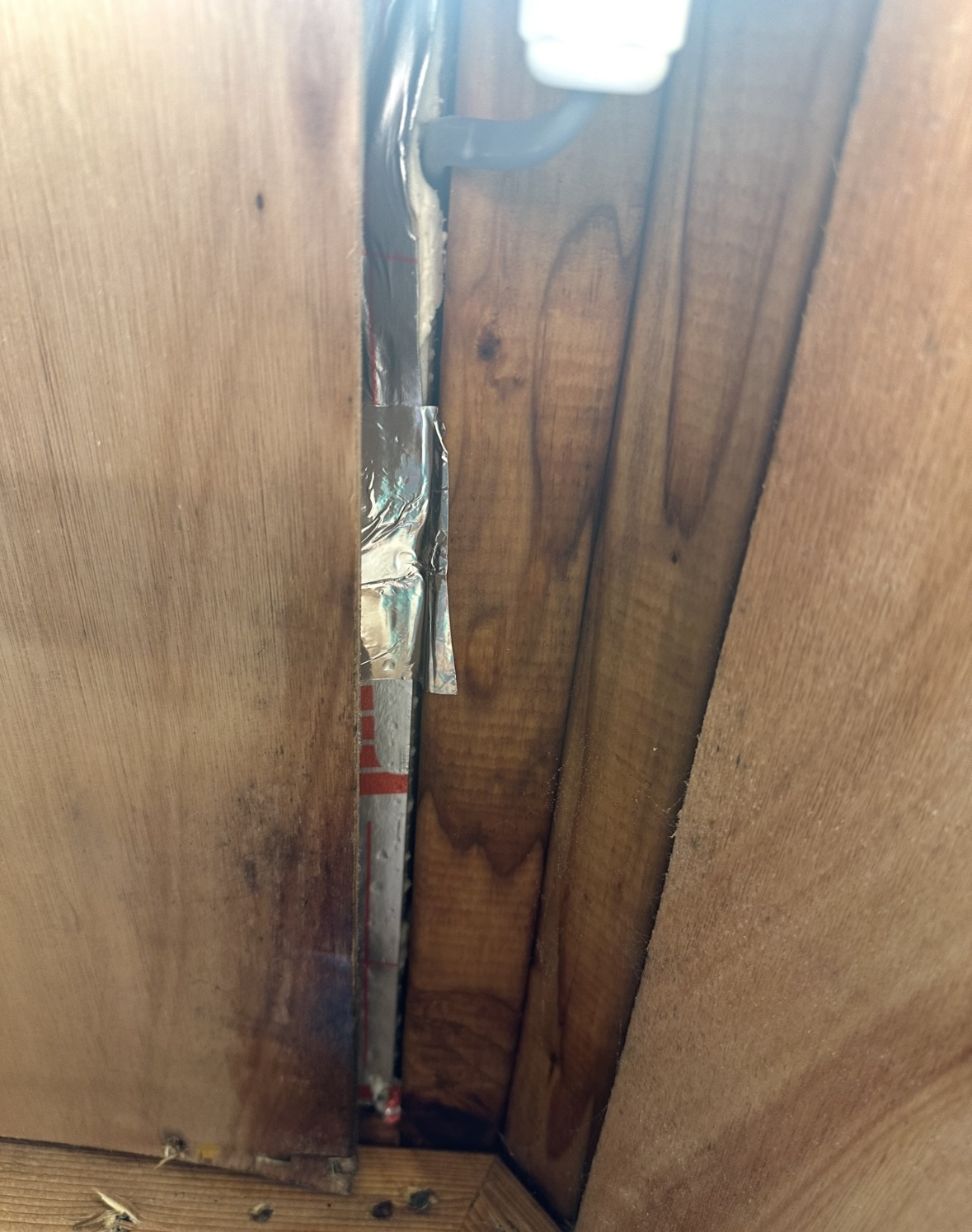

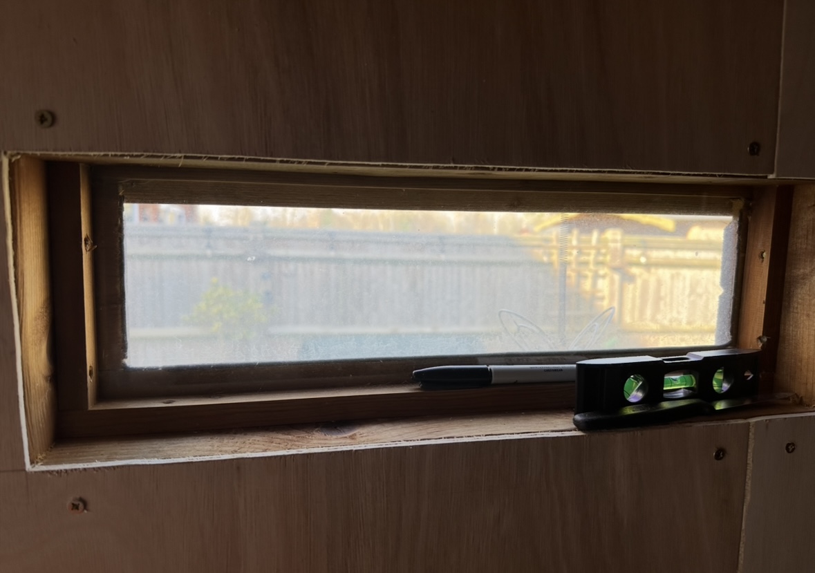

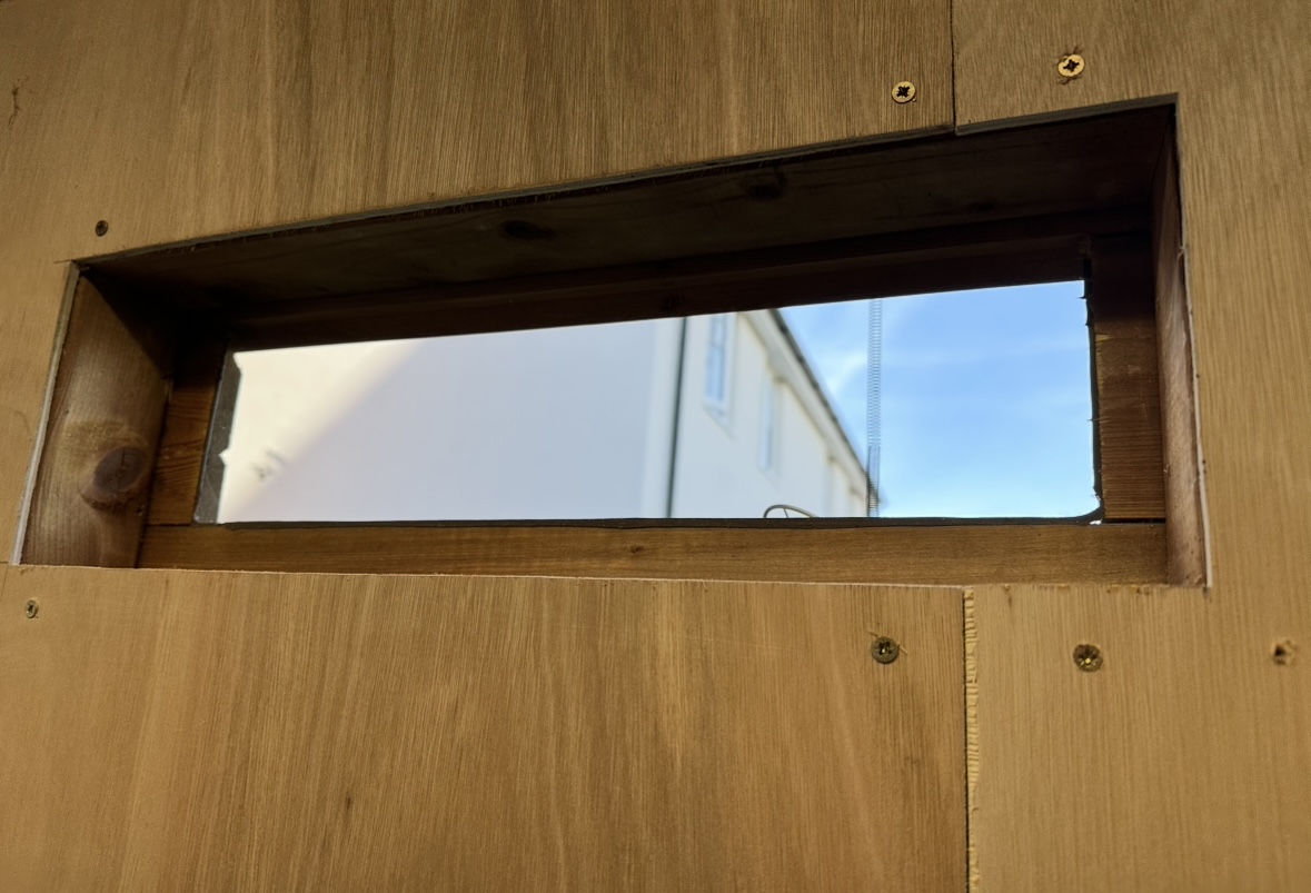

I’ve removed 2 panels from the windows at either end, hoping that will create some air flow.
Water/condensation seems to be forming on the center roof, quite a bit to be fair since completing the insulation.
Hoping the windows will sort that.
I’ll probably order some Perspex to fit the window and either fit a hinge or just leave them loose until I can work out how to fit something
The windows are too narrow for a person to get though

That one is intended for aircraft so comes with aviation pricing that would make your eyes bleed...

When it's all dry you could give the areas that are getting the condensation a coat of polyurethane sealant or some such. Won't stop the condensation but should stop the staining. I'm guessing that the area you've photo'd get the coldest.
Ventilation + air movement is the answer. (Or a dehumidifier).
For ~ £8 you can get a digital humidity meter with max and min levels from Amazon. For ~£12 you can get the Blutooth version so you can monitor the humidity from indoors. Supposed to work at 80m distance but I'm not sure I believe it.

So the 2 panels I’ve removed got broken in the process.
Also now they are “open” there is zero condensation on thr roof where is was forming and the bit that looked damp has dried. So guessing airflow is not issue now
