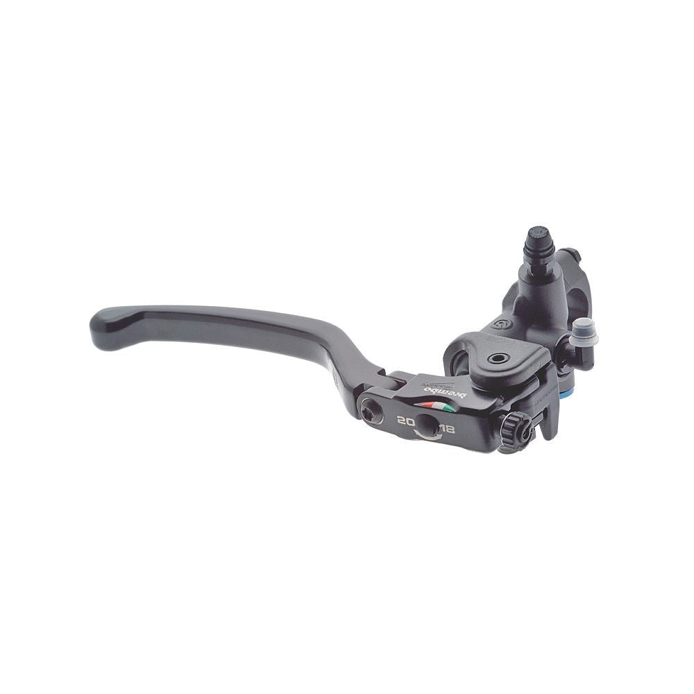

Splashed out pennies a while back on a no name 19mm rcs, all singing, all dancing multi adjustable master cylinder.
Only thing being.....nowhere to mount a switch!
So I duly order a hydraulic unit, which in the due course of time has now failed.
So of course, my MOT is due on the 1st of Jan, so must be replaced expeditiously.
Cue calipers off and pistons pumped out as far as possible, 1m length of tubing off the bleed nipple pumped full of dot 4.
Drop the offending banjo bolt, insert new one asap.
Press pistons back into the caliper, attach mityvac to m/c nipple, crack caliper nipple with the tubing on, steady with the vacuum big boy, watch the hose!
Leave ¼" in the long hose, nip all nipples up, job jobbed.
Do wonder if not messing about in the first place and just having to undo 2 screws may have been easier!

Ratio click system
