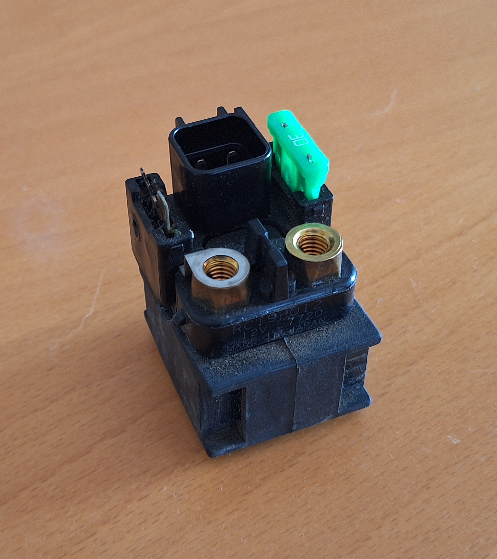

ChrisW wrote: Tue Aug 27, 2024 5:48 pm Didn't you have to replace the main fuse a year or so ago? Do you know why it went then?
Yeah. I messed up.
viewtopic.php?p=162655&hilit=Fuse#p162655
A_morti
Posts: 1034
Location: Malta
Has thanked: 412 times
Been thanked: 824 times
Re: Proper Blown Fuse
Post by A_morti »
Yorick wrote: Tue Aug 27, 2024 5:51 pm Yeah. I messed up.
Could be the root cause.
Maybe the original mess up caused enough heat to damage something that's now finally had enough. Metal contacts heated up enough can lose their spring tension, for example.
If that's all, then a fuse and a solenoid should be enough to get her happy again :obscene-drinkingcheers:

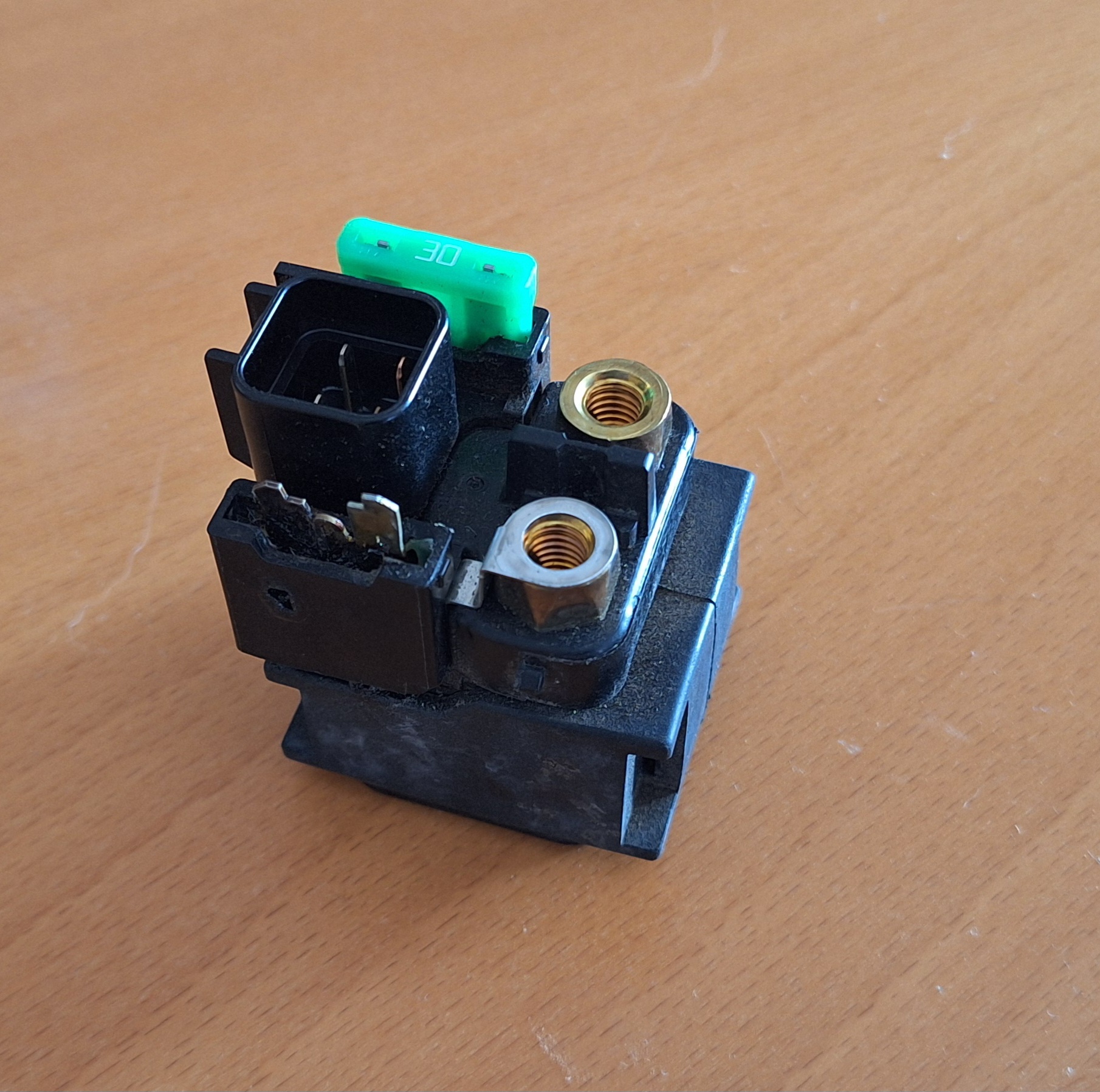

By the looks of that, I'd say that the Fuse was loose in the connector. The burn mark in the middle is where it was loose. It would have been arching, pitting the contact even more and gradually making the electrical connection progressively worse.
Possibly.
Posts: 19945
Has thanked: 12620 times
Been thanked: 8541 times
Nobby wrote: Thu Aug 29, 2024 5:23 pm By the looks of that, I'd say that the Fuse was loose in the connector. The burn mark in the middle is where it was loose. It would have been arching, pitting the contact even more and gradually making the electrical connection progressively worse.
Possibly.
Hmm. Maybe true 👍

My last one of these was because of a trapped wire, it only shorted out when I went over a big bump.
It was black wire, black bracket and black bolt.
Had to park up get the Mrs to rescue me and went back the next day.
Took about 40mims to realise what it was

Took it to ship with my pal to translate. He was chatting to owner for ages as they're great pals.
Owner then comes out, sees the blown fuse and pulls the whole unit off.
The starter motor relay had blown.
They had one in stock. 23€ :obscene-birdiedoublered:
Gave him 10€ tip :obscene-birdiedoublered:
Happy here, but think it's screwed the battery. It's on charge now.
