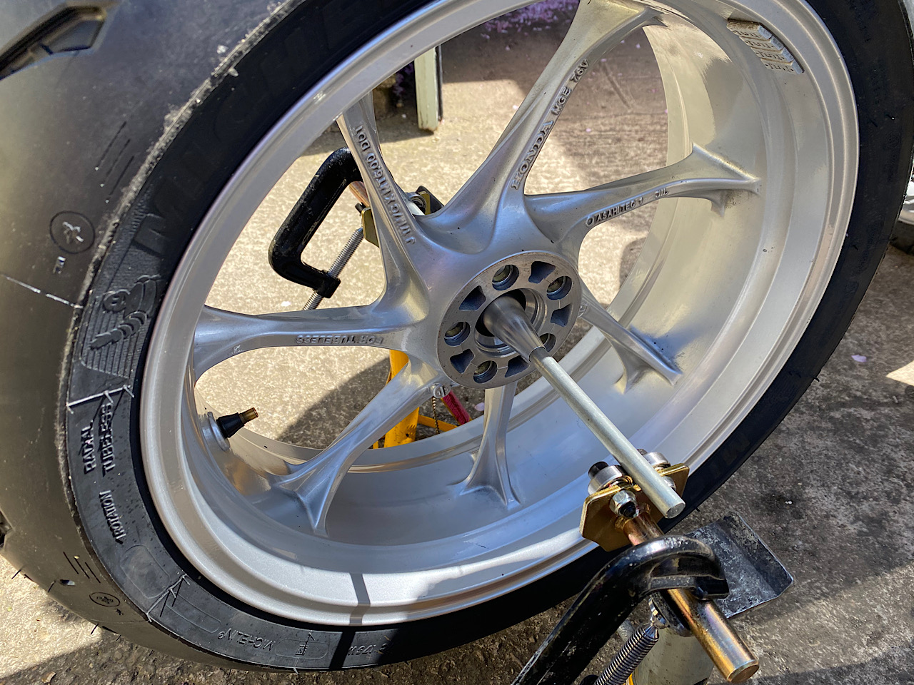

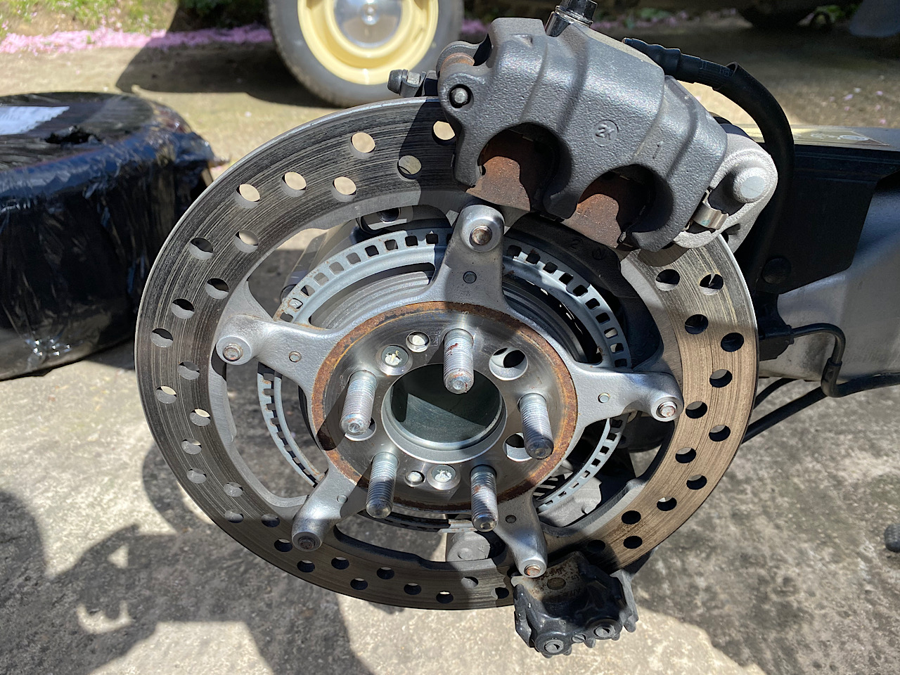

Changed the tires today to some road 4s. Had to adapt the tyre balancer by putting the cones in backwards and making them wider with tape. The result will be close enough. Picture below shows the rear wheel hub and the separate handbrake calliper.

Fooled by the tread. Mounted the tire to the wheel correctly but installed the wheel the wrong way round because the tread looked right. Fitted no problem but tc and abs lights wouldn’t go out and the dct box wouldn’t change out of first.
Took me a few minutes to figure out this one. Was checking the wiring on the abs sensor and then noticed that the sensor wheel was on the other side of the bike.

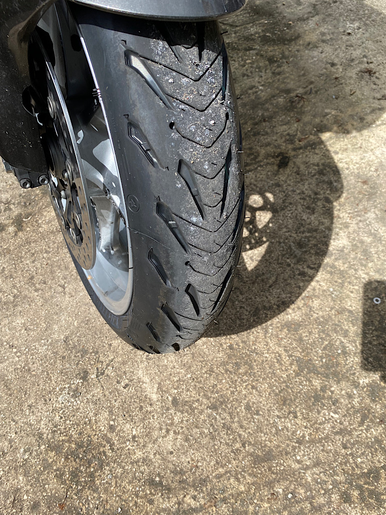

Really happy with the new tyres. It carves instead of tramlines now. Very confidence inspiring, even in the rain.
