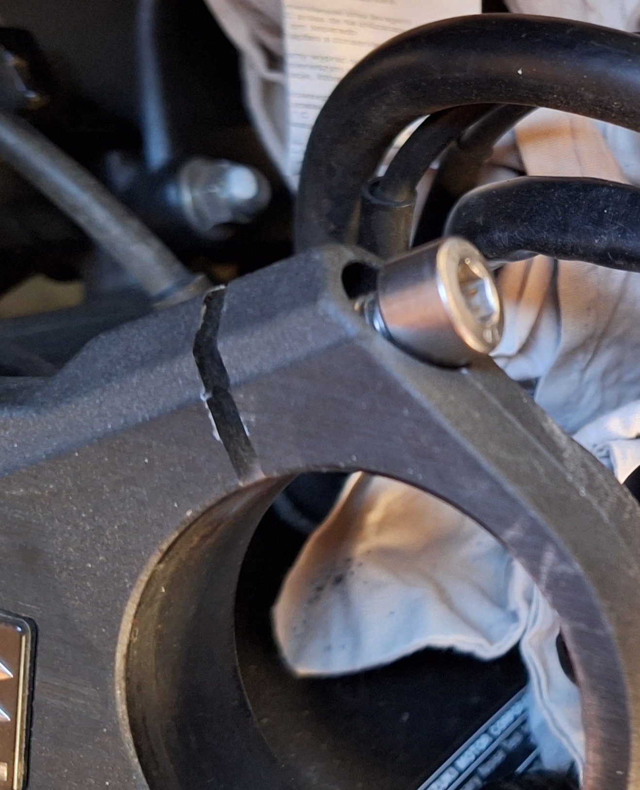

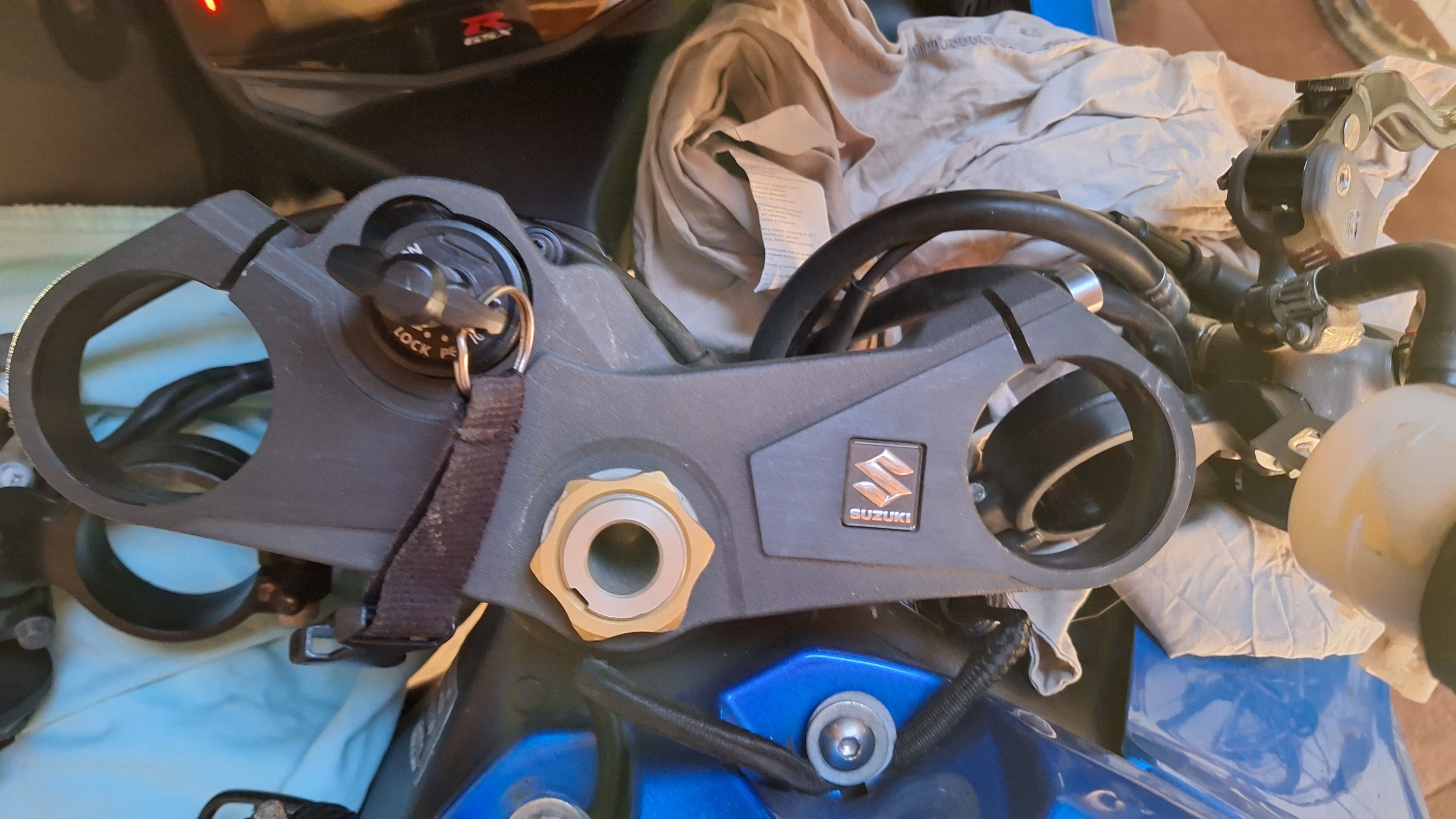

I'm pissed off and a bit angry but not sure who or what to blame.
Took the front wheel out and dropped the brakes and mudguard.
Loosened the lower fork yoke on right side and the leg fell out. Aaaargh.
So I assumed the top yoke had come loose. No. The Allen bolt was still tight. I pushed the fork leg back up and it slid into the gap no problem. Tightened bolt as far as I dare. Nada. It was threadlocked :(
Packed it out with washers and tightened lovely. So got the hacksaw out and chopped 3mm off. Now it tightens lovely.
But HTF did it leave factory like that?
It's always had a tiny knock when braking hard, so this was probably the cause.
It wasn't dangerous as there are 2 huge bolts on the lower yoke. But a bit unnerving.

So did the RH side of the top yoke have a shorter bolt fitted than the LH, or is the thread depth on the RH side of the top yoke different to that on the LH side?
Either way it should never have left the factory like that.

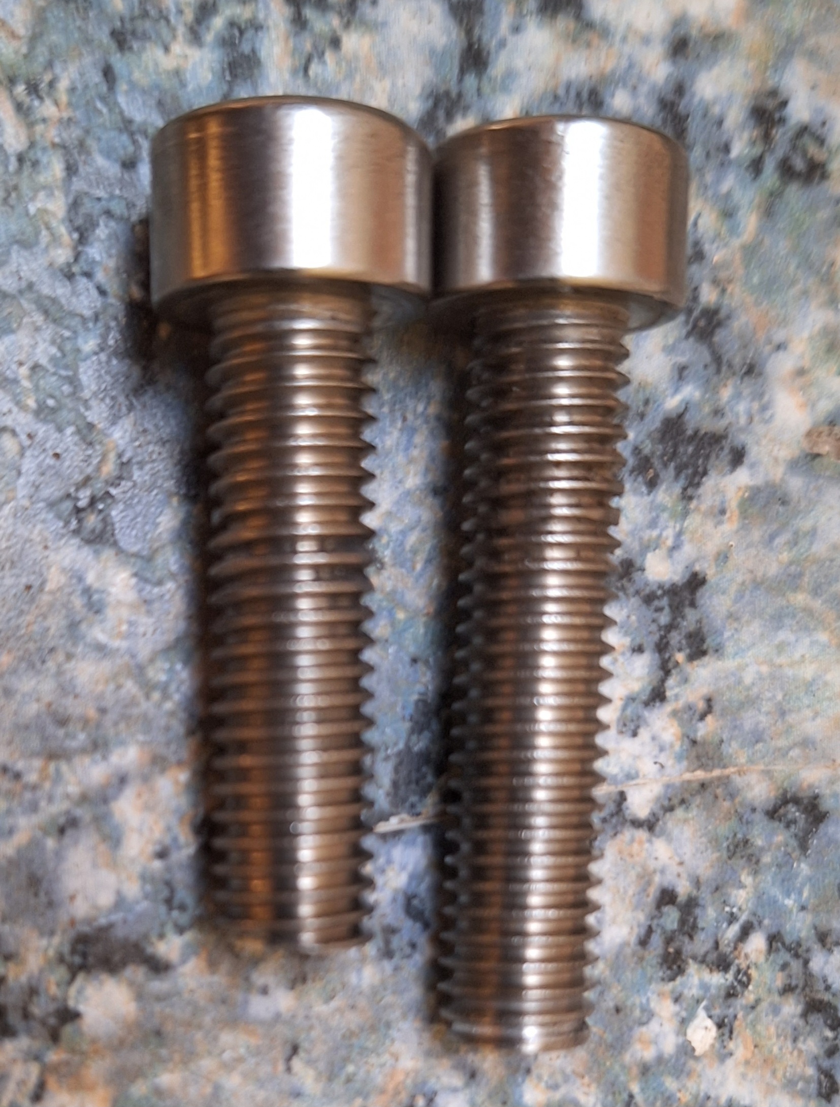

mangocrazy wrote: Sun Nov 12, 2023 6:52 pm So did the RH side of the top yoke have a shorter bolt fitted than the LH, or is the thread depth on the RH side of the top yoke different to that on the LH side?
The same. I swapped the bolts round and same result. But, the left side bolt had a slight kink in it. Didn't stop it tightening up, but looked strange.
The original photo shows left side with sawn off right side.

Could be a manufacturing defect in the clamp, rather than the bolts. Right bolts but holes are duff.

Mr. Dazzle wrote: Sun Nov 12, 2023 7:28 pm Could be a manufacturing defect in the clamp, rather than the bolts. Right bolts but holes are duff.
I'd tend towards that view as well. If you can be bothered and have a set of vernier calipers, measure the depth of the thread hole on each side. I suspect the RH yoke thread had not been drilled and tapped to the same depth as the LH one. Or drilled off centre, perhaps?

mangocrazy wrote: Sun Nov 12, 2023 7:45 pm
The bolts are OK. The hole not deep enough.
